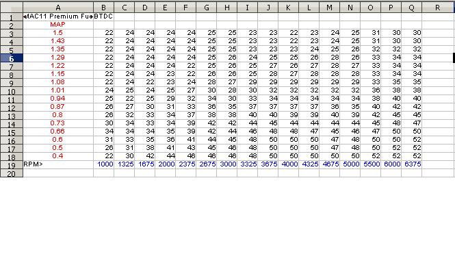

Here's an MC1 timing map (supposedly stock, as in from the stock MAC11 ECU) for premium fuel:
- MAC11 timing
- mac11-timing.JPG (62.65 KiB) Viewed 18369 times

Holy ballsack that is a lot of timing. Obviously only up to 1.5 bar but still. I have like no timing in my car at all. Awesome.

7.8:1 compression ratio....

I would imagine that MC2 timing maps are significantly more conservative. Beware, if that's what you have.

Great, thanks... shortblock is an MC1 w/ an NF head and SS exhaust valves...
Now I have to figure out how to input/mimic those timing numbers into my 034 Ic ECU... haha. But thank you! Huge help.
