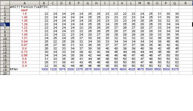

Hey all,
So since I'm not going to be able to get the 'ol bird on the rollers for a bit to mess with anything, and will be tuning on my own (danger!), I wanted to make sure my timing numbers are rock solid before messing with the fuel, etc.
Chance anyone has the list of the MC1/2 base timing numbers they can share with me, so I get my map into the "safe zone" regarding timing?
I really want to toss the 2.2 bar WG spring in the car, but don't want to damage anything if my ignition timing numbers are off.
Thanks! Heading to VIR next weekend (Nov 8-10), so want to up the power a little bit so I'm not mowed down in the instructor group! :)

Here's an MC1 timing map (supposedly stock, as in from the stock MAC11 ECU) for premium fuel:
MAC11 timing
MAC11 timing

Re: Anyone have MC 1/2 Base Timing numbers?
Holy ballsack that is a lot of timing. Obviously only up to 1.5 bar but still. I have like no timing in my car at all. Awesome.

7.8:1 compression ratio....

I would imagine that MC2 timing maps are significantly more conservative. Beware, if that's what you have.

Great, thanks... shortblock is an MC1 w/ an NF head and SS exhaust valves...
Now I have to figure out how to input/mimic those timing numbers into my 034 Ic ECU... haha. But thank you! Huge help.

Here are the stock premium and regular timing tables for the MC2/ MAC14
MAC14 TIMING.jpg (67.15 KiB) Viewed 18320 times
