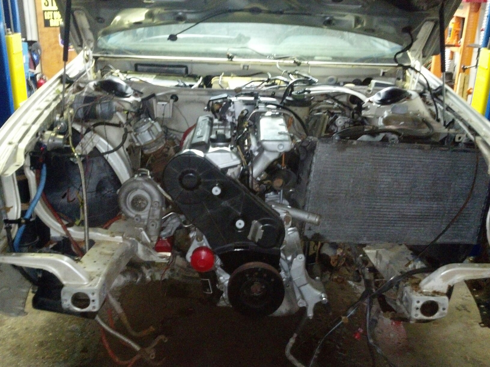

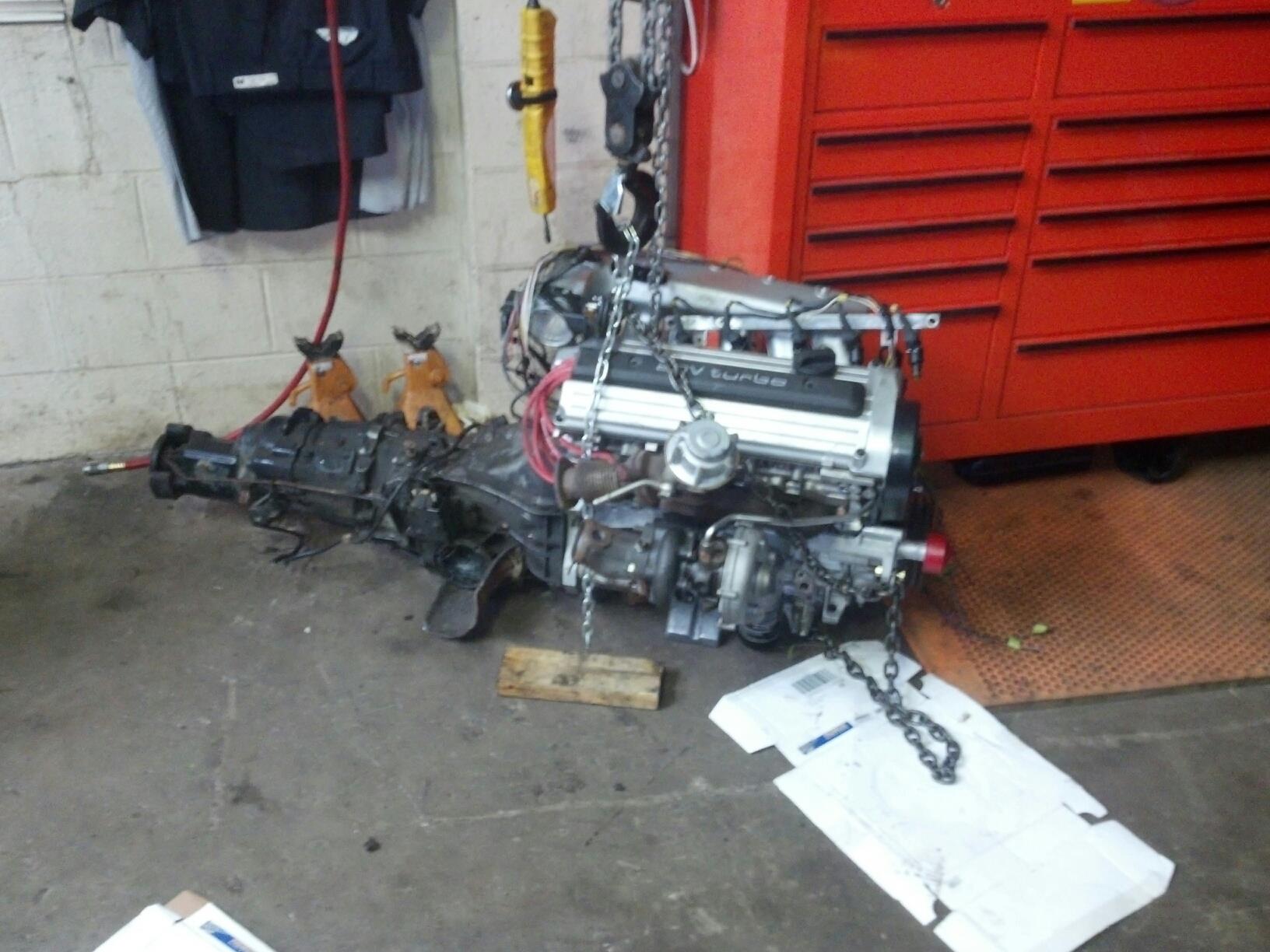

I guess it's time I make a thread on here.
Car:
1987 Audi 5000CS Quattro
Engine:
NF bottom end
7A head and cams
7A oil pan with extension
60-2 rear crank seal (no provisions for the factory sensors)
VEMS ECU
aaaand I guess pics...

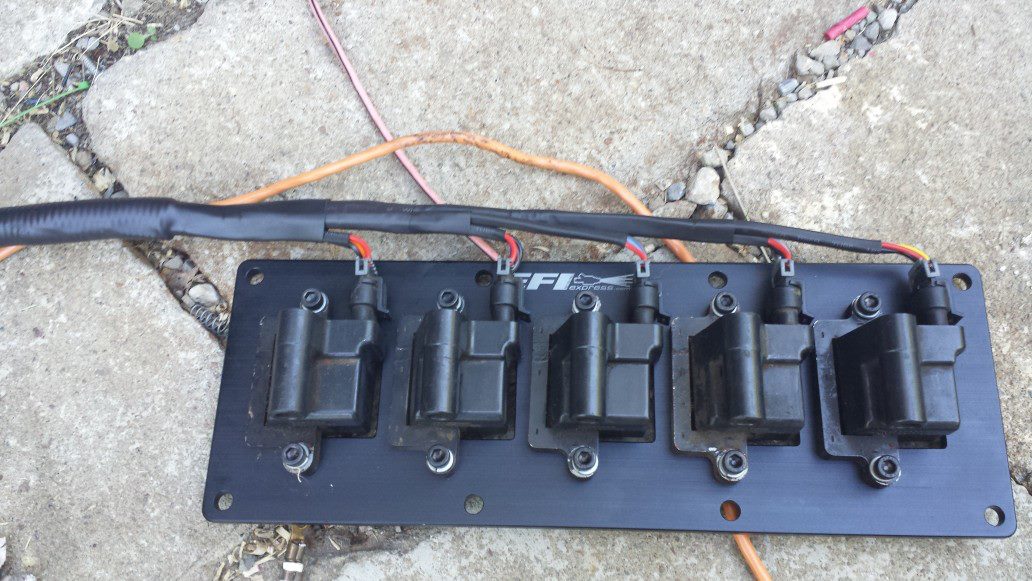

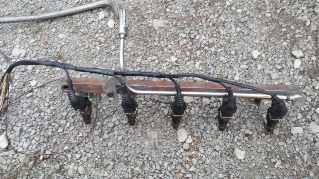

Aaaaaand wiring progress. All I have left is ECU side and the crank sensor.
