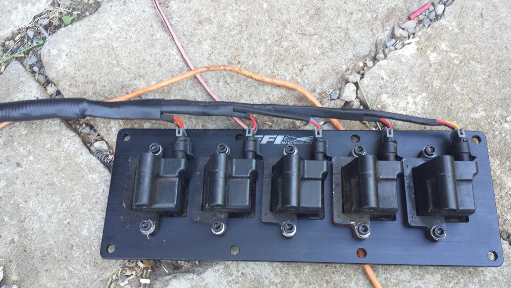

Aaaaaand wiring progress. All I have left is ECU side and the crank sensor.

That would be cool. I eliminated a lot of stuff, and I'm running LS coils too. But at least part of it should be the same.
