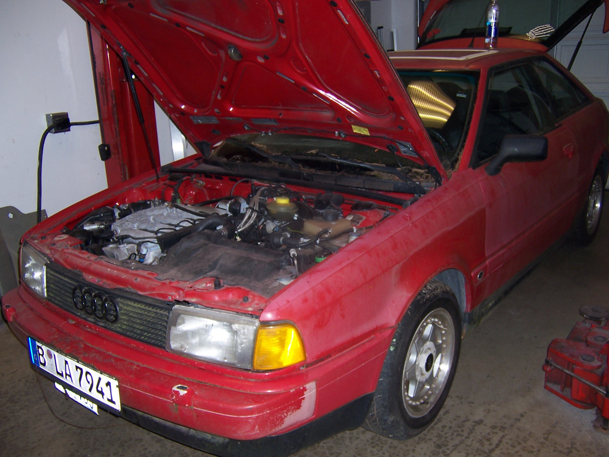

Ben lurking here for a while and finally pulled the trigger.Coupe is 1989 and a mess,as it has been sitting in my yard for to long.
The reason it sat so long is that i was/still gathering parts.Had to move it the other day and said screw it ,if i wait for the parts
still needed it will sit here another 6 years.So i decided to at least do what i can to move the Project ahead. Always liked
Widebody cars so after looking at tons of fiberglass flairs as well as flairs on existing cars i thought 944 flairs would look the best ,
to me anyways.Since the car had been hit , and i bought it with a Rebuild Title there was no moral dilemma when the saw hit the car
the first time.

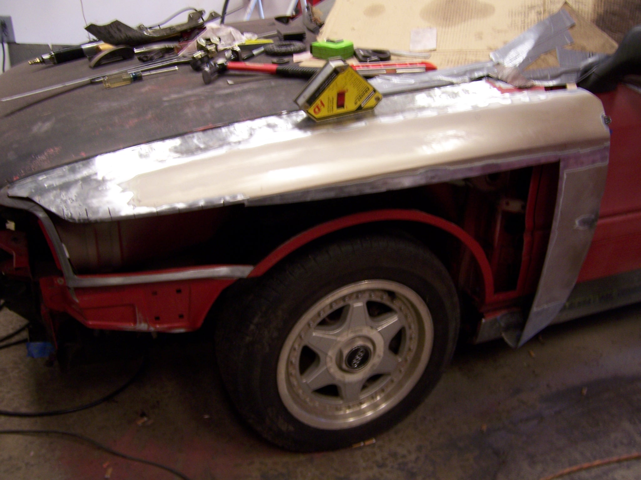

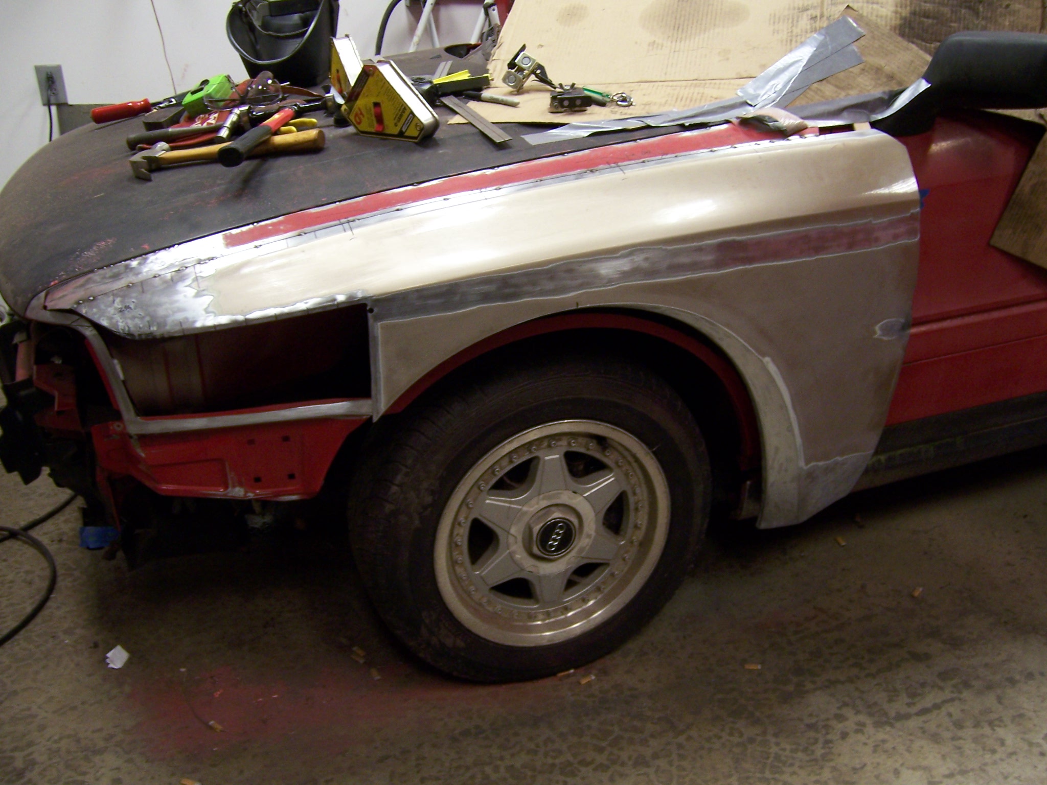

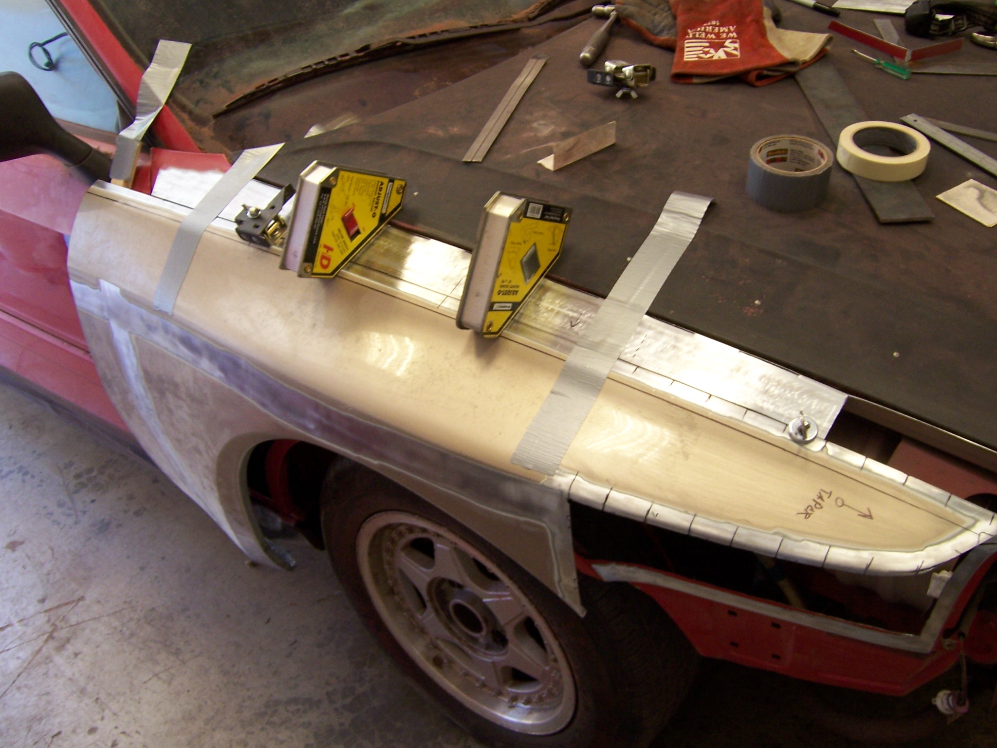

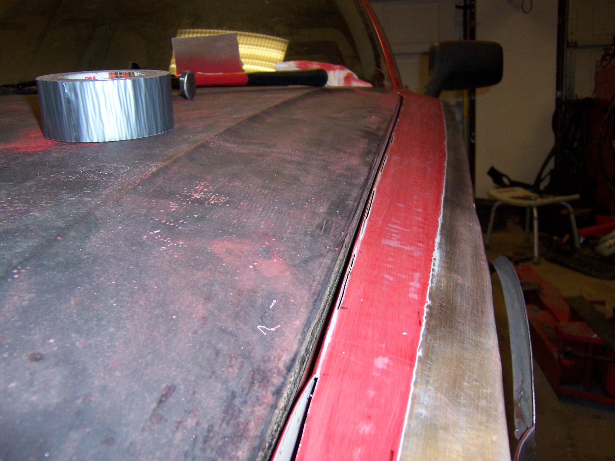

So lining the fender up ala Urq or Sport did not lock right (again with my eyeballs ,other people may see it different). This would have been
the easy way since i would not have to section the fender. Moving the fender up locked way cool but with that came more work. The top
curve of the porsche fender has more of a curve than the audi fender so i brocke its back to make it fit. Also the audi metal needet to come
up in order to keep a good hood to fenderline. Let me state at this point that before i cut int the car i alined all the body panels and fixed
what needed fixing bodywise.

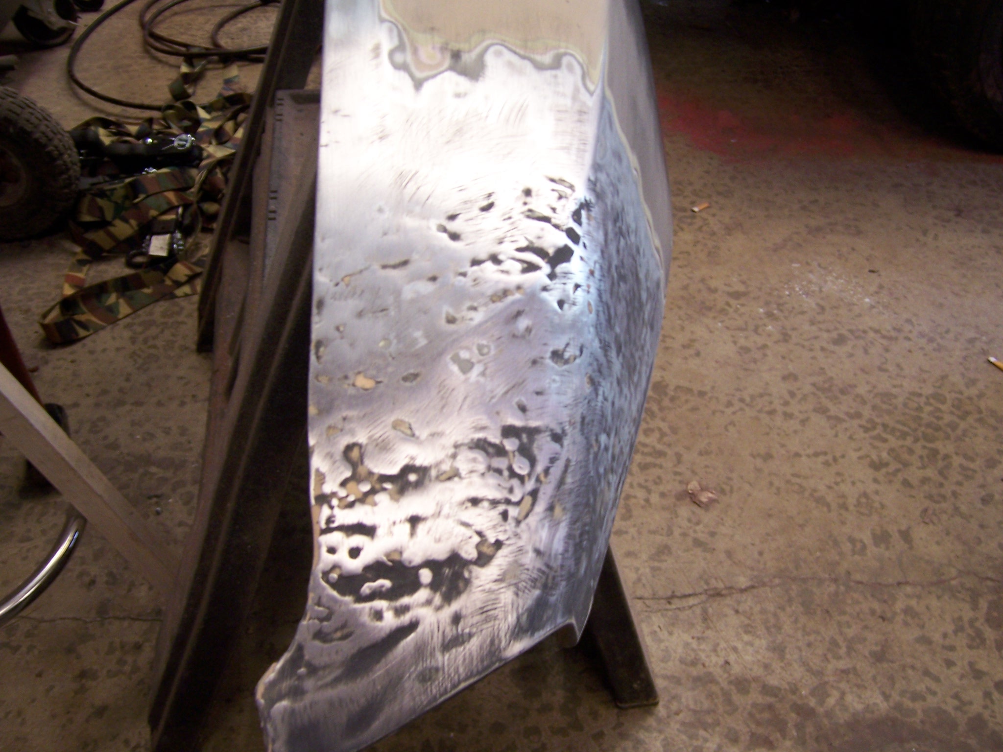

Hammerd straight and pulled up , was not playing well so i made some relieve cut and it started to be nice.
audi wide build 007.jpg (568.2 KiB) Viewed 76758 times
audi wide build 009.jpg (441.06 KiB) Viewed 76758 times

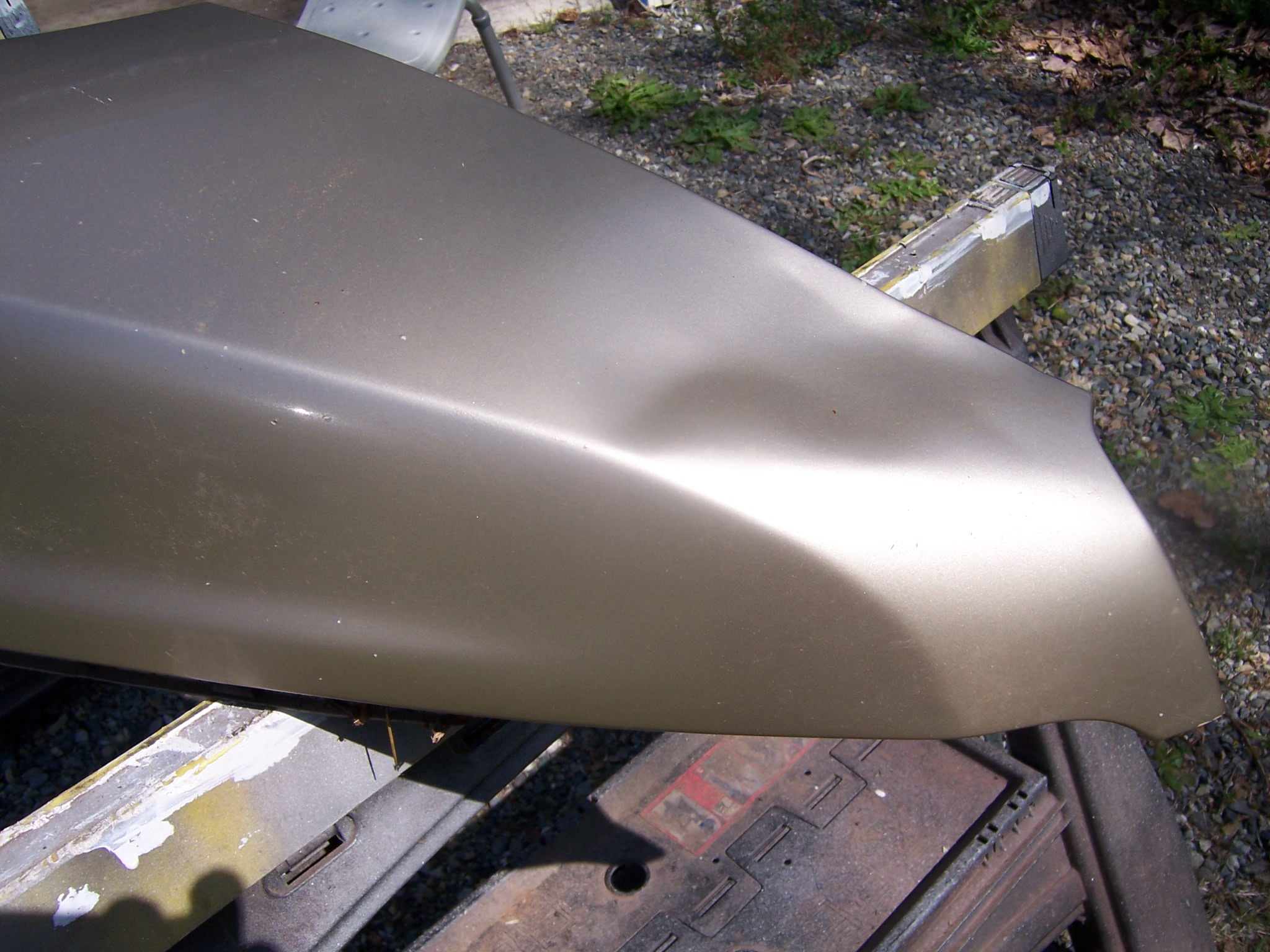

Fixing dent in porsche fender revealed a previous fix.
cars,vac,tb 156.jpg (620.09 KiB) Viewed 76758 times
audi wide build 012.jpg (499.95 KiB) Viewed 76758 times
Fender on!!!!!
audi wide build 020.jpg (524.49 KiB) Viewed 76758 times

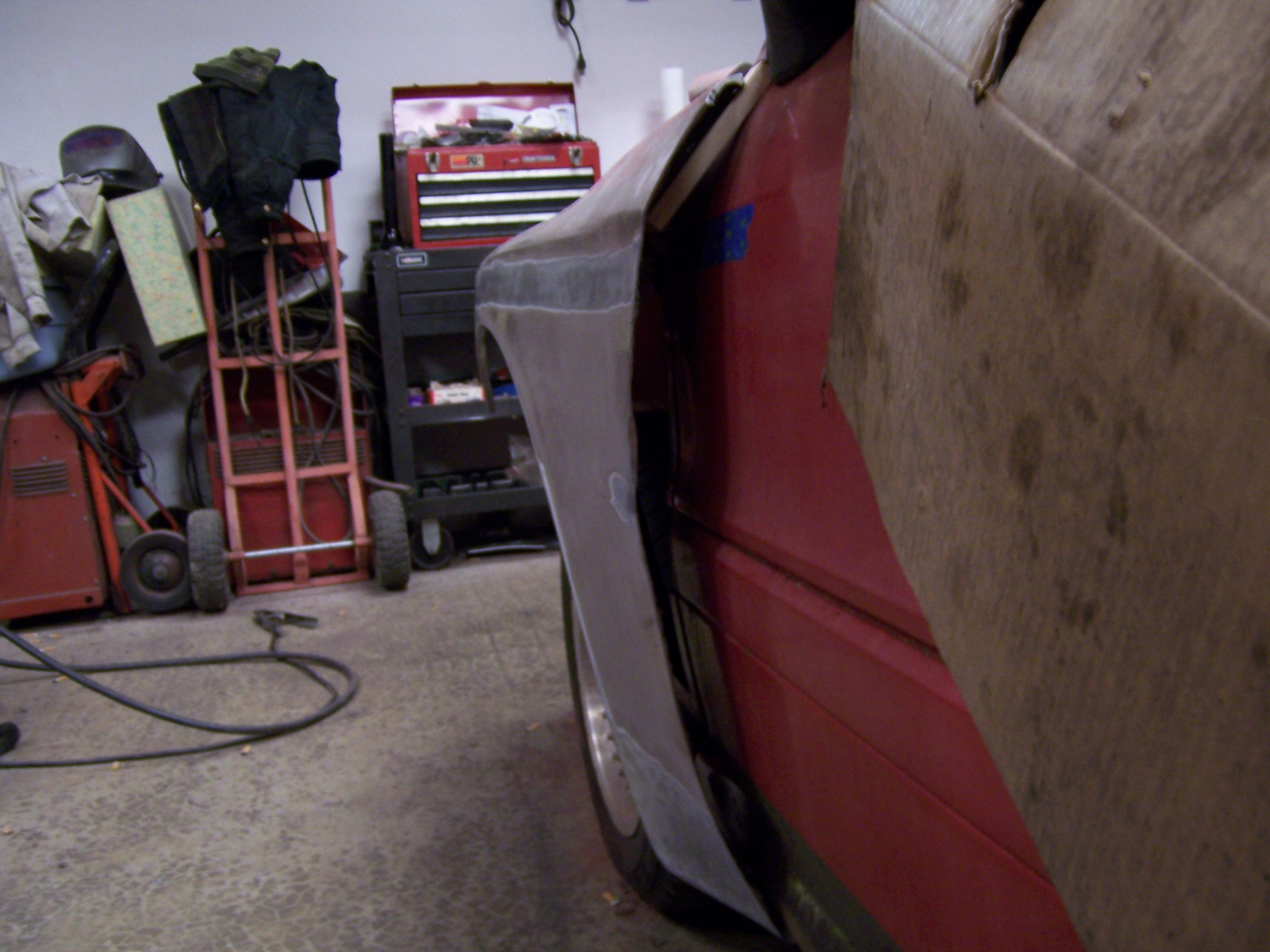

Rear view of fender.I am keeping that Slot (Hole just doesn't sound right).
audi wide build 021.jpg (482.47 KiB) Viewed 76671 times

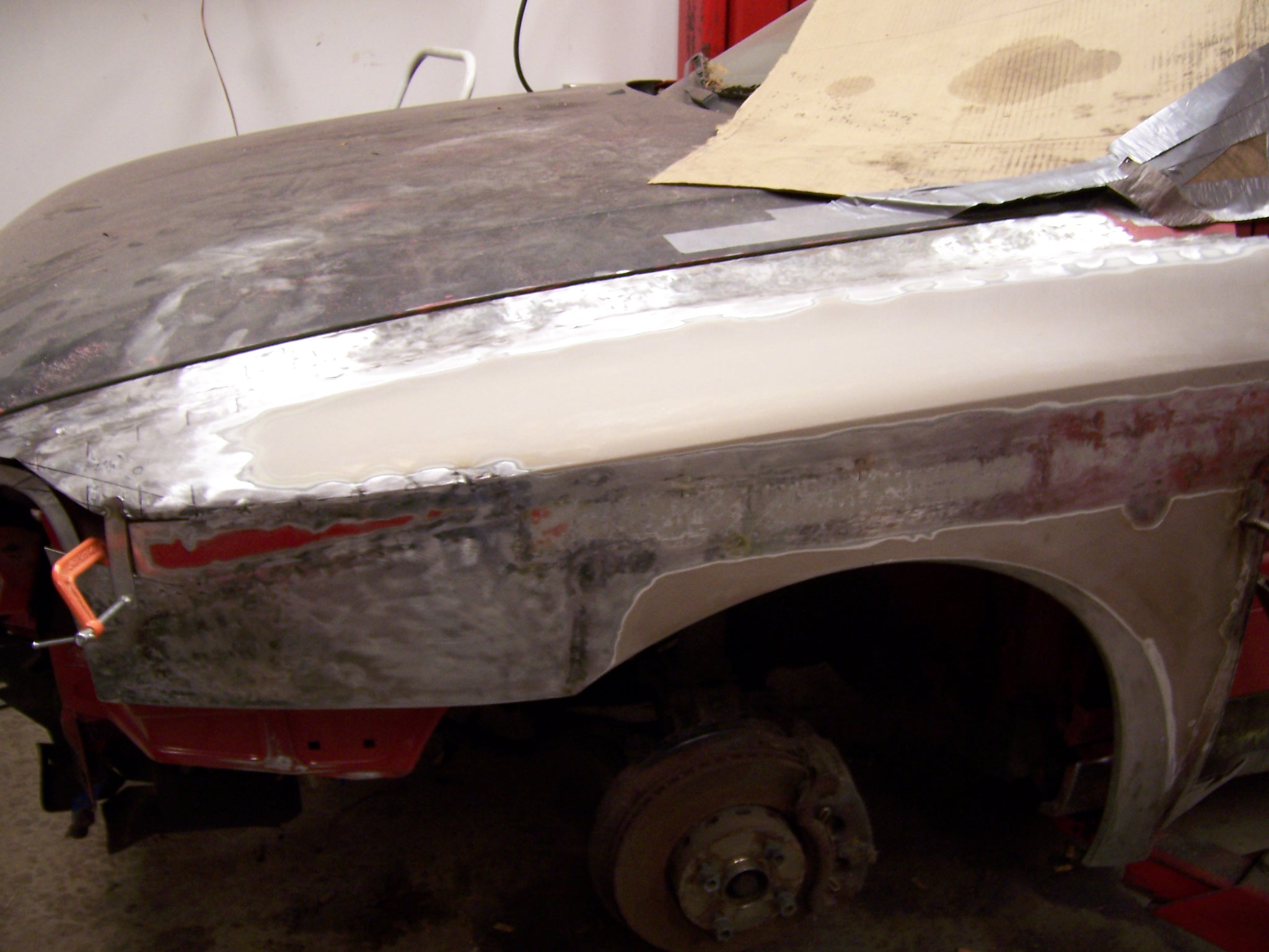

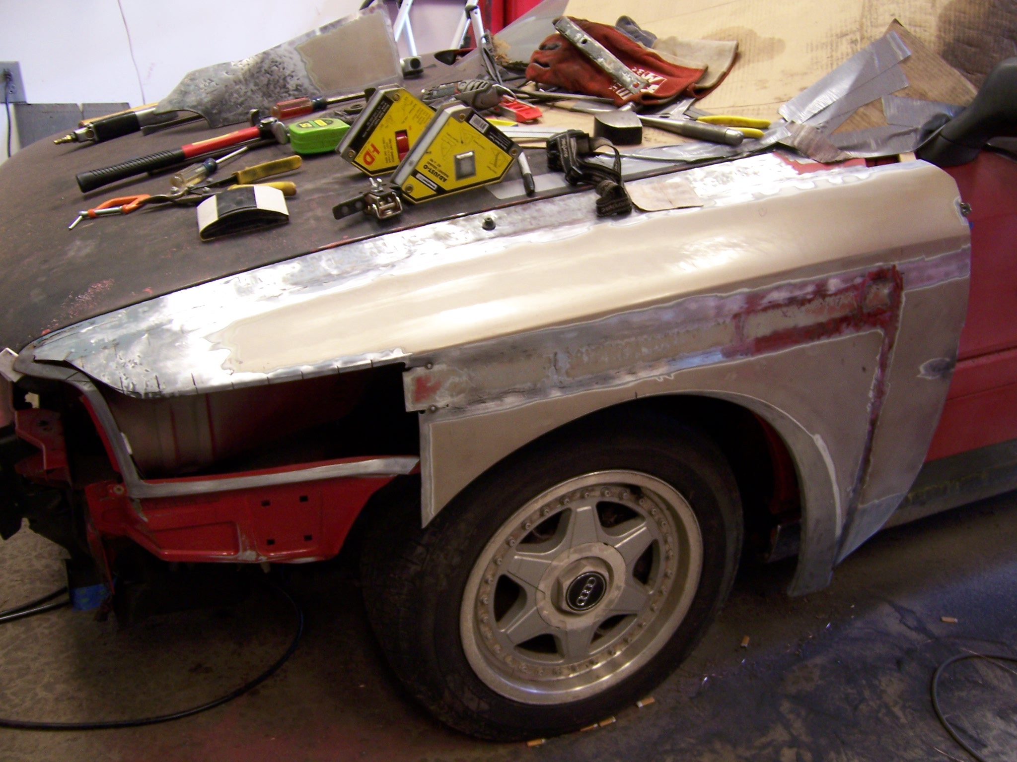

Fender after cutting for sectioning
audi wide build 026.jpg (430.29 KiB) Viewed 76671 times
Lined up with Original Wheel Well
audi wide build 028.jpg (547.31 KiB) Viewed 76671 times
Making headway
audi wide build 030.jpg (408.58 KiB) Viewed 76671 times
Look of gain from inside before taking the audi wheel frame out
audi wide build 029.jpg (648.66 KiB) Viewed 76671 times
Future updates will be rinse lather repeat for the other side and then i'll do the all important nose of the fenders.

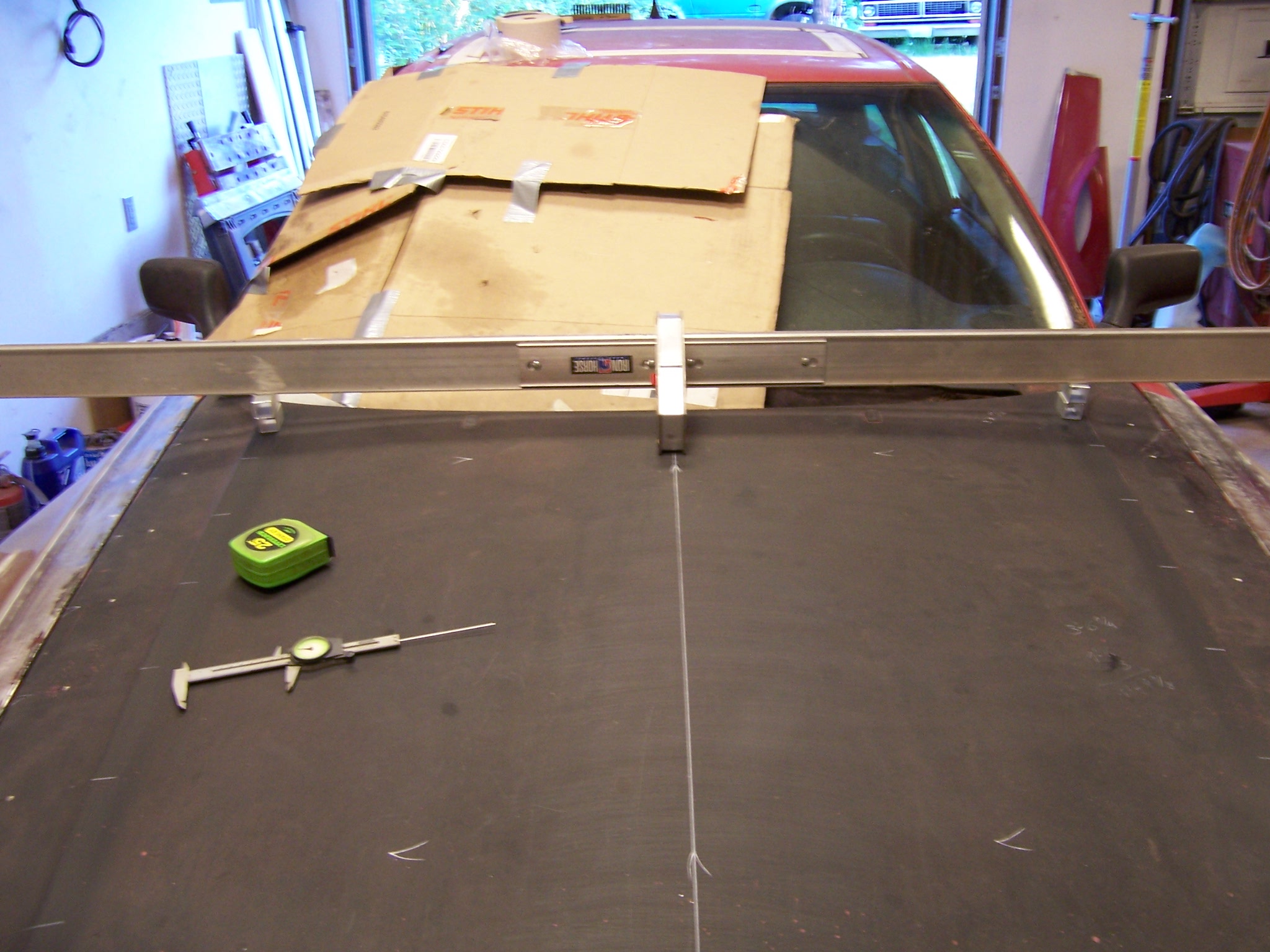

Measuring top of fenders to get them even
audi wide build 039.jpg (505.05 KiB) Viewed 76439 times
Things i have found out:
Tire pressure needs to be equal ( 5PSI is worth about 1/8" with battery removed )
Do everything the same including the screw ups so the metal will pull the same as other side
If using used metal from other body parts install them the same way so the metal will pull the same way as other side
My right tire sits in the wheel well 1/2" further towards the front as the left ( in original audi sheetmetal ) :o
As soon as i get the other side tied in ill get you guys a Overhead shoot of the front , that thing looks Mean!!!!!
