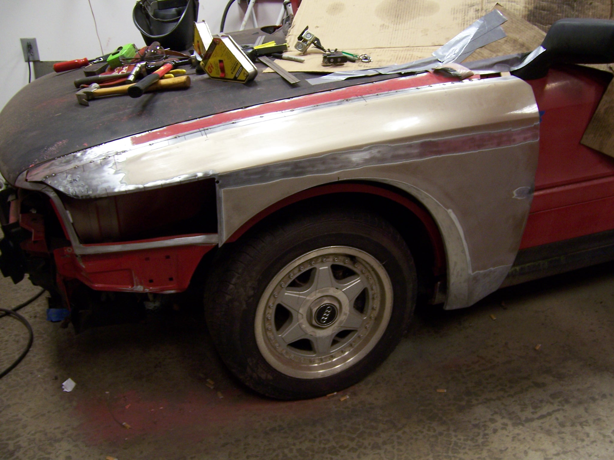

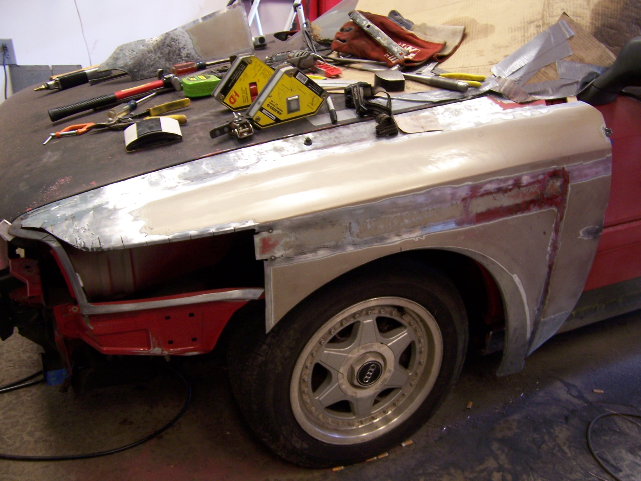

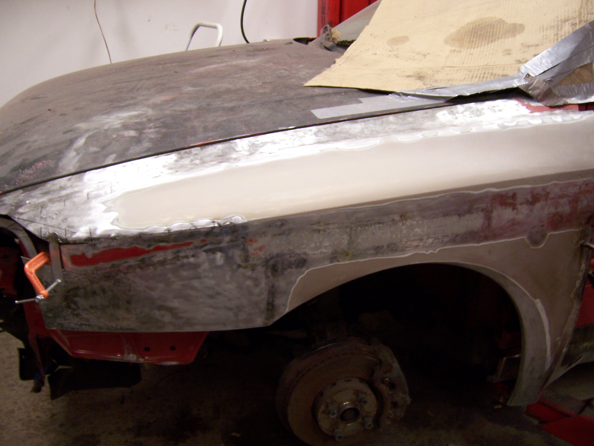

So lining the fender up ala Urq or Sport did not lock right (again with my eyeballs ,other people may see it different). This would have been
the easy way since i would not have to section the fender. Moving the fender up locked way cool but with that came more work. The top
curve of the porsche fender has more of a curve than the audi fender so i brocke its back to make it fit. Also the audi metal needet to come
up in order to keep a good hood to fenderline. Let me state at this point that before i cut int the car i alined all the body panels and fixed
what needed fixing bodywise.

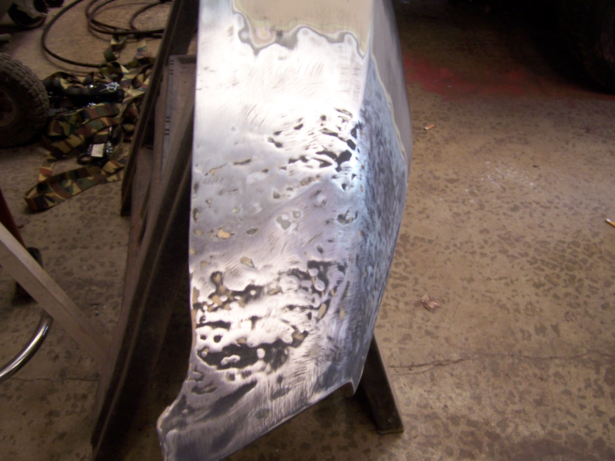

Hammerd straight and pulled up , was not playing well so i made some relieve cut and it started to be nice.

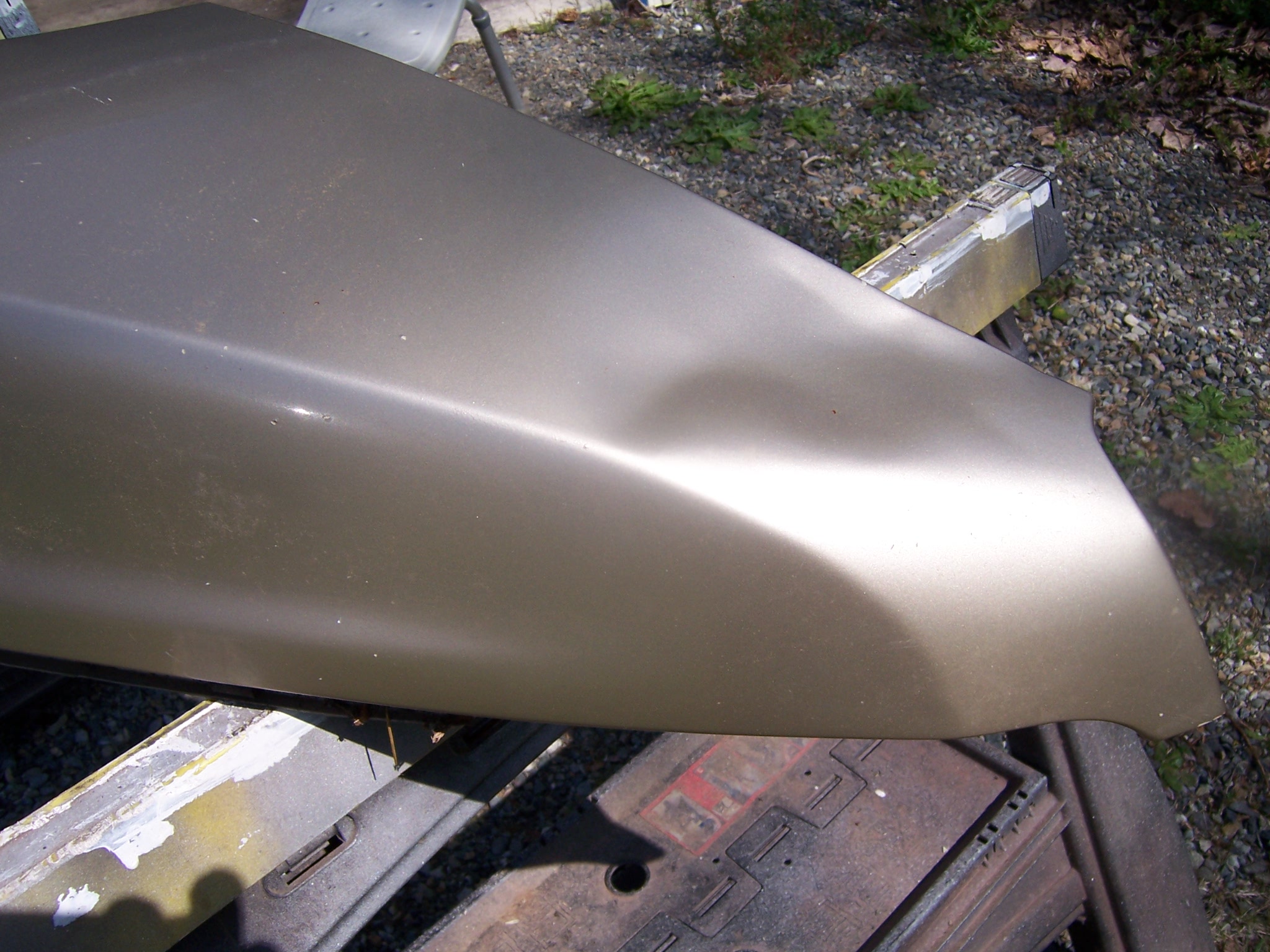

Fixing dent in porsche fender revealed a previous fix.
cars,vac,tb 156.jpg (620.09 KiB) Viewed 76728 times
audi wide build 012.jpg (499.95 KiB) Viewed 76728 times
Fender on!!!!!
audi wide build 020.jpg (524.49 KiB) Viewed 76728 times
Just found the limit on attachments , Now i know for future posts but that also means you guys do not get to see the fender from the
rear view of the car till next post . The opening it created instantly grew on me I LOVE IT.

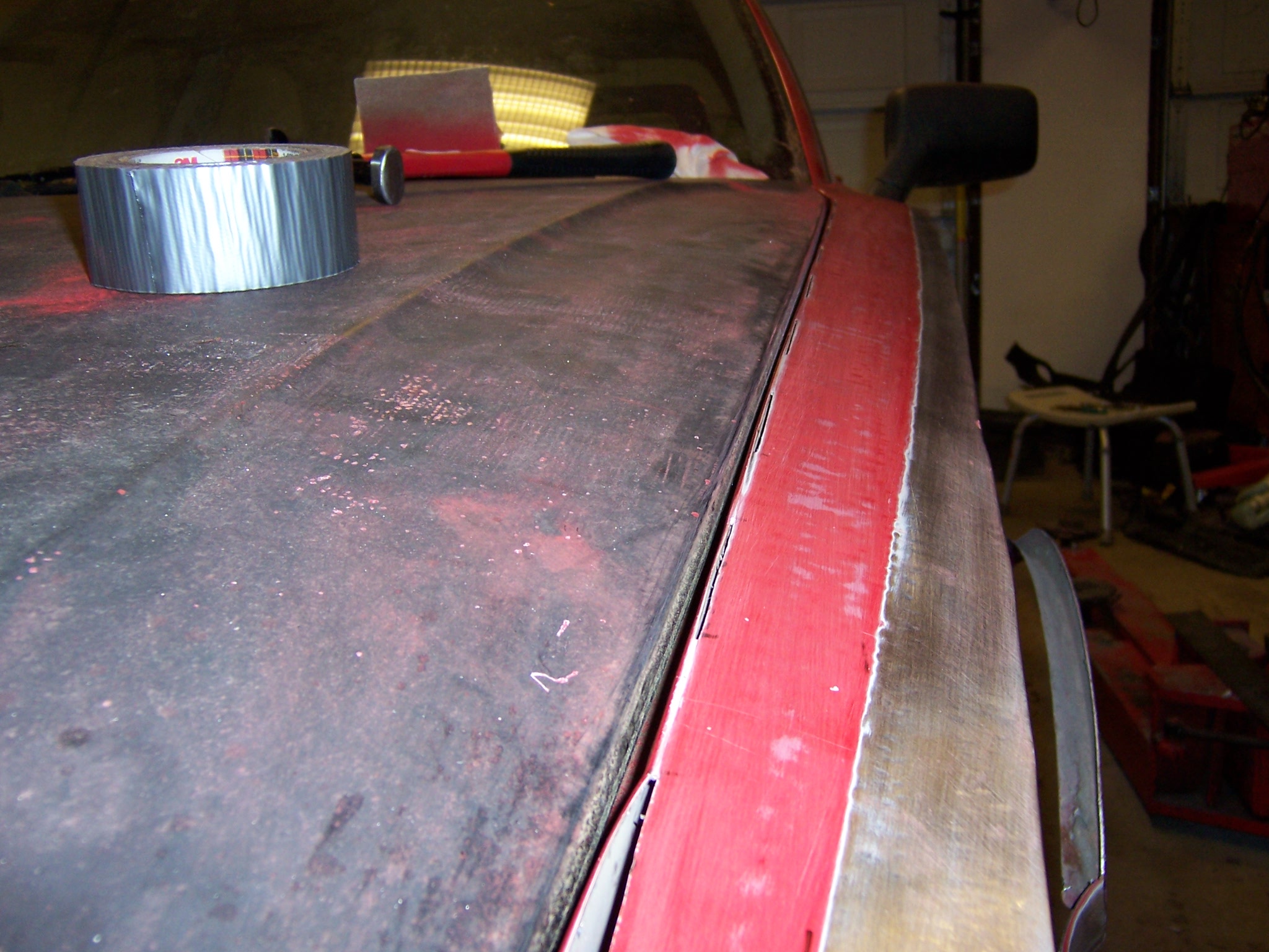

Rear view of fender.I am keeping that Slot (Hole just doesn't sound right).
audi wide build 021.jpg (482.47 KiB) Viewed 76641 times
Fender after cutting for sectioning
audi wide build 026.jpg (430.29 KiB) Viewed 76641 times
Lined up with Original Wheel Well

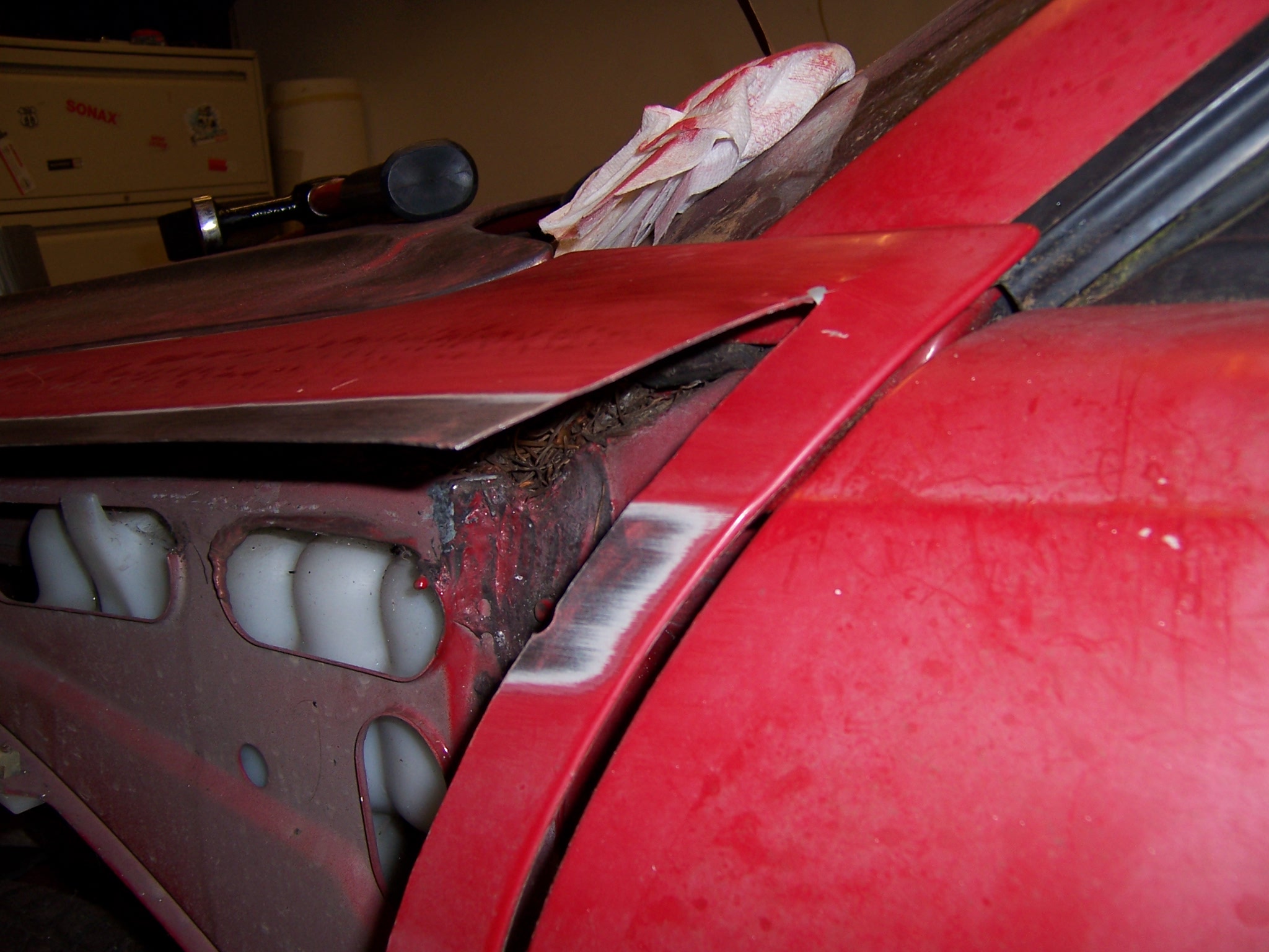

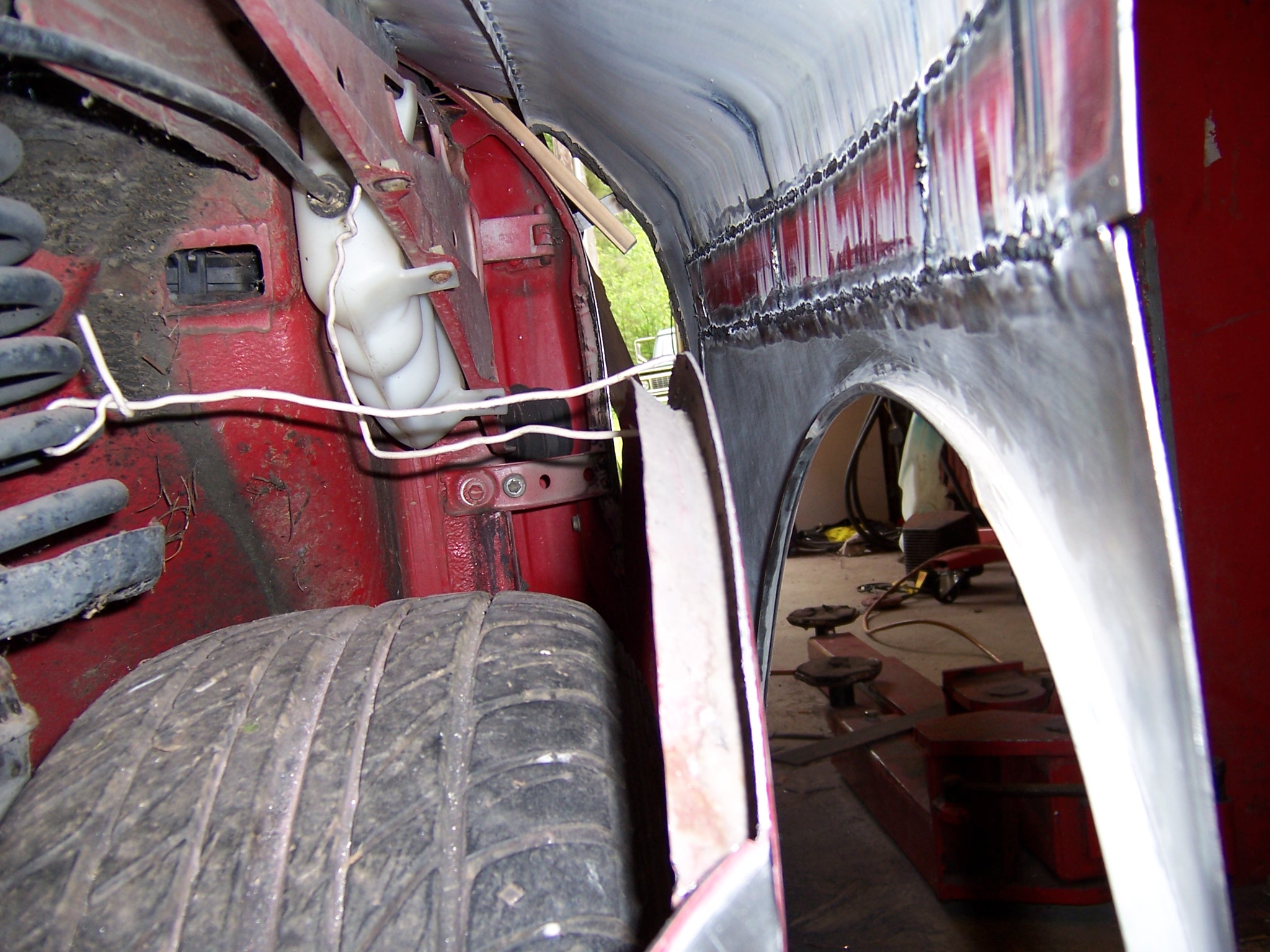

Look of gain from inside before taking the audi wheel frame out
audi wide build 029.jpg (648.66 KiB) Viewed 76641 times

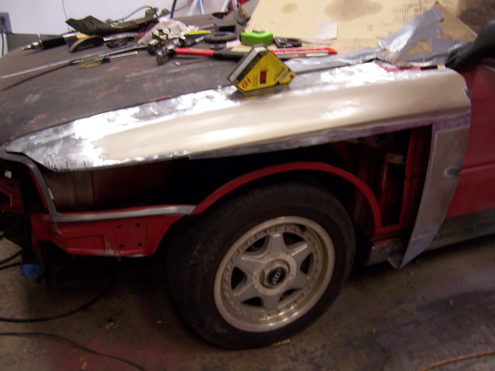

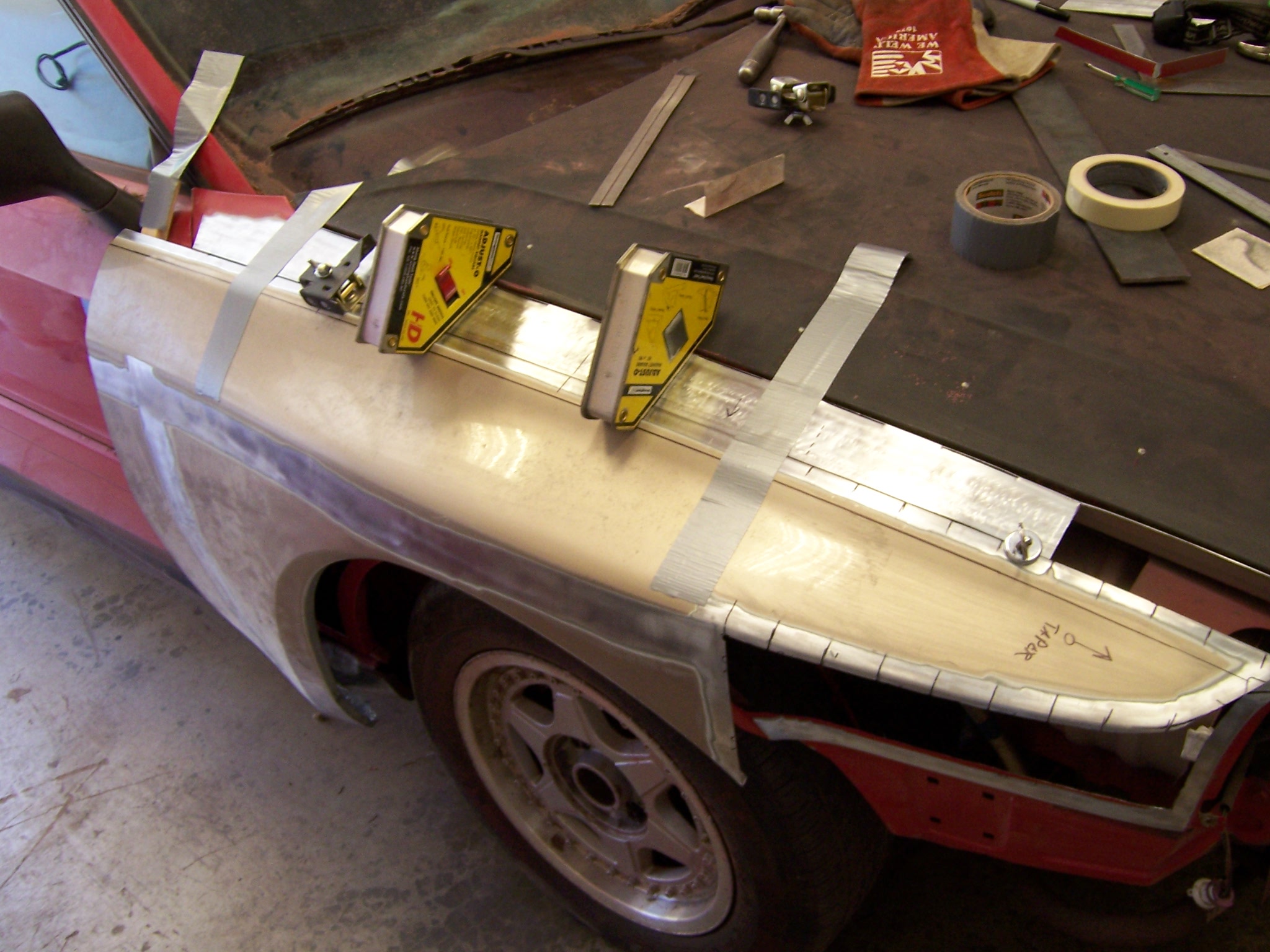

Other side going on
audi wide build 035.jpg (525.77 KiB) Viewed 76409 times
audi wide build 038.jpg (561.22 KiB) Viewed 76409 times

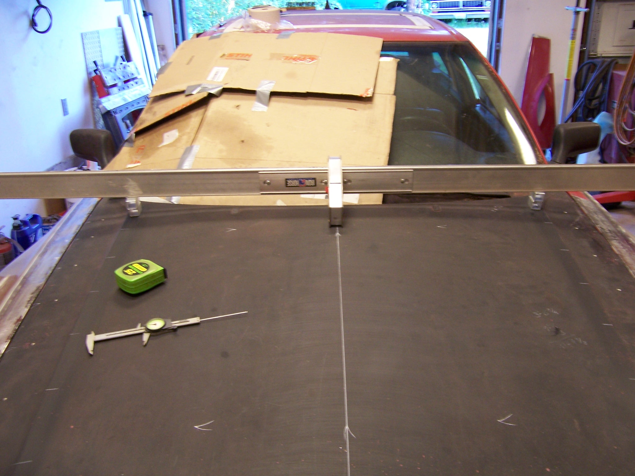

Measuring top of fenders to get them even
audi wide build 039.jpg (505.05 KiB) Viewed 76409 times
Things i have found out:
Tire pressure needs to be equal ( 5PSI is worth about 1/8" with battery removed )
Do everything the same including the screw ups so the metal will pull the same as other side
If using used metal from other body parts install them the same way so the metal will pull the same way as other side
My right tire sits in the wheel well 1/2" further towards the front as the left ( in original audi sheetmetal ) :o
