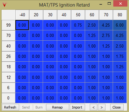

iat ign retard
iat ign retard
This is how I used to have my 30r setup. I was very weary of intake temps and have a feeling it contributed to my last engine's detonation problems. Since upgrading my intercooler and intake setup, I've reduced my IATs and have subsequently adjusted the amount of timing the ECU will pull from the base timing map.

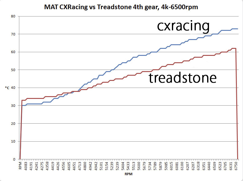

New Treadstone vs old CXRacing intercooler:

For example, based on that IAT timing retard table I posted above that I used to use on my 30R, my VEMS was pulling 6 degrees out of my timing table on a regular basis. My base timing table was only ~12-15 degrees in the upper RPM range. 6 degrees of timing is NOT a lot, one could say effectively *too little* timing to even be worth it. BUT, that was my old intercooler and I felt it was worth it to save the motor. Sure, "turn down the boost yadda yadda" but I wanted to be able to push the car and let it figure out when/how to pull timing.

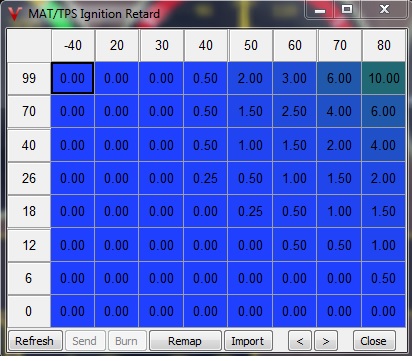

This is my current IAT retard table. As you can see, it is much less conservative:

MAT/TPS retard is a safety feature - nothing more. Why do you want to reduce the table's ability to provide that safety?
In my opinion, leave it alone, let it do its thing. Remember, MAT/TPS retard, along with any other ignition retard tables, use the ignition map as a base. So if you tune ignition appropriately (with a good set of knock ears), then you've adapted the ignition table to reference the MAT/TPS retard table's values. In other words - let's say you've dyno tuned the ignition map with 60* MAT...you detected some slight detonation so you backed the timing off 2* to be safe. But the MAT/TPS table was also pulling 3* at that point. By reducing the values in in the MAT/TPS retard table, you're now back ON or PAST the detonation threshold at that load cell.
Point is - that table can be whatever you want it to be, but it should be tuned before the ignition map, then left alone. I prefer leaving the values there on the higher side, so that it can more effectively help protect your motor.
