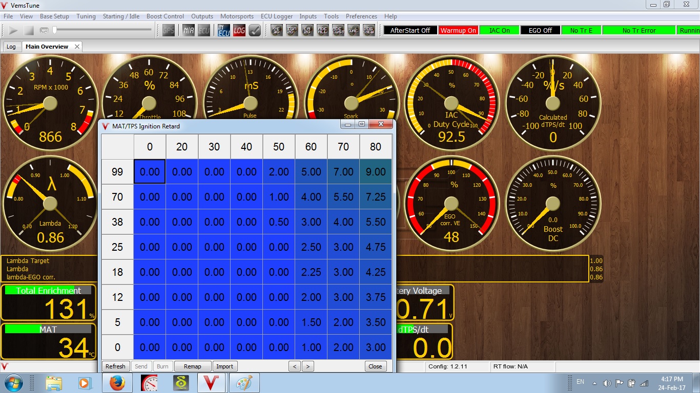

So in my journey to lower my intake temps, I've been trying to read up as much as possible about WHEN and HOW MUCH ignition timing one should take out of their base timing table with an additional MAT/IAT timing retard table.
Why do you take timing out when IATs climb? So your engine doesn't detonate and blow up the nice shiny stuff inside your long block. This is obvious, right? Okay, but at what point should we start removing timing due to IATs, and how much timing do we remove? The downside to retarding timing is higher EGTs and less power. Go too far one way (advance) and you detonate, go too far the other (retard) and you melt stuff.

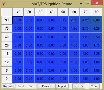

At least with VEMS, this table is very simply laid out:
This is how I used to have my 30r setup. I was very weary of intake temps and have a feeling it contributed to my last engine's detonation problems. Since upgrading my intercooler and intake setup, I've reduced my IATs and have subsequently adjusted the amount of timing the ECU will pull from the base timing map.
New Treadstone vs old CXRacing intercooler:

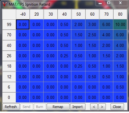

I recently found a table from the Evo guys, this is how their stock ECU pulls timing: This is clearly where dyno tuning helps the calibrator in that he can see MBT (or as much timing as possible before MBT due to knock) and hear detonation/preignition. If det, pull timing. It may be that one just cannot run over a certain amount of boost - Marc tuning the billet k26 on the small #6 hotside, for example. If I recall, intake temps went off the "acceptable" limit at a certain boost regardless of timing. But what if you're unable or don't have the funds to get on the dyno right away? Suck it up, gotta pay to play? Or are there some very general guidelines out there?
So at what temperature do YOU start pulling timing, and how much? How high of temperatures is too much? What is simply too little timing? Is there a certain number or range that there is no point in pulling MORE timing than?

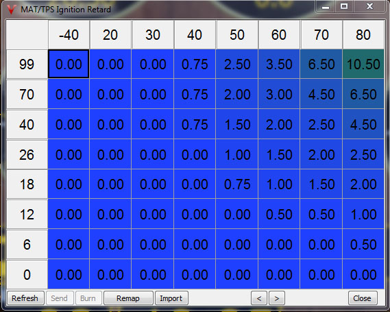

For example, based on that IAT timing retard table I posted above that I used to use on my 30R, my VEMS was pulling 6 degrees out of my timing table on a regular basis. My base timing table was only ~12-15 degrees in the upper RPM range. 6 degrees of timing is NOT a lot, one could say effectively *too little* timing to even be worth it. BUT, that was my old intercooler and I felt it was worth it to save the motor. Sure, "turn down the boost yadda yadda" but I wanted to be able to push the car and let it figure out when/how to pull timing.
This is my current IAT retard table. As you can see, it is much less conservative:
Re: Timing Retardation with Intake Temp
TLDR
Just kidding. I skimmed it. That is more timing than I pull here in FL on 95 F days. I will see if I can pull a map for how much timing I pulled. The only thing I can tell you about mine is that when I took it apart there were no signs of det whatsoever.

For what it's worth, the number Sam quoted is what I remember mine being. Let's pull it up to see how good my memory is...
Here we go. This is the table I used for MANY a hot (90-95F) day at about 25psi in FL with 56mm turbo. I can't take credit for making this. I just left it as is because it was working well. Also used in conjunction with a base timing map from Marc (no dyno time).

That looks about right, 6 degrees of adjustment across the board is close to what I am running.

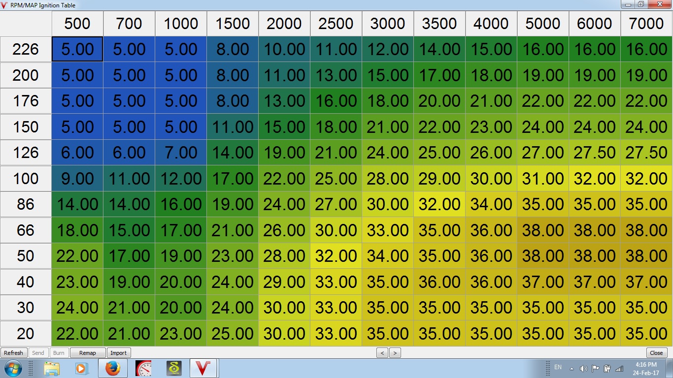

These are my ign timing and retard tables.
- MAT TPS IGN RET.jpg (422.13 KiB) Viewed 74231 times
- igntiming e85.jpg (451.36 KiB) Viewed 74231 times
That seems like a lot of iat retard and not a lot of timing in general. I was running more timing and less iat retard on pump which... Won't make much power for you on e85. 0 signs of det when the engine failed due to oil starvation.
Edit, see my revised table and the table that Chris posted. I can also post my timing table, I have it somewhere.

Keep in mind that the tables are for my AEB.chaloux wrote:That seems like a lot of iat retard and not a lot of timing in general. I was running more timing and less iat retard on pump which... Won't make much power for you on e85. 0 signs of det when the engine failed due to oil starvation.
