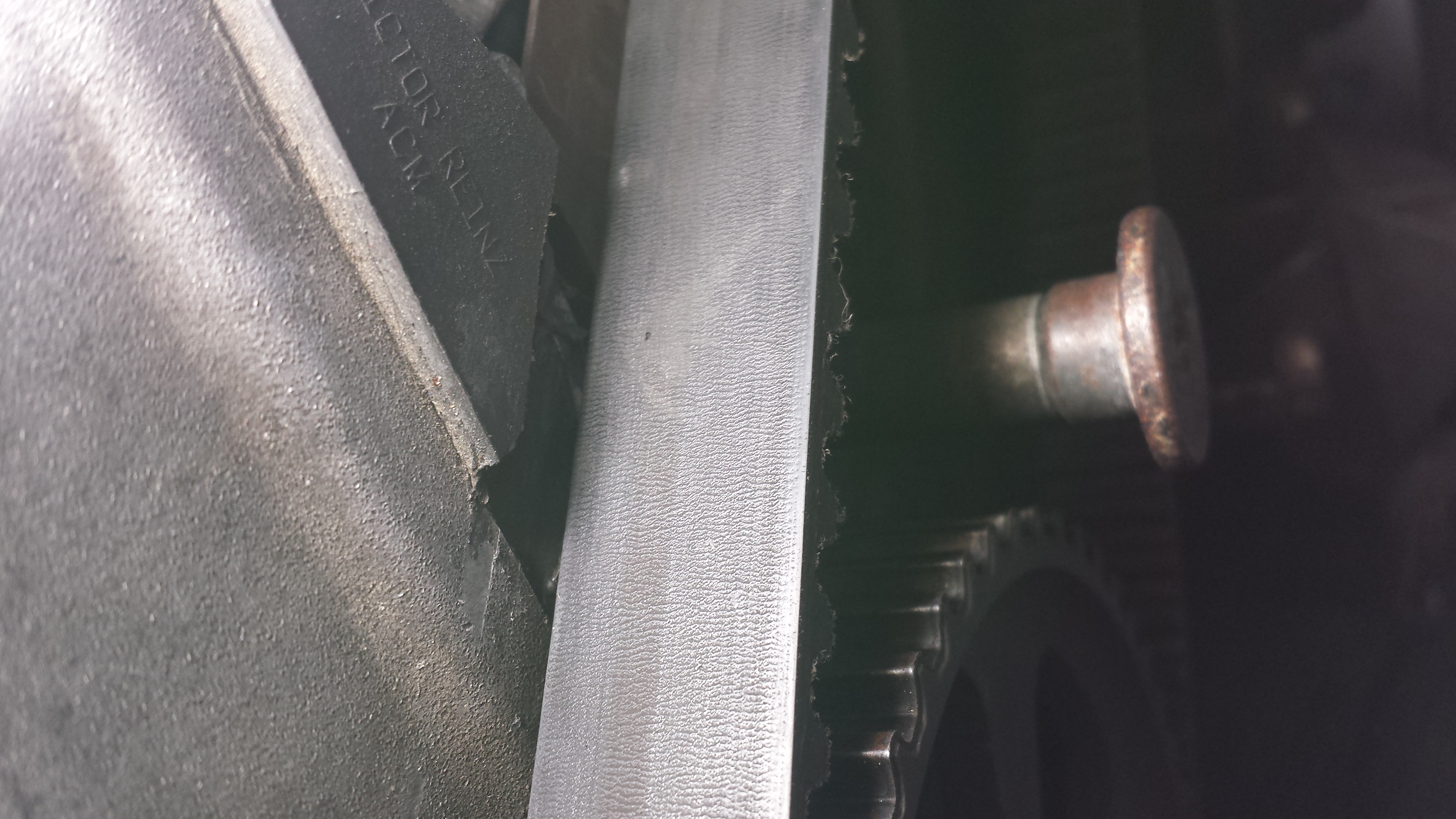

Posted: Fri Oct 09, 2015 4:37 pm
Is this wrinkly look okay?
Yes, that's a microscopic needle hole in just the surface of the T-belt.
It's probably got no more than 20k on it. Lol broken odo!

Valve seals are bad? How was that determined? Something isn't quite right for sure. What was done to it a year ago? I forget.
And yes that wrinkly look is pretty normal.

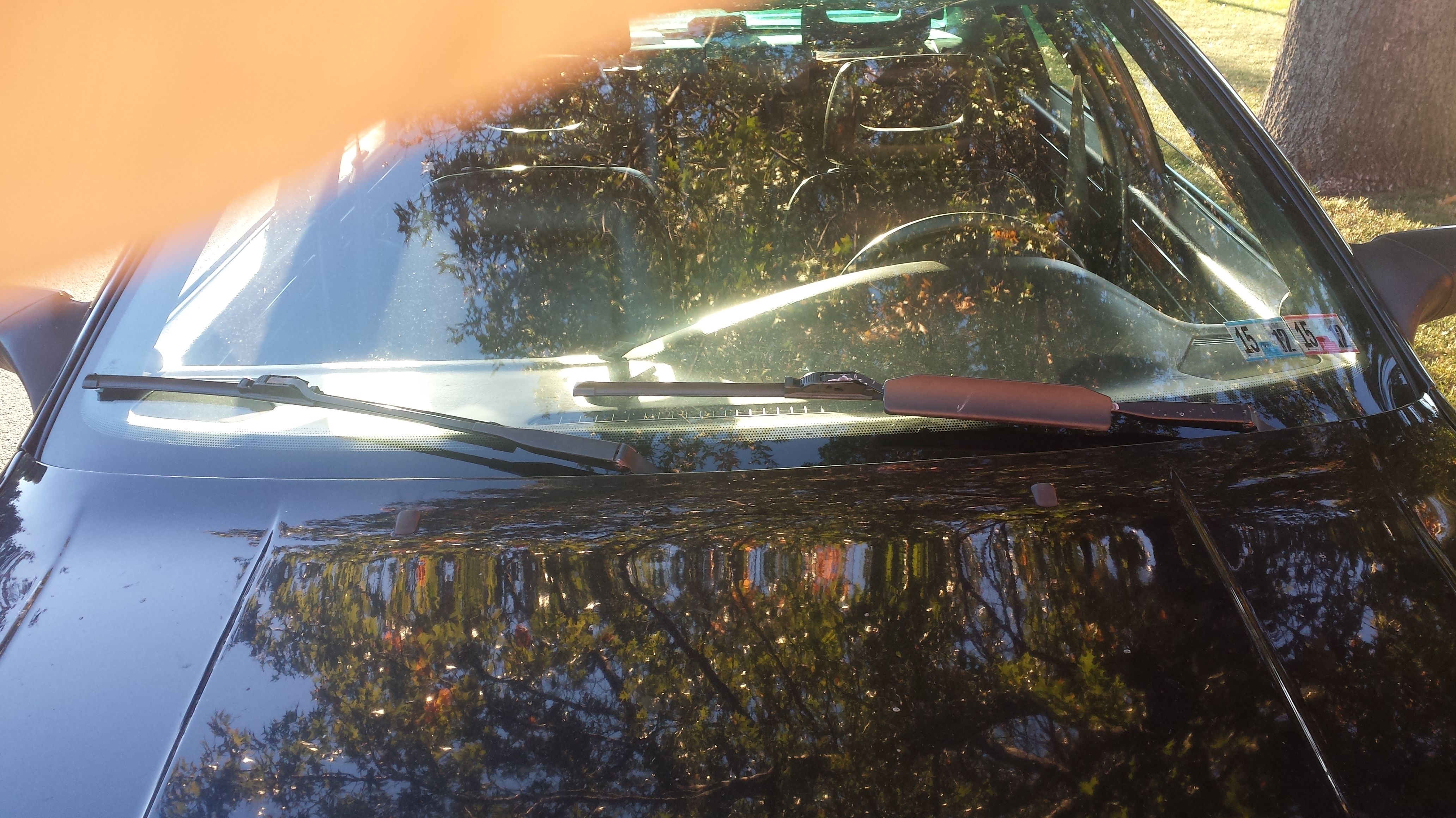

Is this about how low your guys' wiper arms are adjusted also? If I lower them anymore they get pinned under the hood. ??
My spare DS 5k arm is too low profile to even bolt in
Posted: Sun Oct 11, 2015 5:35 pm
Ha, I just had to adjust mine because of the hood thing too. The Bentley shows how far they should be from the black part of the windshield. Is yours aftermarket? It looks a little different than my windshield. Anyway, I will post a picture of where mine are. (Damn the animal that got my hood dirty out at the rig!)
Posted: Sun Oct 11, 2015 5:40 pm
Here
