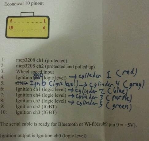

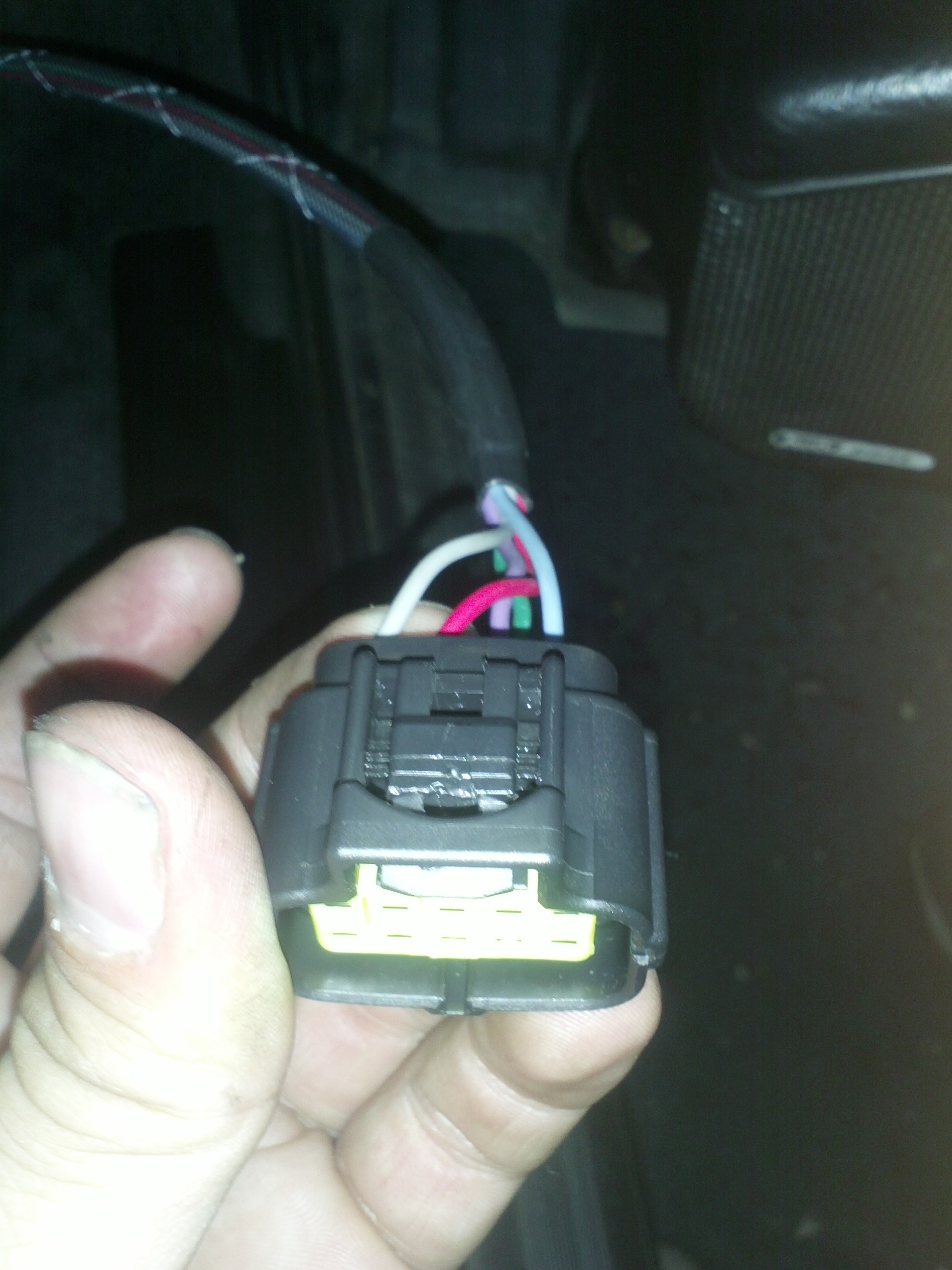

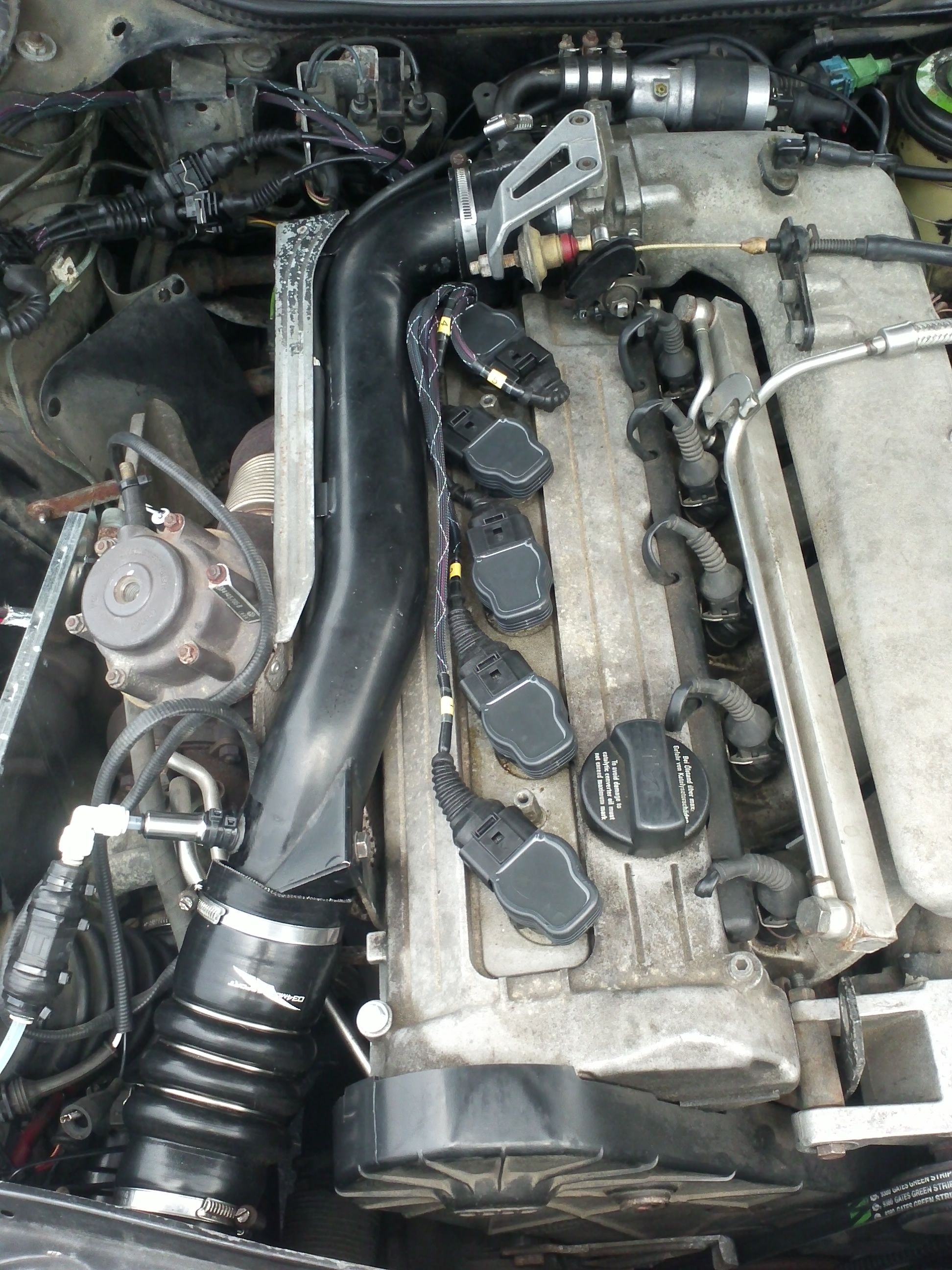

I connected everything for COP including installing coils over old plugs until its up and running. I'm confused on this 10 pin plug on the interior end of the 3B COP conversion harness though. I only have like 5 wires to populate it with but the strange part is that I don't see anywhere in the pictures or reading about the PNP ECU having a 10 pin plug. Not sure what i'm plugging it into. The other thing i'm wondering about is the conversion harness has 2 3-pin connectors with only 5 pins populated between the two of them whereas the ones they connect with have all 6 pins populated. I think I read that their order doesn't matter since they are just power supply wires for the 5 coils?? I connected them up anyway. Apparently, I'm only supposed to leave the original huge 3 pin connector for the factory coil unplugged too.
- IMG_20140802_142324.jpg (1.23 MiB) Viewed 65247 times

I'm pretty well convinced I wired the wideband right since the calibration went off with out a hitch. Here's a better picture of instructions.
- IMG_20140804_203937-1.jpg (26.09 KiB) Viewed 65131 times
