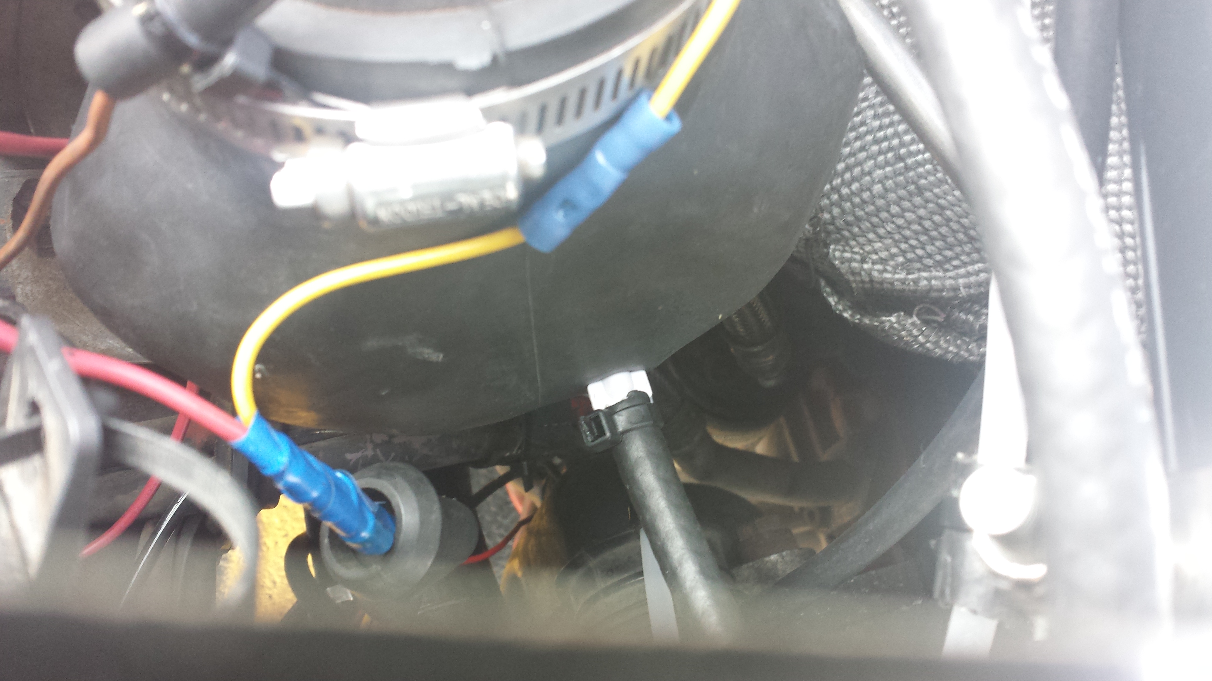

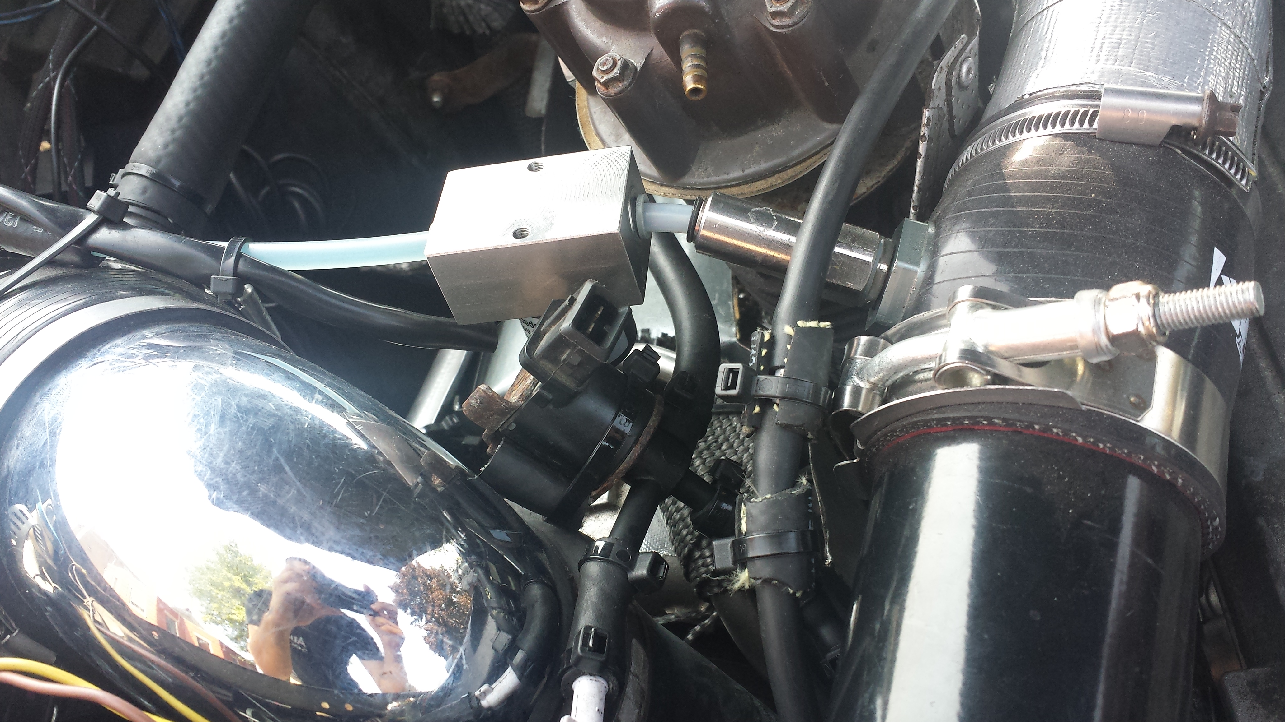

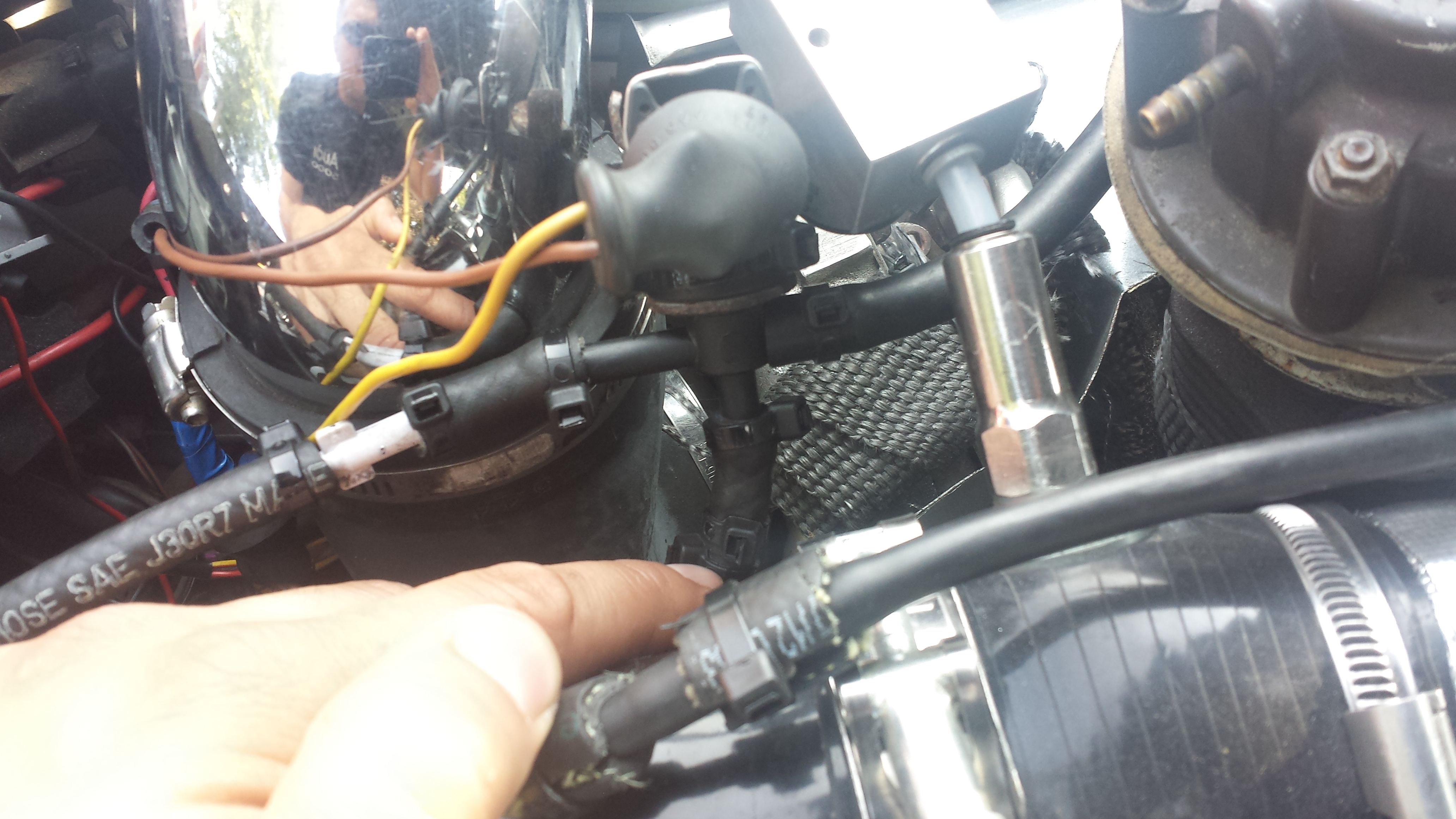

Posted: Mon Sep 07, 2015 10:32 am
Alright in the picture I'm pointing at the restrictor in the boost reference line. The right port is the "vent" line that goes into the cobra elbow. The left port goes directly to the bottom WG port. The 2nd shot shows where the vent line is press-fitted into the cobra elbow.
The electrical plug is facing the camera in the first shot.
One last shot unplugged:

It be worth noting that my wiring for the n75 only looks suspect lol. It's fully functional. I don't think polarity matters, but that's also correct. When I went back to the n75, I grabbed the one that completely prevented air leakage from the vent port. The other had a very slow and minor leak. That's all I can think of that's pertinent.

Dude! That's a real special setup you have going there haha.
From your description "The right port is the "vent" line that goes into the cobra elbow. The left port goes directly to the bottom WG port." and based on the picture, it would appear that you have the vent line and wastegate line backwards. The long tube coming off of the N75 is for venting. The short one coming off of the side goes to the bottom of the wastegate, and the bottom port is boost reference which you definitely have correct.
If this is not how you have them arranged, then do yourself a favor and get rid of that restrictor (the N75 already has one built into the bottom port), buy new vacuum hose so you can get rid of a few of those zip-ties (lol) and hook it up per my recommendation above. Bottom to compressor or intake manifold, long side port vent to atmosphere, and short side port to the bottom of the wastegate. Vent the top port OF THE WASTEGATE to atmosphere (which it looks like you are doing already).
And yes lol the wiring does look... special... but I don't suspect that it is part of the problem either.

DOH!! Sorry, I reversed them when I typed it. Short RIGHT port goes to bottom WG. Long LEFT port is vented to intake elbow. Sorry, I learned my rights and lefts yesterday lol.

Thanks Dave. That's a great illustration too. I used the one on Scott mockery's (sp?) site when I reverted back. Yep all that stuff looks good.
