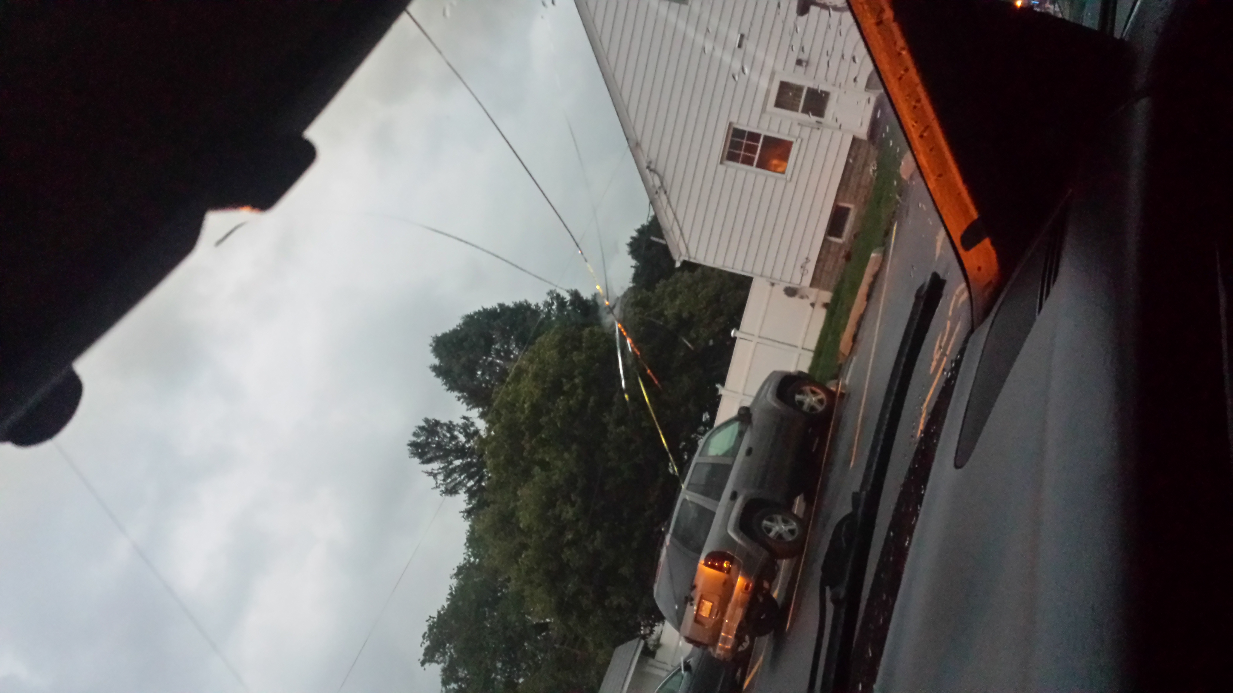

Another beauty shot
Everything all the time... my cell bill is due in 4 days, I need gas, I didn't put the 5k's shifter back in, it's freakin battery is f#cked even with it being on a float charger for a month lol, my data plan only has 100 mb left until Sept 7th bahaha, and my insurance payment is due on the 5k end of month. ;) Heartbreak is all relative

When it rains, it poor's! I'd say your about flooded out!

I was nitpicking on those things. At least they're routine problems.
Now for the potatoes of this whole thing. Am I going to have to search the earth for a replacement windshield? NLA?

Safelite had one in their warehouse. Everyone in the office that heard the p/n asked "wth is that for?" Lucky me :)

Now I'm ju$t concerned about whether my chrome accent around the glass will be salvageable. BTDT's?
