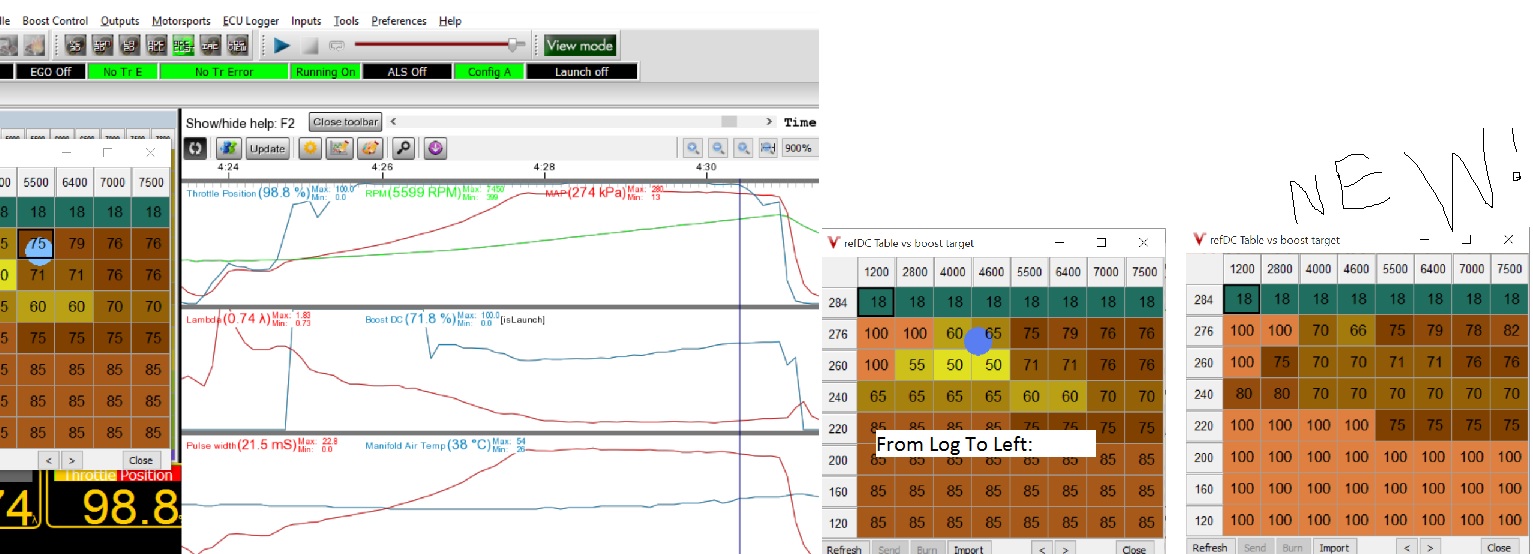

I don't think this is really related to your oscillation issue, but it probably doesn't help... look at your ref dc table and clean that up. It goes from ~45 to ~75 dc within one cell. That isn't helpful for boost control. You might want to smooth it out.
Looking more closely at your PID tuning, I can see the problem. It is DEFINITELY because of the "Apply max DC until" setting. It is currently set at -30 kPa. That means it will apply max duty cycle to the boost valve until boost is 30 kPa below the target boost (in this case 270 kPa). If you look at the log, this is exactly where the boost duty cycle drops off and your PID tune starts to kick in AND where your first oscillation is. Then, later where the boost duty cycle picks back up in value, its not because your PID is doing something. It is because your refDC table is requesting that value!
Your PID tune is essentially doing nothing lol. It is, for the most part, applying your base ref DC values. This is because your PID values are so small, they are essentially zero. You need to get rid of this 100% bs for a while and get your PID settings on point. Then you should fine tune with these auxiliary settings.

Alright, I've met you half way lol (or is it a 1/3rd of the way close?? 60% closer?). I reduced that 100% until bs to -90 kpa :D
Some tweaks to my table and here is the first guess's log and what changes I made according to the data.
I also increased I to 10 haha. I say haha because apparently I'm showing my age when I type lol :nuts:

To be honest man, I think you're focusing on that refDC table way too much. You're getting the results you want roughly, but you're kind of defeating the purpose of having PID at your fingertips. You can tune every single cell in the refDC table and turn PID off and get roughly the same result as you can with Just setting refDC to the same number across the board and letting the PID controller do the rest of the work. The latter method just takes less time.
Either way, it looks like you're pretty close to where you need to be for now. It's just that when the weather changes, your system will not be very robust because your PID controller still isn't doing almost anything. You have to give it more control authority. Do you see what I'm saying here? You're relying almost entirely on the refDC table and that's not robust.
I think tomorrow your new, higher ref DC values at the lower RPMs will make the car overboost and you'll hit boost cut. P, I, and D will probably have to be higher to counteract that. If it were me, I'd put like 60% all the way across the refDC table and tune the PID controller from there.
