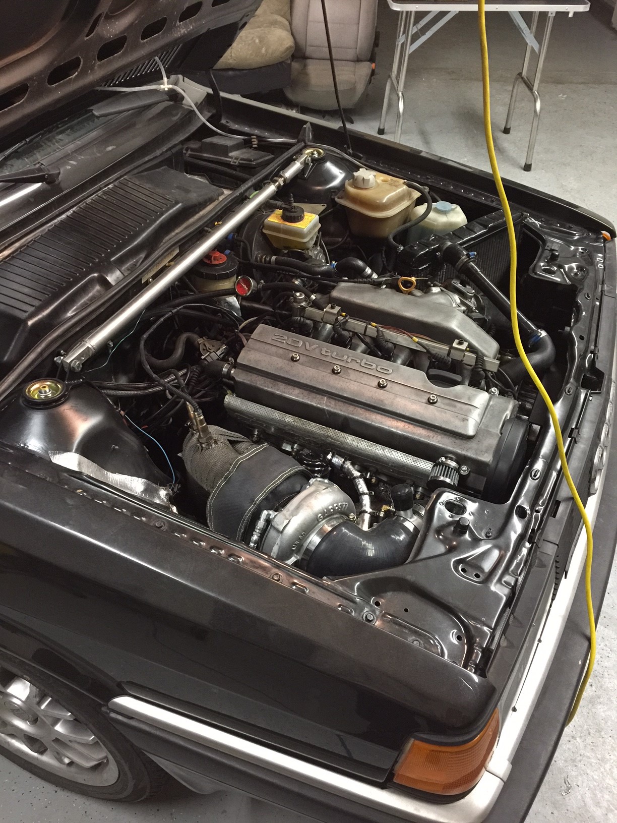

Apprently since my last post I have gotten some stuff done.
3b swapped a 4K we brought back to life just prior to the owner junking it.
Swapped out the old grey cloth with some Quattro script we found in another car about to be junked as well....
Then we swapped the motor and did a Gt3071/RS2 EM/IROZ Exhaust ect... swap on my brothers S6 avant. The motor that was in it was done. Heavy scaring on #5 cylinder and pretty much all valves in the head were loose to the touch with major surface damage in all the domes.

Then I got up with Marc Swanson and had him write me a tune for a GTX 3071 on my S4000 while I pulled the 11c out and installed the Motronic.
I also added a much needed oil cooler and a much larger radiator.
Of course there were tons of hiccups from clutch/flywheel order fuck ups to a bad ECU but everything was eventually worked out.

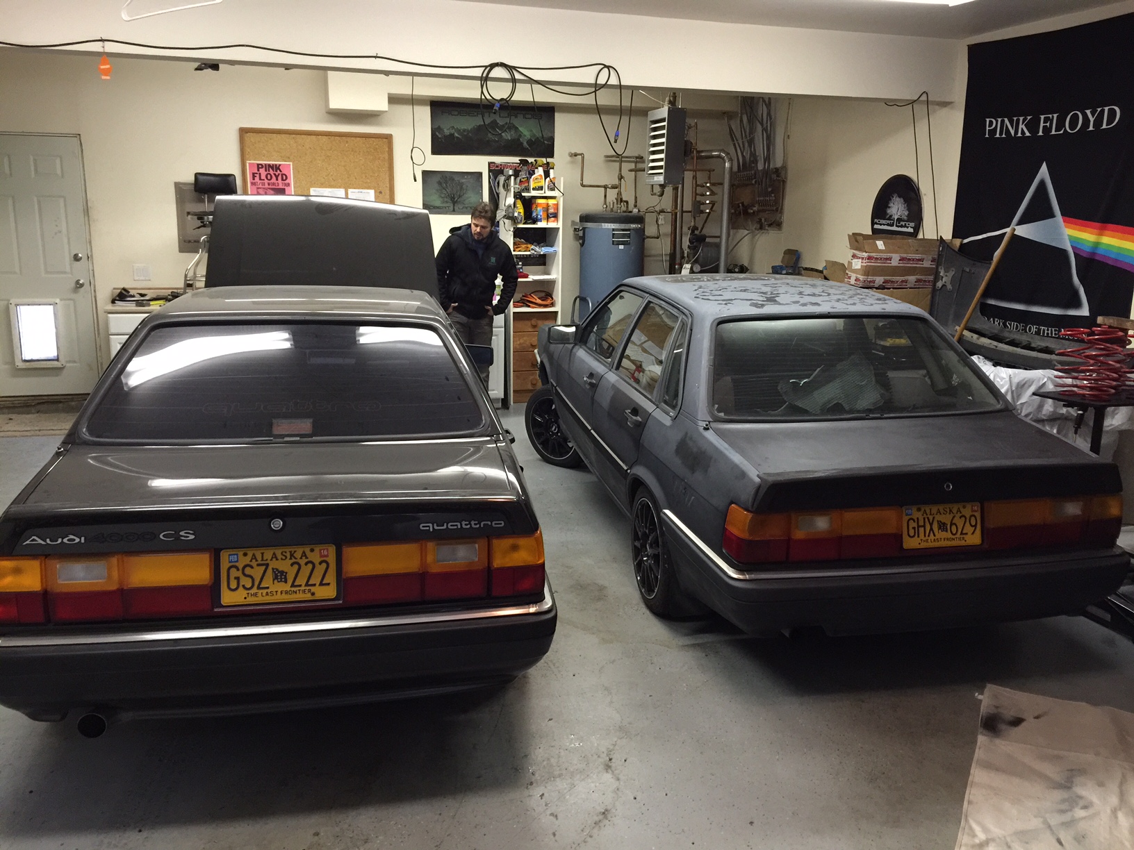

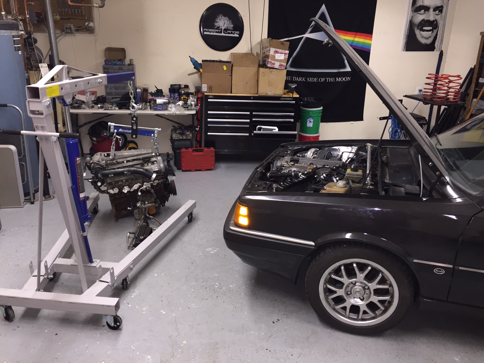

Started working on a little more tame (for now anyways) 4K AAN for the wife to drive :)
Anyways, this white 4K has about 30 years of grime in the engine bay. I've spent more time cleaning shit then actually building. Here are some pictures.
Brought it inside for the first time in a while. I finally got all the details dialed on the black 4K.
Pulled the old power horse out.
Lots of cleaning-not very fun but I did have Opeth and Tool to keep me company as well as some Neil D. Tyson and Joe Rogan.
That hood though....
Motor cleaning and assembly blah blah blah. Been done so many times at this point who cares. 07K's are the rage now anyways :)
