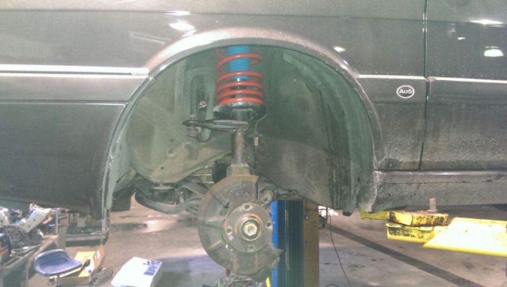

Suspension needed replaced ASAP. I hit one of these Alaskan frost heaves and destroyed one of the front strut. Probably original from 86. I have been reading about MC1 swaps all the way back from 2000. I started talking to a buddy and we decided on the AAN or 3B. I also got rid of the hideous black BBS wheels at the same time. (Those came from the dealer, they are on the original sales receipt.)

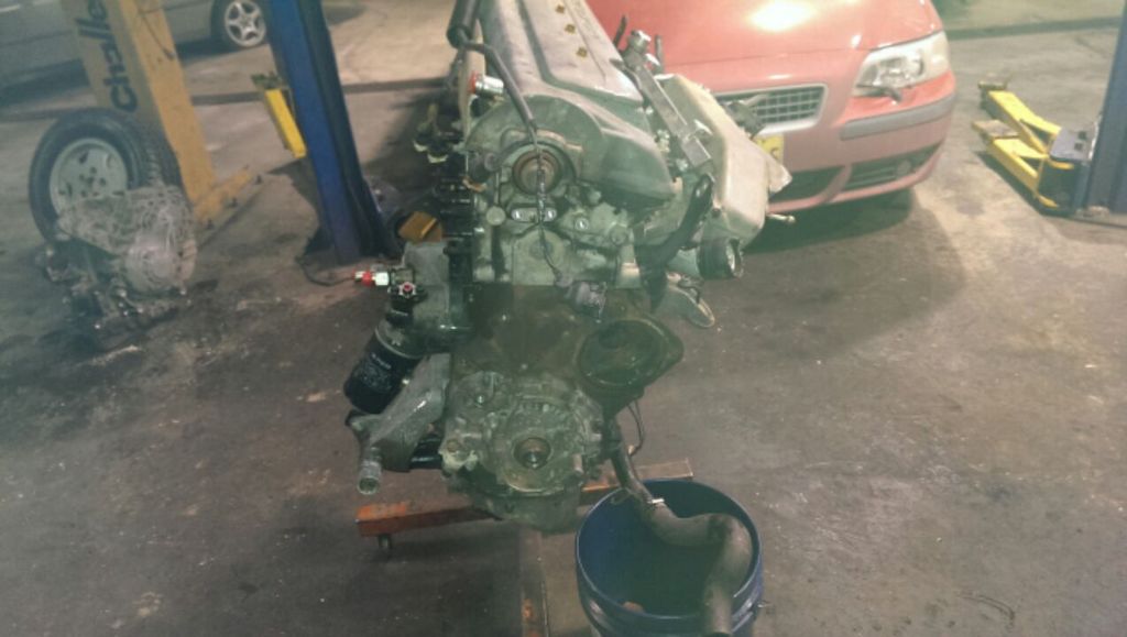

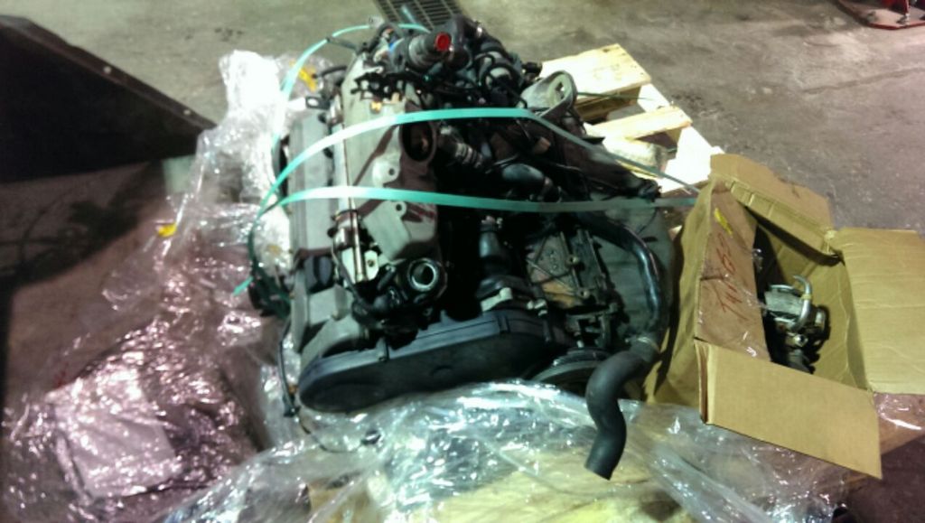

So I found an AAN in California with 100K. Bought it and shipped it.
AAN 1.jpg (88.83 KiB) Viewed 54902 times
AAN 2.jpg (66.37 KiB) Viewed 54902 times
AAN 3.jpg (75 KiB) Viewed 54902 times

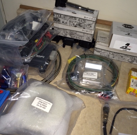

Once the motor got here I had to do a ton of research on what all I needed parts wise. So I ended up going 034 and went with the 11c ECU. I did have a major hick-up on the parts order. I was sent the wrong harness and coil setup among other things. 034 was really good about it and fixed me up.

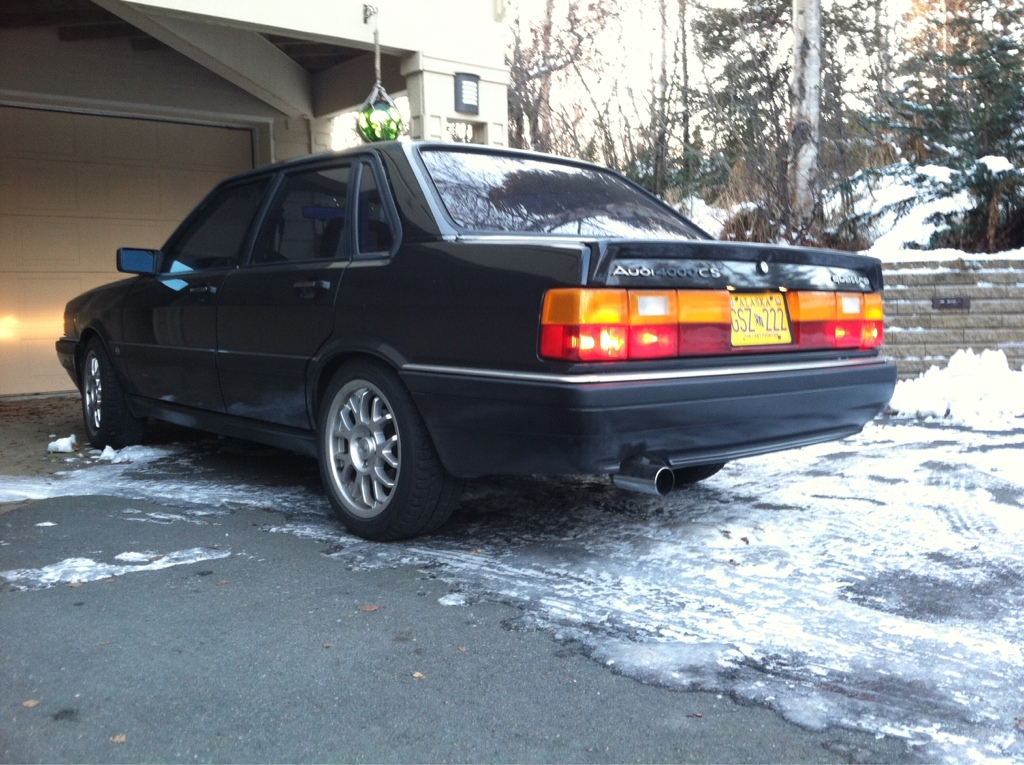

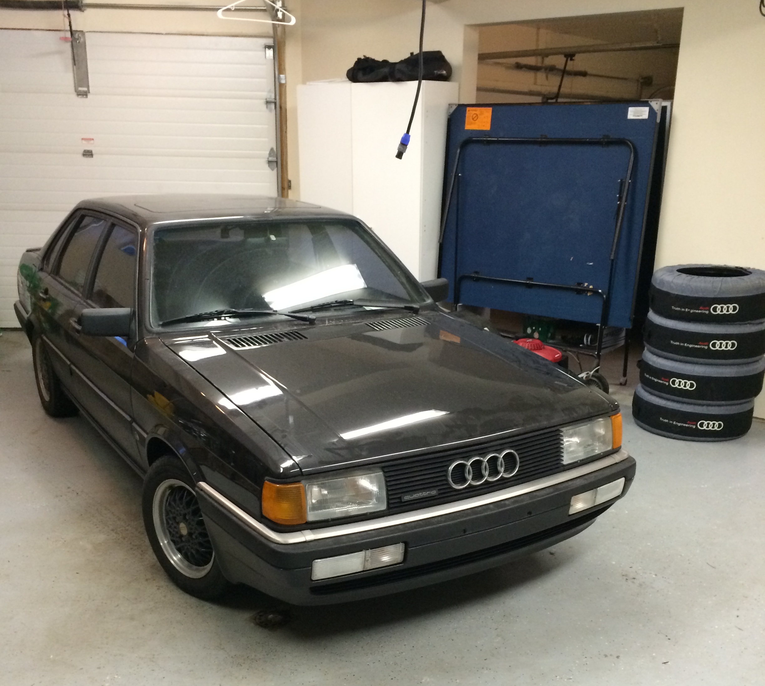

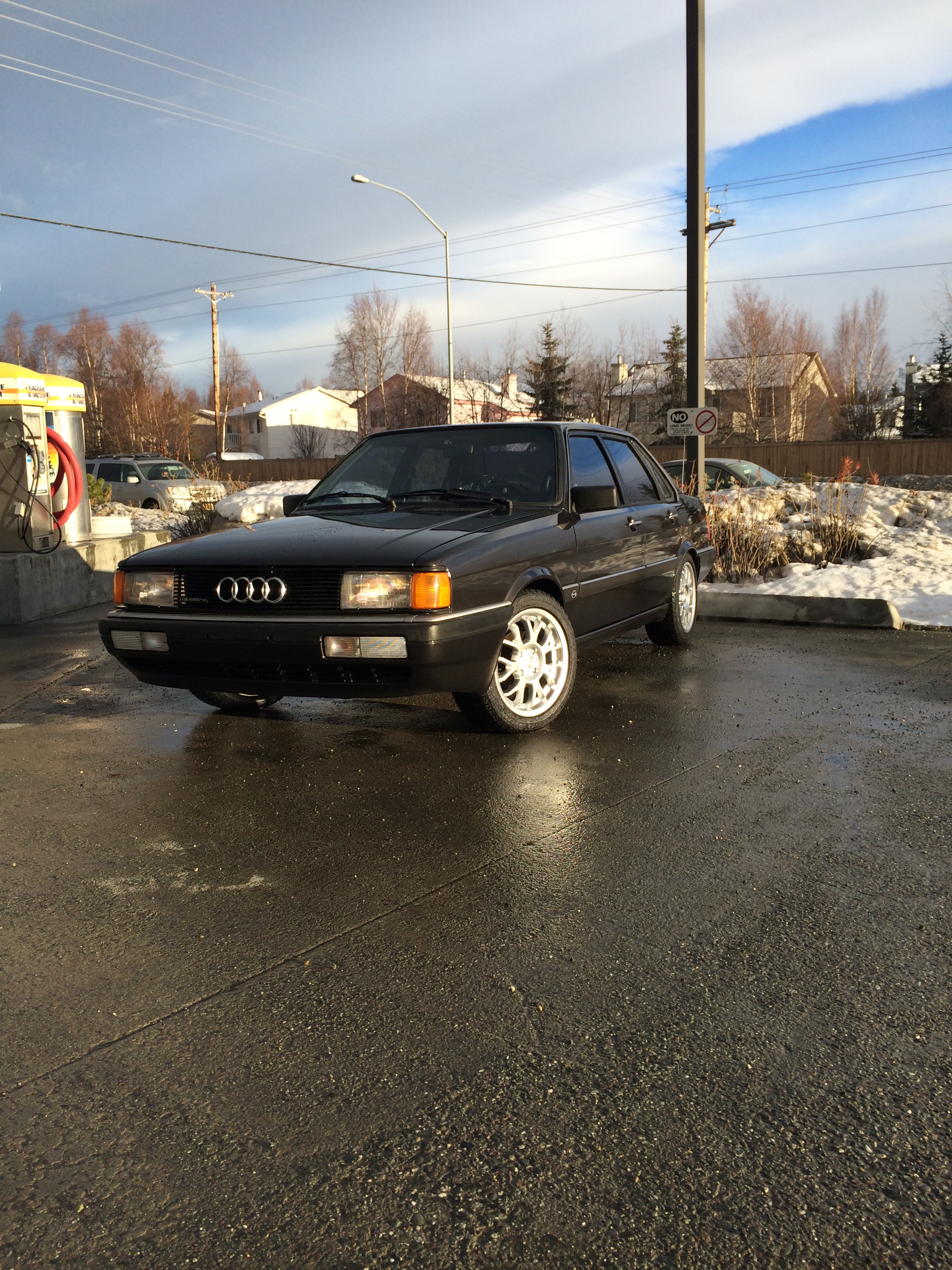

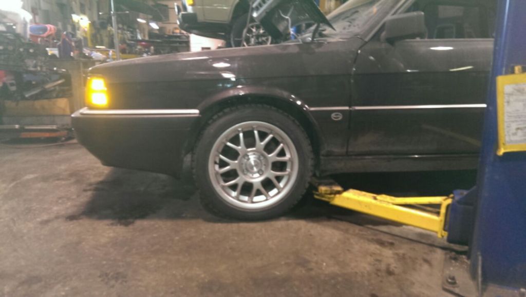

SO the car with the new wheels and suspension. Still JT'd
4k full shot 2.JPG (3.3 MiB) Viewed 54898 times
4k full shot.JPG (1.65 MiB) Viewed 54898 times

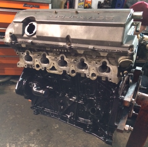

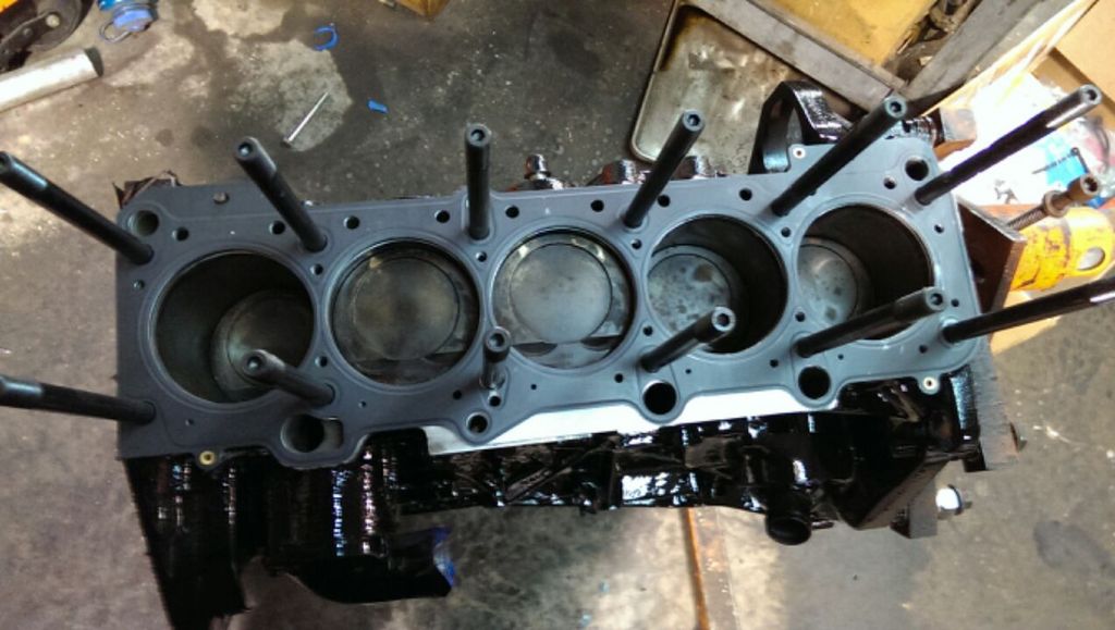

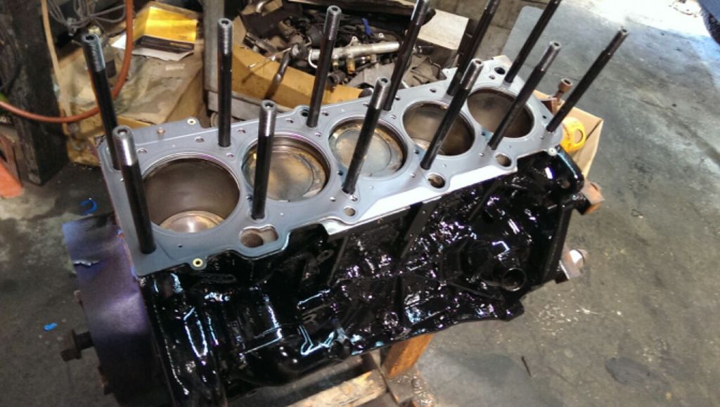

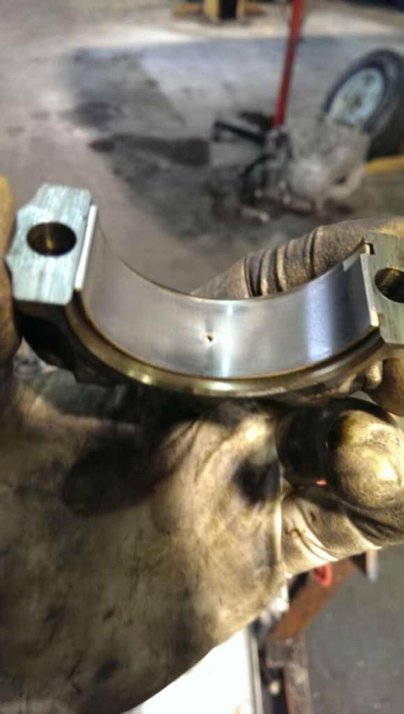

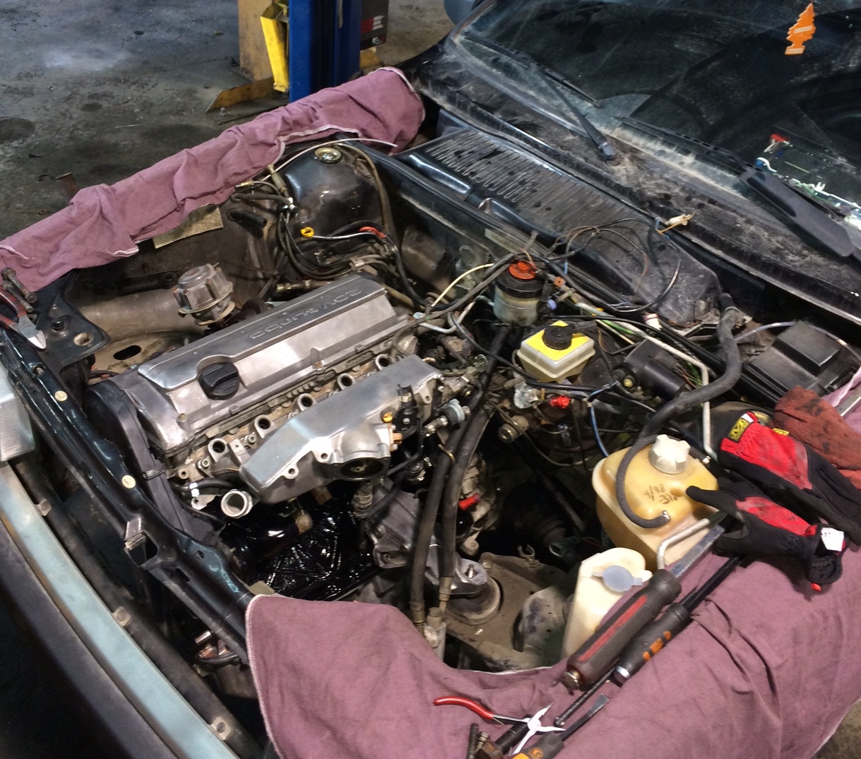

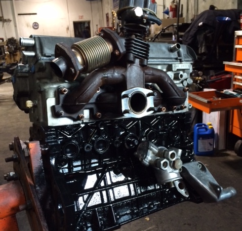

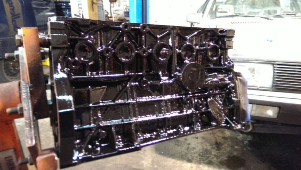

So then we did an inspection on the AAN and changed all the gaskets ect.
AAN Bearing.jpg (59.72 KiB) Viewed 54898 times

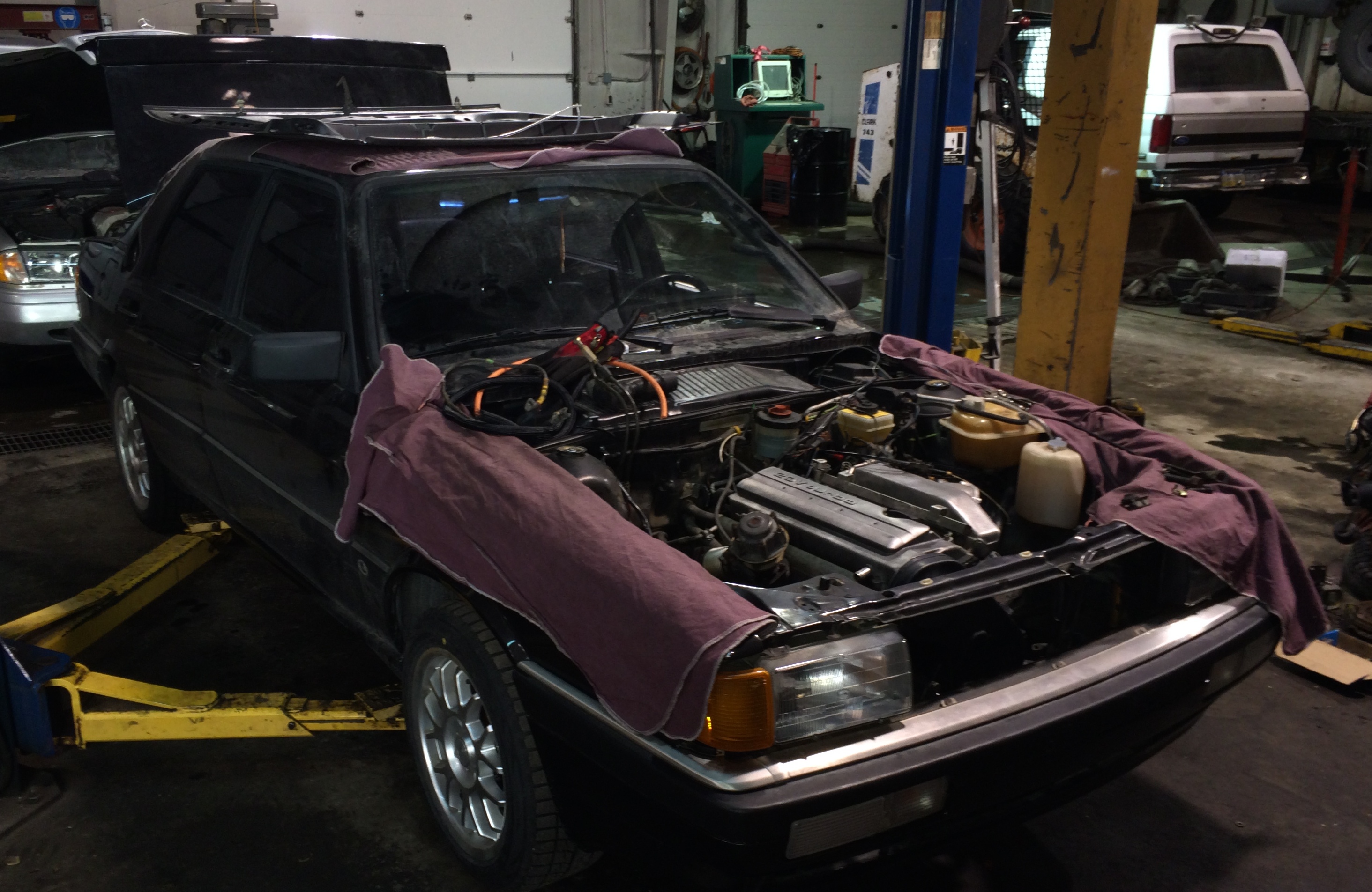

Then we pulled the JT. Nothing too exciting.
JT Pull.JPG (49.81 KiB) Viewed 54898 times
JT Pull2.JPG (31.62 KiB) Viewed 54898 times

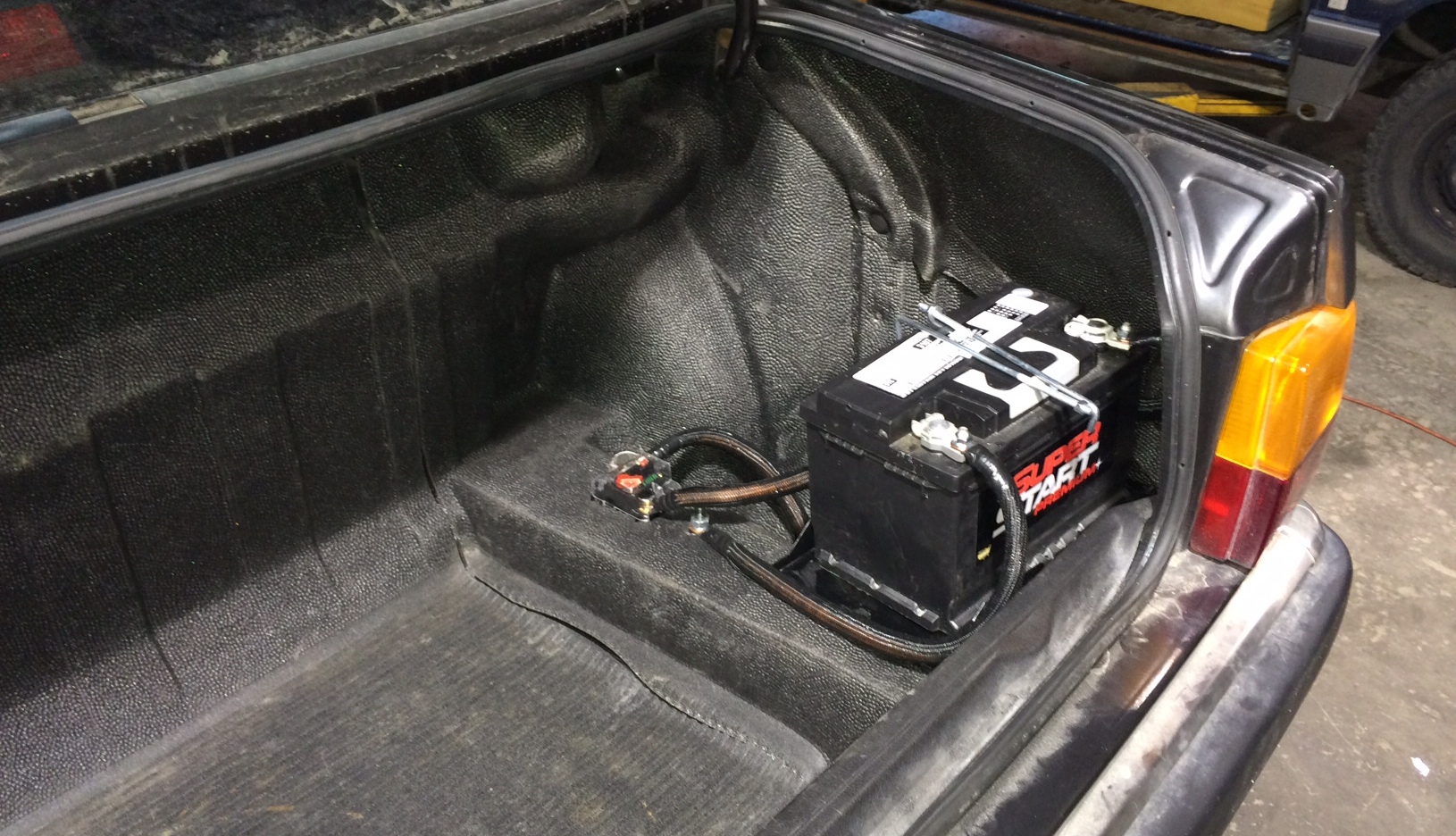

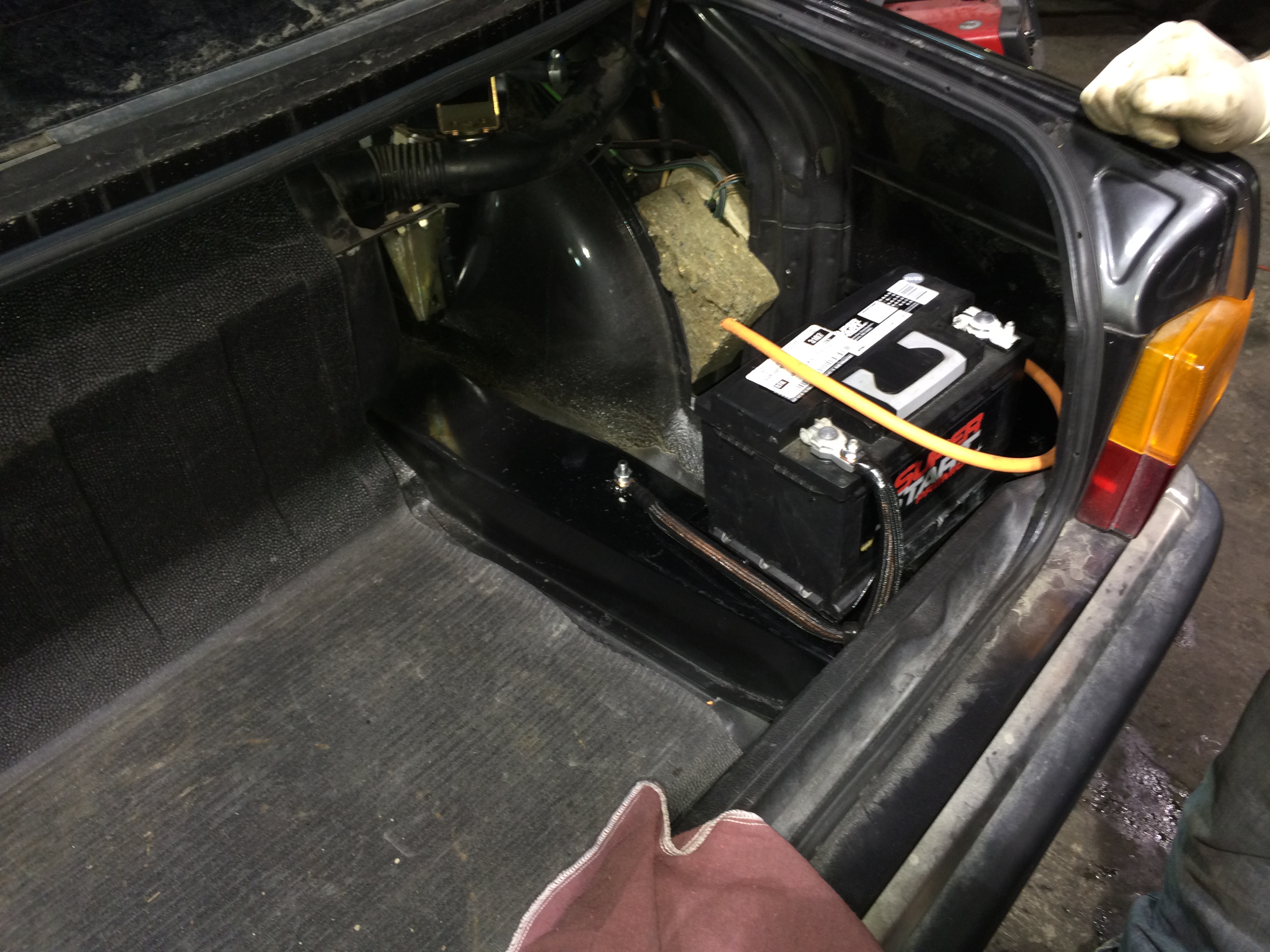

Then the battery relocation. Exciting

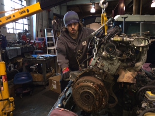

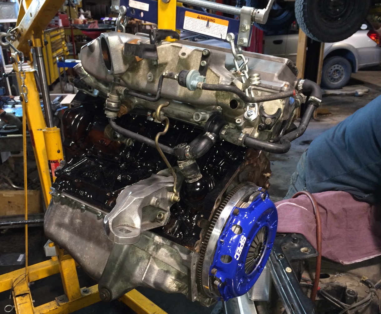

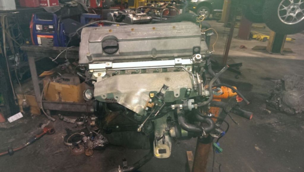

Then we got the motor put together; Clutch & Flywheel, Intake manifold, Exhaust manifold and Turbo ect...
That is a 016 Aluminum flywheel with a stage 3+ SPEC 016 clutch
Sean Haynes
Anchorage Alaska
Namreg Rac
Posts: 127
Joined: Mon Oct 06, 2014 8:33 pm
Re: Audi S4000 - Alaska
Post by Namreg Rac »

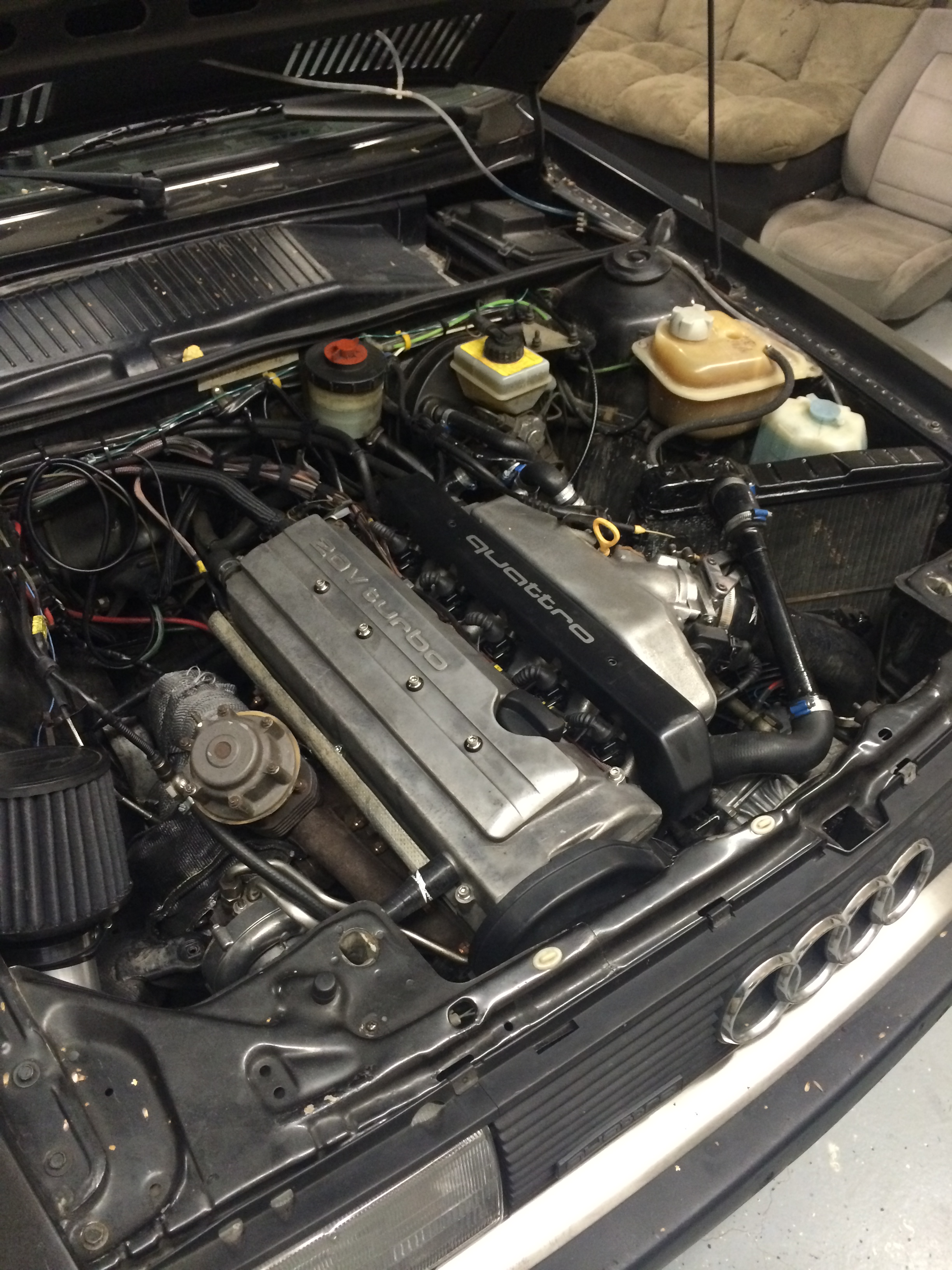

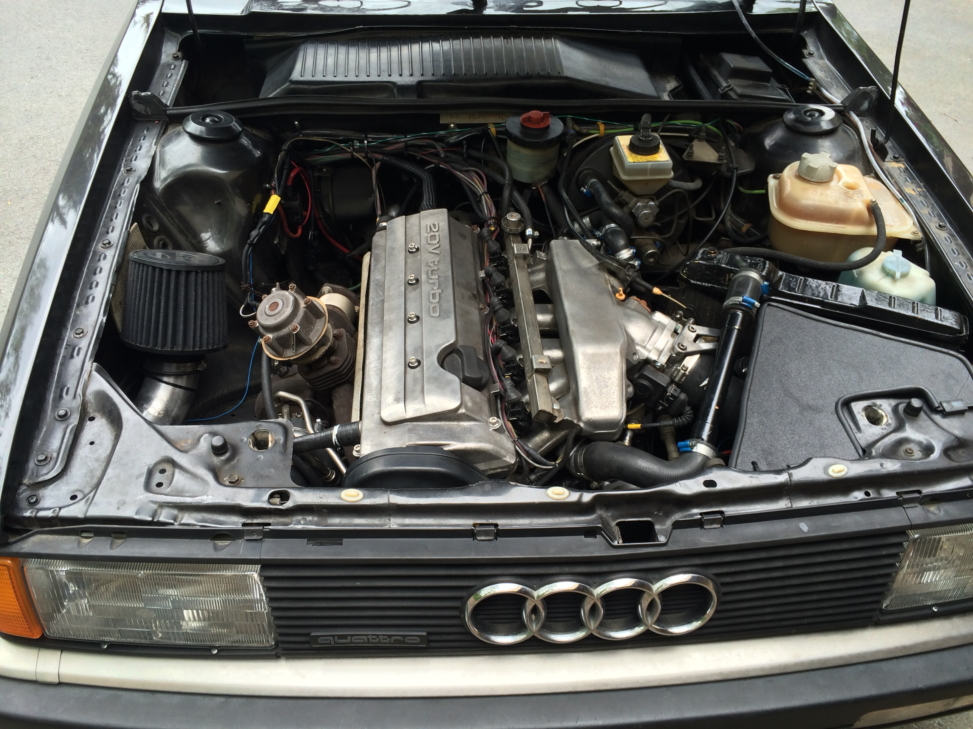

Then we put it in :) (Notice we didn't cut the front brace, just can't have the Crank pulley on)
AAN IN.jpg (423.51 KiB) Viewed 54897 times

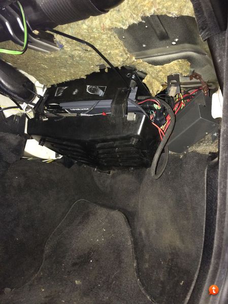

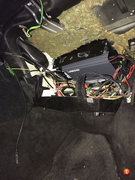

Then I ran all the wiring for the harness and made a mount for the ECU out of the shroud for the old AC evaporator.

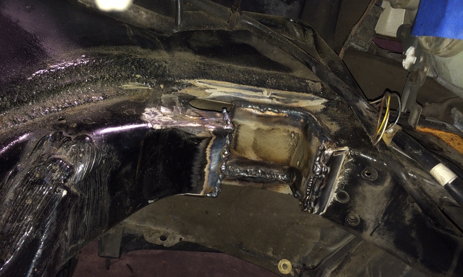

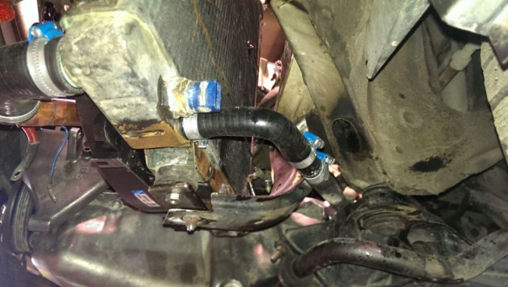

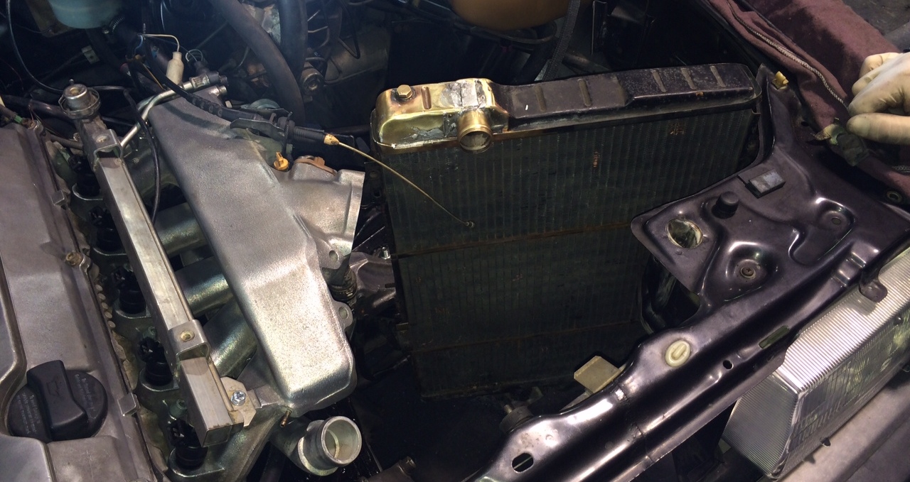

The radiator situation was kind of a conundrum. No big deal. We first cut out a portion of the Uni-body support frame to allow the radiator to articulate about 45 deg from the normal setup. We simply inverted the square "C" we cut out and re welded it in place.
RAD FAB 3.JPG (685.09 KiB) Viewed 54897 times

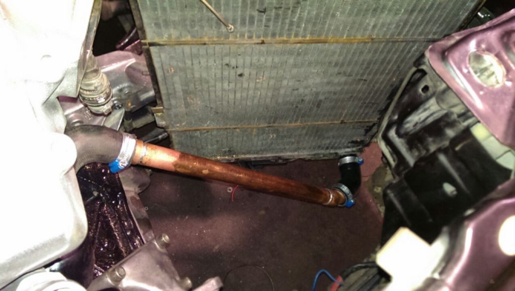

This cleared the throttle body. Next we cut the inlet and outlet of the radiator and re soldiered to more convenient locations. We used flat stock to cover up the old holes.
Rad Fab 2.JPG (330.96 KiB) Viewed 54897 times
Rad Fab 6.JPG (99.88 KiB) Viewed 54897 times
Some copper tubing which I later painted black. Of course
Rad Fab 4.JPG (89.62 KiB) Viewed 54897 times

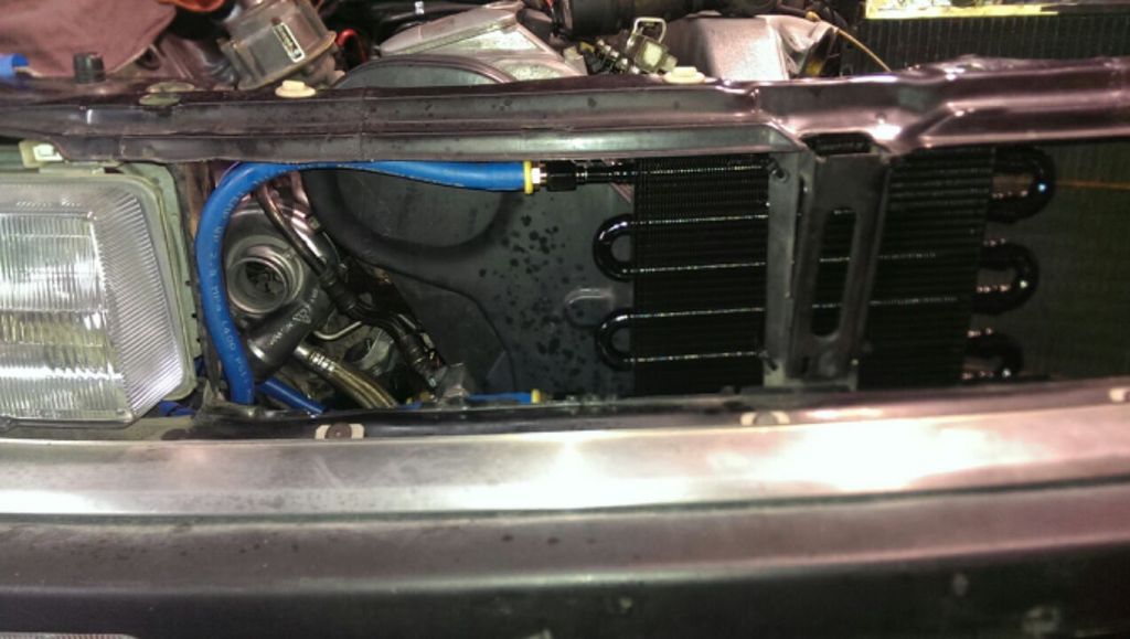

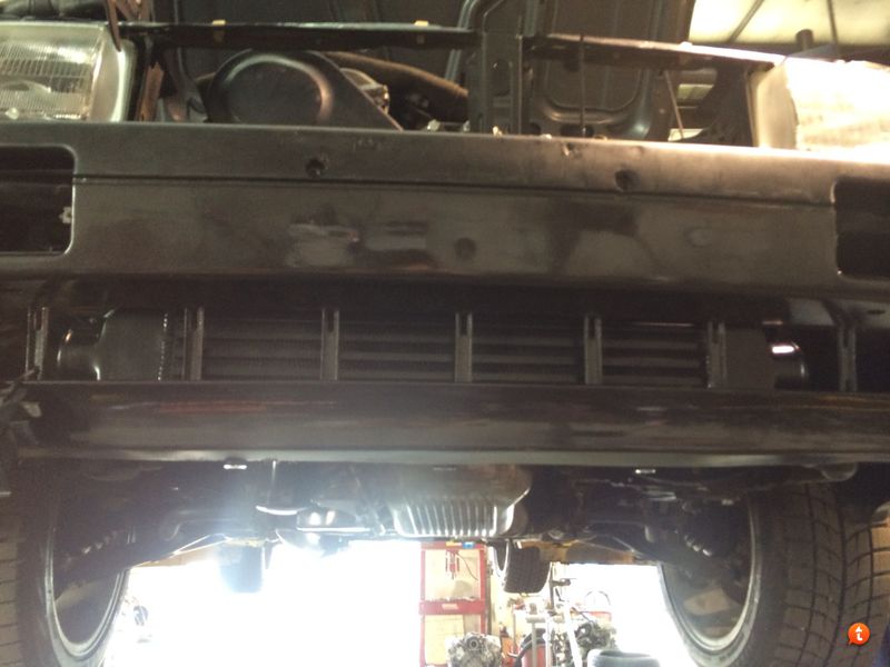

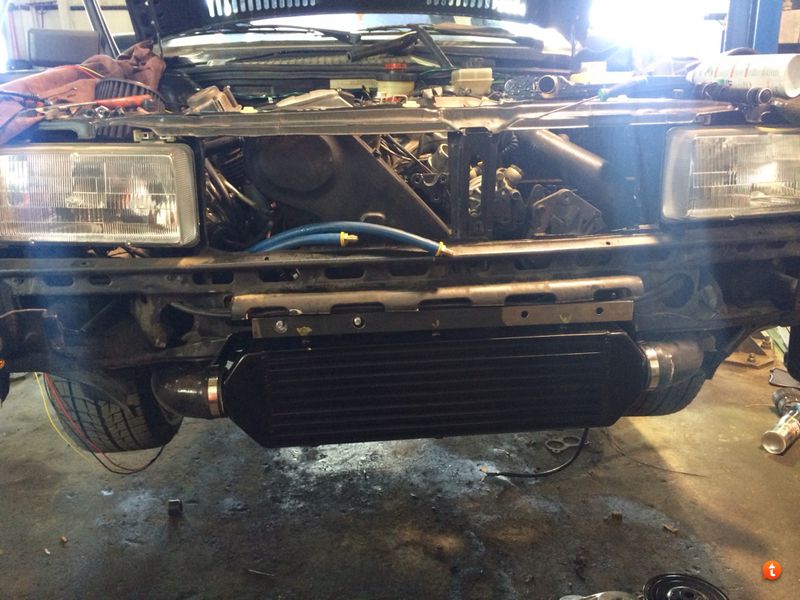

Then I tackled the intercooler. I ended up using the 2 snub mount bolts as the main anchoring point. After cutting some of the front metal out and some spacers, I got it to fit with the bumper and bumper grills. Not to bad.
Then installed the heavy duty NAPA oil cooler.

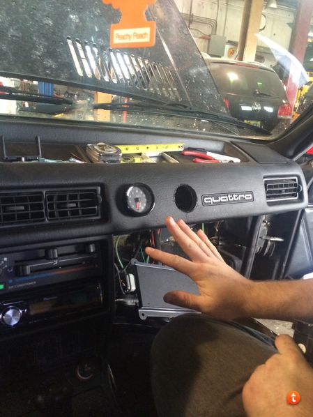

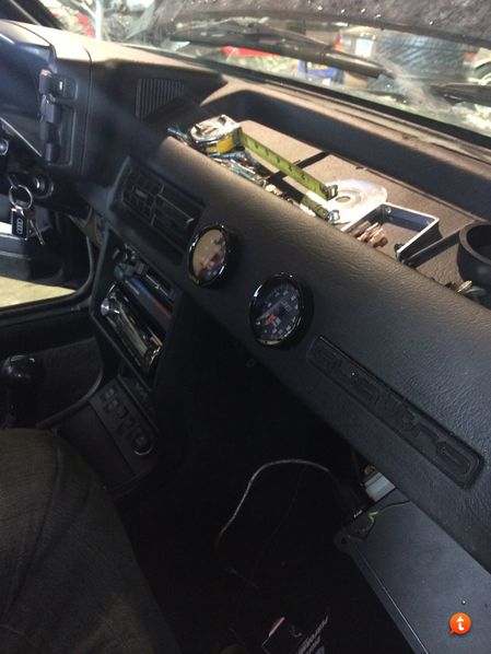

The most nerve wrenching part. Penetrating my perfect dash with a hole saw. Got lucky. I actually pulled a dash from a 4000 in a junk yard and practiced a couple hole prior to going for it. I screwed up 2 out of the 3 holes. Come to find they like it slow and steady as opposed to aggressive barraging. Those are boost and AFR gauges by the way.

So once everything was put together we started it up using the 034 tuning manual. The only AWD dyno in AK wouldn't help me tune it because the 034 ECU has no knock provisions. I don't blame them. It was a blessing in disguise. The 034 base tune was relatively good. After a lot of reading and internet scourging I became confident that I could tune conservatively on the street. Once I got it running good through as many street conditions I could on the stock boost levels I increased the boost.
From what I have read 17-20 PSI on a stock K24 is about it's max efficiency. So that's what I did. Man is the car insanely fun at 17 PSI. Thing has made long trips with out a single problem. This is how the 4000 should have been from the factory.

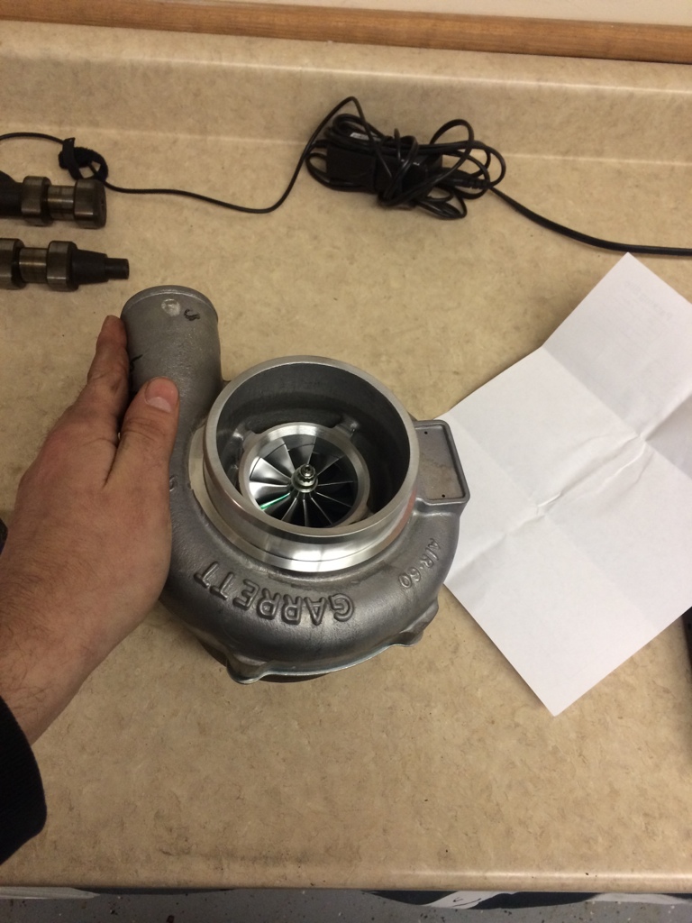

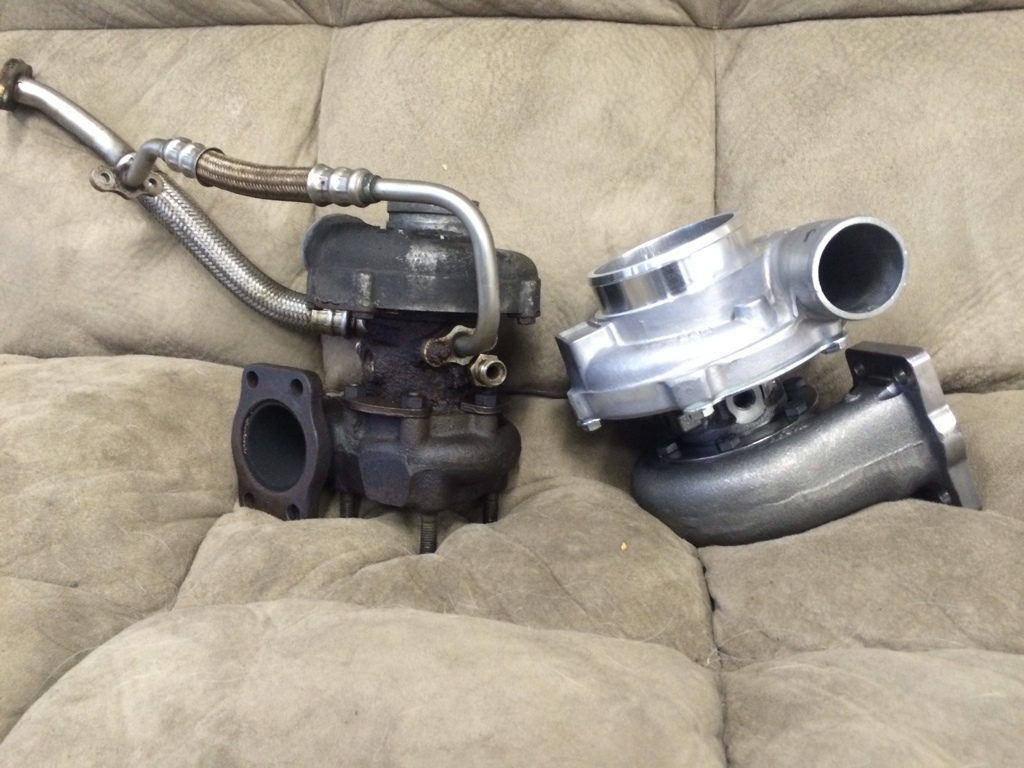

These are the upgrades I am rounding up at the moment. Should have everything within in 2 weeks.
GTX 3071 w/ 4" inlet
IROZ equal length exhaust manifold
IROZ down pipe
Tial 38mm wastegate
HKS filter
Compression lowering head gasket. (9.3 to 8.8)
Phenolic intake manifold gasket
Siemans 60lb injectors
Crank case ventilation catch can
Waiting on the IROZ stuff, I have everything else. Oh yeah, sent my ECU back to upgrade from a 2.5bar to 4bar MAP sensor.
More to come.........
