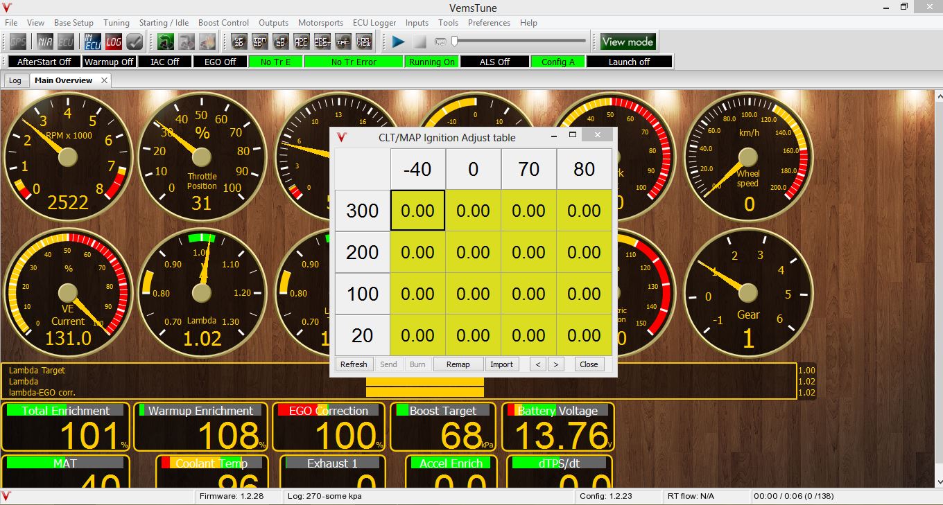

88a5tq wrote:Thanks a ton Chris. Truth is I'd be barely anywhere with this standalone without your educated assistance. Anyone who can't admit that is a dick lol. I absolutely didn't know about the coolant facet of timing :geek: Ready to learn!
I should clear up the IAT sensor and that it already is the 1.8t one. It however isn't Bosch brand. It's off of eBay and generic. Should I use it as a door stop?
Any time, happy to help! I just looked at your CLT table and it is all zeros, so that probably isn't the reason you're seeing power loss.

Also, good that you have a 1.8t IAT sensor. Do you know if it's calibrated properly?

Oh boy. All I did was start using the new OEM 1.8T table values as per Marc

88a5tq wrote:Oh boy. All I did was start using the new OEM 1.8T table values as per Marc
Do any temperature reading limit boost? I hit 268 kpa in one log.
OK, you should be good then if you got them from Marc.
Not that I'm aware of. Your MAT vs. Ign retard table is pretty aggressive though. Send a log when it's happening and we'll see what it's doing if anything.
