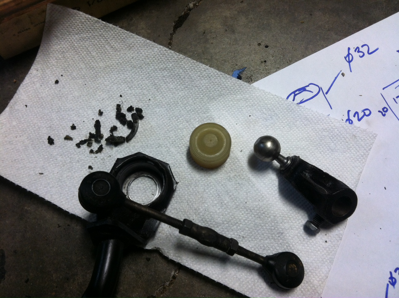

Good to see an update Mike! I'm actually dealing with shifter slop myself at the moment. Have you tried driving with the shift boot off? That might be more revealing as to what is clicking. There's a little room for a sloppy linkage in the cabin, but my bet would be the trans shifter bushing if it's still original.
If you get under the car, reach up on the driver's side of the trans and grab the gear selection rod that runs toward the front of the trans. It should be pretty fixed on the trans input shaft, but you may find you can shake it and there's a bunch of play. That'd be the bushing if that were the case.
I replaced my bushing with the 034 one about a year and a half ago, and I'm disappointed to find it disintegrated already. I may just get another, but I'm looking into either having one made from a more durable material, or replacing it entirely with a heim joint. I'll post up what I come up with if that ends up being the case for you.

I used white lithium grease to do my shifter bushing the 2nd time after it deteriorated with CV grease after 2 years. It's recommended for that material!

Depends on whether you still have the PROCON-10 bracket on the trans or not. Without it, it'd be a breeze! With it in place, the worst part is finagling the linkage out of there. Took me about 2 hours start to finish when I did it in January, with the majority being trying to get it back under the bracket. You could maybe do it on the car, but I thought it'd be much easier to pull it out of there, replaced the bushing and press it on the ball, then reinstall the rod. I can do a little write-up if you're interested!
Knowing what I do now, I think I could do it under an hour now. It's not too bad, other than the tight space. For the lulz, old vs. new bushing:
