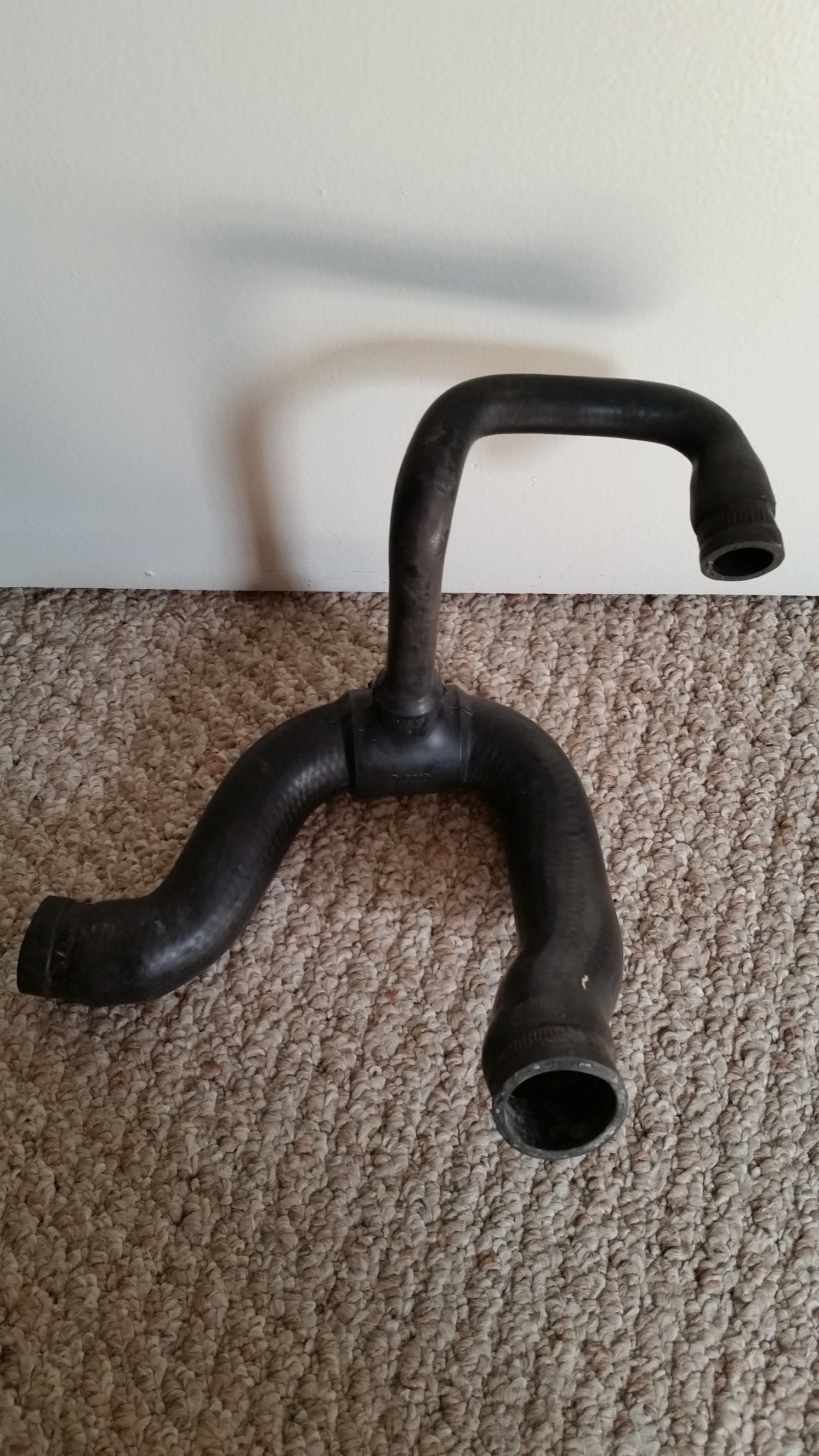

Mikey, is this a coolant hose you need? It is NLA, and I happen to have a mint used one. :D
World Impex use to be able to get them I do not know any longer. Last check they sold thru there for $137.
PN# 447-121-101-S Reg. OEM Audi retail was: $160 new
Let me know....I told you I have some things! Do you need wood trim?
