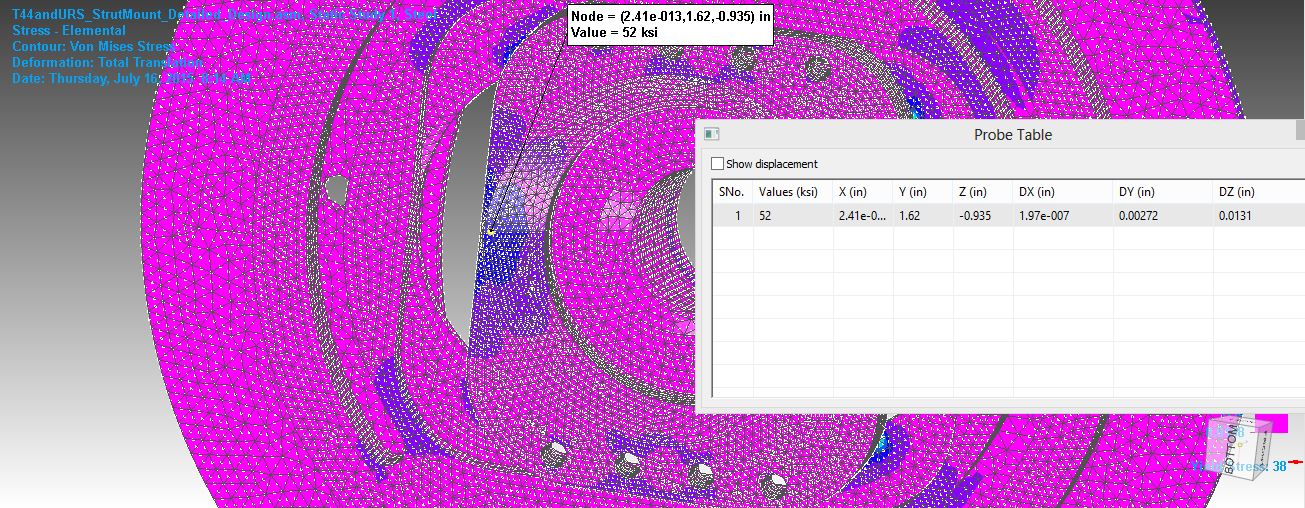

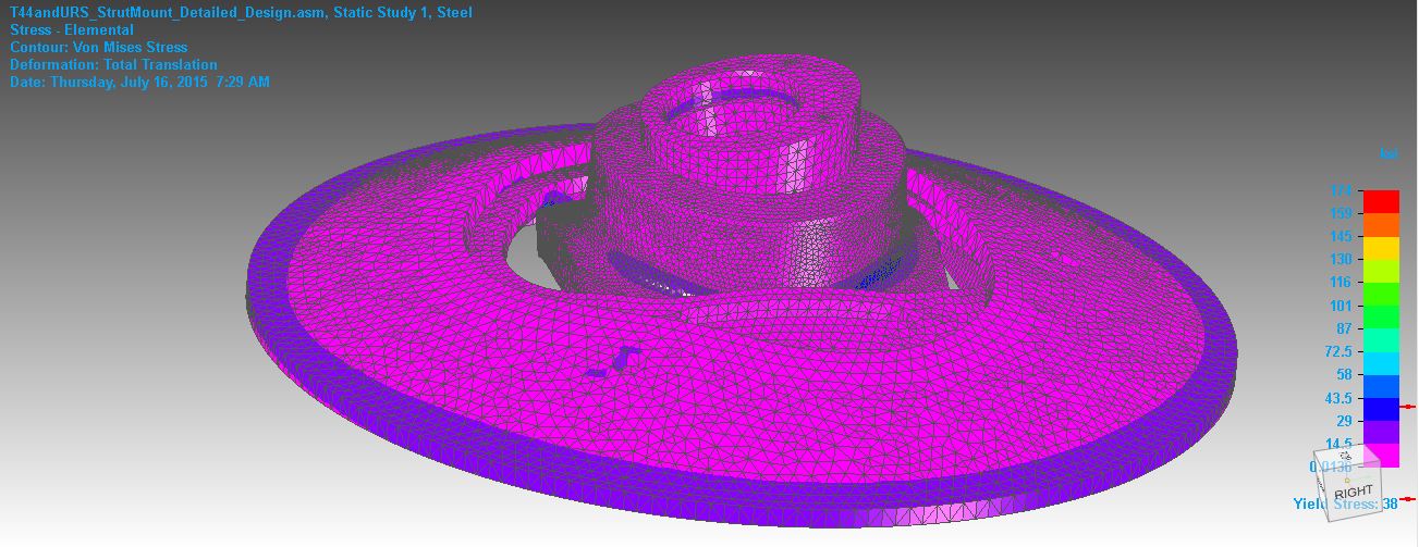

This shows the overall mesh and a general view of the Von Mises stresses seen in all the parts involved. Notice that the scale goes rather high... that is due to localized stresses in the model which are not "real."

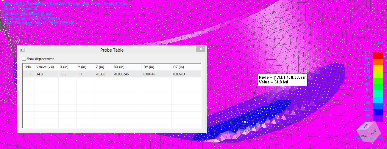

Localized stresses along the contact between slider and lower plate

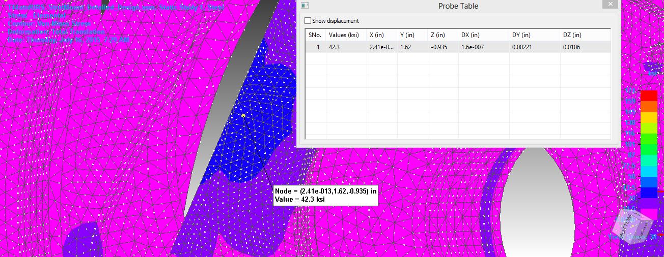

These are the two critical areas for stress in this design. This is the downfall for this type of design as opposed to letting bolts carry the stress from the top. You get a lot of shear and bending stress in the member which crosses the gap in the lower plate.
Slider radius stress
Slider top hat cut-out stress

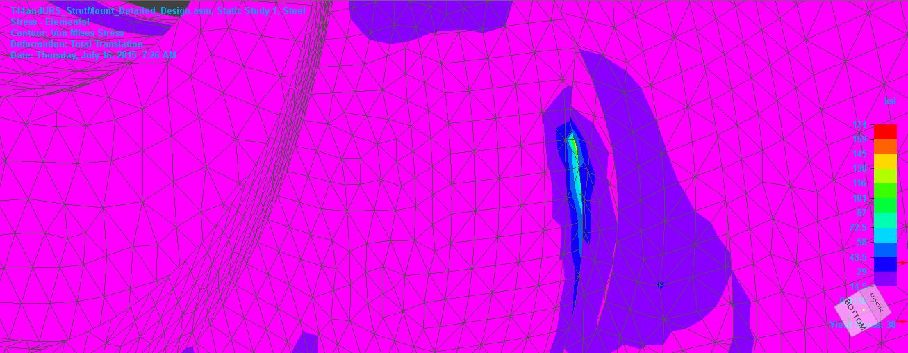

Just ran the analysis quickly for 8000 lbf. This is more than the bearing is rated for, and this is a stronger bearing than I used in my previous design which I tested thoroughly by bottoming out the car one too many times haha! The previous bearing was rated for around 6750 lb axial load and I was told by Hoerr Racing that this is a very commonly used camber plate bearing in motorsport. So if you break these mounts, you probably jumped the car off of a cliff! :D
This design should keep the material within it's endurance limit under any normal driving conditions ensuring no possibility of fatigue failure unless you bottom out the suspension HARD thousands of times!
Slider radius at 8000 lbf load
Slider top hat cut-out at 8000 lbf load

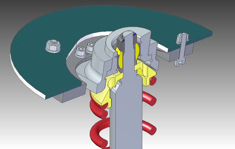

That looks like an awfully low clearance between the hat and the mount...are you sure there won't be interference there under compression?
I agree the bearing housing should remain self-centered based on directional suspension force, but I'd look into adding a set screw or something to keep it in place. Also, is there a circlip or something planned to keep it from moving downwards? I see a groove there?
Posted: Fri Jul 17, 2015 7:29 pm
EDIGREG wrote:Yeah, I have been on vacation and forgot to ship those to you prior to leaving. I figured at this point they wouldn't be of much help to you.
Yes, there will be a circlip on the bottom. The problem with any indexing feature like a set screw or a key is that I'd have to have them in several places on the "slider" part to account for different castor angles.
The clearance between the hat and the mount has been calculated very carefully. Remember, this is an engineered part, not an "engineered" part. I'm coming from designing jet engine parts with clearances down to the gnat's ass :D There is clearance in all positions. It gets closest at full POSITIVE camber. It still has clearance there, but I haven't truly accounted for the few mils which might be taken up by compression of the mount. That is one reason it's so thick in the area which would affect that clearance, but if there was an issue at full positive camber, a simple washer or a sleeve with a slightly thicker shoulder would be the only thing which needs to be changed. I don't foresee any issues, but I have definitely designed it so that it is easily fixed if there is a clearance problem in any condition. :beer:

loxxrider wrote:The problem with any indexing feature like a set screw or a key is that I'd have to have them in several places on the "slider" part to account for different castor angles.
Why? You don't need the threads to go into the bearing housing, just have the set screw drilled through the slider and press onto the bearing housing (or cut a small channel into the bearing housing for it to ride in).
loxxrider wrote:The clearance between the hat and the mount has been calculated very carefully. Remember, this is an engineered part, not an "engineered" part. I'm coming from designing jet engine parts with clearances down to the gnat's ass :D There is clearance in all positions. It gets closest at full POSITIVE camber. It still has clearance there, but I haven't truly accounted for the few mils which might be taken up by compression of the mount. That is one reason it's so thick in the area which would affect that clearance, but if there was an issue at full positive camber, a simple washer or a sleeve with a slightly thicker shoulder would be the only thing which needs to be changed. I don't foresee any issues, but I have definitely designed it so that it is easily fixed if there is a clearance problem in any condition. :beer:
I wasn't questioning your engineering abilities and it's not a matter of dealing with small tolerances. I realize you've designed it to have clearance in all positions while static, I was referring to the increase in positive castor that occurs when the suspension is compressed. Unless you've modeled the full sway bar/control arm/strut assembly for simulation, or measured those angles in real world scenarios, then it is difficult to know. Plus, it depends on the ride height and spring rate.
Agreed it would be easy to fix by spacing the hat further from the mount, just an observation. :wave:
Posted: Sat Jul 18, 2015 1:14 am
I was thinking about more of a positive engagement feature, so I hadn't really thought about a set screw just yet. I think that might be the solution. I will add that to my design unless we can come up with a better option which doesn't increase machining costs substantially.
I didn't mean for that to come off as defensive. I was just explaining my reasoning for the design features. To answer your question, no it doesn't account for much in the way of this kind of movement directly, because noone ever gave me any specs for it. However, all of the clearances were done with the strut at full extension. At full extension, all of the angles involved would be amplified compared to at full compression or anywhere in-between. For that reason, I *think* it should be OK. If not, different spacers will be made :)

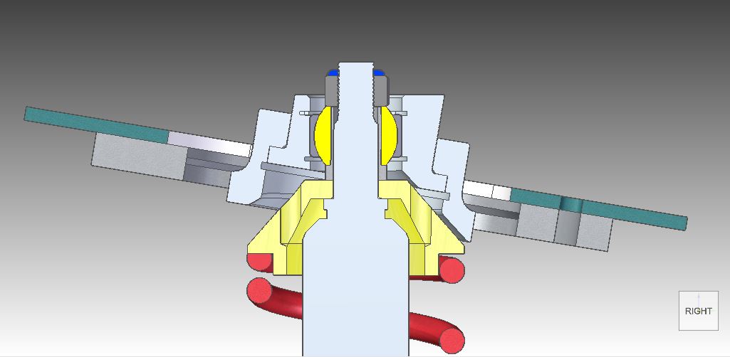

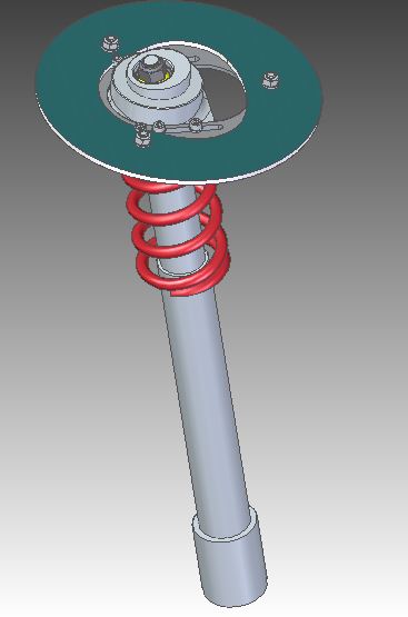

Here is the way it is constrained at the bottom. There is a sleeve which allows for vertical movement of the strut and rotation along the transverse axis of that little sleeve. This is as close as I could get to emulating a worst case scenario of suspension movement without having more information. I realize the point that sleeve is constrained at can move a little bit, but it should only pose a potential problem when the mount is at full POSITIVE camber which I don't think too many people will use. At neutral or negative camber, there is pleeeenty of space!
full camber.JPG (24.68 KiB) Viewed 95353 times
