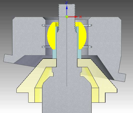

Just so there is something remotely visually appealing here, here's a picture of part of the current assembly (without lower plate showing). I have a LONG way to go with this, but it's better than nothing. Just started this design from scratch a few days ago. I'll go into more details on the concept in a bit.
Strut Mount Progress.JPG (39.52 KiB) Viewed 123906 times

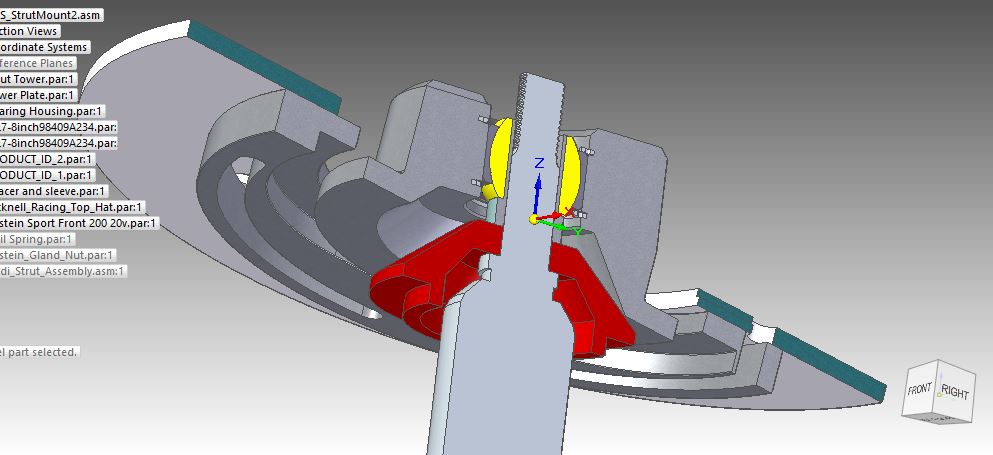

I've made some progress with my "proof" of concept, AKA virtually determining if my idea will fit within the constraints we have to work with. So now you can see a little bit of the concept I have going here. The design is driven by the need for adjustability in any direction, suspension travel, and the space we have to work with.
I am pretty close to being able to determine how much travel can be gained from this, how much adjustment it will provide, and probably of equal importance, how to clamp it all together. Thoughts on clamping include a threaded retainer to go around the OD of the big bearing housing, or bolts. The bolts pose an issue with adjustability however. The threaded collar idea is just going to be expensive! But that's all next on the list.
This picture shows the mount set up for pure caster adjustment.
Strut Mount Progress 4.JPG (28.36 KiB) Viewed 123693 times
Strut Mount Progress 3.JPG (63.52 KiB) Viewed 123693 times
Strut Mount Progress 2.JPG (32.29 KiB) Viewed 123693 times
The lower plate will be able to rotate in the strut tower while the bearing housing slides in the lower plate.

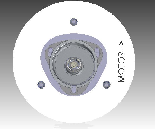

I got your assembly to work in Solid Edge ST7. This is the kind of utility that you pay the big bux for :)
Assembly Opened in SolidEdge Proof.JPG (35.39 KiB) Viewed 123588 times

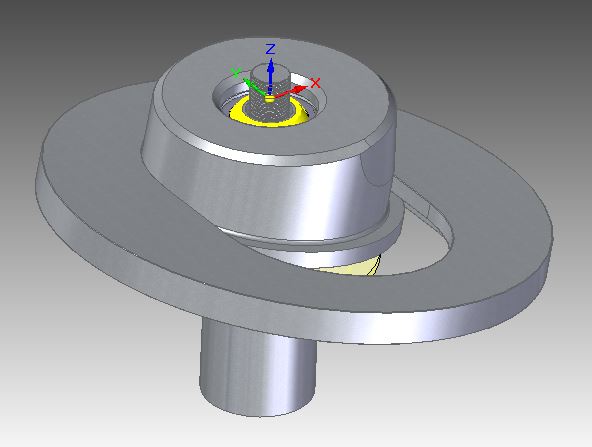

This is how mine overlays yours. Adjustability should be similar or better (the little lip around the outside will go under the plate).
Overlay TOP.JPG (30.71 KiB) Viewed 123588 times
Looks like you measured 10 degrees in the camber direction to my 9.5. Close enough for me!
Also, I see that you don't have any cant in the castor direction.that was just my mistake when sloppily overlaying the parts for that picture.

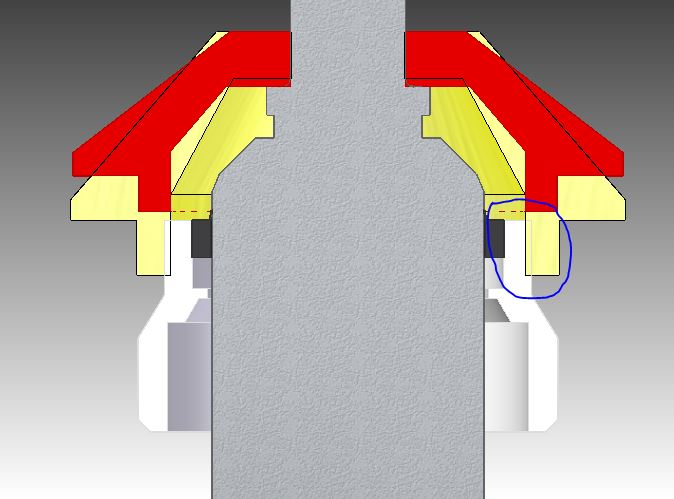

Another question...
Are you sure about the ID of the Bicknell hat? I thought I remembered them being much thinner around the part which centers the spring (I.E. similar OD to the A1 hat, but bigger ID than the A1 hat resulting in a thinner profile there).
Also, I think I am remembering that with the Bicknell hats, the strut would bottom out on its own internals before the gland nut would interfere with the top hat. With the A1, the top hat would hit the gland nut before the strut would bottom out. The attached picture is helpful in understanding why.
You can see the interference in diameter, but also that the Bicknell hat is much shorter allowing the strut itself to bottom out first I believe. That is for an unmodified strut. I'm not sure what the shortened struts are like.

loxxrider wrote:Another question...
Alright, with a set of calipers and a Bicknell hat in front of me, I measure a 2.071" for the ID of the hat, and a 2.432" for the OD of that same feature. I've also measured 10 degrees of tilt for the bearing housing FWIW.

Thank you, your measurement matches Nick's part file.
I'm not sure what kind of bearing you're talking about, but I can almost guarantee you it's because it would affect adjustability or suspension travel. The spherical bearing I've chosen should easily be able to cope with the stress though, so not to worry. I'd love to see some pictures of what you've got in mind though.

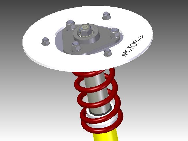

I made a lot of progress last night both in the design and analysis of how things will fit, etc. Things still aren't nailed down and I'm still not even sure if the concept really makes sense to carry on to production at this point without sacrificing something, but I'm going to keep going until I reach a dead end or find success :)
I need two measurements as soon as possible. What is the rough distance between where the strut mounts in the strut tower and where it can pivot down near the lower control arm area. This will help me determine how much angle we gain per linear movement at the strut tower top.
I also want to know how much room I have to go up still. AKA how much space between the top of the strut tower and the hood. :beer:
Pic for clicks...
