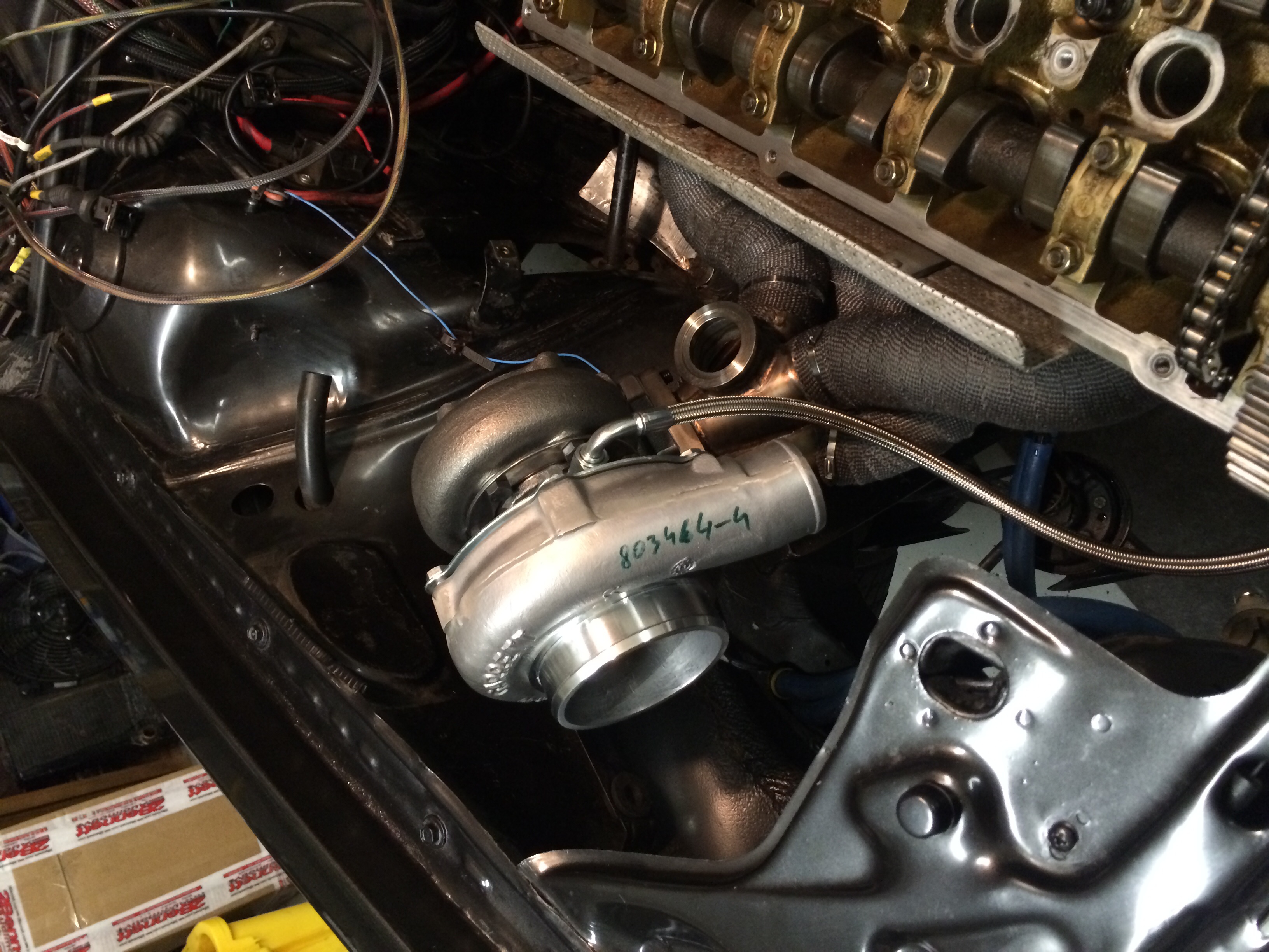

You will love that turbo. If you thought it was fast before, you're in for a treat. What fuel pressure regulator are you using, an AAN one? You'll need that slight bump in fuel pressure for all the fuel you can get. I was at 86% DC with a 4bar 7a and the 60lb Siemens. Oh, and are you using a bigger fuel pump? 044?
Re: Audi S4000 - Alaska
Posted: Sun Dec 21, 2014 12:21 pm
by Namreg Rac
chaloux wrote:Nice! Getting right at it, I like your style. Running by Monday? lol.
I have a new 4 bar FRP. I also got those 60lb Siemens. From what I have read the stock Bosch fuel pump will work well beyond my needs so I am just putting a new one in as well as a filter.
I have a question for you: How do you know which connections on the GTX housing are the oil supply/return and coolant supply/return? I need to get this thing oriented right and can't even figure out what hole in the turbo goes to what.
Posted: Sun Dec 21, 2014 12:54 pm
Oil inlet is the smallest and should have a restrictor fitting, oil drain is largest and needs a flange, use -10 hose at least.

Is this the oil inlet? What is that little piece on the inside? It's not a built in restricted is it?
This is the smallest hole on the turbo
Posted: Sun Dec 21, 2014 1:19 pm
by Namreg Rac
And then the opposite side would be the drain. It has provisions for a little flange
Posted: Sun Dec 21, 2014 1:27 pm
by Namreg Rac
Like this
