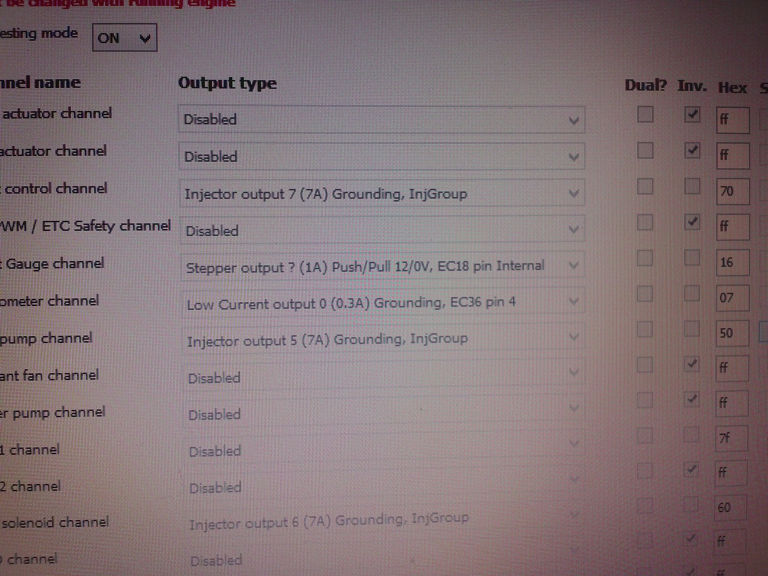

And now for the meat and potatoes of the matter. I decided to check the fueling side of things first. Here is my outputs page with testing mode enabled and the fuel pump checked and turned ON.
Posted: Sat Aug 09, 2014 3:52 pm

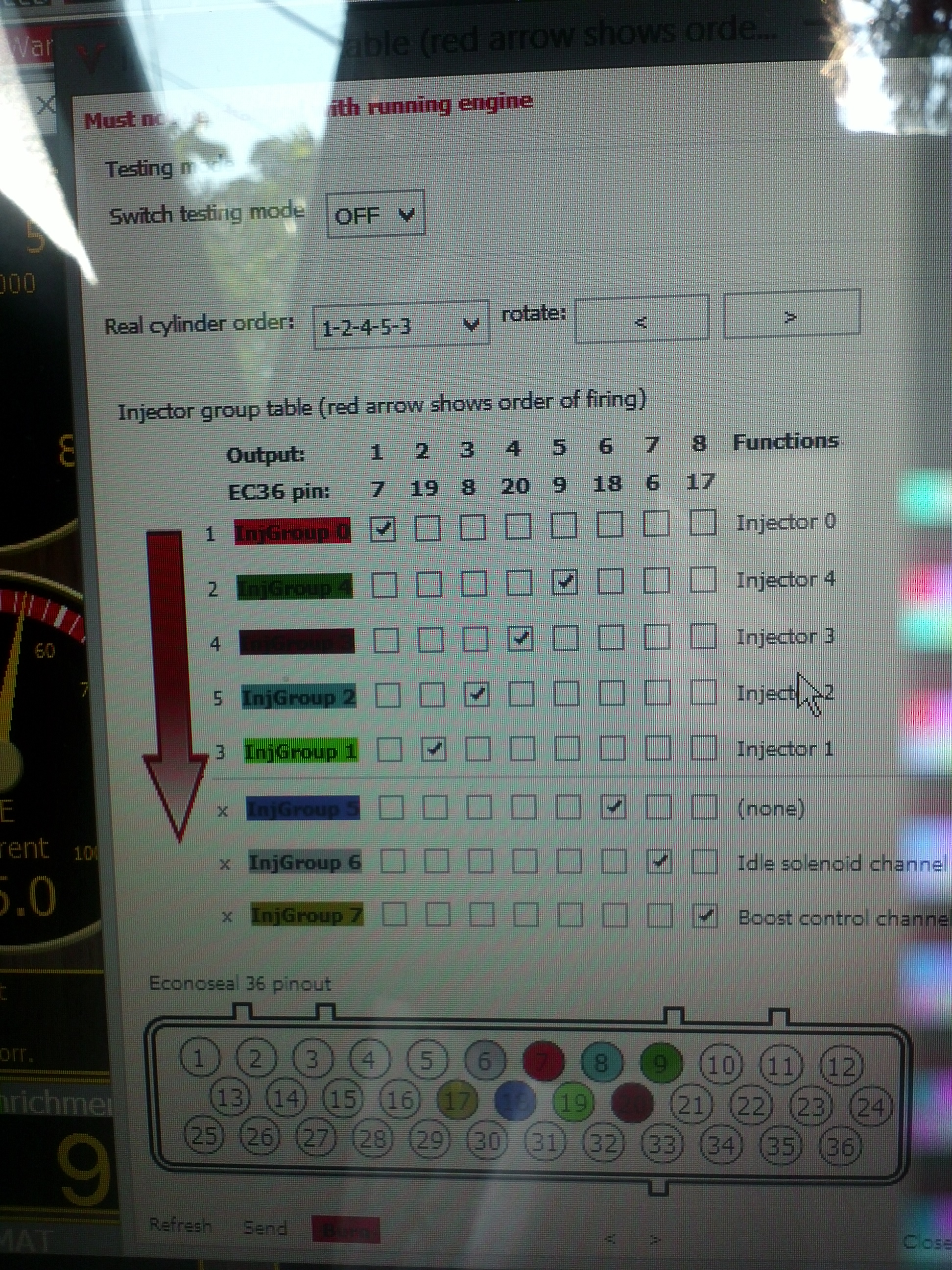

now id like everyone to look at the line to the right of the fuel pump and look at what it says. "ignition output 5 (7A) grounding, injgroup" Does everybody have the same thing in that box? Anyway when I hit ON for the fuel pump output, I noticed that injector 5 was receiving the ON signal before I even step mouse on the injector outputs visual page. I'll repeat that, I don't need to test injector 5 in order for it to stay on... In fact when I click TEST on #5, nothing happens at all. I did notice that when I clicked one injector's test button, another one went off instead. This last one is a shot of my injector output visual page
With nothing turned on or changed and still have injector 5 stick open. Is this normal
Posted: Sat Aug 09, 2014 4:17 pm
by Marc
First thing first, the channel numbers are zero based. So, the cylinders get channels 0-4, fuel pump is 5. Are you saying you get no pulsing from cylinder 5 at all, it just stays stuck on? Test with a test light with engine running and #5 injector clip unplugged. If it stays lit constant, that sounds like a blown injector driver.

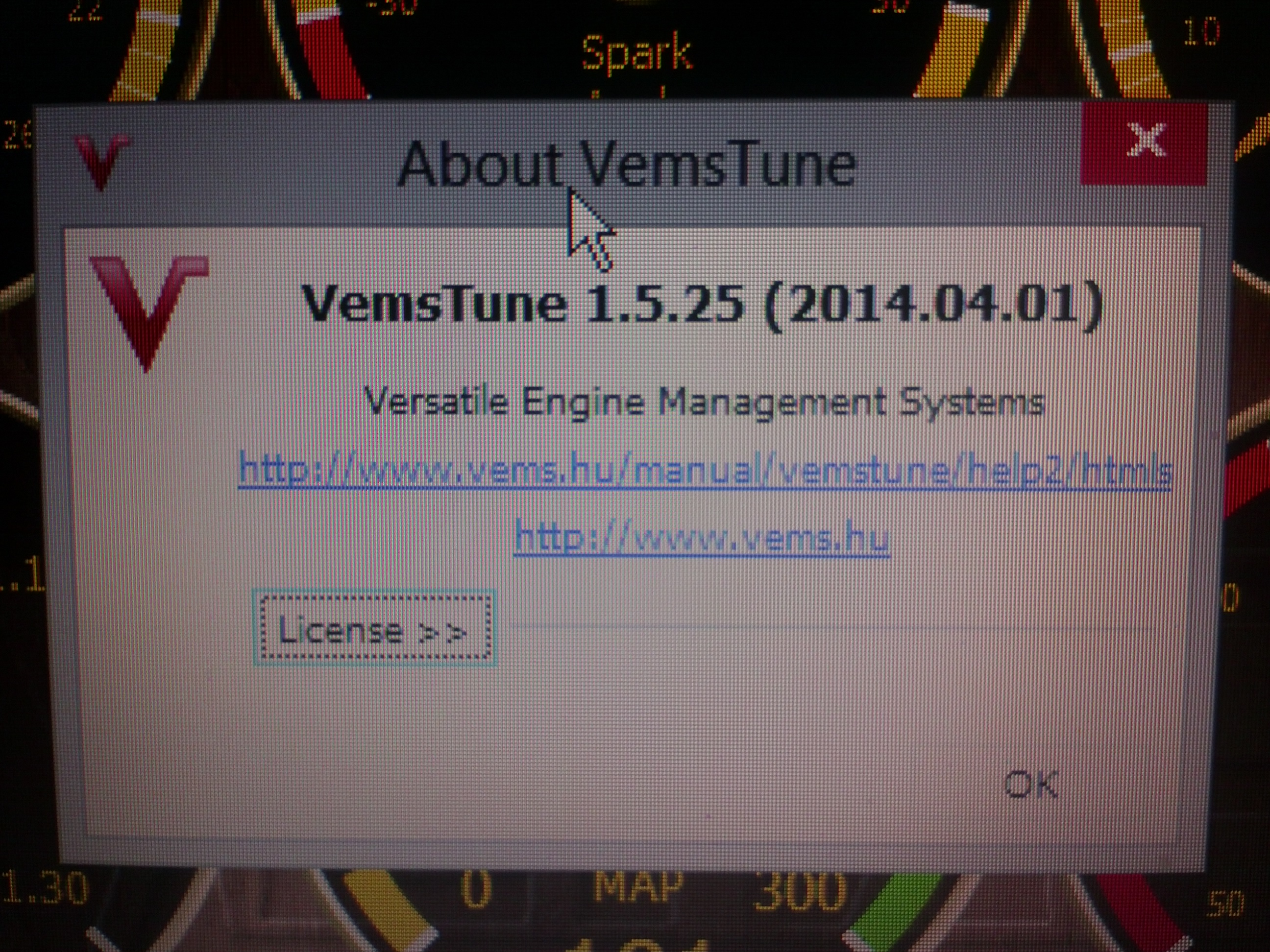

my money is on config corruption. The 3b ecus I cant test before I ship because I dont have any running 200's at my shop so we leave the default .hu firmware loaded on them and just adjust them for things like coil on plug and injector configs. I suspect what has happened here is because its 1.2.27 firmware the latest stable firmware isn't new enough to properly run things like test mode (you can see where his fuel pump channel shows as "none" on the test mode screen).
I've advised him to download the latest nightly vemstune, reset channel 5 as the fuel pump channel and repeat the test mode procedure to make sure #5 doesn't light up when turning on the fuel pump channel only in test mode.
Posted: Sun Aug 10, 2014 12:38 pm

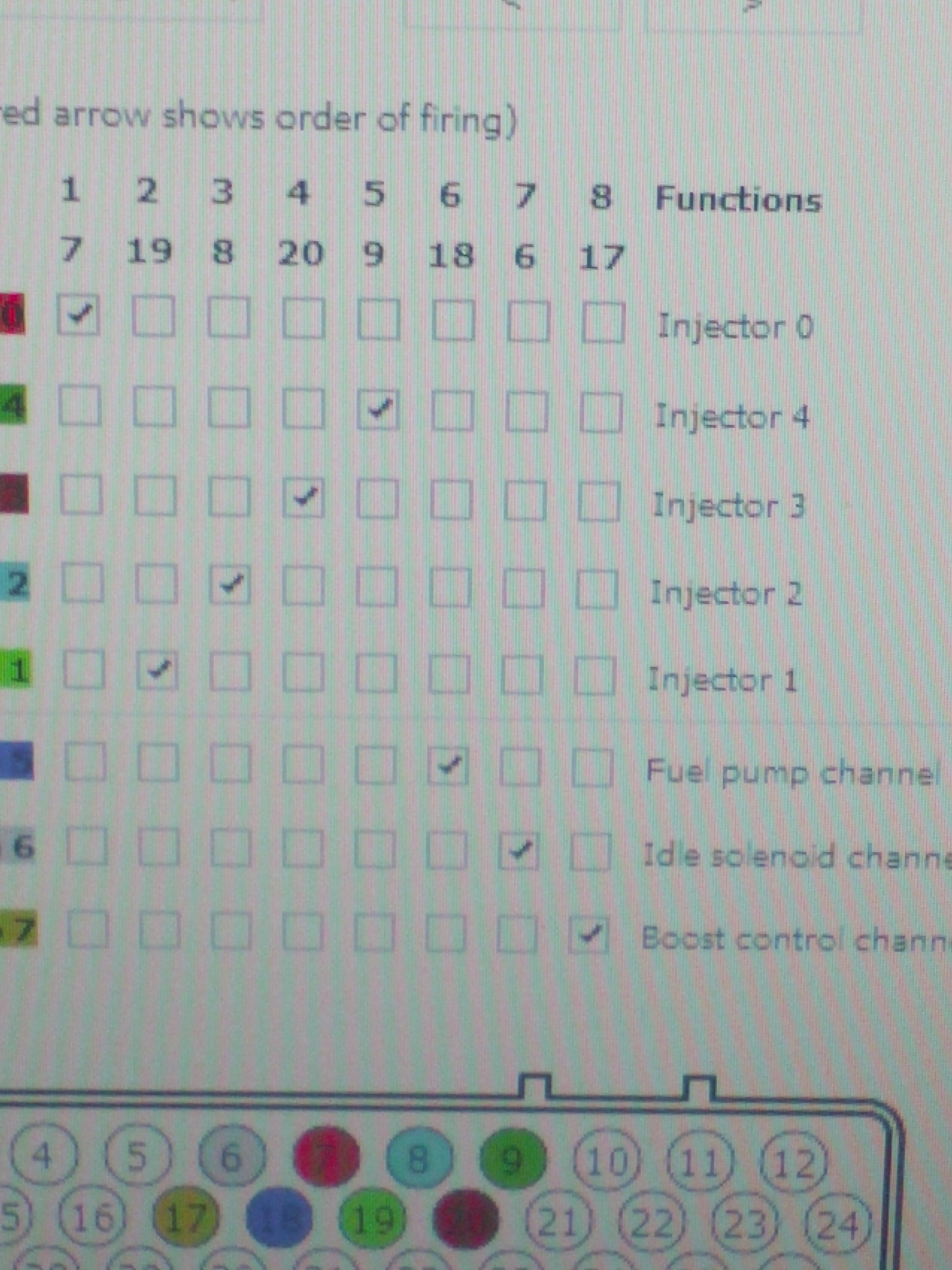

I updated to the one month newer nightly release from this. It fixed the "none" label
but as you can see I didn't need to change those settings but burned them anyway then went to this screen to see "none" was now fuel pump.
Here's the low down:
Ok so I updated to the nightly build. Now it says fuel pump channel for injgroup 5. It doesn't stop there though. When I click ON for injgroup 0, the fuel pump freakin runs like it used to when I tested the fuel pump. I was literally about to start the car again when I found that out. So now the fuel pump channel test just clicks and turns injector #5 on full but only blips the fuel pump for a fraction of a second. both injgroup 0 and 5 turn the 5th injector on still except testing the fuel pump test only blips injector 5. Its all reversed now. I tried my older fuel pump relay again (been using new one for about 3 months) but the results stay the same. Testing the fuel pump from outputs menu still turns both fuel pump and injector 5 full on.

I think at this stage its best for you to ship me the box so I can do some bench diagnostics. I have a new theory on what is going on (there are "clamp plates" that hold down the FETs for injectors and coils. I'm thinking these clamp plates might be touching things they should not in the case. this will cause one channel to also fire an adjacent channel). anyways, ship it back to me, I'll credit you any shipping costs and turn it around as fast as I can.

Wanted to make it clear that Marc truly knows how to take care of his customers! The other guys though, not at all so far. He was even correct on his remote diagnosis before he even saw it. Two FET's were touching and ruining stuff while operating. VEMS won't answer my calls (3 days) at this point but time will tell. Hopefully they realize their customers come first. Thanks again Marc.
