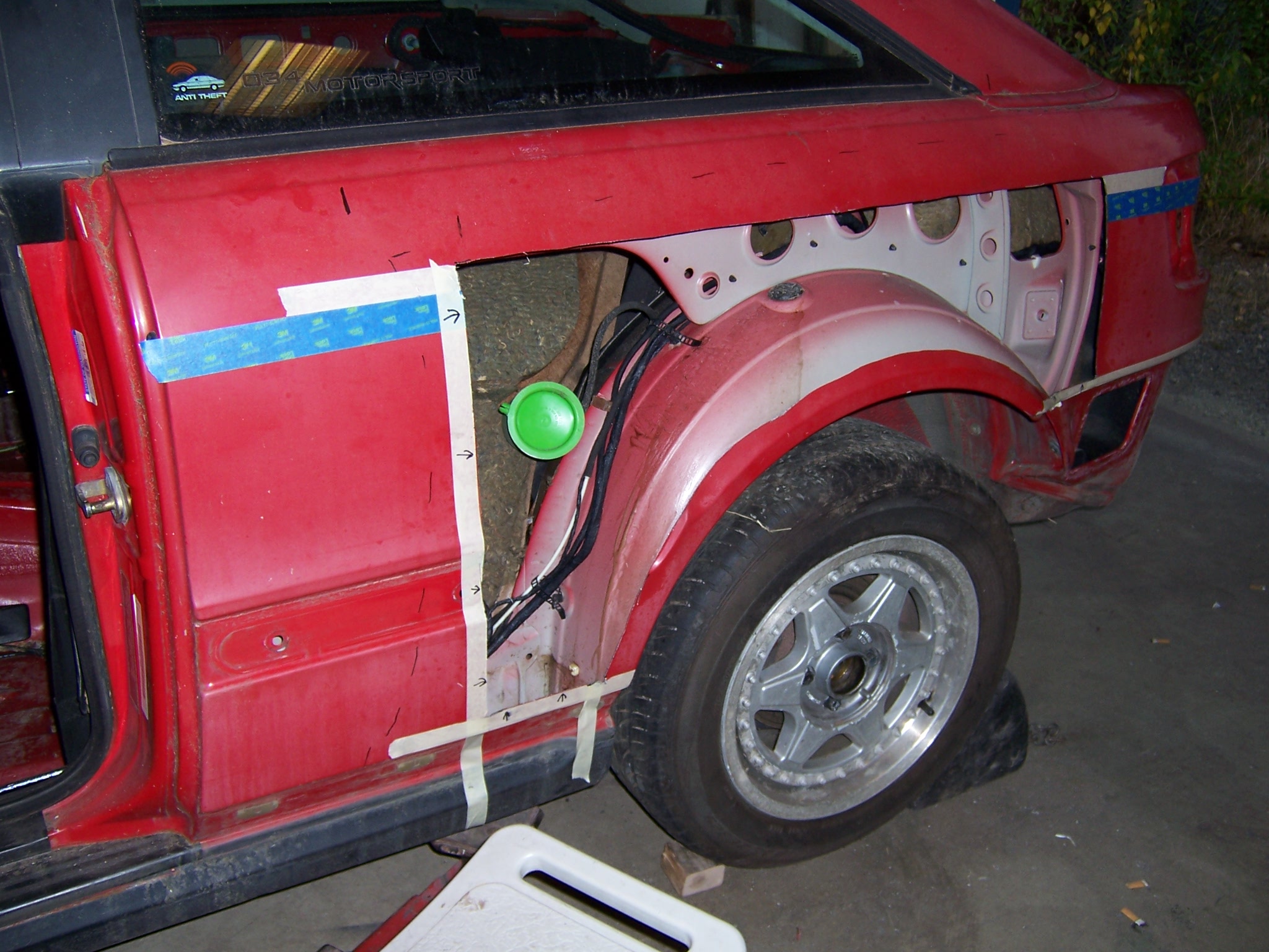

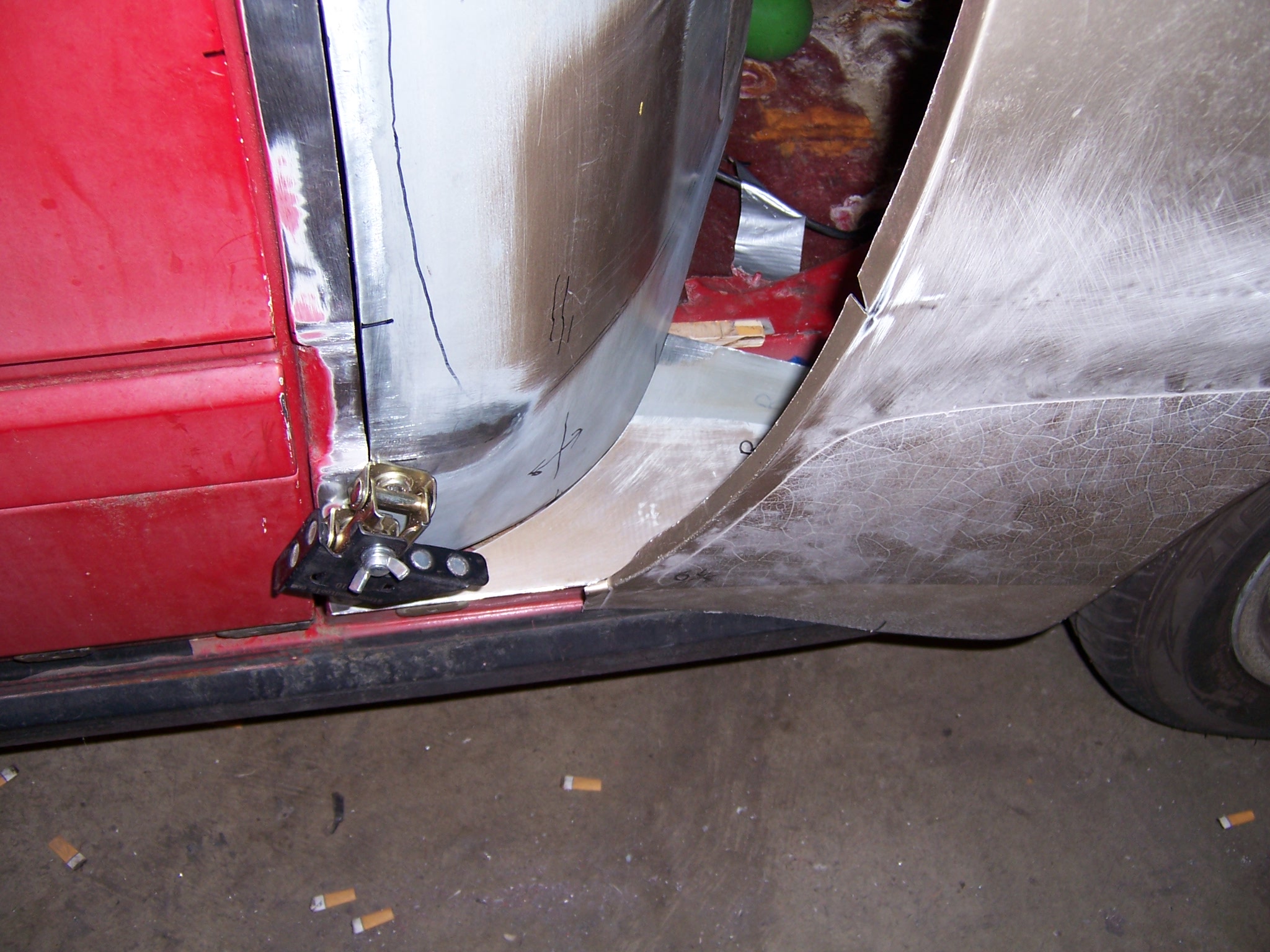

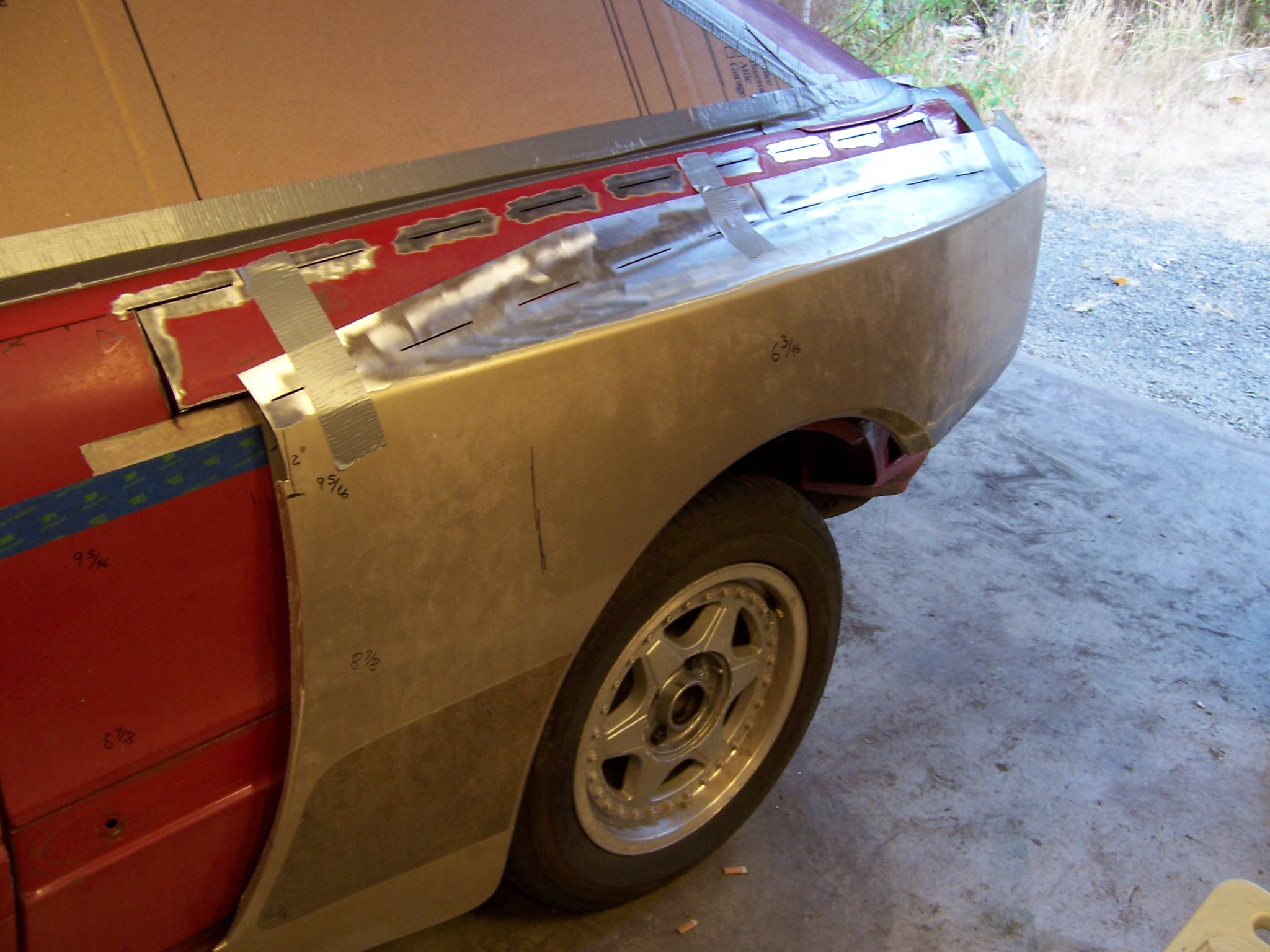

Few updates
Right side sectioned and weldet
audi wide build 043.jpg (451.43 KiB) Viewed 55975 times

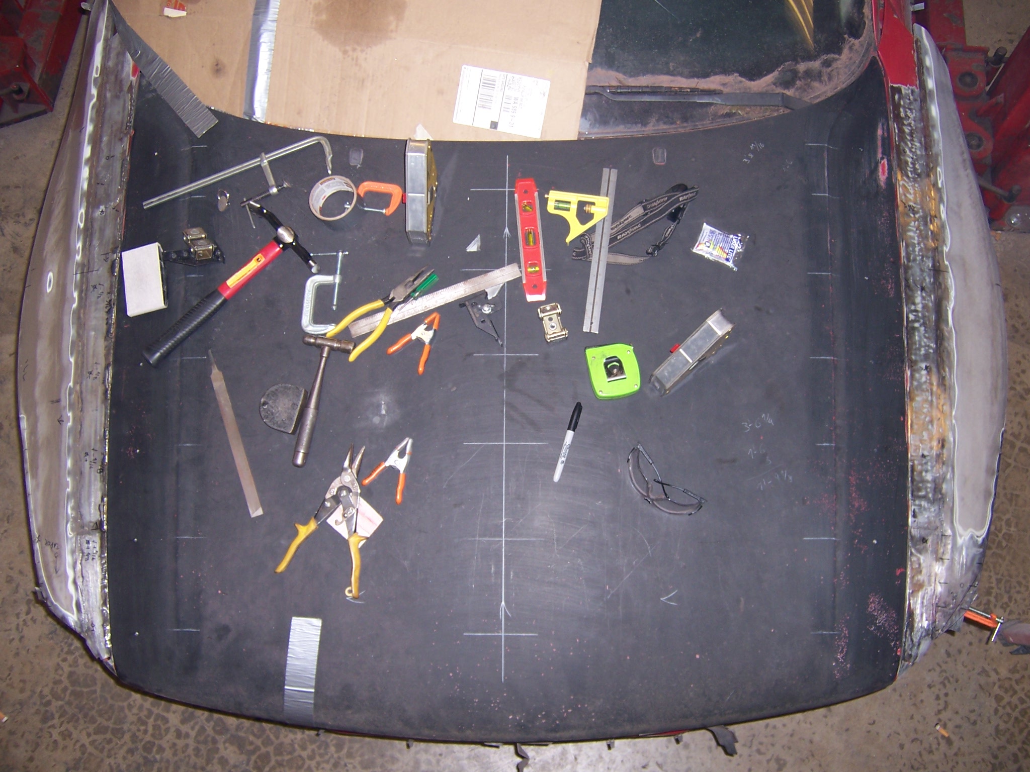

Overhead shoot
audi wide build 046.jpg (595.29 KiB) Viewed 55975 times
A little bit more hammering and some tweaks and i can start on the noses of the fenders. Once that is done the rear quaters will be next.
Then Rocker panels
Cheers

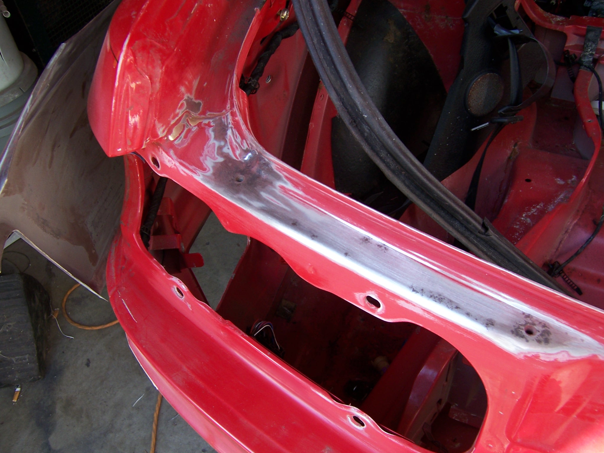

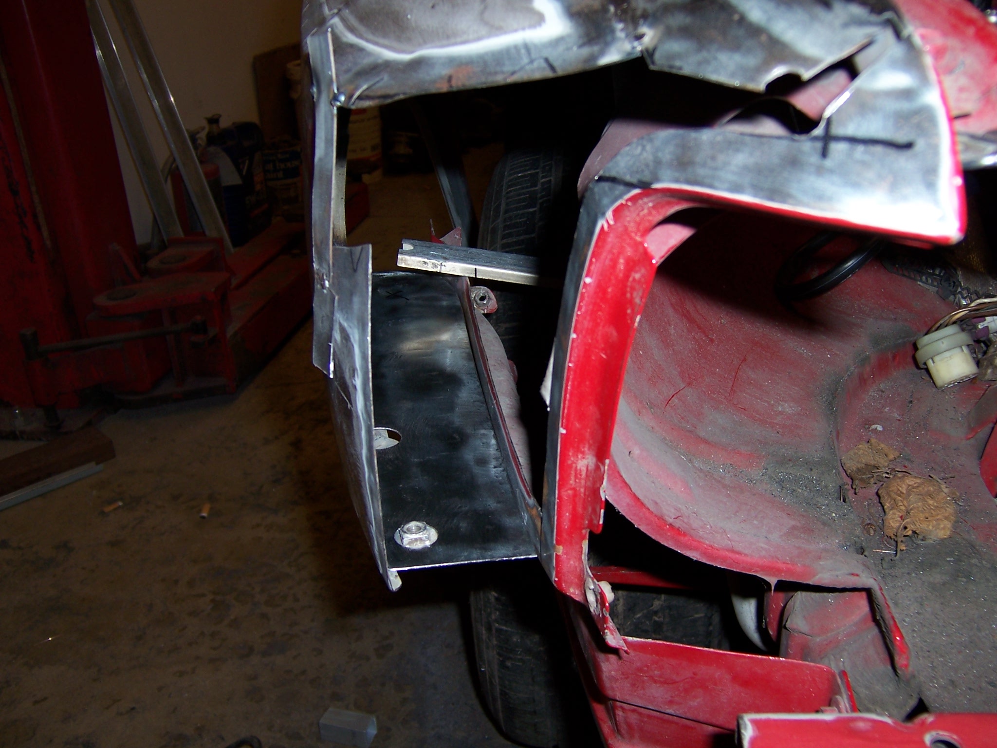

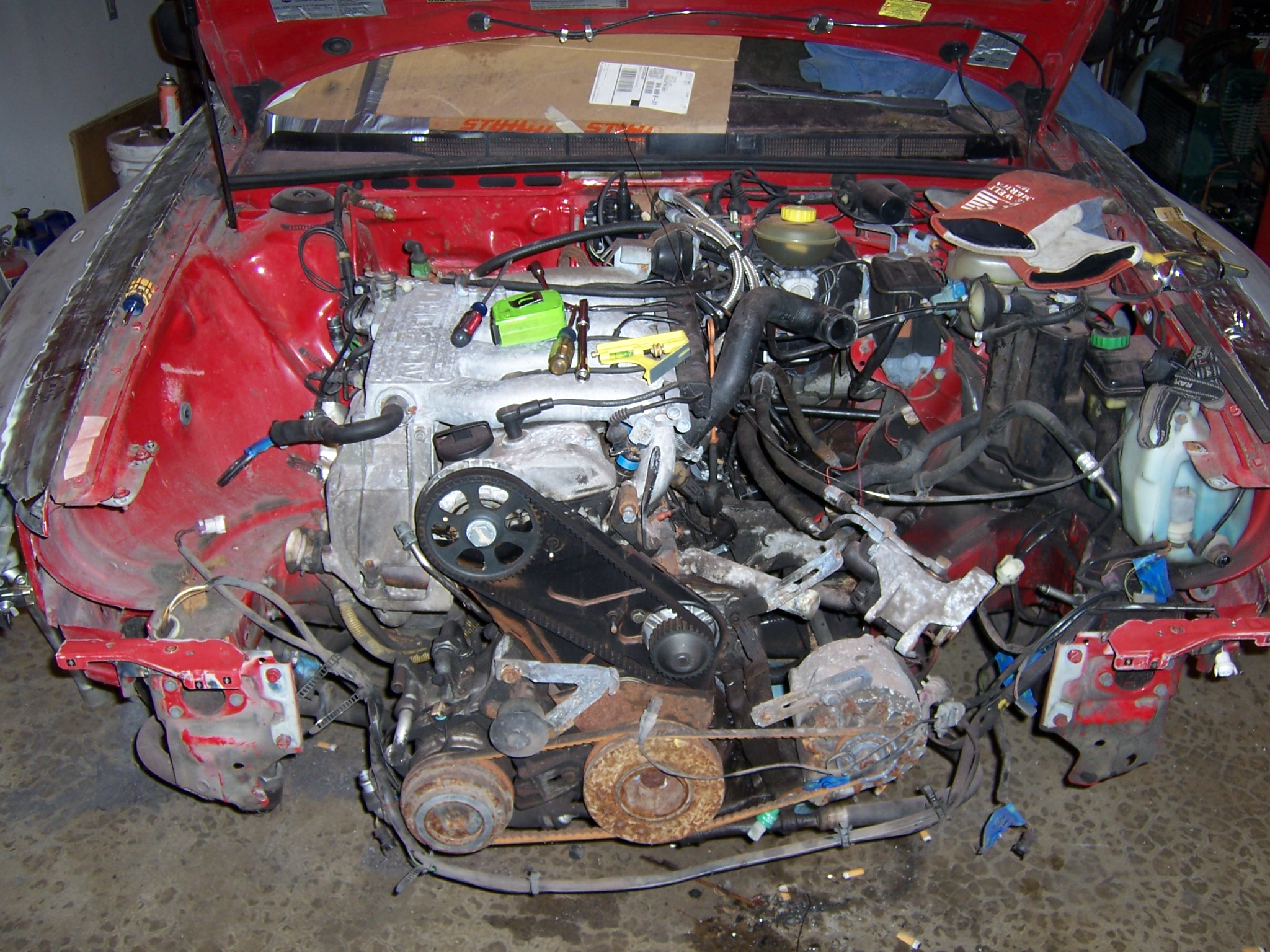

So i am working on the noses of the fender and i needed some targets for measurements , witch resulted in some parts removal.
The offending parts removed
audi wide build 074.jpg (864.97 KiB) Viewed 55913 times

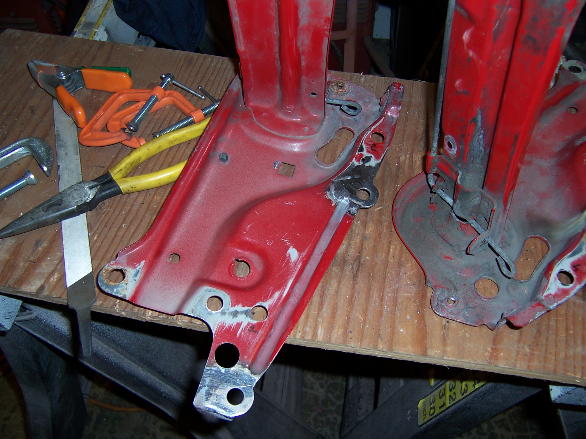

Thing that are being modified so noses can get finished
audi wide build 077.jpg (708.34 KiB) Viewed 55913 times
Updates as soon as i get some more done .

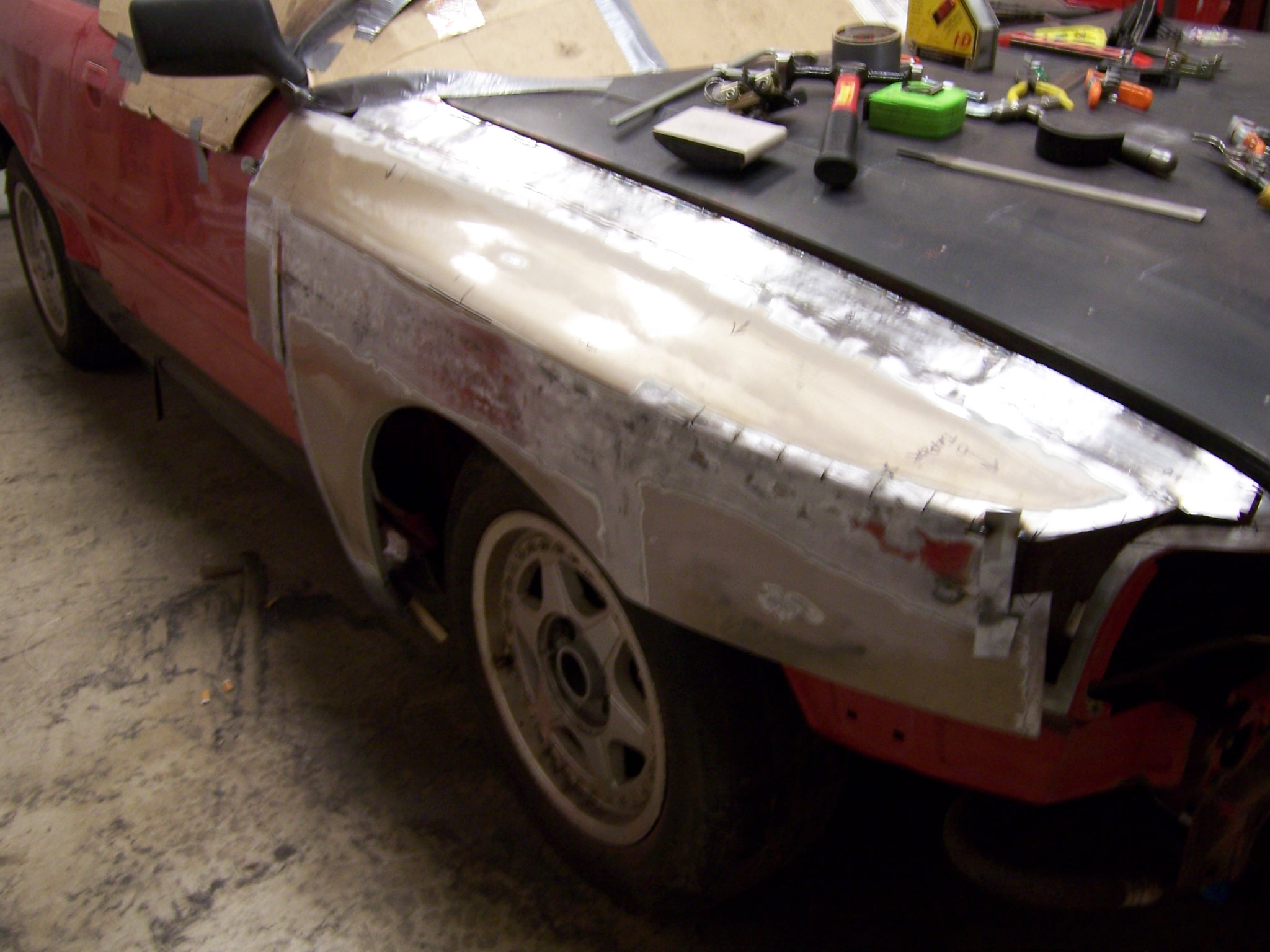

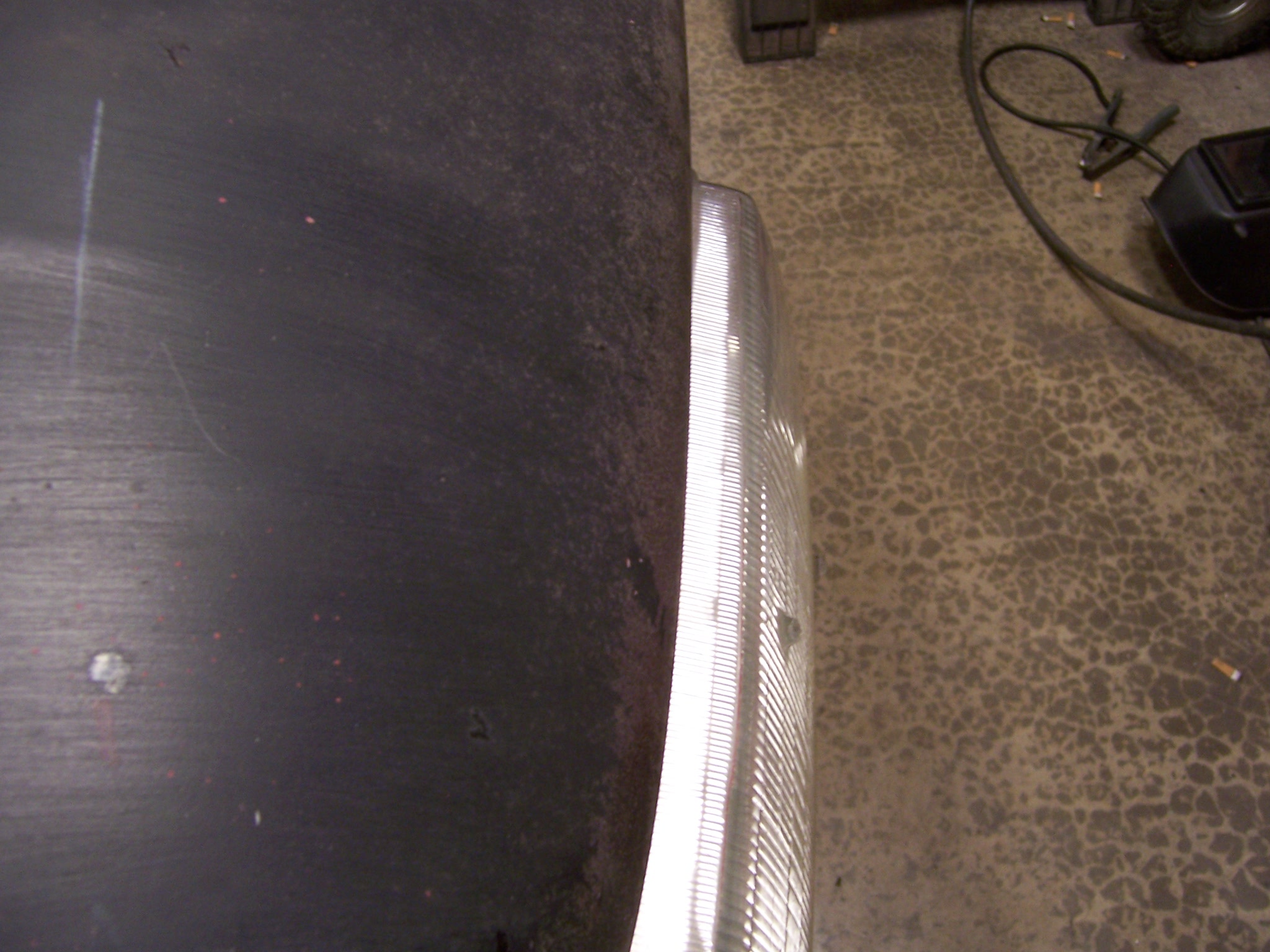

Update.

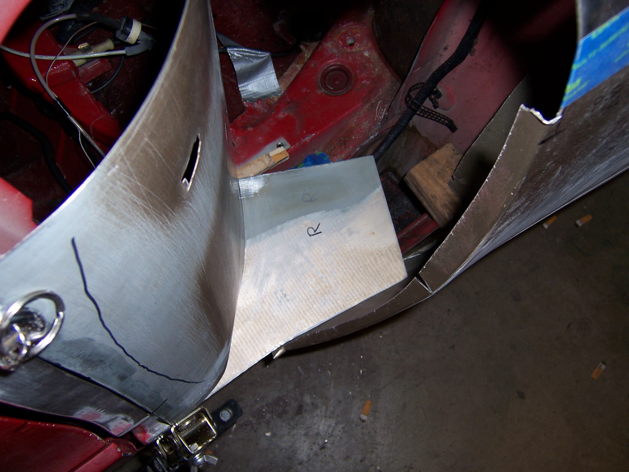

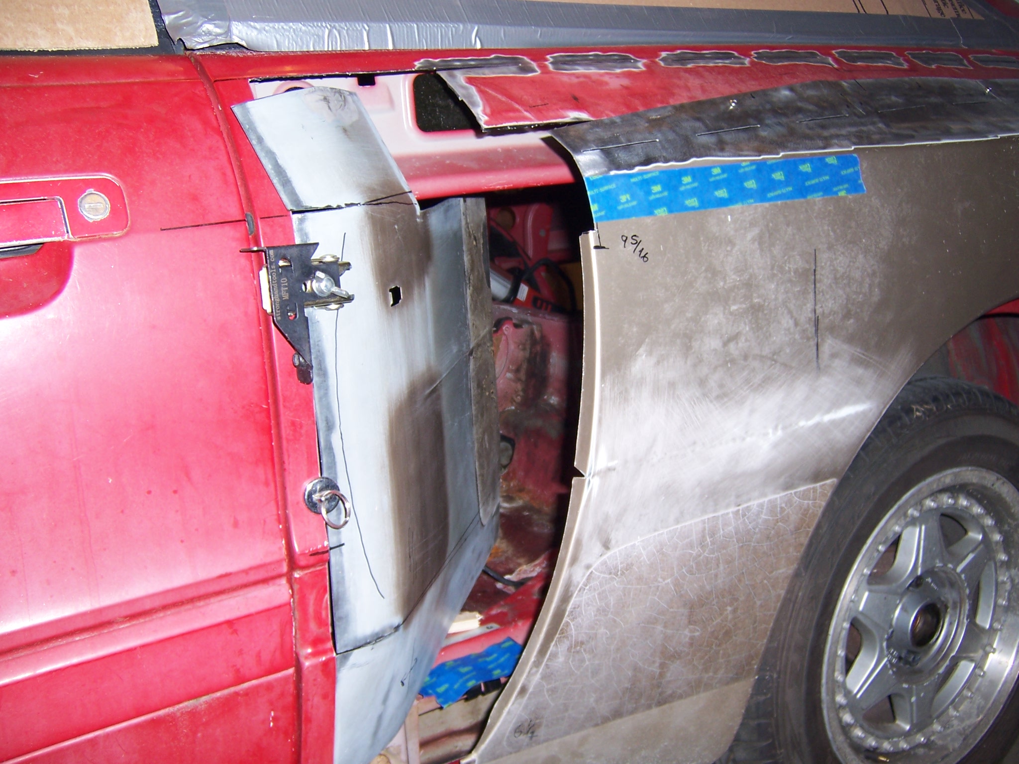

Patch panel for fender
audi wide build 078.jpg (690.79 KiB) Viewed 55826 times
Other side but not tacked yet
audi wide build 080.jpg (501.75 KiB) Viewed 55826 times
More things i have learned doing this build:
Use New sheet metal , stripping the paint of used metal to make it weldable Eats Allot Of Time. :shame:
Cheers:

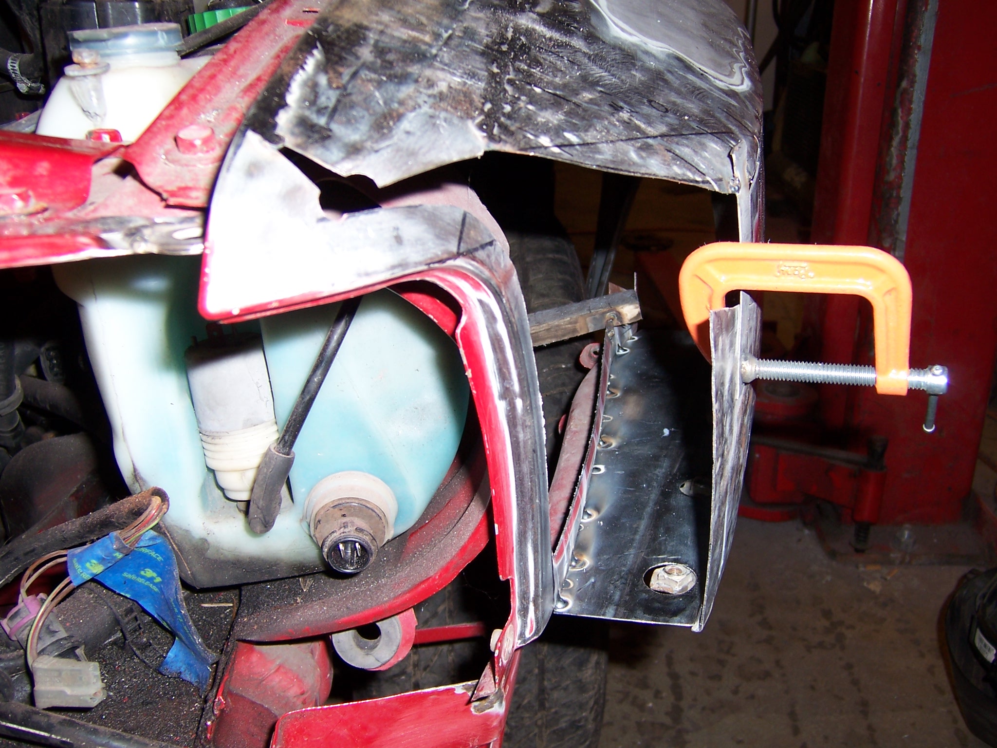

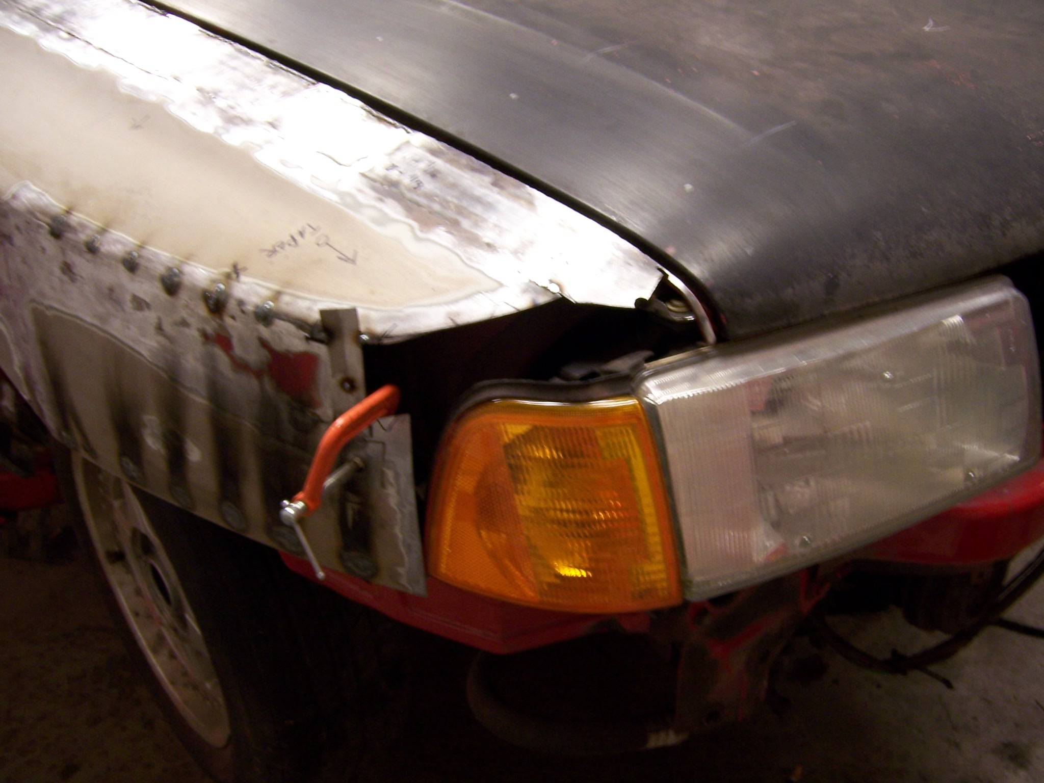

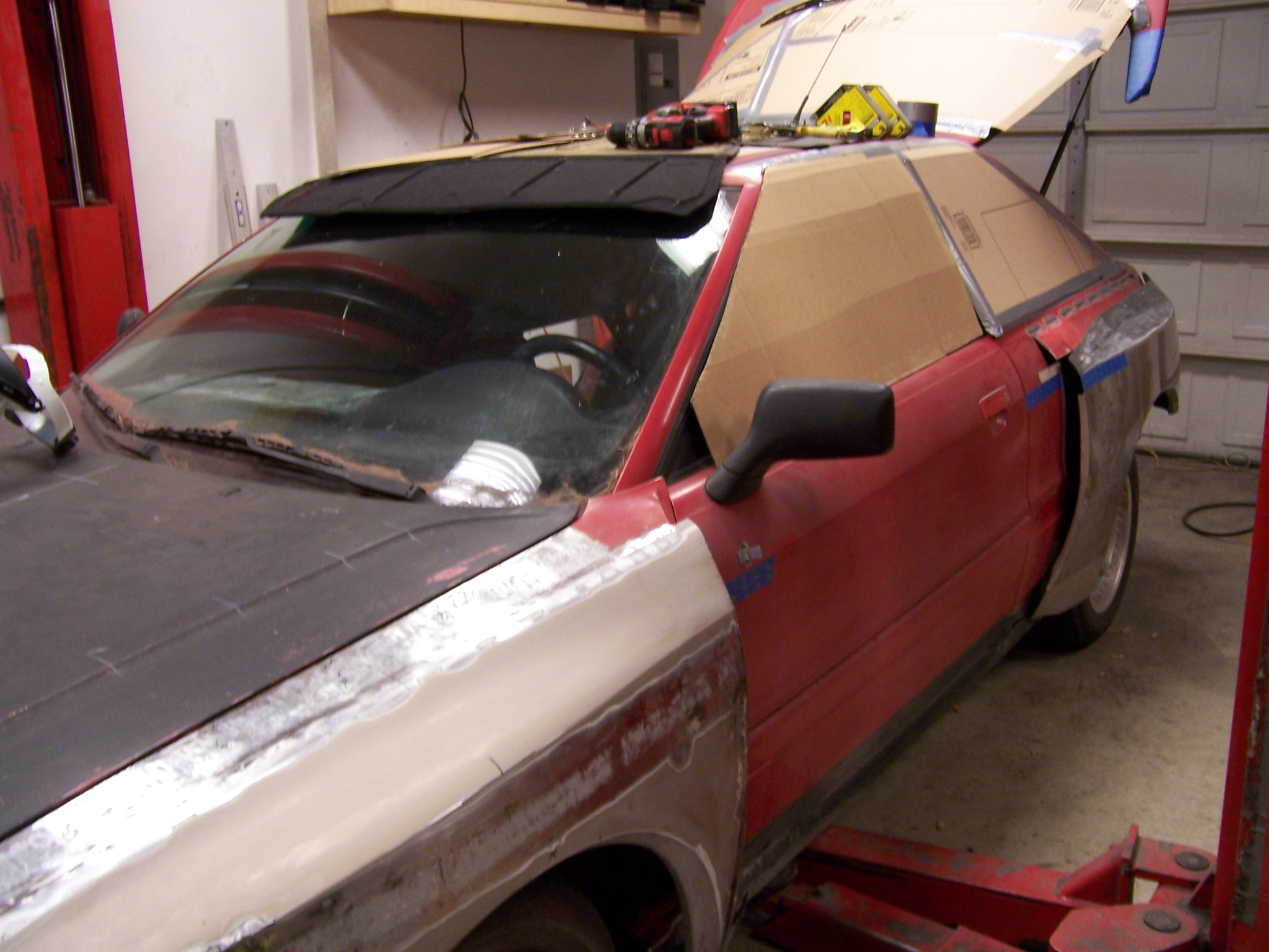

So work on the nose of the fenders is on Hold. The turn signals are just not stable enough to get the frame placed with any kind of
accuracy . I need eurolights to make that happen the way i want it to , as i only want to do this once . To top that off , i think i need to
redo the Headlight mounts to place the light further back . :bangshead: So i will focus on the rear of the car until i get some
one piece headlights .
This is how it sat tonight
ok 002.jpg (489.89 KiB) Viewed 55802 times
ok 003.jpg (410.49 KiB) Viewed 55802 times
ok 005.jpg (482.91 KiB) Viewed 55802 times
Thats it for now .

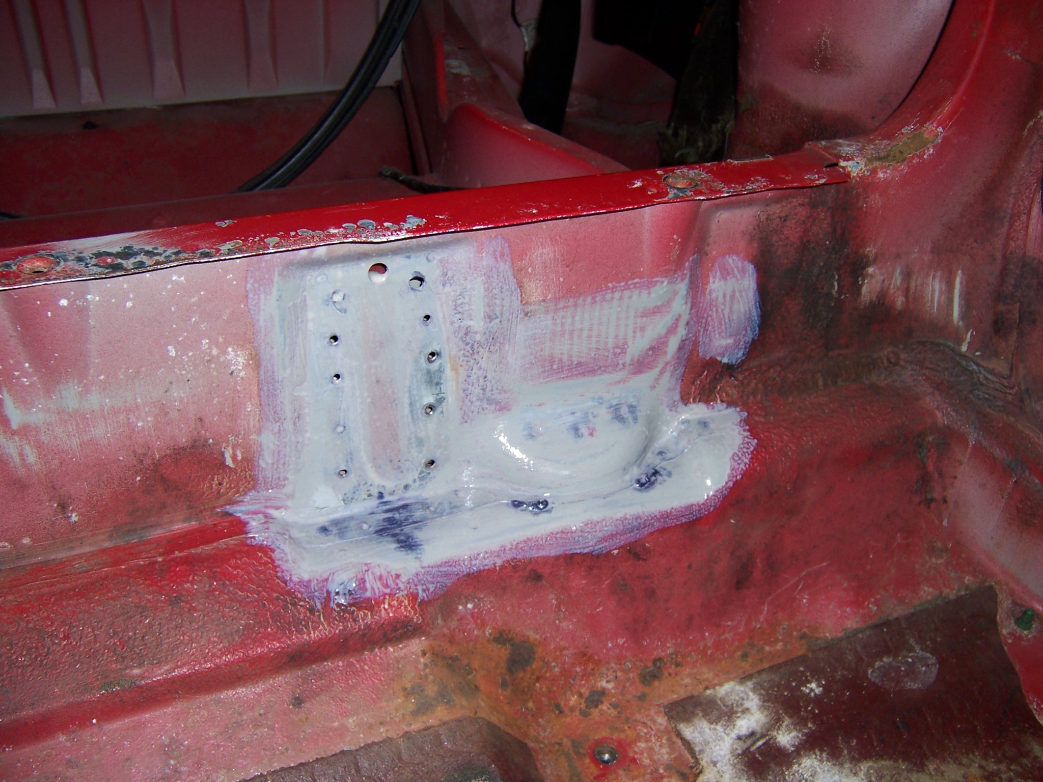

Made some progress on the Rear of the car.
Making a Hole
Rough fit Needs more love ,but starting to look like it was meant to be there

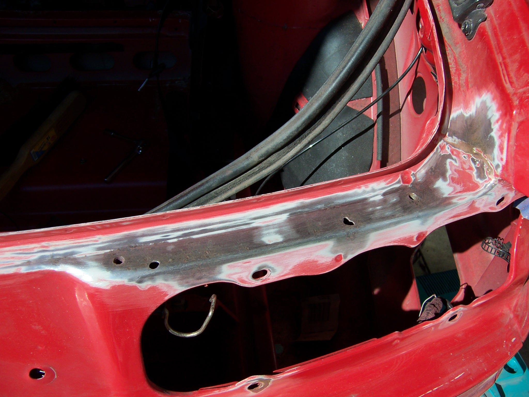

Also fixed this
Holes welded and ground , waiting for rust destroyer

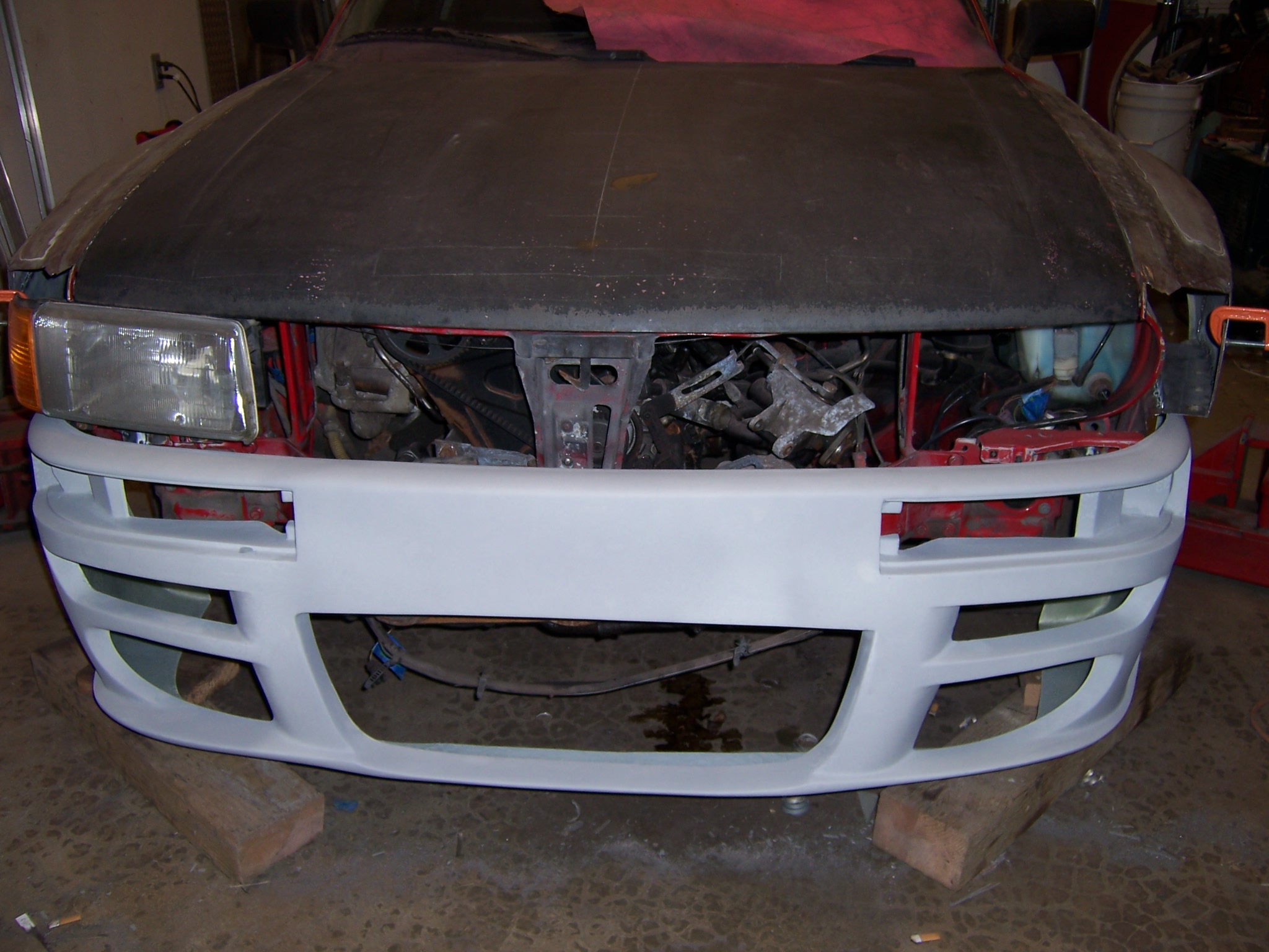

Also ordered this Front Bumper :hide:
audi bumper.jpg (70.54 KiB) Viewed 55367 times
Chiao
Posted: Wed Sep 09, 2015 6:35 am
by versacehobo
can't tell if you're serious about the bumper or not?
Posted: Wed Sep 09, 2015 10:04 pm
by Einbilden
jaychen wrote:can't tell if you're serious about the bumper or not?
I like it that's why I ordered it. So yeah I am serious Kind Sir !
Comments are always Welcome ( Likes , Dislikes ) it all gets read and processed by my engineer. :twisted:

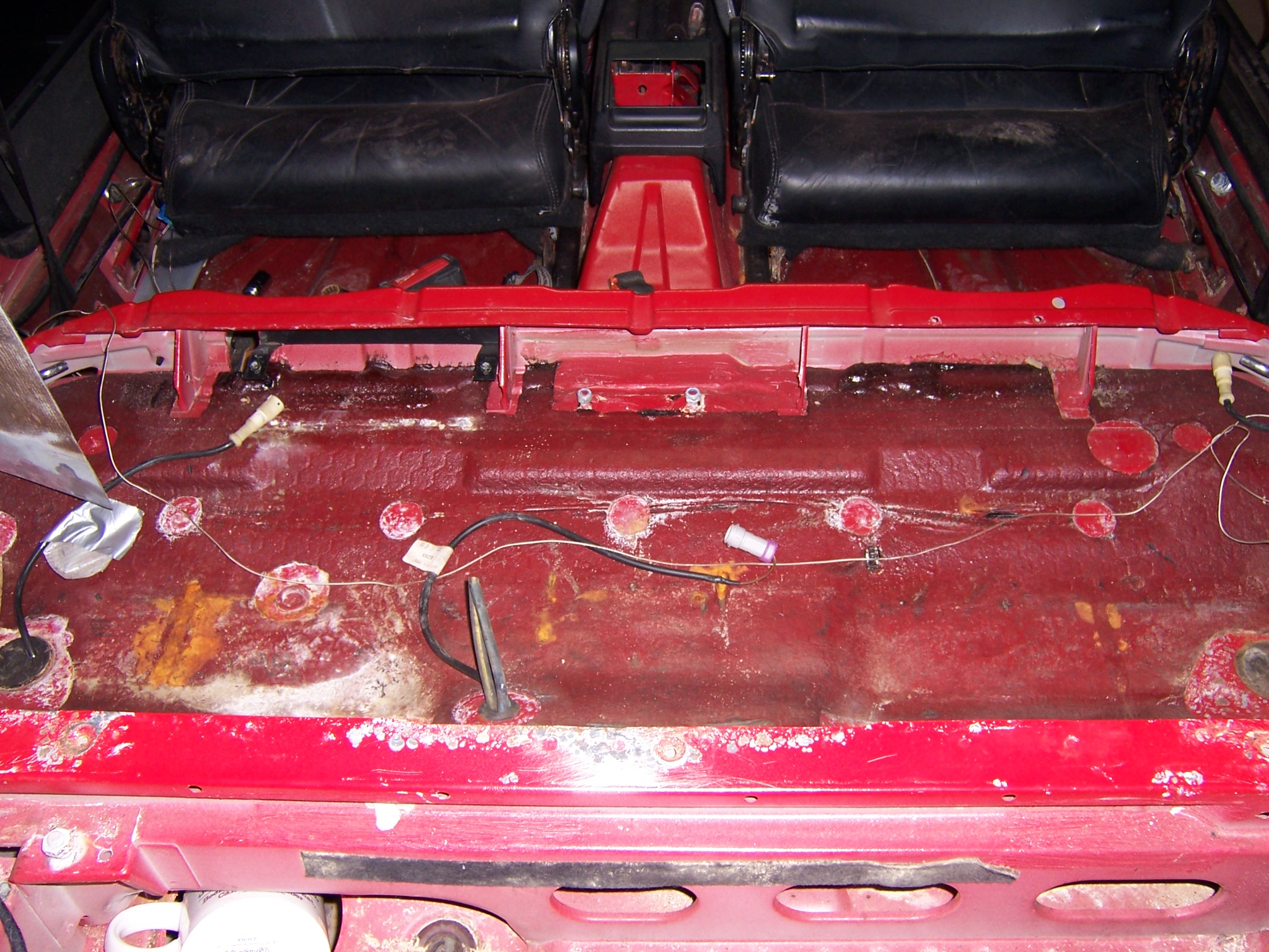

Got a couple of hours done on the car tonight.
Removed backseat center pivot mount
Also all the control units under the backseat are now gone
All this meant having to be in the car. Getting in and out a few times I realized just how Light these cars are in the Rear. :o Glad I am adding weight in the Trunk to hopefully offset that a bit.

Posted: Sat Sep 26, 2015 8:31 pm
by Einbilden
Received the bumper yesterday, and slid it under the car. Needs to get Wider, plus the top edge of the center opening would look better Straight (to me anyways). Maybe I get some time tomorrow to work on the car. Ill keep you guys posted.
