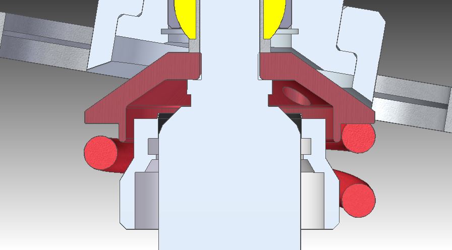

Kind of a shitty pic, but you can see the radial bearing in the top cap, then the 3/4" spherical on top. Mine don't however have any means for adjusting castor, yet.

uberaudi, make your next point of education in that program to learn how to take a section view. That will help a lot! Until then, I can't really tell what you have going on there.
Posted: Tue Jun 16, 2015 11:00 pm
by uberaudi
Yeah I should of done that to begin with!
How's this?
The blue parts are just 1018 while the orange is 6061. Note that the strut drawn is a 5000 strut, not a 20vt, but the steps and diameters are the same between them. Well, except for the main shaft.
Posted: Wed Jun 17, 2015 12:02 am
uberaudi wrote:Yeah I should of done that to begin with!
How's this?
Much better, I can tell what's going on now for the most part :)
Is that not still just loading the spherical bearing though? I don't see how you are taking any of the load off of it.

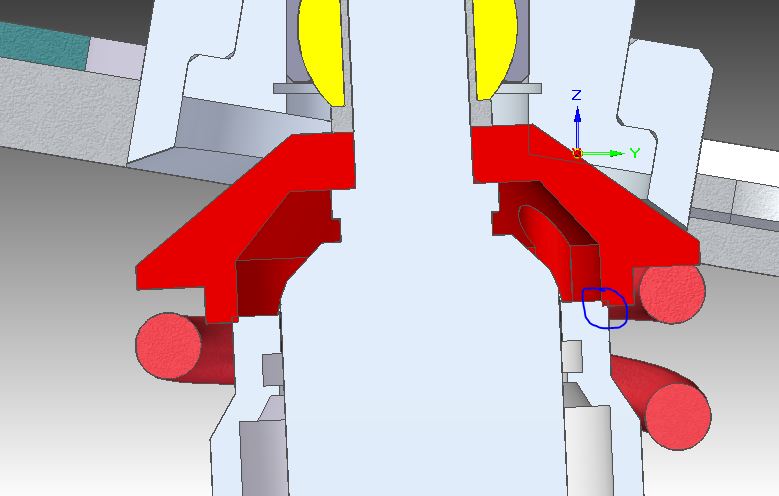

Pic for reference:
Strut Mount Progress 8.JPG (45.49 KiB) Viewed 87249 times

I don't think it's possible to have the hat interfere with the gland nut. I'm pretty certain the Bilstein will hit its internal bump stop before that can happen, plus I think the spring would be fully compressed before that happened as well. We're not exactly running long springs here

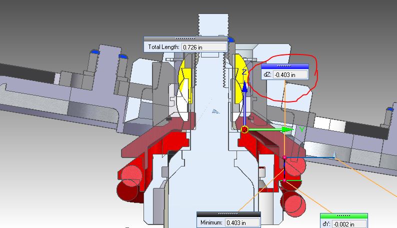

Progress has been made!
I took very good measurements of the strut tower bolt pattern (it was pretty close to the one you gave me in your CAD files Nick), the Bicknell hat (you got a little lazy on that one ;) ), and hood clearance (thanks Kevin!). From those measurements, I was able to come to a few conclusions.
1) The Bicknell hat has clearance for the Bilstein gland nut when the strut is all the way compressed. Woo! I thought that's what I remembered, but now I'm 100% sure of this.
Bicknell to Gland Nut Clearance.JPG (44.78 KiB) Viewed 86944 times

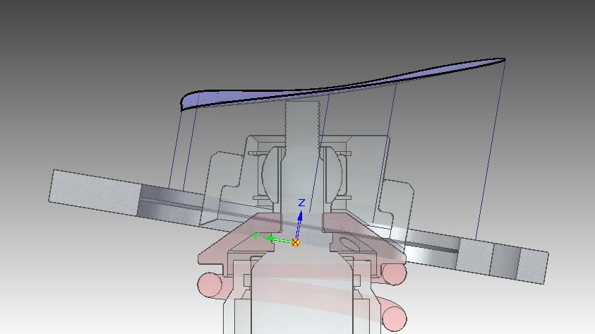

2) This design really does maximize strut placement with respect to hood clearance. I used Kevin's more conservative values (with the hood lining in instead of out) and we end up with just enough clearance in the middle of the adjustment range. If you want more camber, there is more room, but if you want to adjust in the positive direction, a spacer may be required. There is already a spacer used in the design to allow proper contact between the bearing and the top hat, so this can be made thicker for those wanting more adjustment in the positive direction.
Mind you, those hood clearance measurements were taken from a 200, so you UrS guys are on your own if it doesn't clear in your cars. Again, the fix is a simple spacer. It may be possible to just use some washers to space it out if needed in fact.
Hood Clearance.JPG (42.52 KiB) Viewed 86944 times
