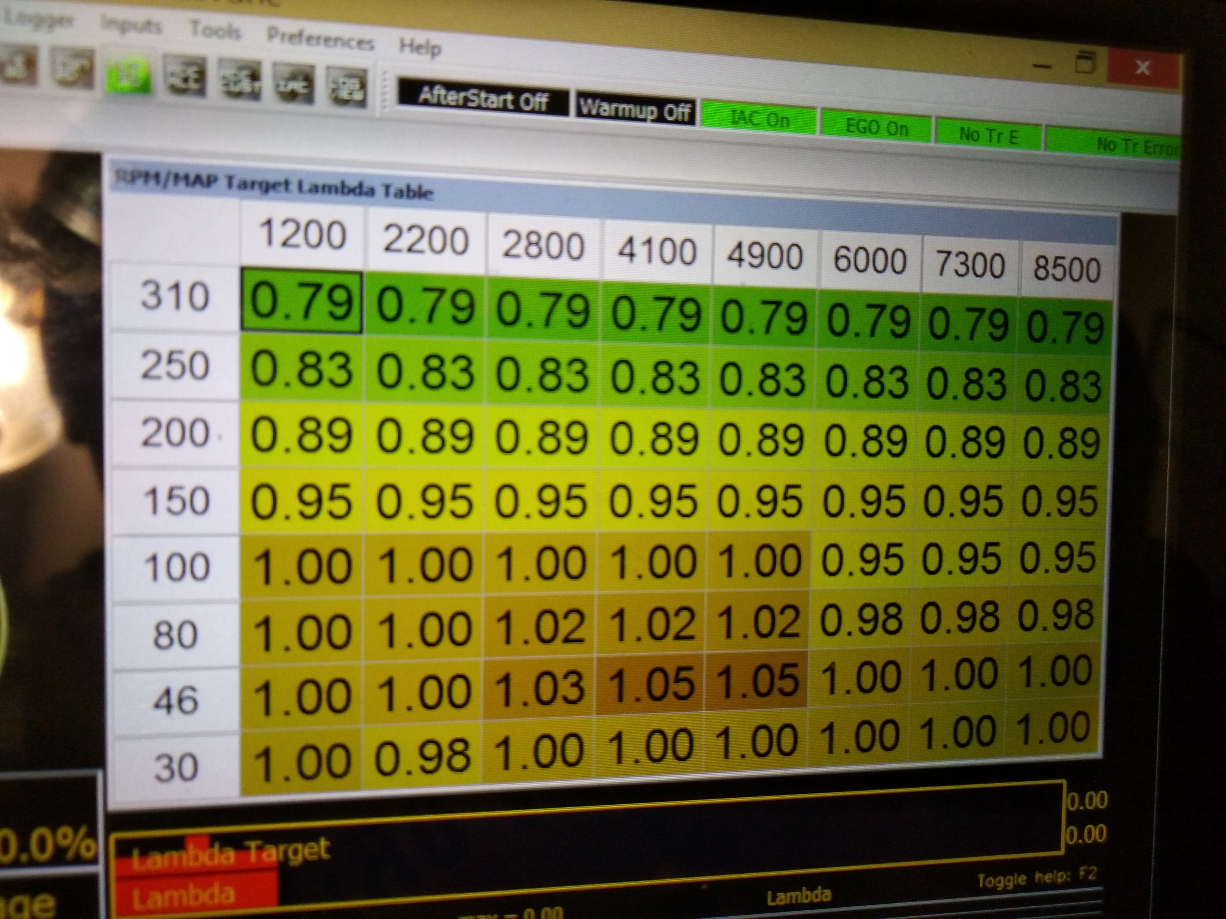

Is this reasonable you guys think? 0.79 lambda at 30 psi seem too rich or good? This is with the new direct port meth injection spraying. Feels very healthy at that afr.
Posted: Thu Nov 24, 2016 12:06 pm
Marc says this all looks good for lambda target. Happy Thanksgiving everyone!
Posted: Sat Nov 26, 2016 11:59 am
Yeah doesn't look bad to me. Happy Holidays
