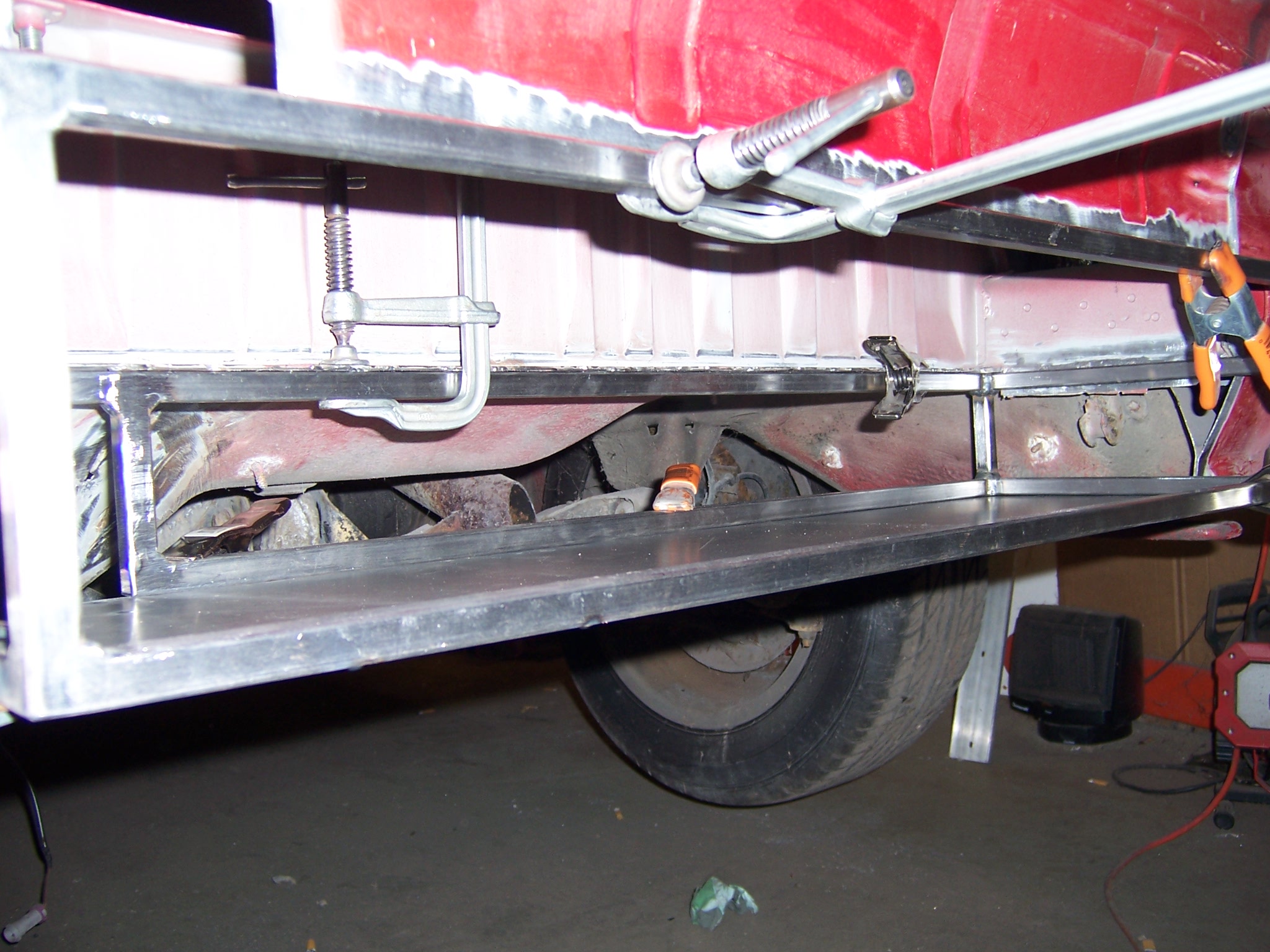

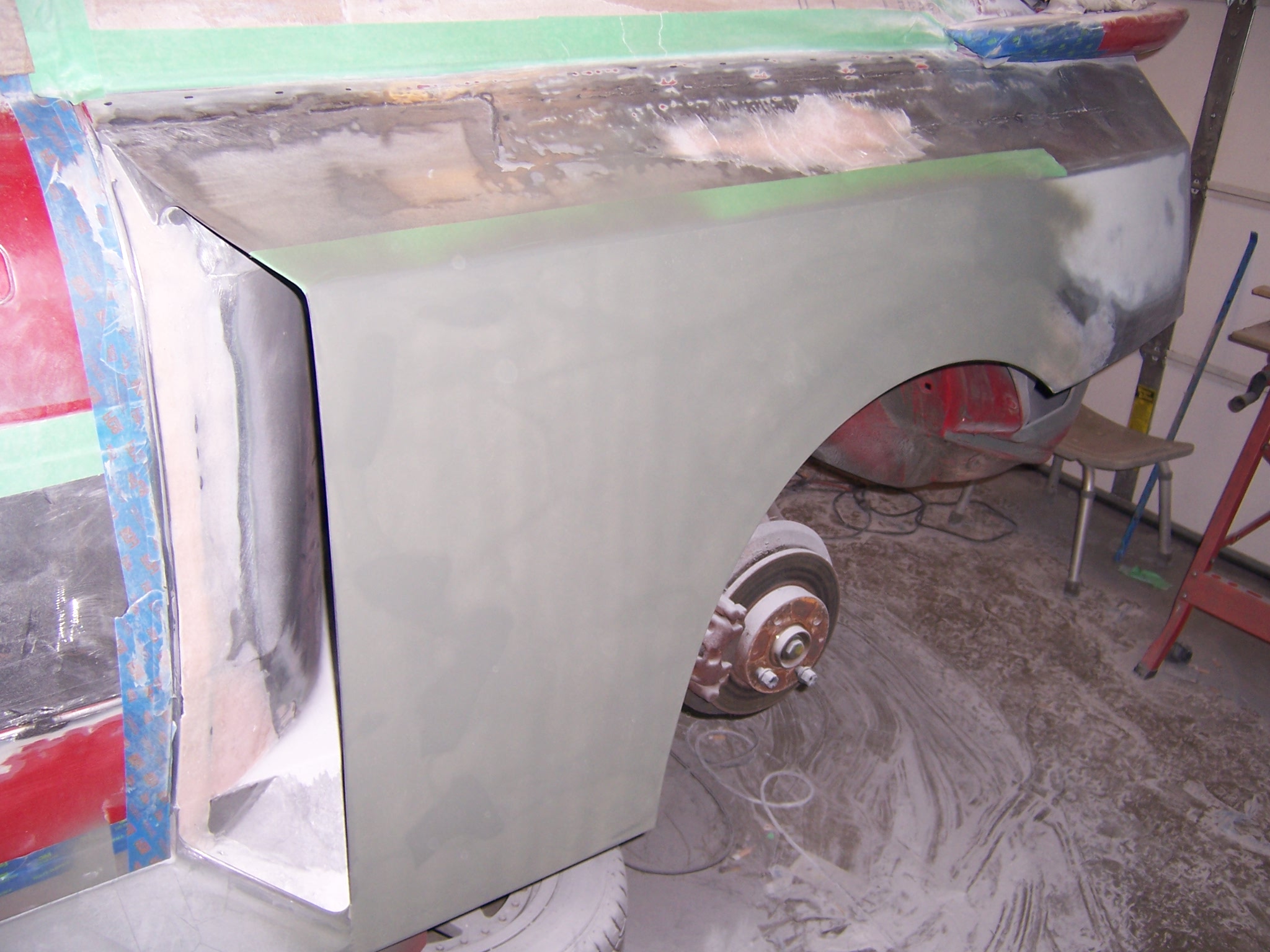

So after 2 coats of paint, panels got welded and ground.
Pass. side
- 100_2642.JPG (499.27 KiB) Viewed 63219 times

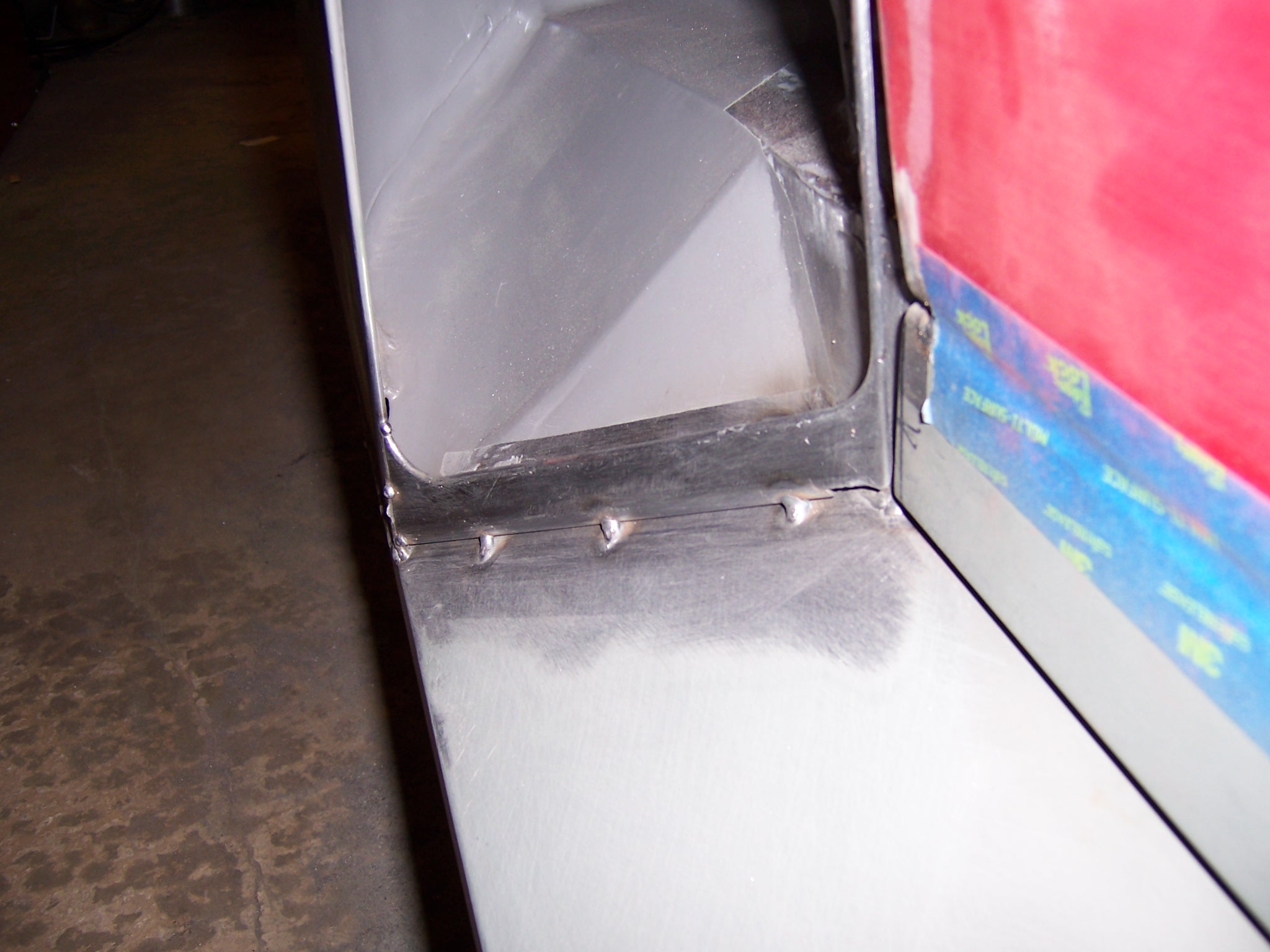

The bottom fill pieces had to get cut and extended on both sides by a 1/4 of an inch. Don't know what happened there ?
Bottom fill piece. Needs welding
- 100_2643.JPG (363.11 KiB) Viewed 63219 times

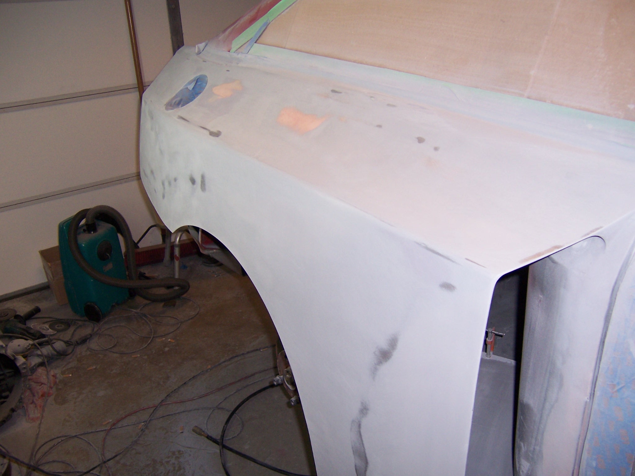

Driver side
- 100_2644.JPG (532.39 KiB) Viewed 63219 times
Have to get a new body saw as mine stopped working, so I can cut the wheel well and frame that in.

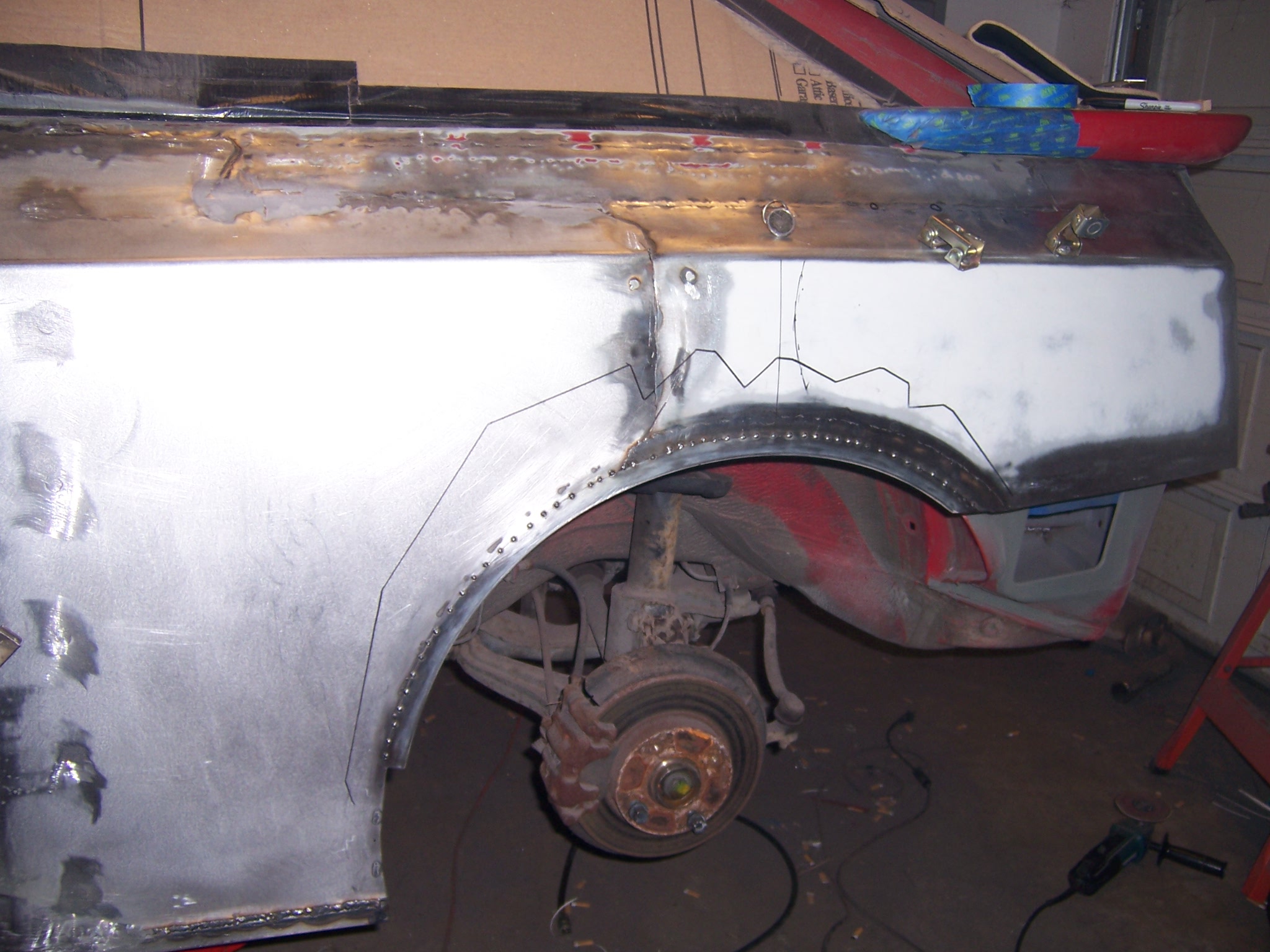

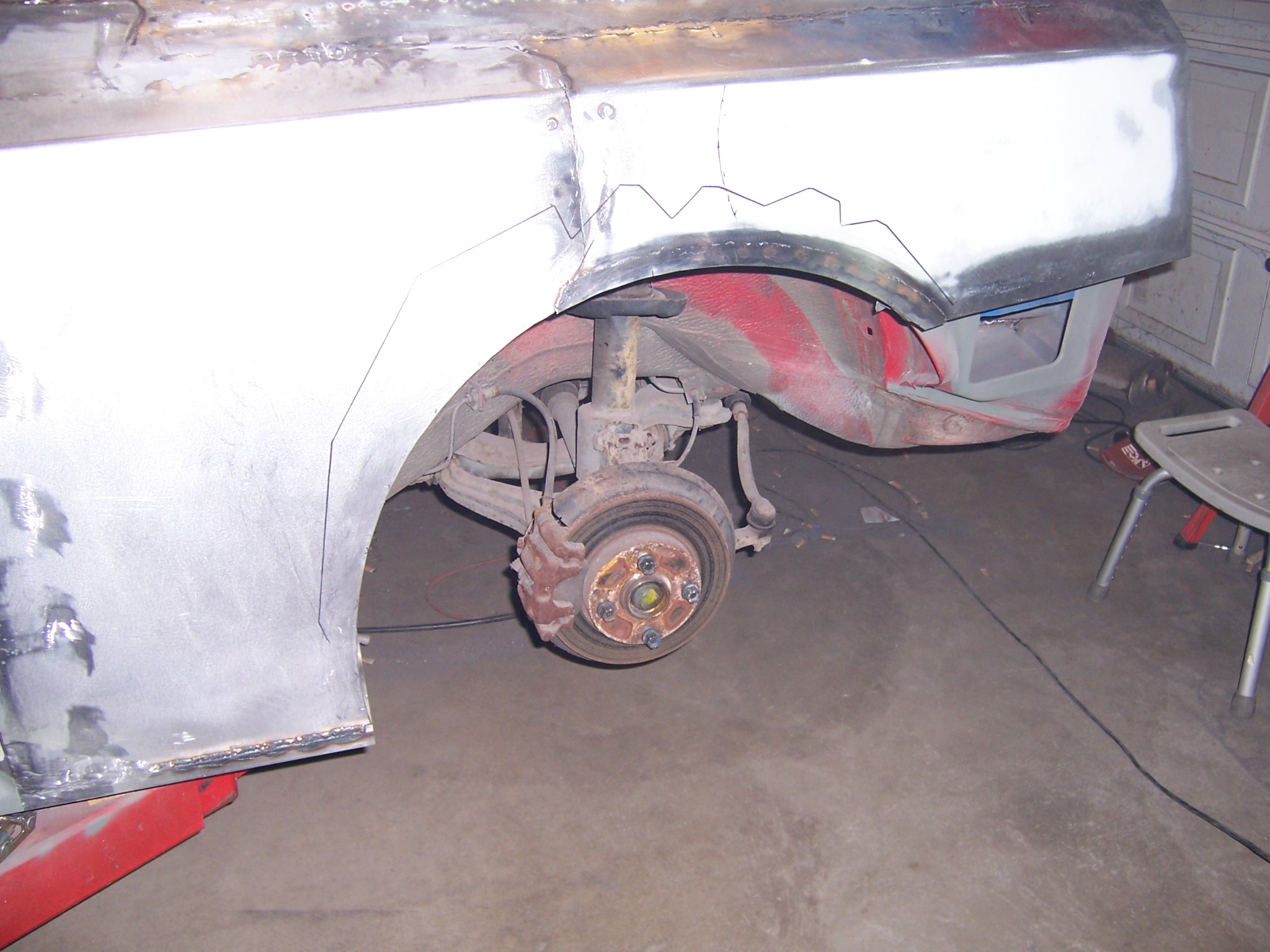

Posted: Fri Jul 14, 2017 12:16 am
by Einbilden
PRY4SNO wrote:Starting to take shape!! Would love to see a side shot to get some more perspective of the proportions
Hope this works for you.
- 100_2647.JPG (544.52 KiB) Viewed 62899 times
There is only two to three feet of room on each side of the car ,which makes it hard for side shots. Car should get moved in the next three weeks. I will take pictures at that point from further away. I cant wait myself to get it out of the garage and look at it from a distance.

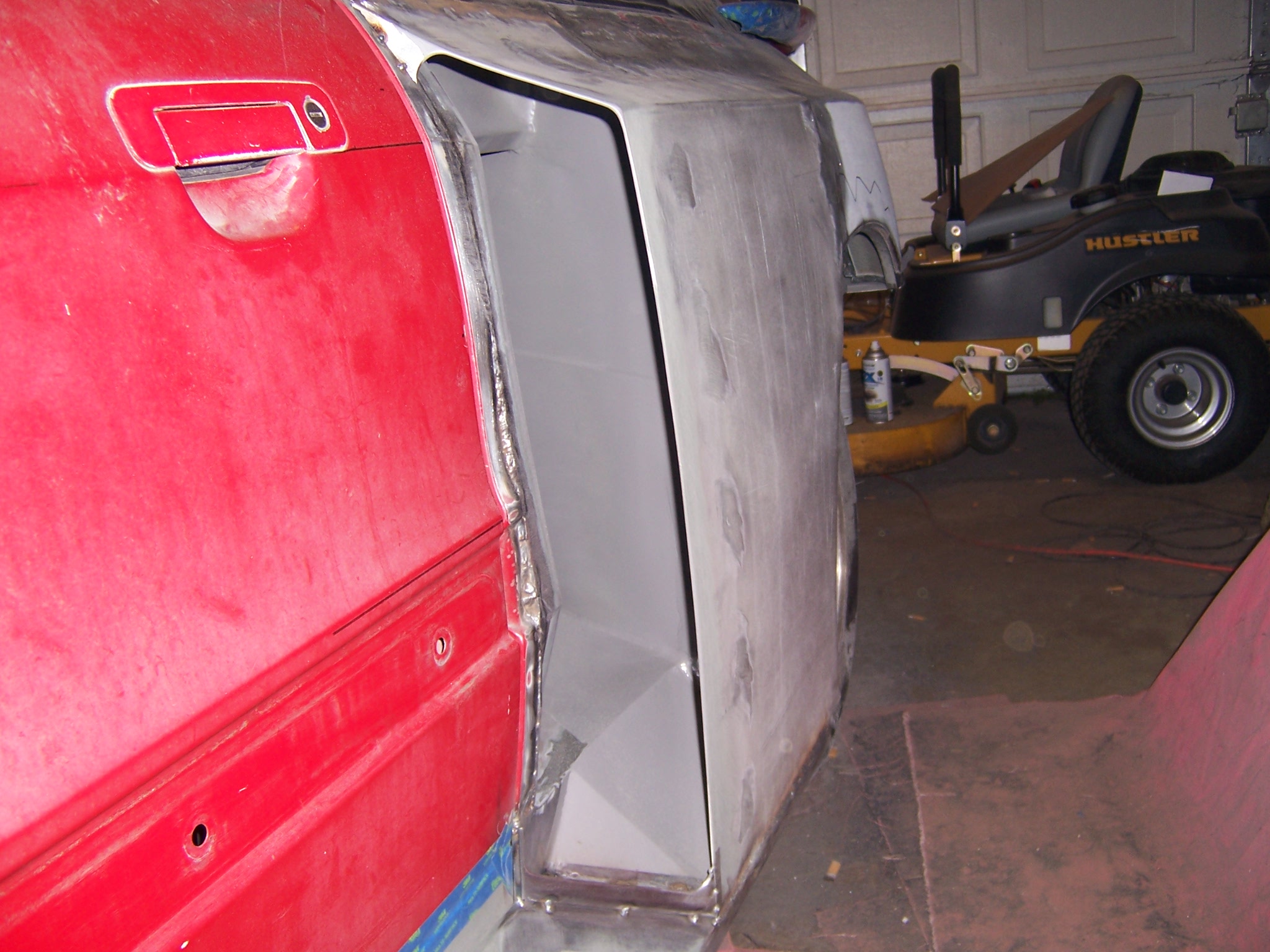

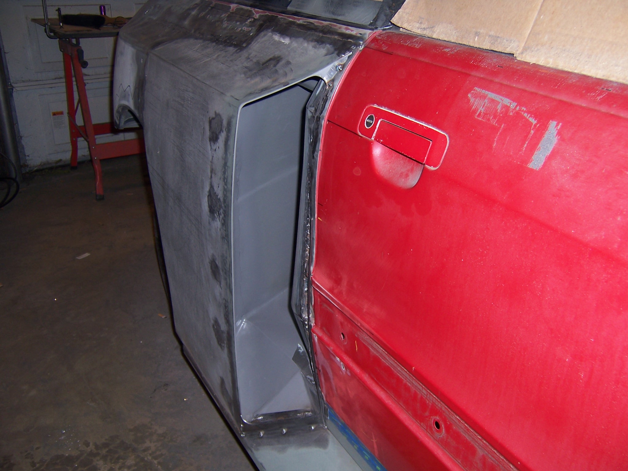

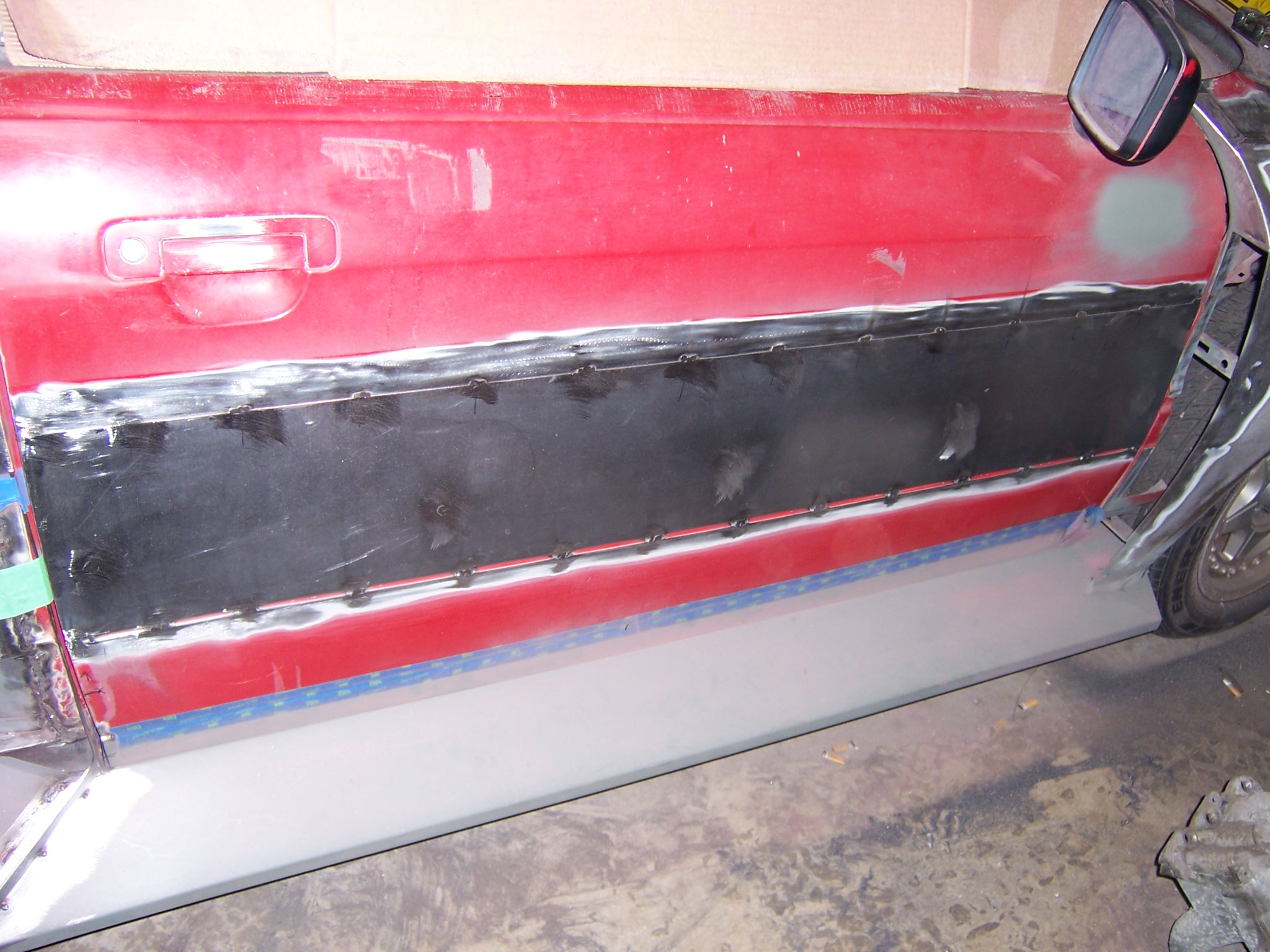

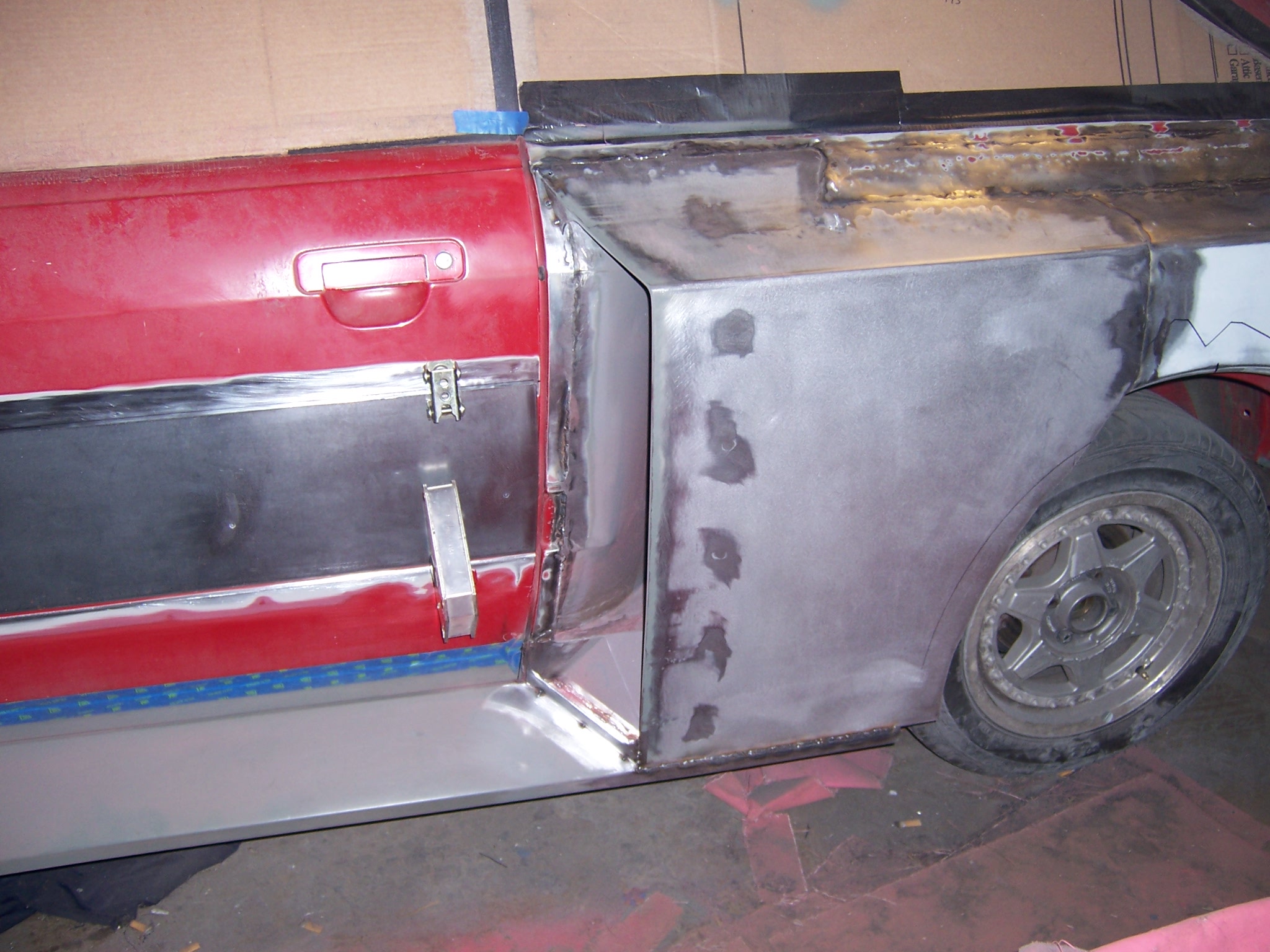

With stuff that needed done around the house and maintenance on the daily drivers, only thing I got done was getting some panels on the doors to make the transition from the rear of the door to the Rad air intake looking better. Also that covered up the indent and the holes for the door bumper/trim.
Both sides look like this now.
- 100_2652.JPG (572.28 KiB) Viewed 62216 times

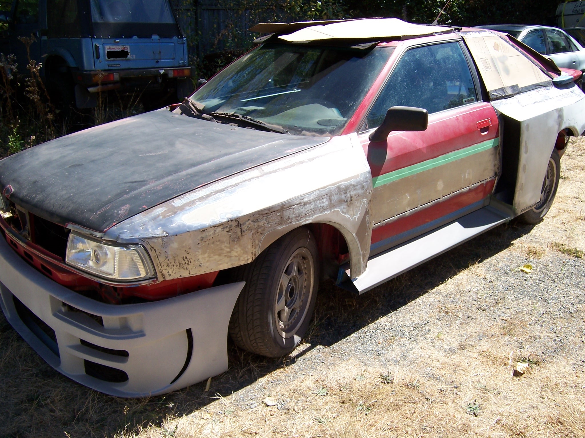

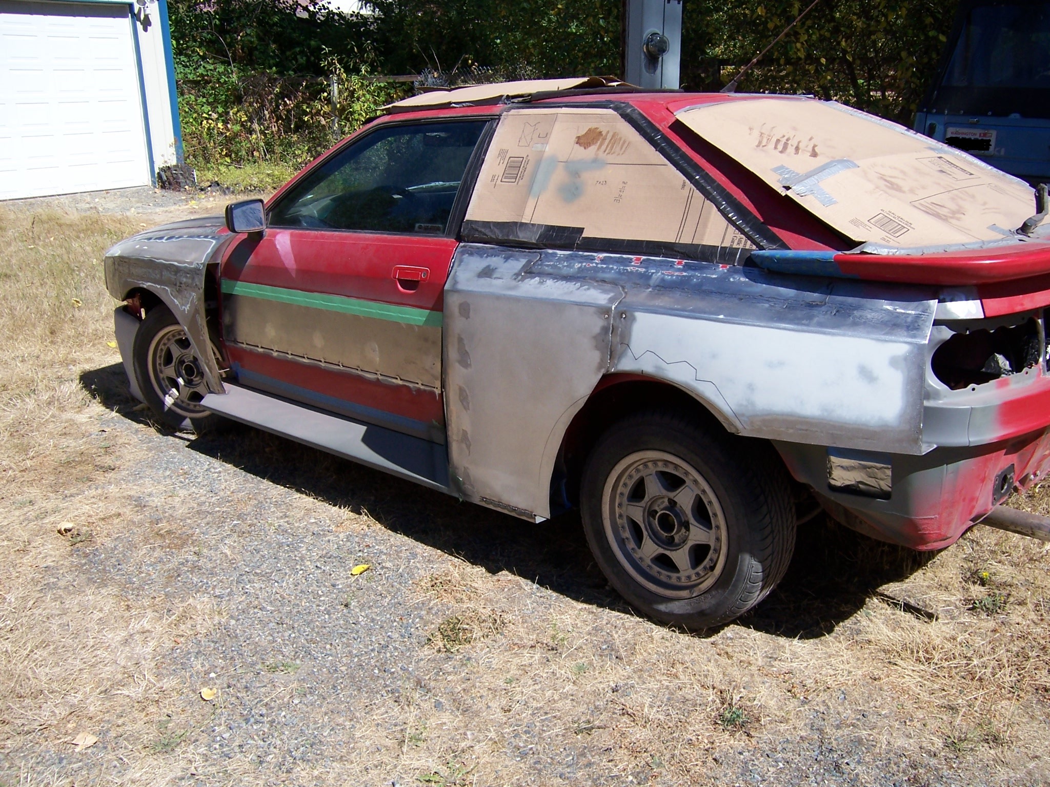

Car got moved the other day and I promised pictures!!!!!!!!!!!!!!!!!!!!!!
- 100_2654e.jpg (1.09 MiB) Viewed 61509 times
- 100_2655e.jpg (1.26 MiB) Viewed 61509 times
Rad intakes are fully welded and seam sealed, fuel filler housing is welded in so at this point there are no " unwanted " holes in the car. Will have to make a adapter for the fuel nozzle to reach as I was unwilling to cut and weld the stock tank. Speaking of tank, you guys remember the battery tray few pages back ? Well on one side I had 1/4 inch interference that could have been made to work but the tank would have ended up hovering over the BAT terminals by 1/2 inch not to mention that the tank would have to come out for BAT replacement. Yup that BAT mount got razzzzzzzzzzzzzzzed. So far the only hiccup although I am fixing to give the Radiator more room, wich is currently occupied by the muffler and exhaust tip so exhaust routing will be interesting when I get there.

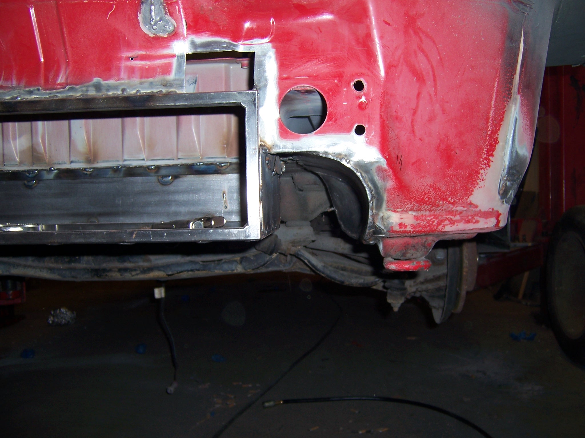

That's all welded in and clad with sheet metal but the rear of the box to make Rad mounting and welding easier. Making a tube so the way out for the exhaust can get done. When that is complete I will move on to the rear wheel arches/inner wheel house.
Posted: Thu Oct 05, 2017 12:43 am
by Einbilden

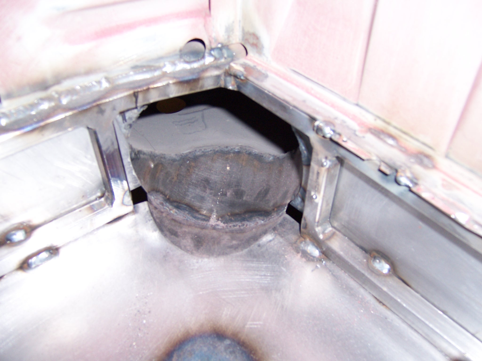

Exhaust now has a way out
- 100_2678.JPG (507.35 KiB) Viewed 61934 times

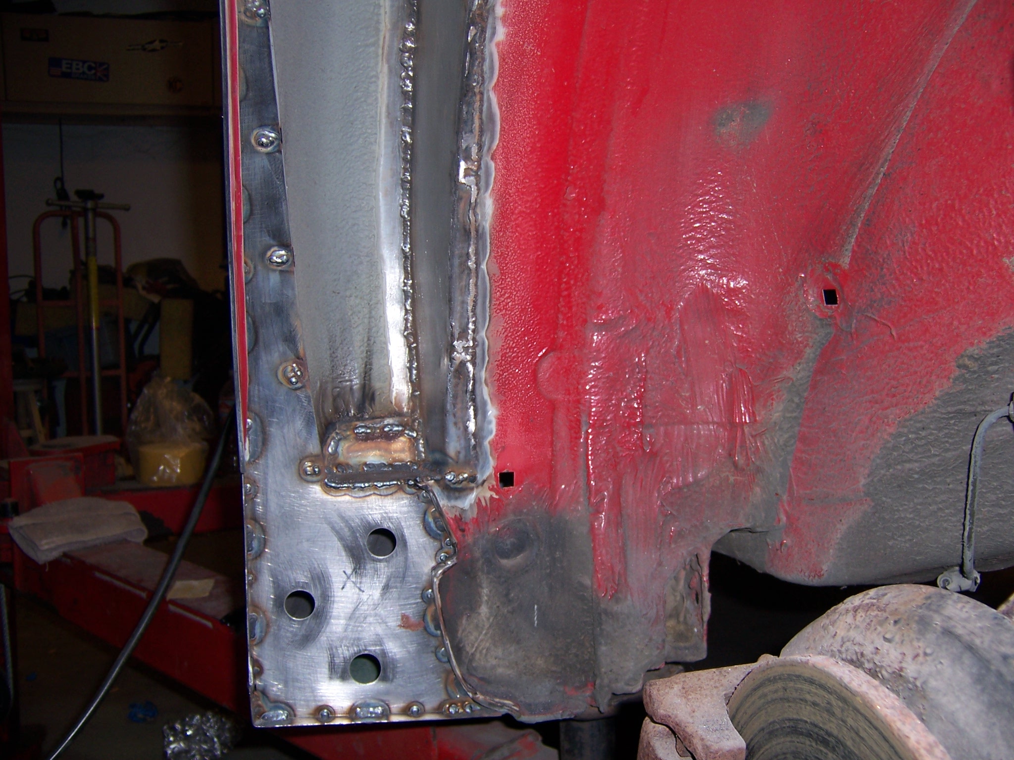

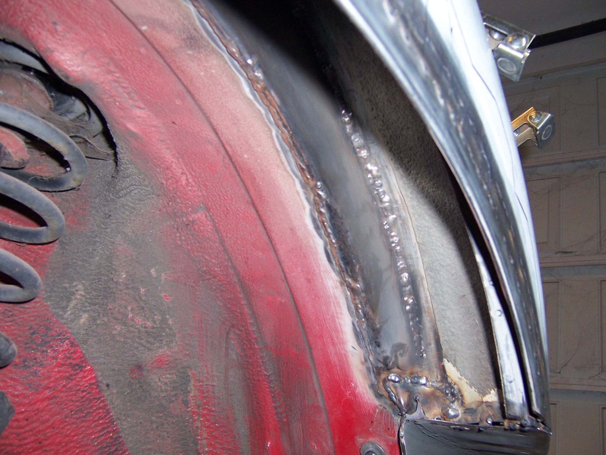

Wheel lip tacked in (other side already welded and ground)
- 100_2694.JPG (484.42 KiB) Viewed 61730 times
Will have to make a piece to bring the lip all the way down to the rockers, but at least I did not have to make the whole thing.
Just some cutting and trimming of the stock audi one.

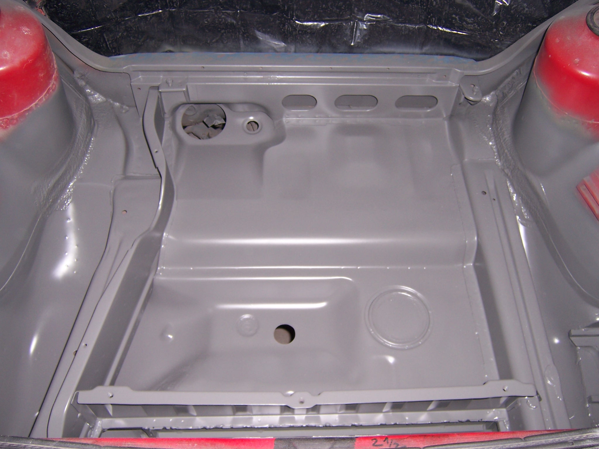

Inner rear wheel well with one coat of primer and seam seal ,needing on more coat of each and then paint. After that probably some rubberized undercoating.
- 100_2710.JPG (611.04 KiB) Viewed 61535 times

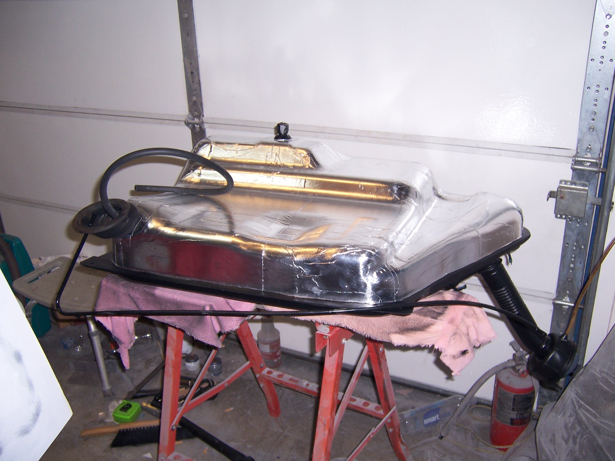

Painted the tank well
- 100_2750.JPG (415.13 KiB) Viewed 61238 times

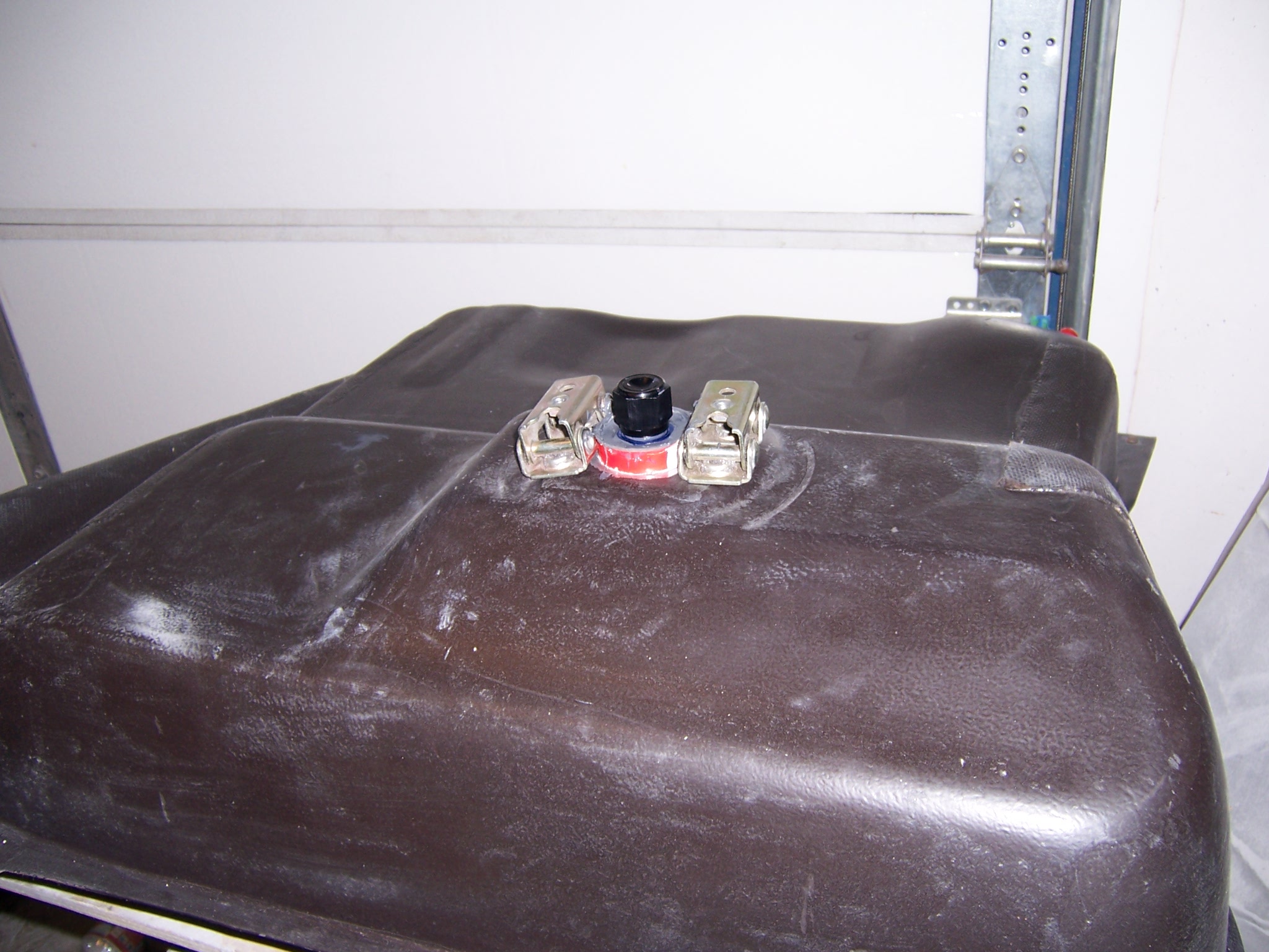

Added 10an port to fuel tank
- 100_2751.JPG (529.64 KiB) Viewed 61238 times

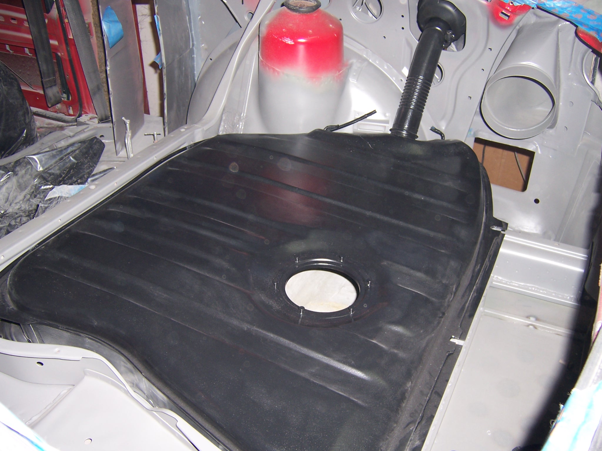

Tank ready to go in
- 100_2754.JPG (498.58 KiB) Viewed 61060 times
Back in the car
- 100_2756.JPG (518.43 KiB) Viewed 61060 times

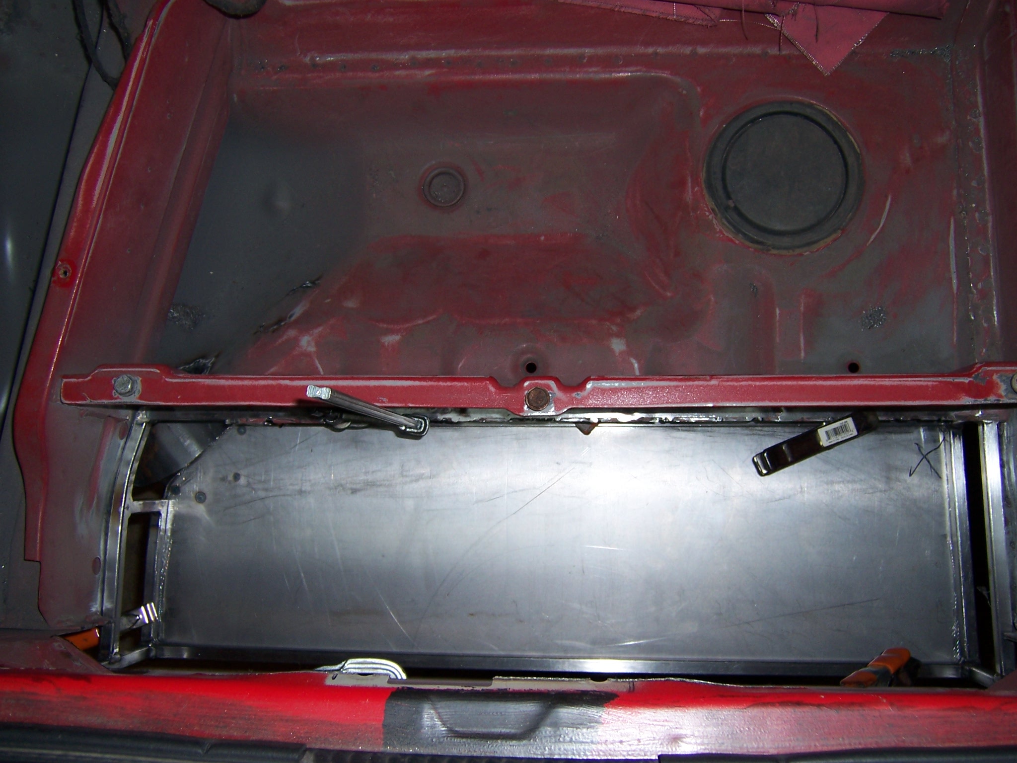

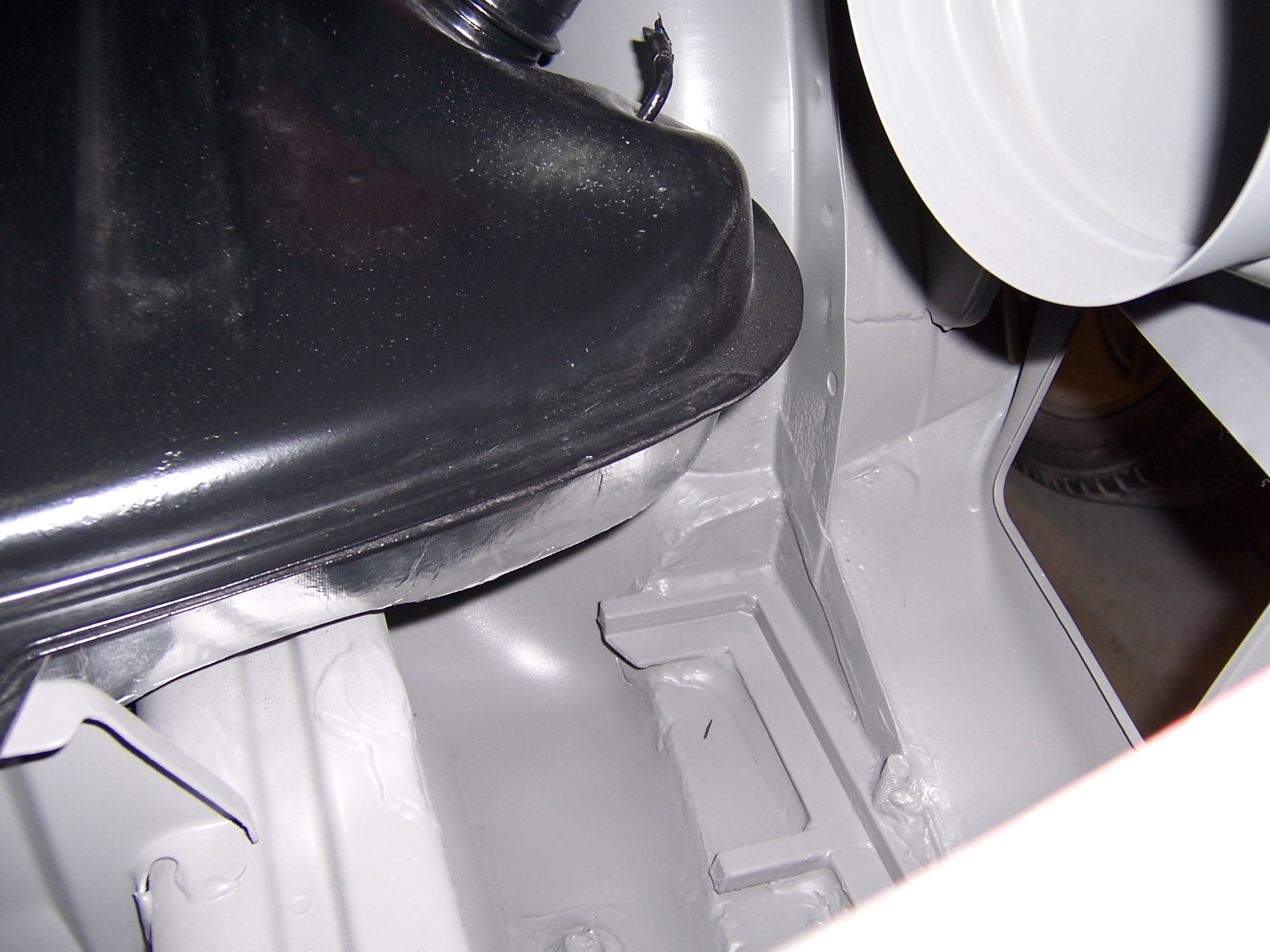

PRY4SNO this is the area of entanglement. Like I mentioned before this could have been made to work but having to take out the tank and rear Rad. ducting to change the battery was not going to happen. Also having the battery terminals 1/2 inch below the fuel tank made no sense.
This could have been avoided had I not assumed that the tank followed the bumper mount rail like on the other side of tank. ( Should have looked at tank before making the mount for battery )
- 100_2757.JPG (428.76 KiB) Viewed 61060 times

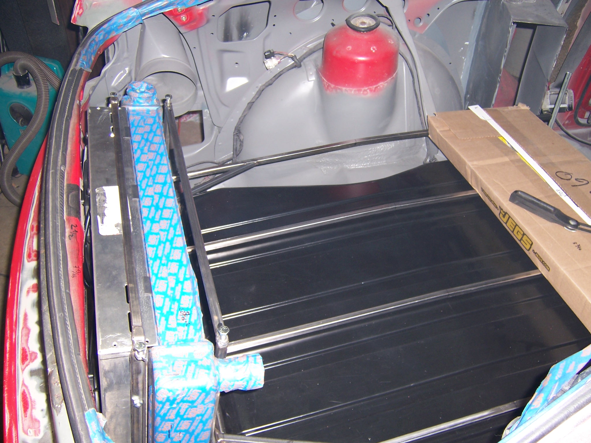

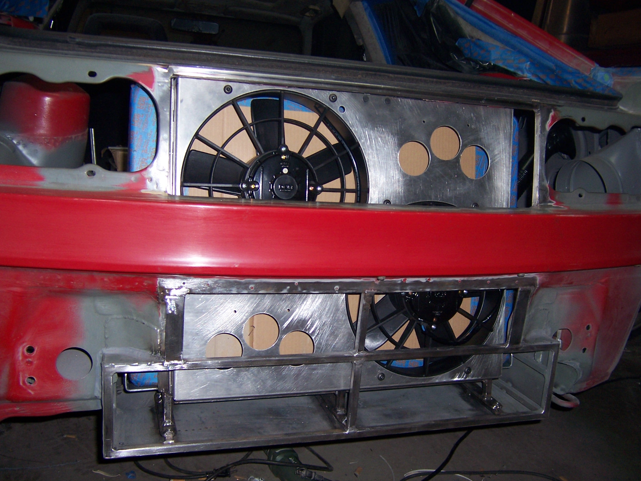

After getting the floor of the ducting tacked in I had some hard targets and was able to finish the mounting for the radiator. Made a frame for the radiator and fan shroud and mounted that to the floor of the radiator box.
- 100_2772.JPG (658.04 KiB) Viewed 59769 times
Although all of this goes in without scraping paint, one of the fans would have been completely covered. So more holes in the car !!!!!!!!!!!
- 100_2774.JPG (644.44 KiB) Viewed 59769 times
