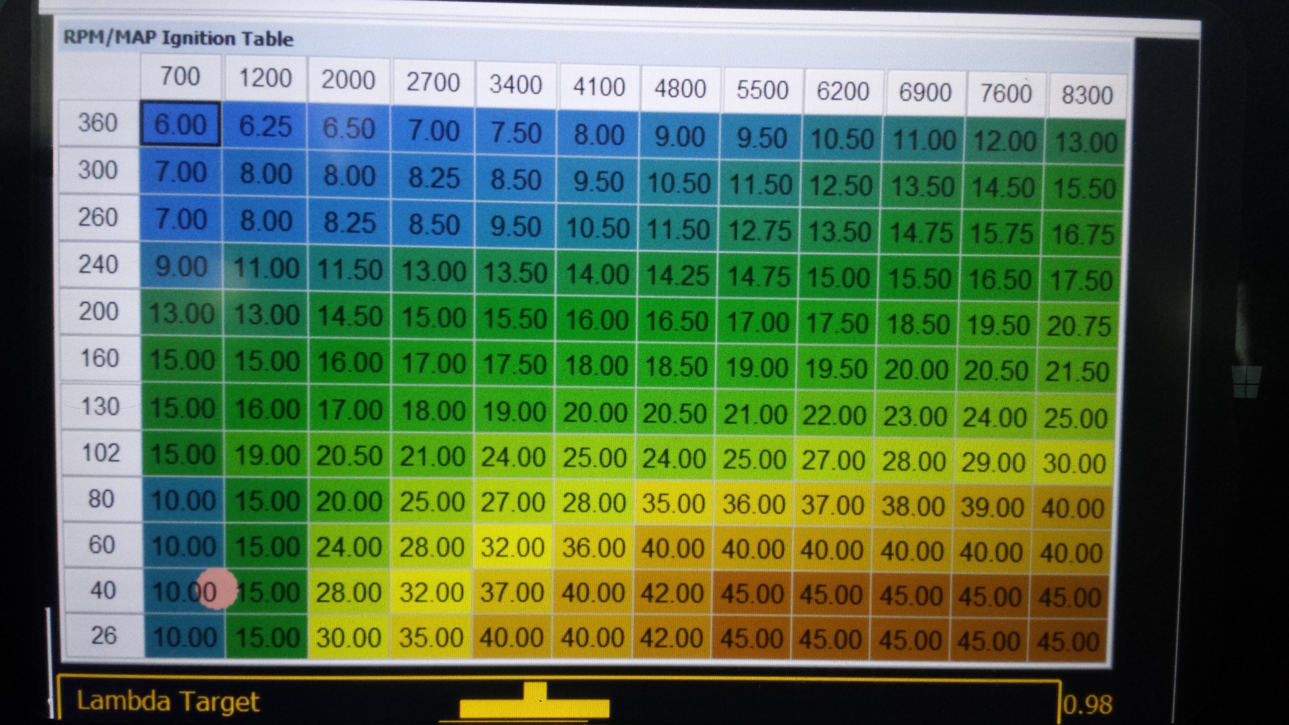

Look what I did! PID varies the max between 260 and 270 kPa. Between 13 and 14 degrees really punches me in the d##k in an enjoyable manner.
I've upped my meth % seeing as my injectors or fuel pump are running out :wah:

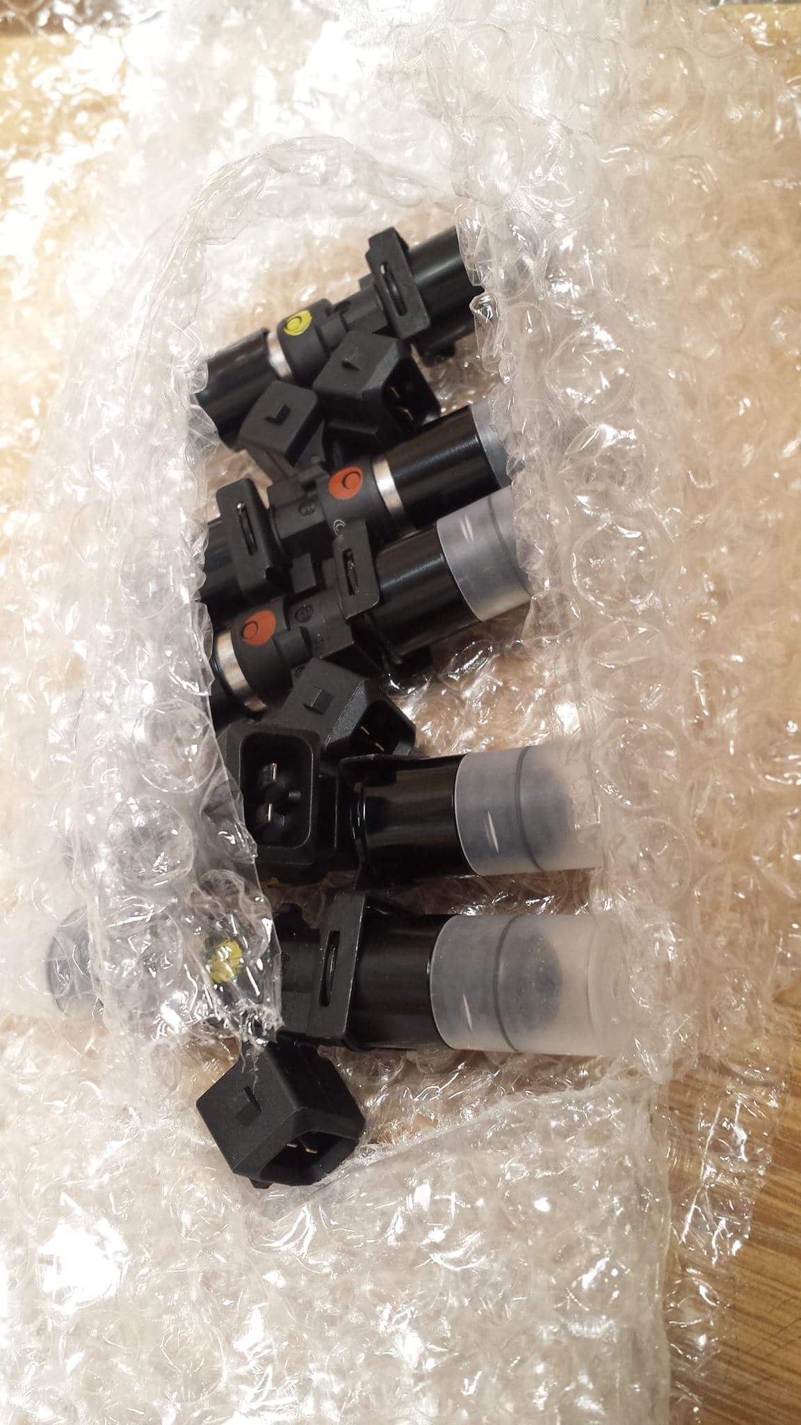

Guess what I DID! Chris helped too!!
THANK YOU CHRIS! Awesome deal man. They're in and I'm driving with the auto-tune going after I changed the e tire VE table to as close as possible judging by idle. Wooo! 1200cc FID injectors
