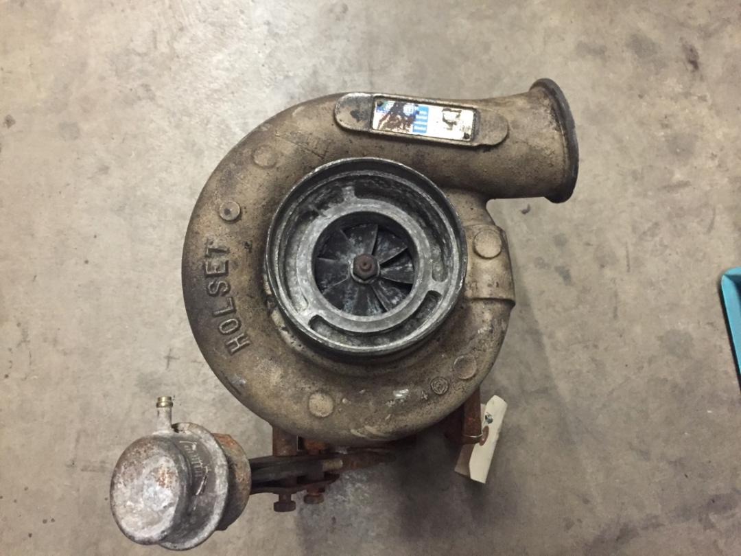

Posted: Thu Apr 07, 2016 8:51 am
Uh oh, it's a 6 pt nut. I don't want to get it balanced so I guess I'll be very diligent about marking all the assembly parts for alignment. Afterall, i did just order the rebuild kit. It's also dirt nasty. Hope I can clean it up easily.
I do find myself wondering if the supplied 12 pt nut in the rebuild kit has the same thread/pitch as the 6 pt and if I can change them but that seems risky considering balance and torque differences. Screw it I'll just reuse the nut
Posted: Thu Apr 07, 2016 2:19 pm
Is there something I should know about holsets with 6 pt nuts?
Posted: Thu Apr 07, 2016 2:22 pm
They are balanced as an assembly :D
Was your h1c a 6 pt?! Lol
Posted: Thu Apr 07, 2016 2:33 pm
I've never heard that. You sure? I think mine was 12 pt.
Posted: Thu Apr 07, 2016 2:38 pm
I have read it around on the diesel forums and other places but it could be garbage EXCEPT for the fact that the compressor wheel doesn't have balancing machining marks (chunks missing). I figure that means the compressor wheel isn't zero balanced :idunno:

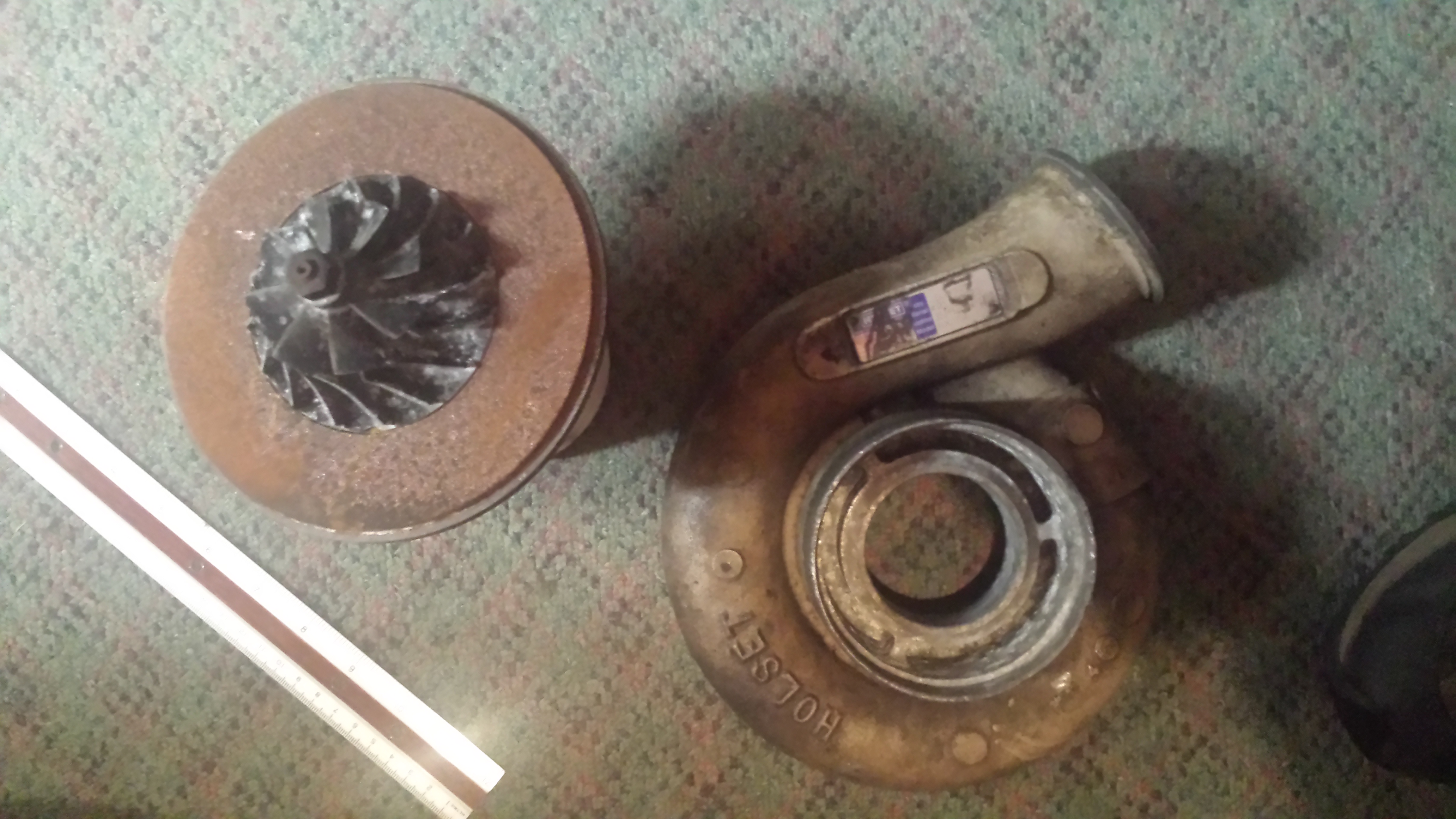

Posted: Mon Apr 11, 2016 12:53 pm
I've got a happy story here for yunz guys :D
Those guys at G&A don't even measure the inducer of these turbos before shipping them (apparently). I just eyeballed the new one with a ruler to the tune of ~2.1875 with a RULER. Sucker is 55.5mm bahahah! I got the monster hx35 on the 2nd shot. Pretty sweet.
However, this snail needs some serious love :(
I suspected it was much bigger when my 54mm comp housing wouldn't fit it either. You know, the painted one they sent that I was hoping to use on this one. This should clean up good still I think.
