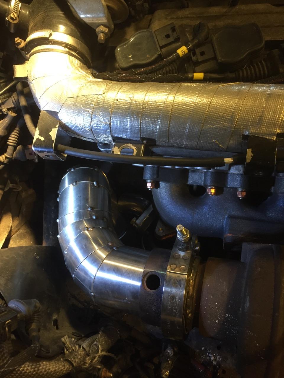

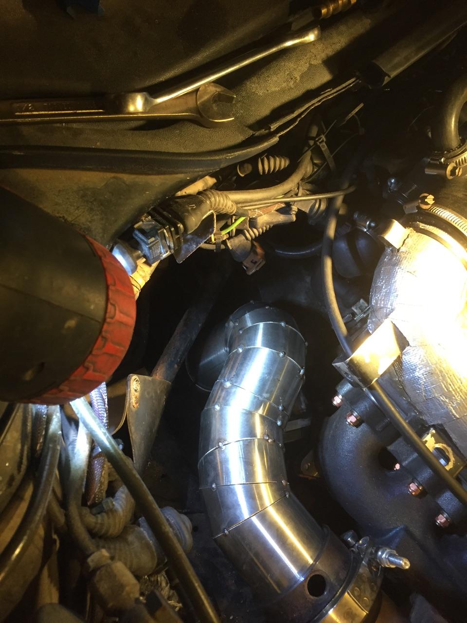

I grabbed the car away from the slow welder since he omitted info that he'd be down 2 mechanics over the next week so my DP would take forever to even get to. I took it to a pro being laid off from GE out here who will have it done by the weekend. No mandrel bending either. All angular cutting/splicing :) He will tie the WG exit back in as well.

Yes I know, and will pay dearly for this :( It was my request though. I said "no mandrel bends"
Now I won't want to wrap it!
Lol holy sh!t that's much "worse" than mine!
