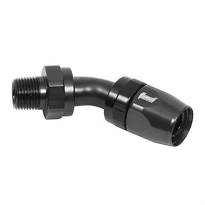

Ok I've ordered all the -4 AN feed line pieces and most everything else. I'm hesitant on the drain line order now tho.
I'm eying the -12 AN option but I think I'd have to use the summit 1/2" npt to -12 AN 45° fitting at each flange. I don't think I'll fit a straight fitting anywhere for that as you said Chris. Of course I forgot about the -3 AN restrictor idea when I got the feed line stuff lol. Now I'm trying to make good on it. Can I pull off the 45° angles at both ends of the drain line if it's a -12 AN line?

Connector in question:

I pulled the trigger on the parts to try it out

Before I respond in detail, I need to slap you if you bought summit fittings.
Posted: Fri Feb 26, 2016 9:24 am
loxxrider wrote:Before I respond in detail, I need to slap you if you bought summit fittings.
Ive learned the hard way to use good fittings.
Posted: Fri Feb 26, 2016 9:26 am
Exactly :thumbsup:
by dana
summit fittings=LOL. They snap very easily.
I just used a bunch of vibrant fittings to build the oil lines for my TDI holset car and found them to be good quality. The price was only marginally more than summit fittings.
Posted: Fri Feb 26, 2016 9:36 am
Not only that, they don't seal well because the taper is wrong or out of spec.

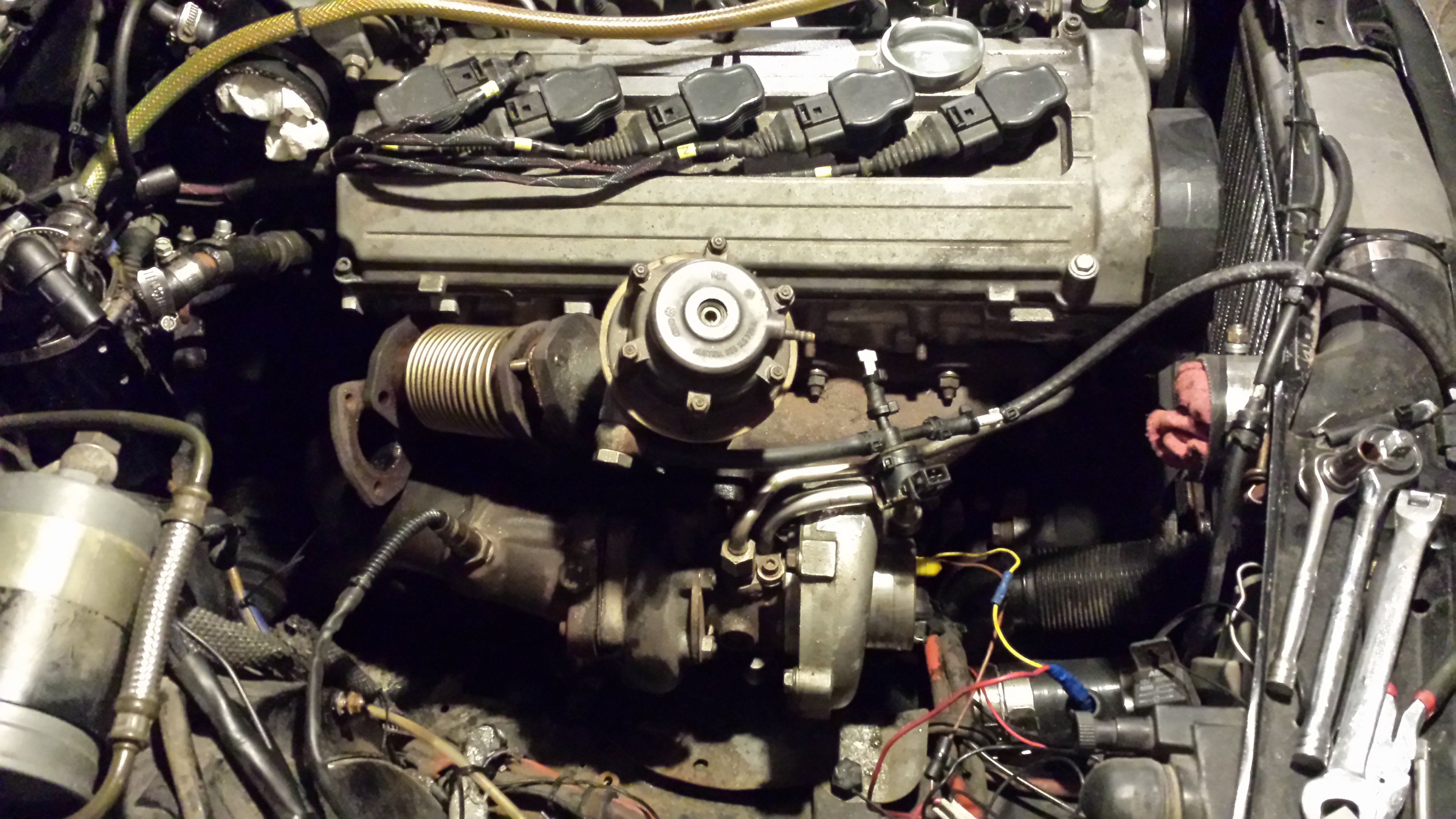

The feed was the only no-brainer in this whole endeavor actually. Found the line complete on ebay. On its way as of today. Went with the 24" line after measuring some things on the spare motor.
Got a good start tonight kinda

As I'm waiting on parts I'm starting to break free the bolts for the turbo drain line flanges ar the block. Got the coolant one fine but the oil one us killing me. I had to drill a small hole in the flange leading to the bolt thread to spray PB into and that's where I've stopped. Nothing has rounded out yet but I'm feeling confident about the he head holding. I'd rather have a bolt on there. I have vise grips on it right now. It better come out one way or another!
Posted: Sun Feb 28, 2016 9:49 pm
Uber progress made. Everything is ready for installation. Coolant system has been sealed and filled and my female 1/2" npt oil flanged are going on tomorrow for when the oil drain line pieces arrive. Getting happy pants here
