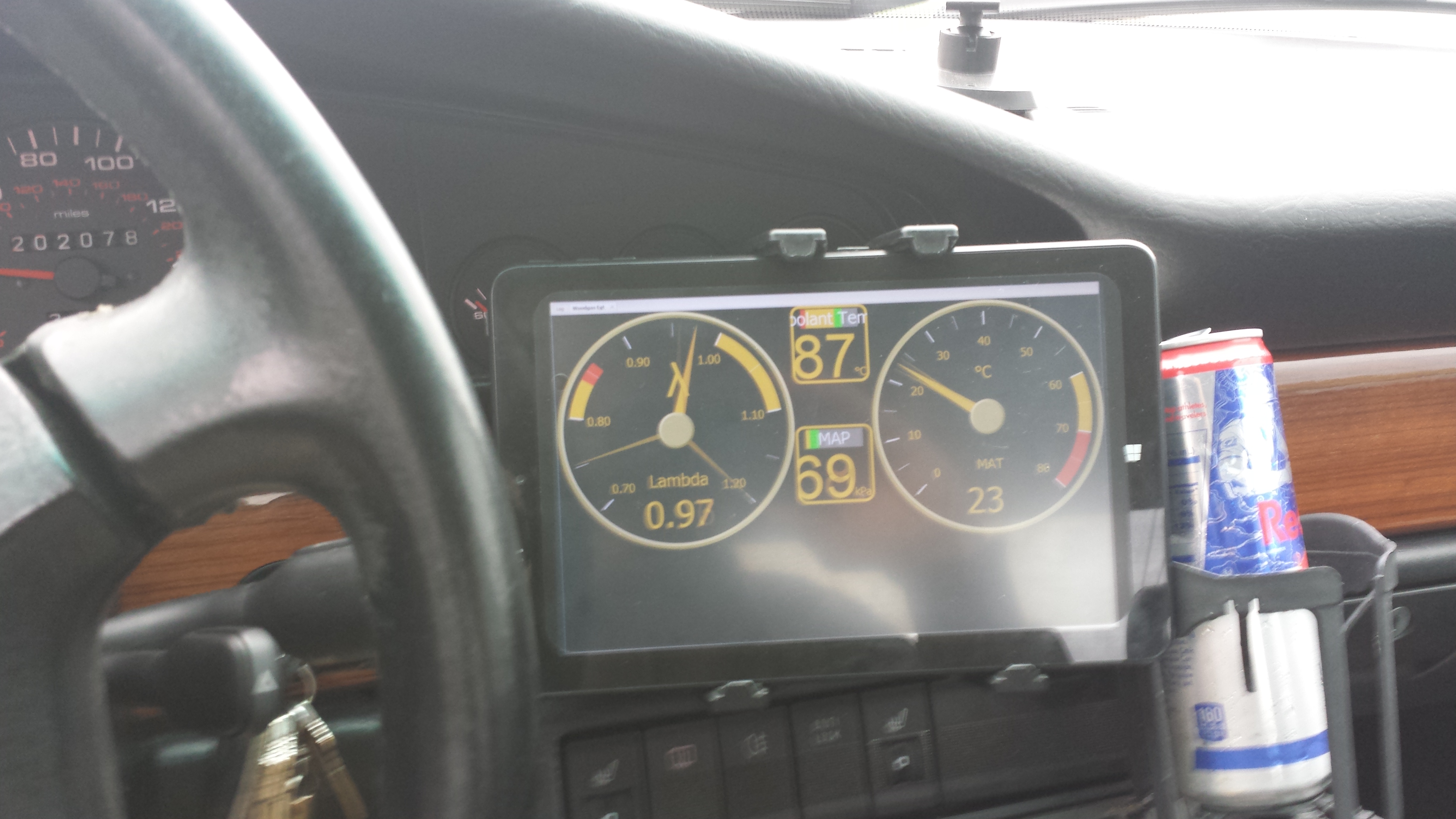

Apologies to that other fella for high jacking his bluetooth thread. My "affordable" asus android tablet smacked the concrete 2 days ago while I was throwing it like a frizbee from my hand as I walked to my place. It was pretty cool. Battery came unplugged inside and it played dead until dismantling.
In comes the insignia (bestbuy I'm told?) Windows 8.1 tablet with bluetooth I got new locally without the box for $40 off the retail price. So awesome, this thing! It connects to the BT dongle really well so I can log/tune all on the same interface. I made a gauge face that resembles my 4 most important gauges from VEMSdisplay. I even tried bluetacks android emulator to get back that app I miss already :( It took some coaxing to even get bluetacks to work on a 1 gb ram OS but I only knew what to google so I didn't hack any of it myself lol.
Well I got VEMSdisplay to start and all but it sticks at the point of asking my "phone" to turn on bluetooth. It was all a bust. I hears interesting things about apps interfacing perfectly using the emulator but this sucked.

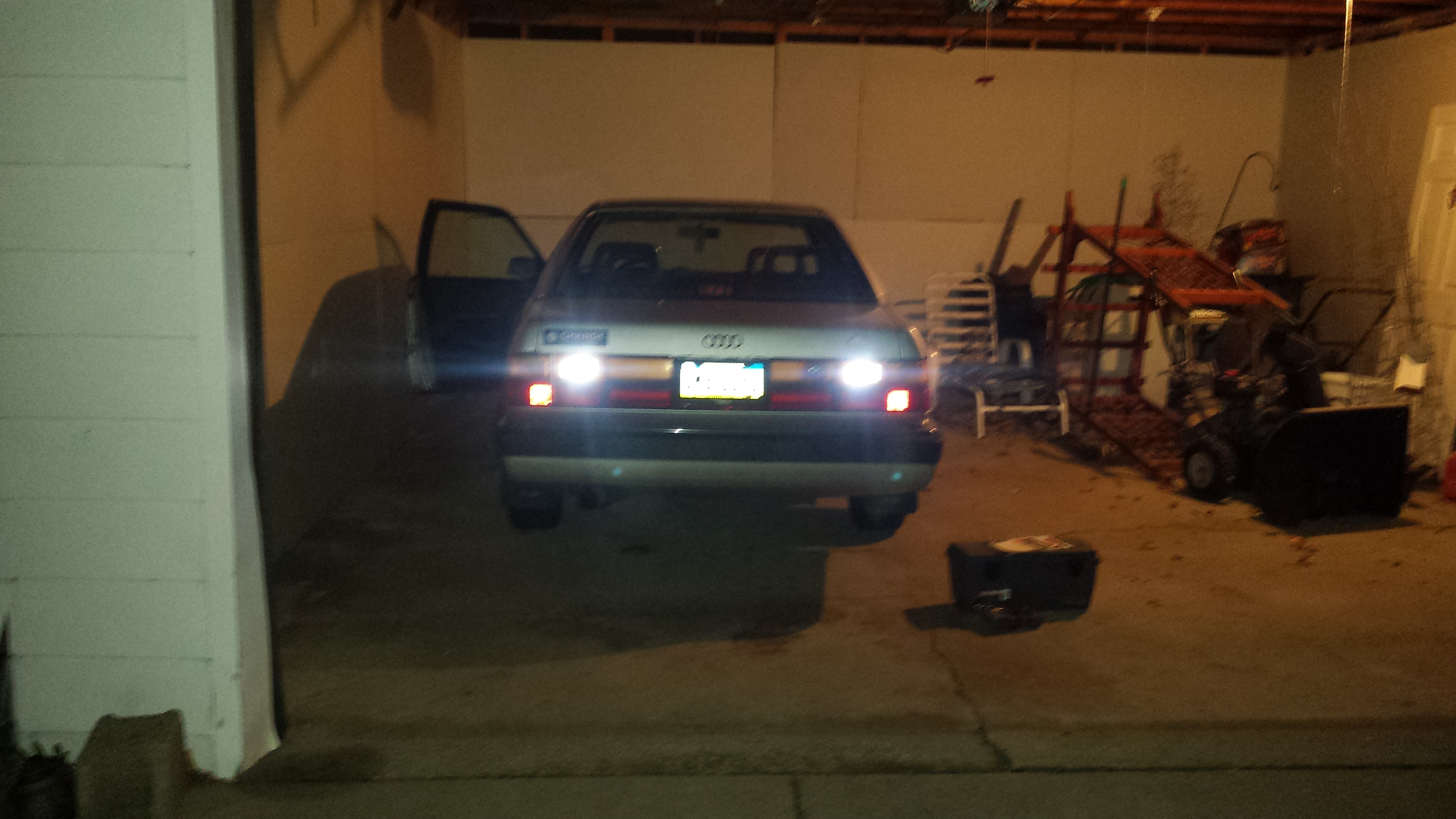

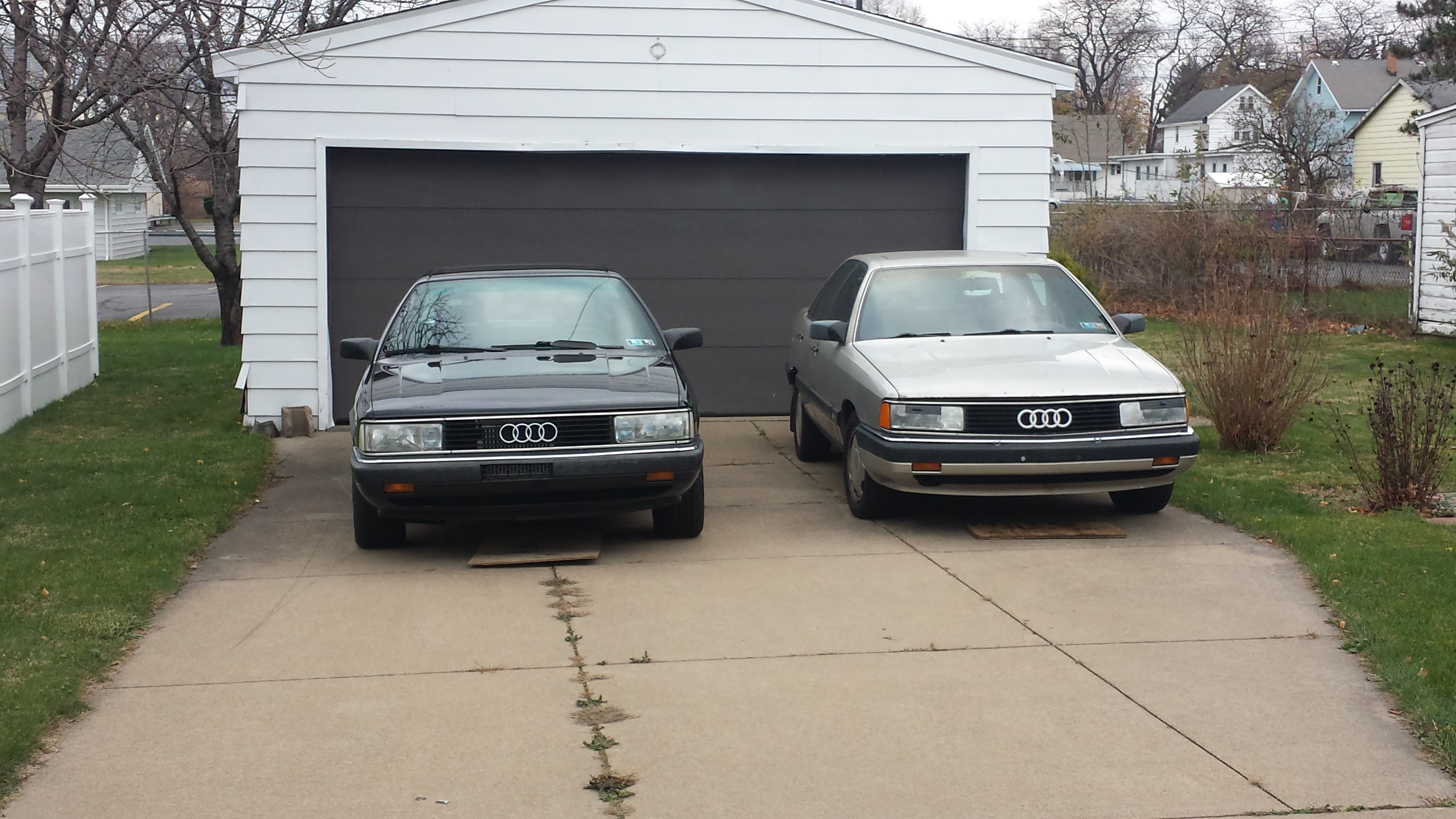

My girls :D
My LED reverse bulbs REALLY worked out well

By the way, your cars look great in that picture, especially the 20v! I always wished I could find one in Black or another dark color. My avant is close enough to dark I guess lol.

Thanks for the kind words :) somebody saw me at the gas station and said the 20v was the sexy one and asked why I even drive the 5k. I've been through alot with the 5k and it's sentimental. It's not about "looks" for me hah. With the 200, it's the total package for me. Great car and great colors..
