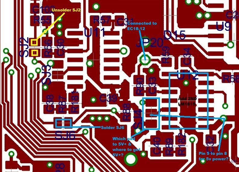

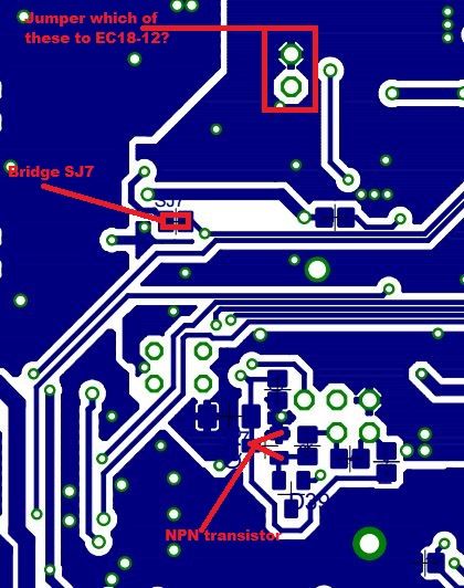

Well thanks to marc i got the hardware i need to add. i have most of it installed but i have a few questions about some of the hardware still.
So far i unbridged SJ2 and bridged SJ6 added the second LM1815, Bridged SJ7, added the resisitor to R248, removed the 0 ohm resistor and added the NPN transisitor.
I just labeled on the VEMS schematic to make it easier to see what i did and what im trying to figure out yet.
My first question is where to get the 5V+ for SJ7?
Next is JP1 and GND 5v1 zener diode cathode to JP1. Which is JP1? each of these pads connect to different pin on the processor.
Now the Connection EC18 pin 12 to the input of the 2nd lm1815, namely JP20. Which side of the jumper goes to EC18-12? in the diagram below i have the bottom side of the board.
lastly i dont understand JP5 and JP1 2k7-10k(Optional for sectrig scope). if the zener diode goes on JP1 how do i add the resistor as well?
i have 2 resistors left after adding all the hardware too. sorry for being such a pain about this but i dont want to screw it up and ruin my ECU before i ever even get to drive my car on it. Ive tried to find pictures of other ECU's that have this modification done but it seems none of them have anymore than the 2nd LM1815 added, SJ6 and SJ7 jumped.

i have everything figured out except the zener diode on JP1.

Wheeljack
Posts: 314
Location: Ute Territory
Re: Convert VEMS econo seal to PNP for URS4.
Post by Wheeljack »
Isn't the blue line just going to a via, not a pad? You want it on the yellow pad, I would think.

Marc
Posts: 1586
Post by Marc »
vwnut8392 wrote:My first question is where to get the 5V+ for SJ7?
you mean SJ4. the reason that solder jumper has 3 pads is you can select what you are sending to sj4 input pin based on which pad you solder. in your photo, connect the bottom 2 as shown in your photo and it will bet set to +5.
regarding jp1 its actually neither of the lines you have drawn. stripe of the diode faces the upper left hand pin, other side of the diode can go to either of the two large through holes on the bottom, they are both ground. but on this PnP here in front of me they used the one diagonally across from it on the bottom.
top top hole is the ground plane (see it connected to the huge pad via those 4 points?). bottom hole is the signal pin path.
in parallel. axial components are easiest or just solder the resistor to the board and then the diode to the edge of the SMT resistor.
hope that helps!
