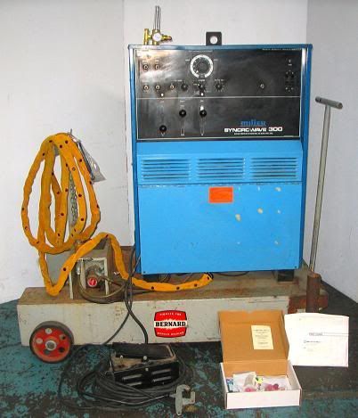

If you have the room the older Synchrowaves are great welders... but like the Dialarc they're power hogs and a fair bit larger than the Dialarc.
I bought my Synchrowave 300 for $650 about 4 years ago with a new watercooled torch, lead, and lead cover... there are deals around if you look (found mine on EBay).
like I said, not a small rig... Image

JustinB_20vt
Posts: 68
Joined: Wed Feb 27, 2013 12:15 pm
Location: Phoenix,AZ
Re: should I buy this welder?
Post by JustinB_20vt »
Heh small... I amost bought an Miller Aircrafter a few years ago which is like a syncrowave only heavier.
