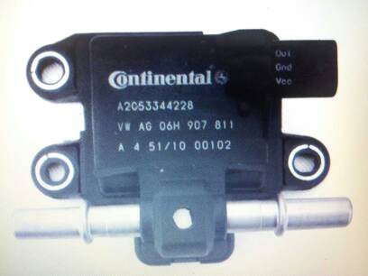

Re: AW: E85 Content Sensor Options
Post by audis2turbo »
Vw part.
It is much cheaper and works good and it is the same as Zeitronix
Gesendet von meinem GT-I9100
