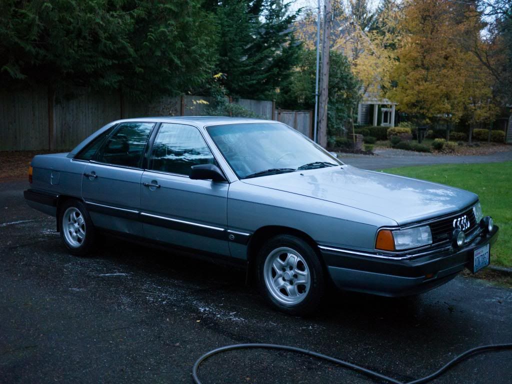

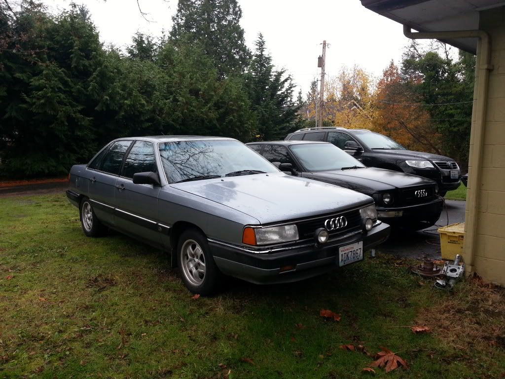

Introducing my new 87 5000CS Turbo Quattro in sapphire!
Has a few problems, mainly a hot start issue. Car starts up and idles perfectly when it's completely cooled and continues until it's turned off. Once it warms up, it will not restart until it's sat for 6+ hours (even immediately after you shut it down). Ran the codes and it came back with 2312 - engine coolant temp sensor. I'm guessing this is the single-wire temp sensor and not the multifunction 4 or 3 pin sensor? I'll probably just replace both. I swapped around crank sensors (came with a few extras) but that didn't change anything nor did an icepack on the sensor so I'm guessing it's not that. Car also seems to have low boost, I can get a max of 1.3 bar in 3rd gear at 4k+rpm. Most of the time it's around 1.1-1.2 and very slow. SJM reading makes me think that some of this could be related to the bad temp sensor. I'll pressure check the intake anyways.

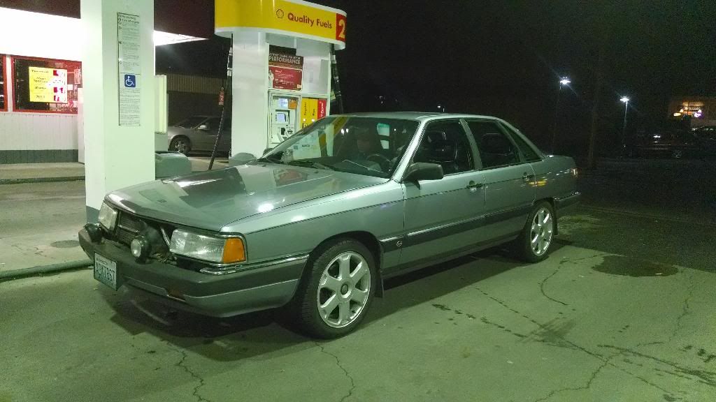

Has the option Fuchs in good condition. I also picked up a set of B5 S4 Avus with winter tires that I'll be putting on this shortly. From what I've read they'll fit, but I probably want spacers in the front.
Not much planned for it, just get it running reliably and up the boost to 1.9bar
Wheels look good!
