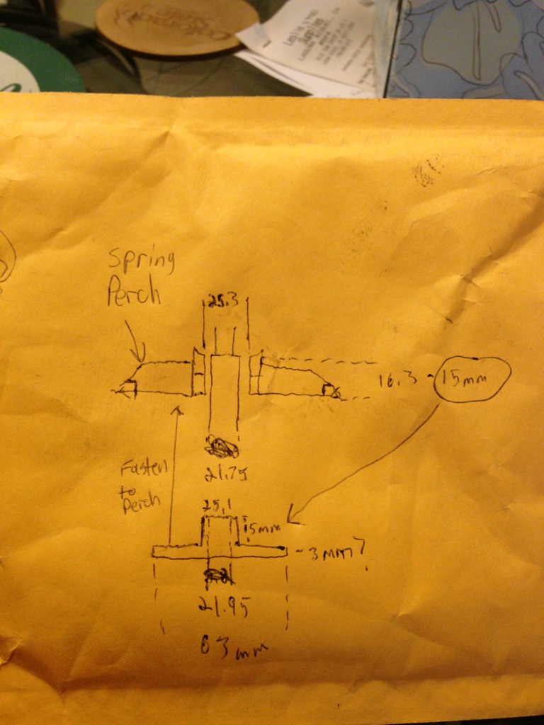

Re: Weld in universal strut top
So for the GC strut mounts, the koni shock is about 3mm smaller in diameter than the hole in the spring perch. Is suspect this adds to the noise because the top perch can pivot and let the spring deflect from the centerline. I am thinking about adding a spacer like so to try and quite down some clunking I can't seem to get rid of.
Thoughts?
