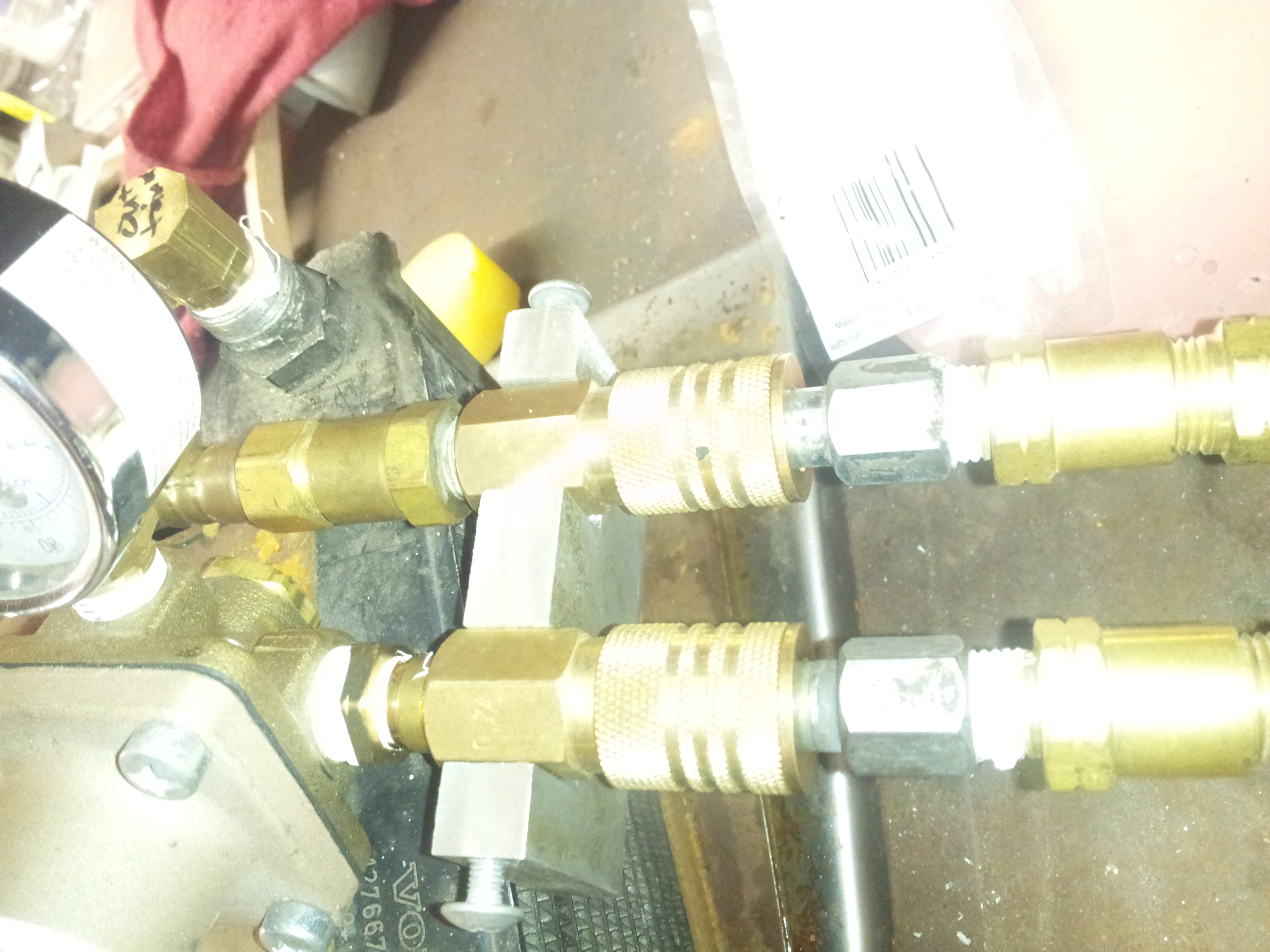

Here is a couple pictures of a homemade tig torch cooler I'm in the process of building. its actually functioning now but need to finish the case for it and mount everything, I found a few versions of this online so figured it couldn't be too hard.
its built out of a fountain machine carbonator using a 740t oil cooler as a heat exchanger. i just used air disconnects on the lines with left hand thread adaptors, considering a miller coolmate cooler is 500+ this is going to work out perfect. I'll post finished pics in a week or so hopefully.
A little bracket i made on the bridgeport quick.  its going to mount to the back panel of the enclosure
2013-07-26 06.21.04.jpg (2.08 MiB) Viewed 7008 times
2013-07-26 06.20.40.jpg (2.91 MiB) Viewed 7008 times
