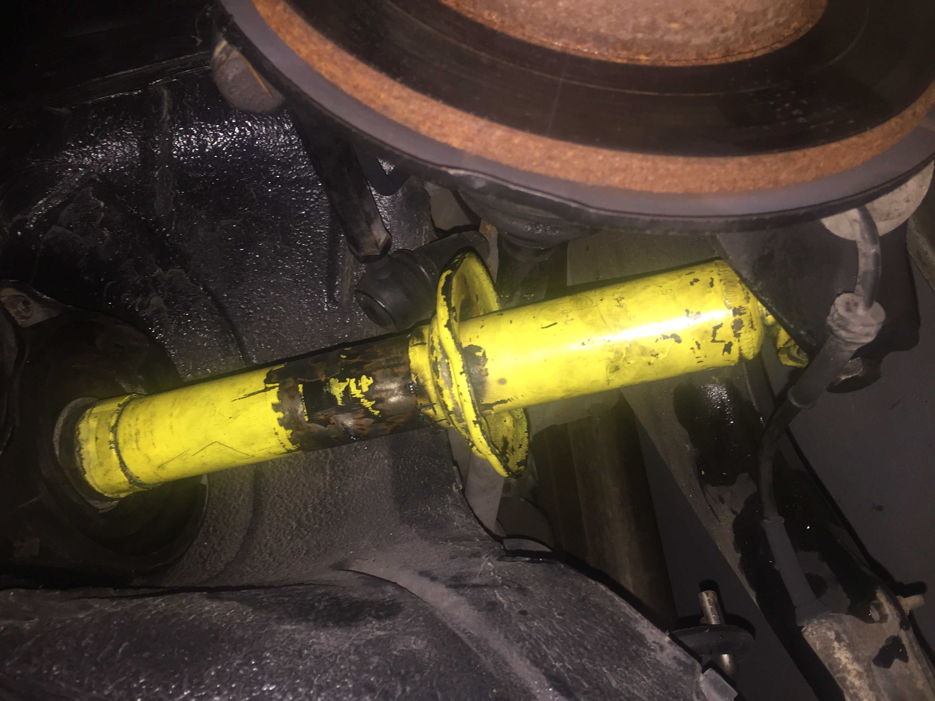

Here it is on the car

Are those stock bushings you redid?
Or are the blue sections an aftermarket solution?
20VAvant
Posts: 370
Location: Florence, KY
Re: Rear Coilovers for 1991 Audi 200
Post by 20VAvant »
k2exoman wrote:Are those stock bushings you redid?
The blue bushings came with the upper tie rod bar. The ones for the sub-frame are UrS4 aftermarket Rear sub-frame from Apikol with a new inner sleeve I had made at work to fit the 200.
