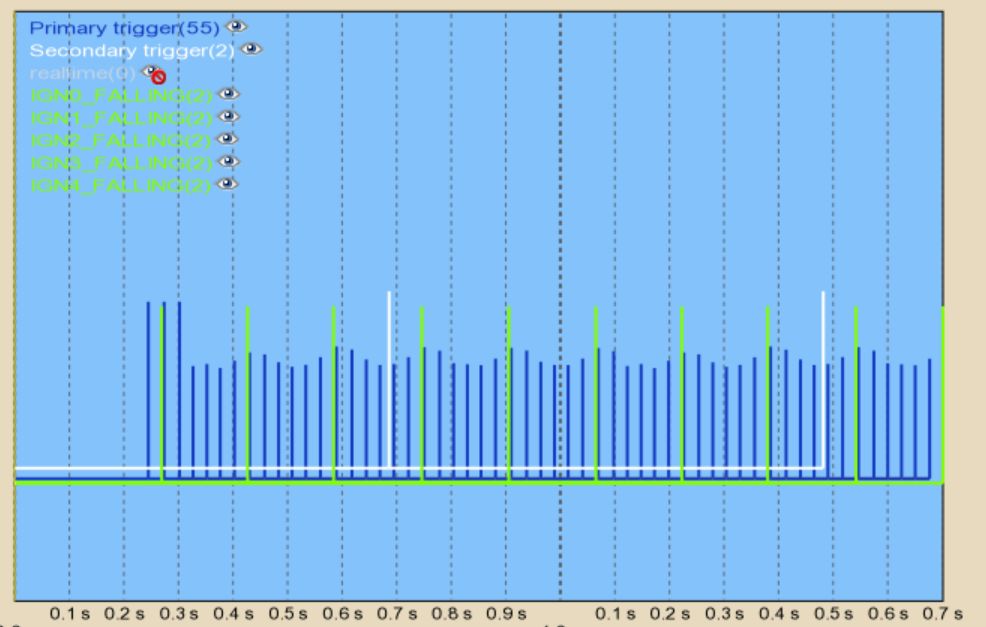

I have a triggerlog and a config file that i sent to Marc. But im sure it will be a while before he responds.
FIrst time triggerlogging and i can only do it while cranking so its short.
Also when i try to log it says not enough data most of the time.
When i "test" both spark and injector on the visuals page both injector 1 and coil 1 (numbers on the left column) correspond to cylinder 1 and so on.
On the triggerlog there are 15 primary ticks between every secondary tick which is good i believe.

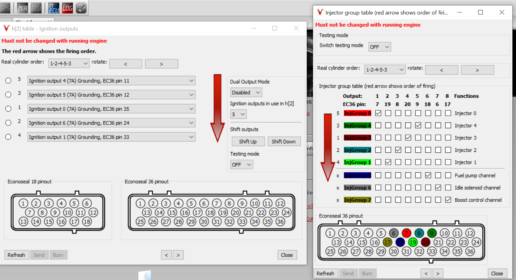

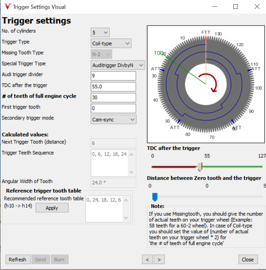

Timing light solved everything! Cylinder 1 was firing at tdc for cylinder 4. Even though when i tested all the outputs the injectors and coils correspond to the same cylinder but i guess vems doesn't care. I dont want to call it stupid as its probably a case of me not knowing whats going on.
Can someone chime in and explain? Is there anyway to set up injectors and coils via only software and know with confidence that they will fire in the correct cylinders?
Also my TDC after the trigger was off about 2 degrees so i got that adjusted as well.

It's stupid, no other way to put it. No excuse in this age of tech to have such a convoluted mess to setup the engine timing. But, you figured it out! If you want to verify they are in the correct firing order, do as I state above.

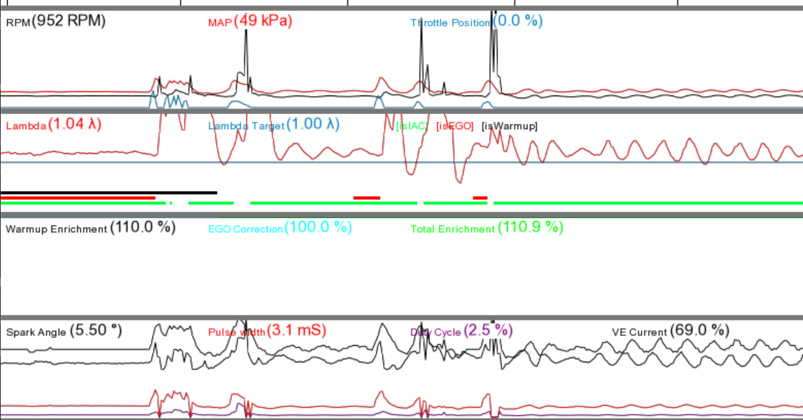

More issues!
Car idles fine. As soon as there is any throttle input it stumbles and thinks its at 8k rpm. The actual rpm wont increase at all since it starts missing right away. The strange part is its immediate as soon as the TPS clicks without even physically changing position it will do it.
Anybody have any ideas?
There are a few less ptrig and less strig when this happens too.
Re: Anyone have Vems + 01e w/ 7a flywheel?
Posted: Thu Dec 19, 2019 11:12 pm
by quattrobros
This is so strange seems to happen only when the iac is off.
Its not like im revving it and getting a trigger error because the engine speed is too fast for the sensors to keep up. There is no physical change in rpm contrary to what the log says.
It has to be when the switch in the tps is deactivated there is some electrical noise causing the sensors to freak out. Injector pulse width and duty cycle drop to 0 when the rpm peaks as well.
