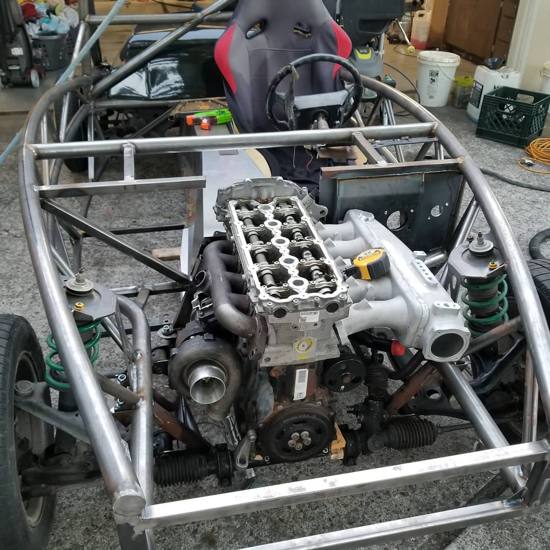

hello all, i am not sure how busy this site is, but i wanted somewhere i could post this and get actual good feedback from people who have done projects. My build is a Exocet and im running a T5 transmission with a RWDmotorsports bellhousing, will be turbo running on stock ecu with a flash tune, most likely dialed down because the car only weighs 1500lbs and will be running 91 octane, currently i am in the proccess of waiting on some parts so that i can throw the transmission in the car, the intake manifold is an IE manifold that i cut and flipped, also using a ECS S4 flywheel for the bigger disc diameter with a RS4 pressure plate here are some pictures
- 40485989_243413636367646_6398200553500566264_n(1).jpg (152.82 KiB) Viewed 31299 times

Welcome! People around here are always up for another 07k Project, excited to see this come together, I auto-x with a couple guys who run Exocets, all of which are Miata powered, so cool to see something a bit different

Nice oil pan solution, cool project

just got my throw out bearing spacer. it was too big and the hydraluic throw out bearing was bottoming out before the bell housing could mate to the engine

got the radiator mounted, turbo manifold is welded up, also got an alternator and going to start plumbing the oil cooler and radiator hoses
