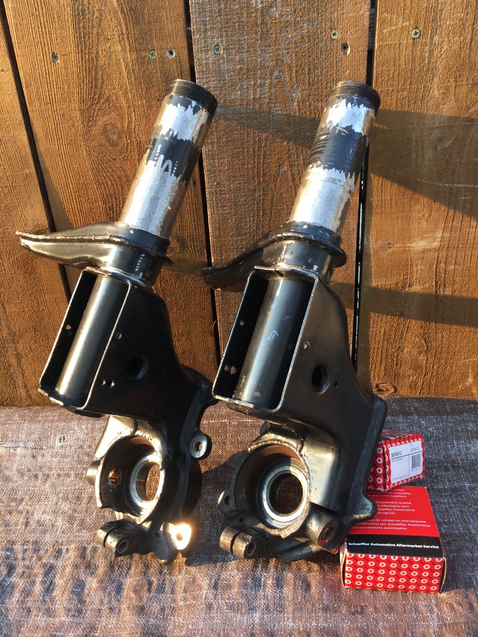

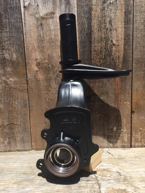

First thing's first. We will need to cut off the factory spring perch.
Get a grinder, a grinding wheel, and go to town on the weld. Be careful to not go deep and actually cut into the strut tube as that's not easily fixable.
Once the weld is mostly ground through, you may be able to smack the spring perch with a hammer and break it off the rest of the way. Once it's broken off you can get to the weld a little easier and get it completely gone.
You can cleanup the last of it with a sanding flapdisk to get it nice and smooth.
Once the spring perch is off you can then attach your coilover sleeve perch.
