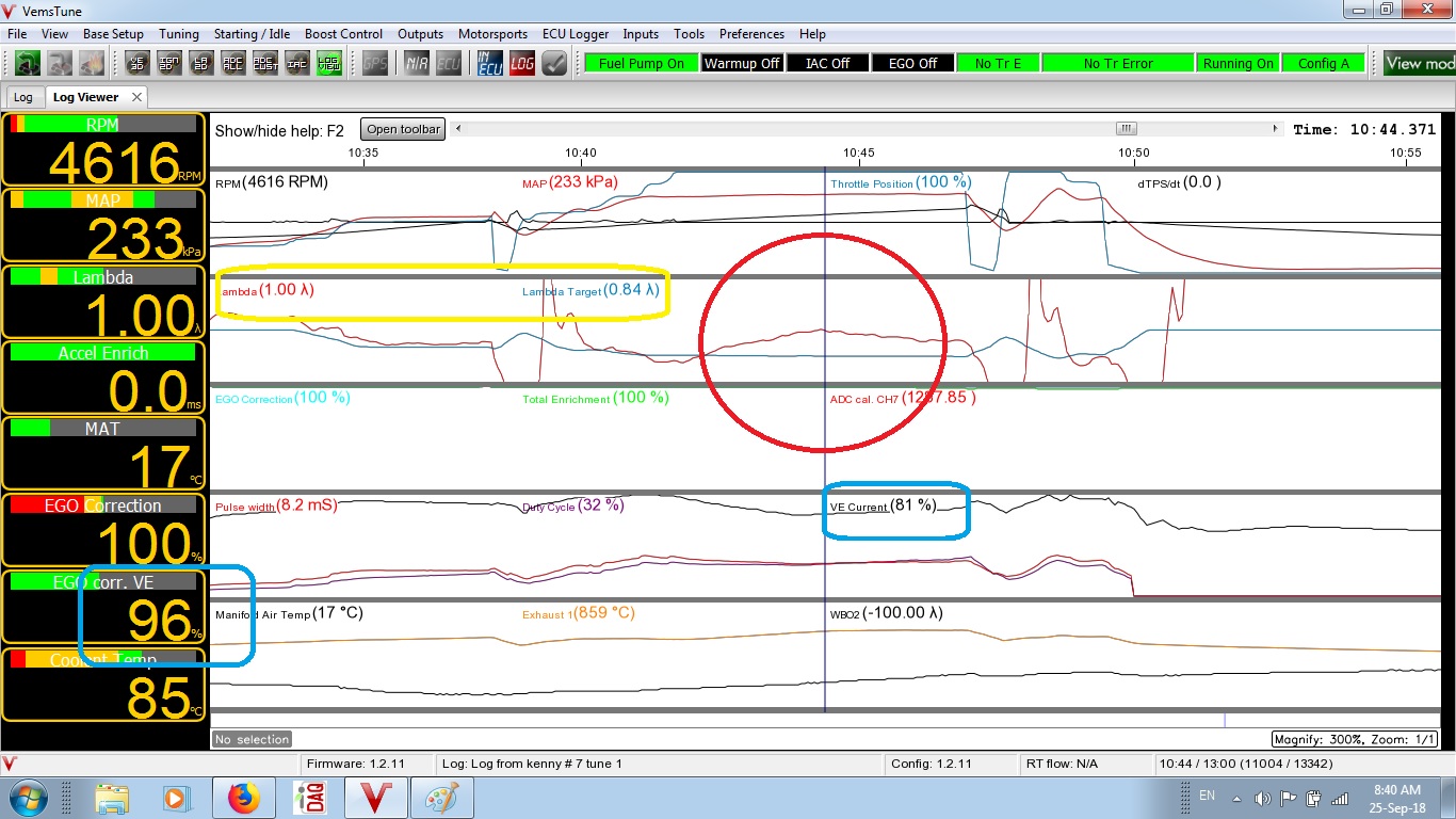

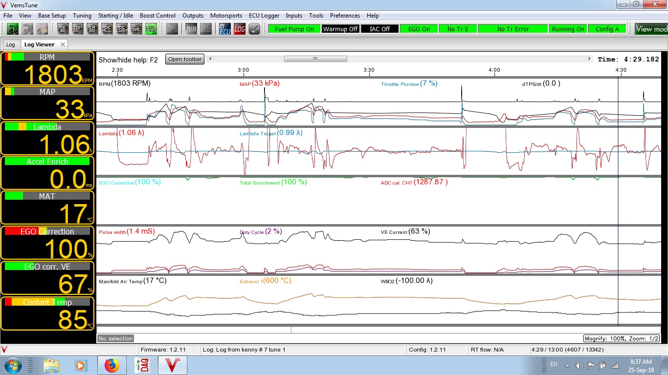

I ran my recent log through tune by statistics and found out I'm in need of alot more fuel down low. I adjusted the VE table to get a really nice idle with ISV today. 850 steady. I also dropped the boost down and made a few WOT pulls. Still have some tinkering on the VE table but it's running and it steady. I think the dueling and timing were my biggest issues. 5he base tune i was using was tuned for sea level...I'm 2000ft + above.
I also had a boost leak that I managed to sort out yesterday.

The idle I can nail down now but if I'm stopping or letting the rpm return to idle I have to feather it down slowly to prevent stalling. If driving the car does pull hard and nice. It's just the return to idle right now. I think the car is running pretty rich right now but that safe for me. I lowered the boost to 20psi as well. I've attached my most recent log and config for review.

Chris,
i have the EGO off and have been fiddling with the VE. i have increased the timing in the idle area to 15deg but i noticed on your config that you went to 21, could raising my ign timing to a bit higher help prevent the stalling?

Re: Help with Vems idle issue (log)
I'm using 91 oct. I went through and fixed any "would be vac leaks" found a couple that may have been a issue. I drove today and the car idles better and no longer stalls. I made changes to the IAC settings that helped. Problem areas I have now are starting...either cold or warm it will still struggle to fire up. Takes a few times. I'm thinking maybe the priming and cranking setting are off? I idle rich right now, .87 lambda. I'll be making corrections to the VE table to lean out the idle area to get closer to .98 lambda.

So, pump gas. In that case I have no experience. That said, I remember seeing 45 degrees advance in your ignition table. That is too high for 91 IMO. Drop that down to 35 max just to be safe. Do you have knock sensing on? You need that.morris400 wrote:I'm using 91 oct. I went through and fixed any "would be vac leaks" found a couple that may have been a issue. I drove today and the car idles better and no longer stalls. I made changes to the IAC settings that helped. Problem areas I have now are starting...either cold or warm it will still struggle to fire up. Takes a few times. I'm thinking maybe the priming and cranking setting are off? I idle rich right now, .87 lambda. I'll be making corrections to the VE table to lean out the idle area to get closer to .98 lambda.
0.87 idle when cold is OK. Not warm.

See picture for an example logview.
- Example logscreen morris400.jpg (298.4 KiB) Viewed 71168 times
Please see picture.
The large red circle shows the lean area. You hit 1.00 @ 233kpa. Not good.
The yellow box shows target lambda and actual lambda. Those need to match as closely as possible.
The light blue boxes compares current VE and VE correction recommended. Those need to match too in order to get what you need.
You had no EGO control above 90% TPS IIRC, so it was not adding fuel.
Tune by statistics is not a good way to tune. This is because I don't know your filter settings and it usually disregards MAT. This has an influence.
Go cell by cell. You can try to free rev it sitting still. Slowly climb in revs. Adjust the VE table accordingly. It won't be completely correct when driving and only a certain kpa line, but better than nothing.
- This is a problem.jpg (291.85 KiB) Viewed 71168 times
