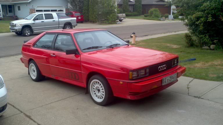

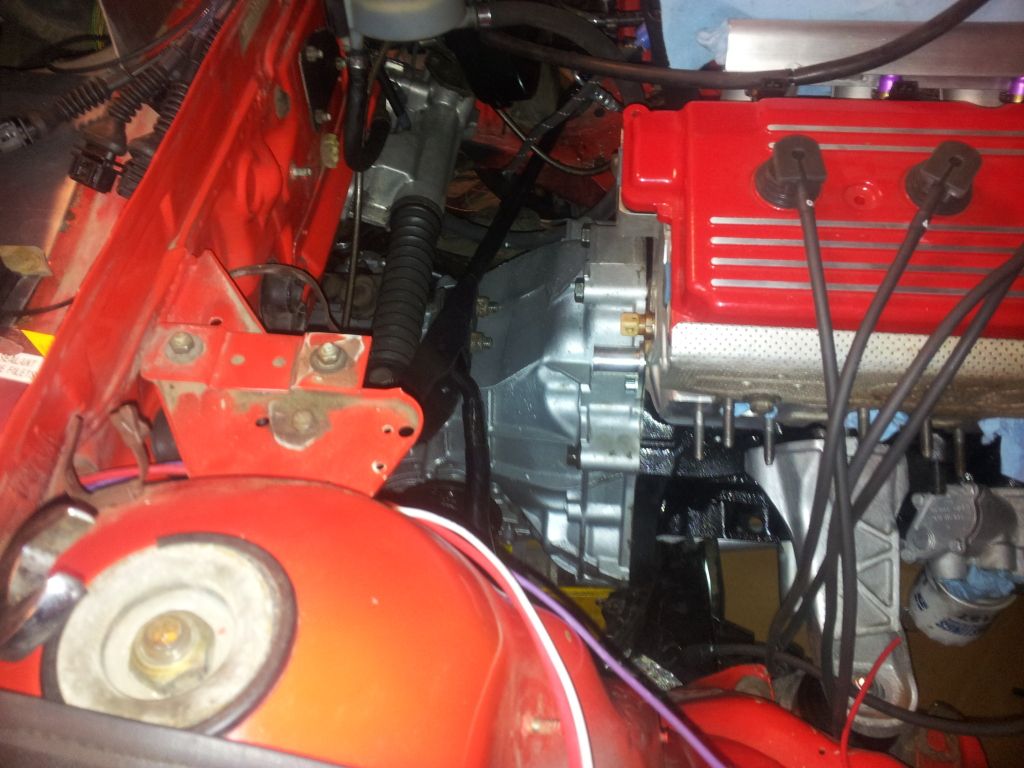

Car is an 83 quattro faded mars red (original paint still, one day I'll get it painted)
Decided to swap a 20vt in it when the 20vt ate a head gasket. I was going to leave it stock for awhile while I built another aan.
This didn't last long however, some cheap parts and some crazy thinking got to me so the engine came out and got a refurb.
Currently the 01e needs some axles and a linkage and it can get the final bolt in.
I also need to notch the motor mounts and slide the trans back almost an inch to meet the driveshaft. 4:11 diff is in
Currently waiting on header/downpipe from Hank as well as some other bits. Started mocking up the fuel pumps but waiting on an order for fittings until I can go much further with it right now.

Your paint looks great to me. And your trans and diff are so clean!

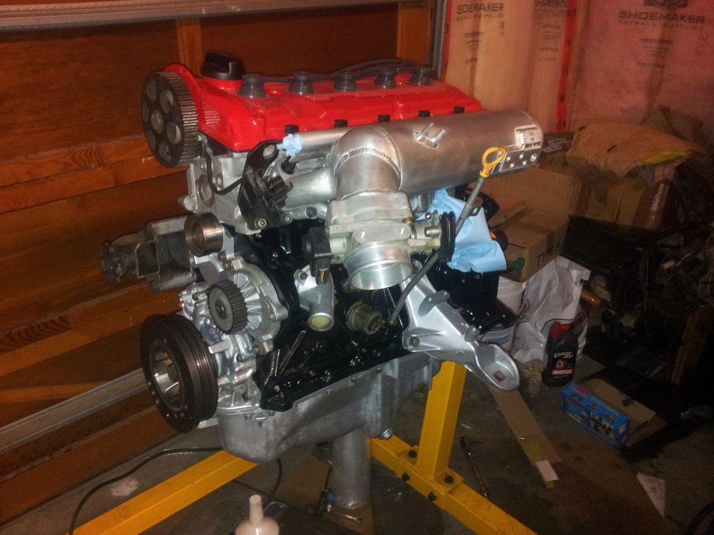

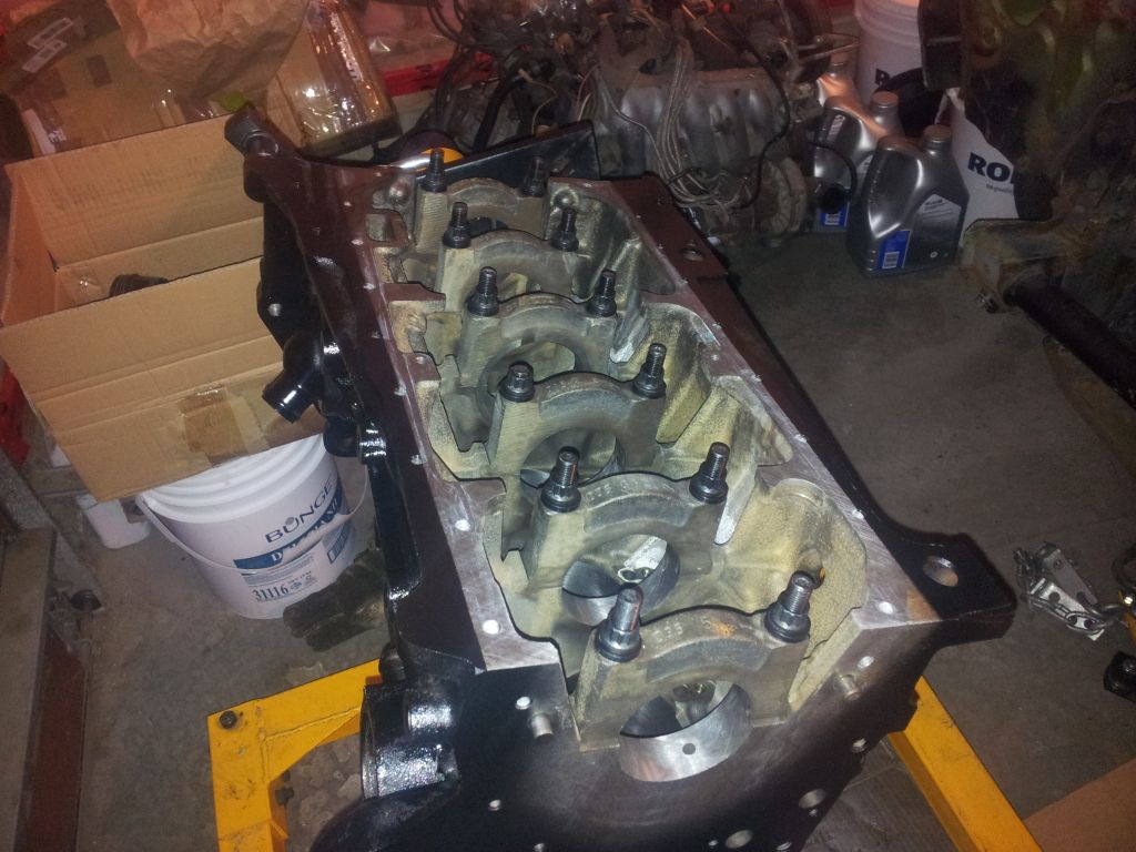

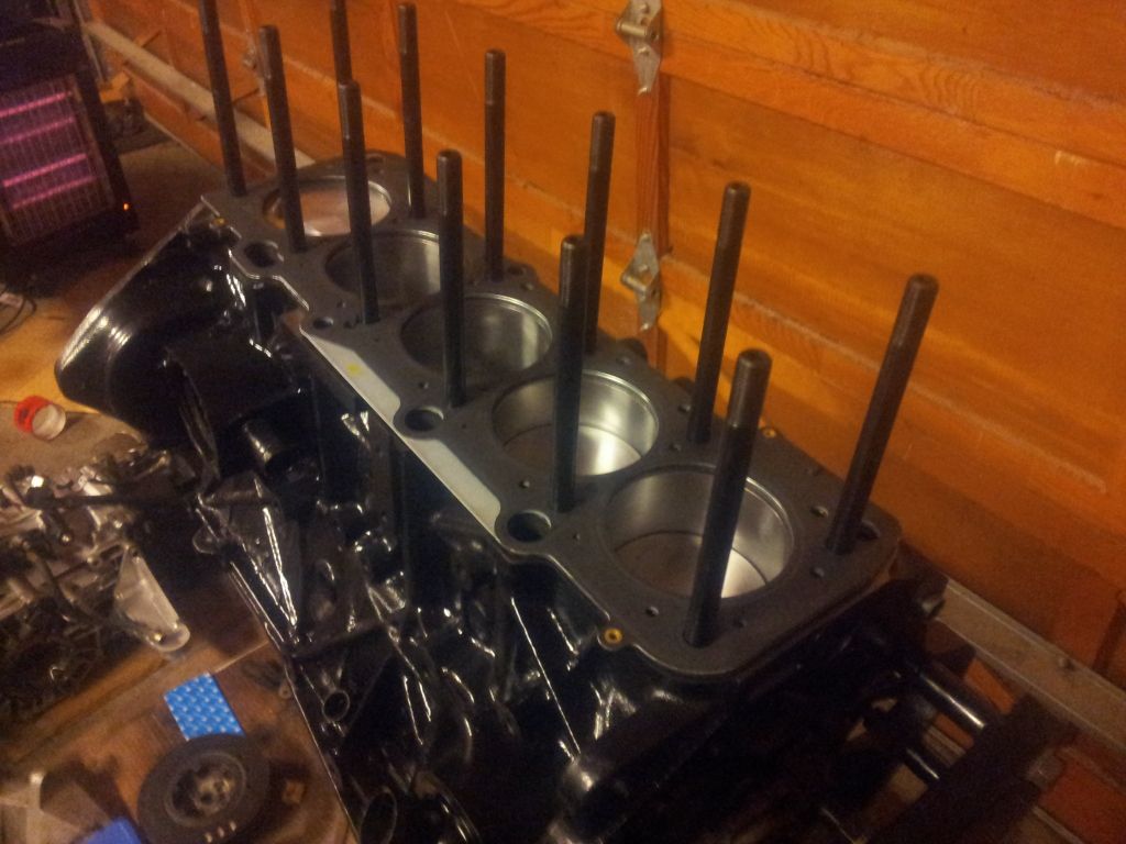

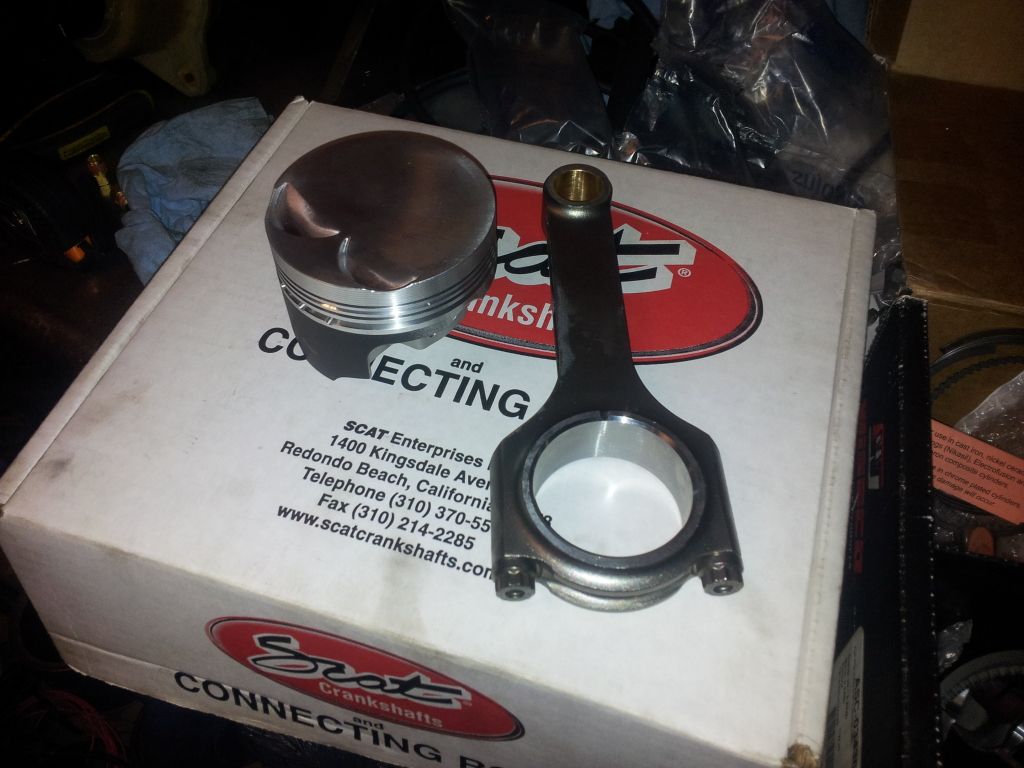

I forgot to mention some of the specifics:
AAN engine
FRP Wiseco pistons, 82.5mm, 9.1:1, nice deep valve pockets
Scat rods
ARP mains/head studs
Internally balanced
034 billet clutch kit
7a cams for now
Ported/polished head, port matched intake
Oversized intake/exhaust valves, LW lifters, HD springs, ti retainers

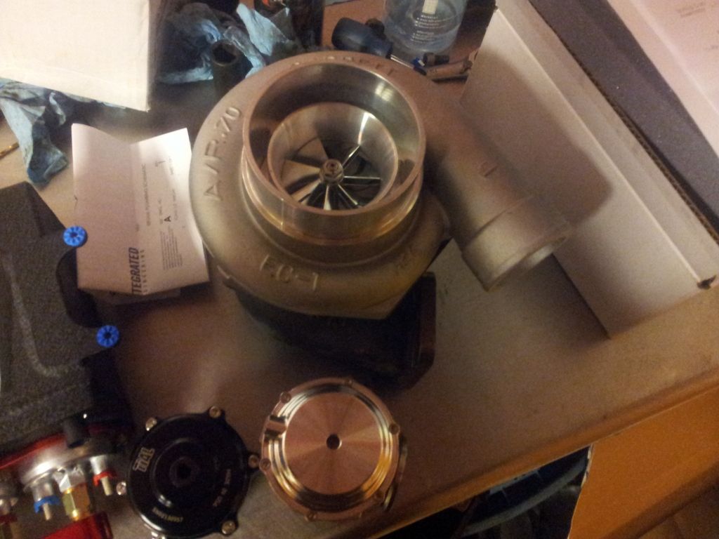

Forced performance GT3586 turbo
Soon to have a Hank manifold/downpipe combo
Air to water intercooler
Aquamist HFS-4 water meth
VEMS
Stack instrumentation
Probably a few things I'm forgetting.
Some pics of some of the goodies

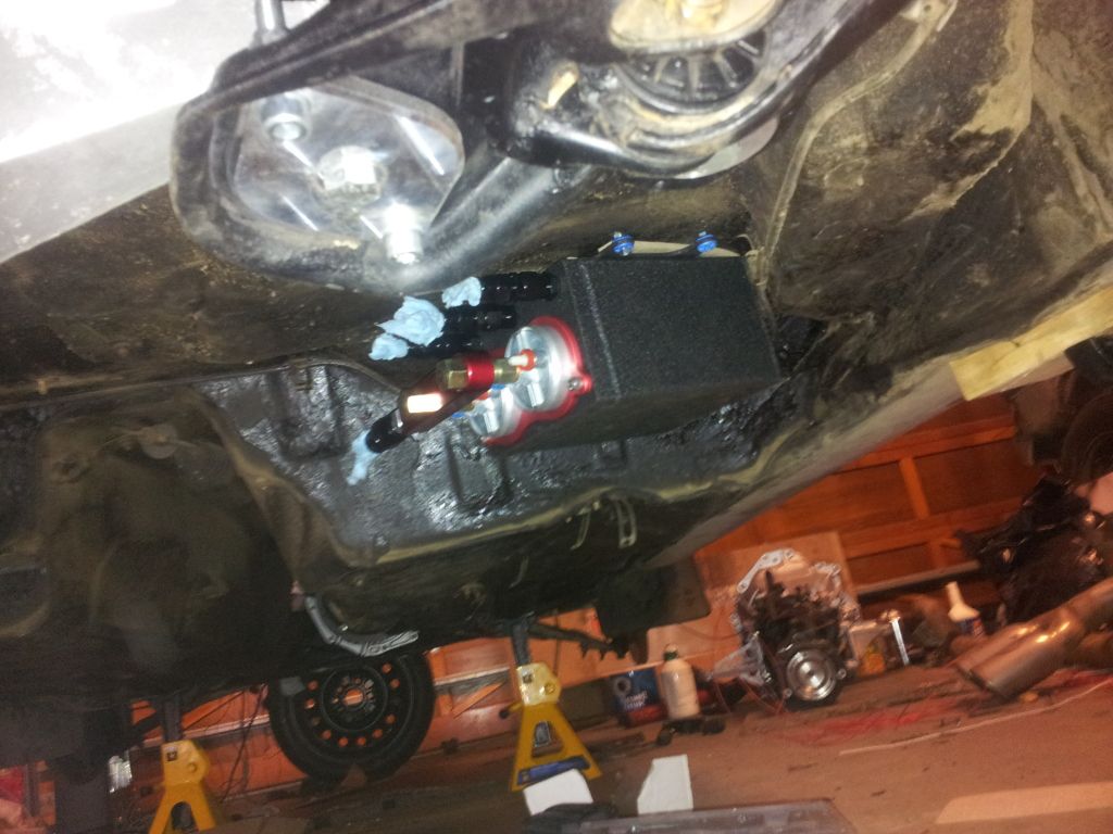

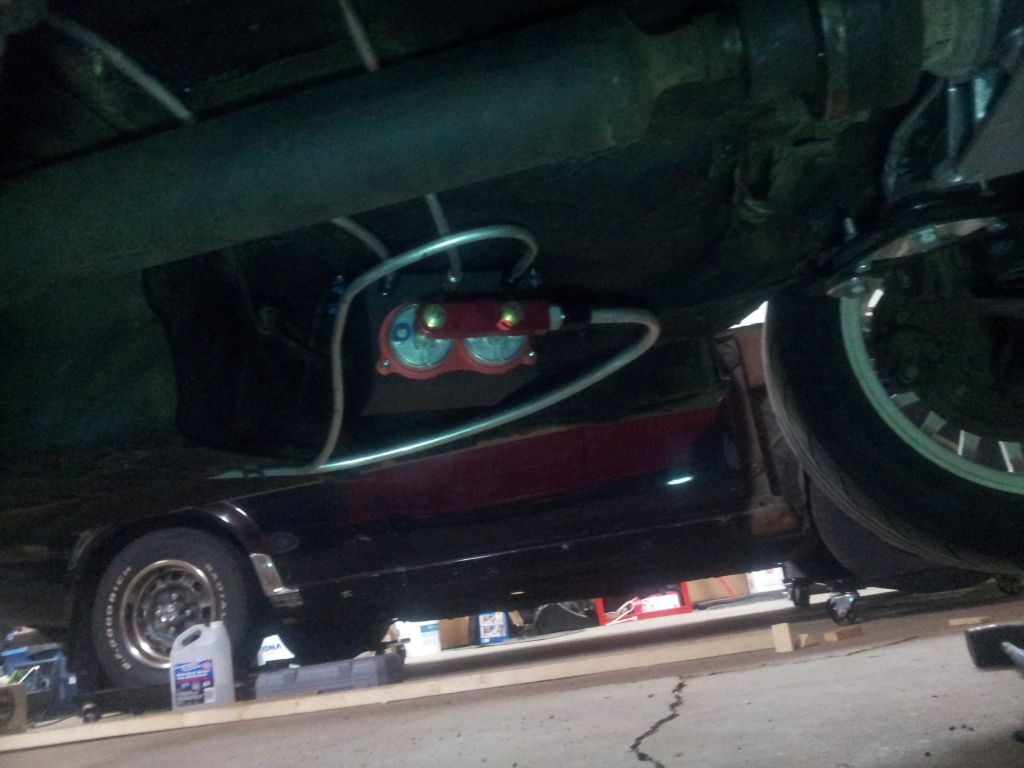

Reason for 3 fuel pumps is the 2 in the surge tank and one feed. I went this route because the ultimate goals of this car could not be met with a single 044 in a surge tank. I didn't want to have go back and re route fuel lines when its time for upgrade.

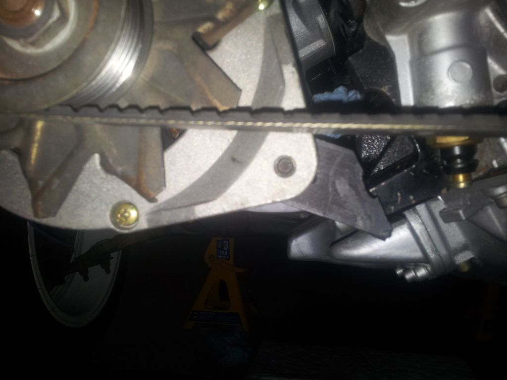

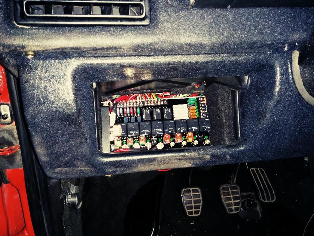

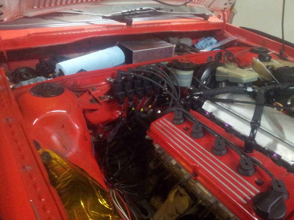

Long time no update. Been pretty busy with the car lately though. Lots of wiring done with a little left to go.

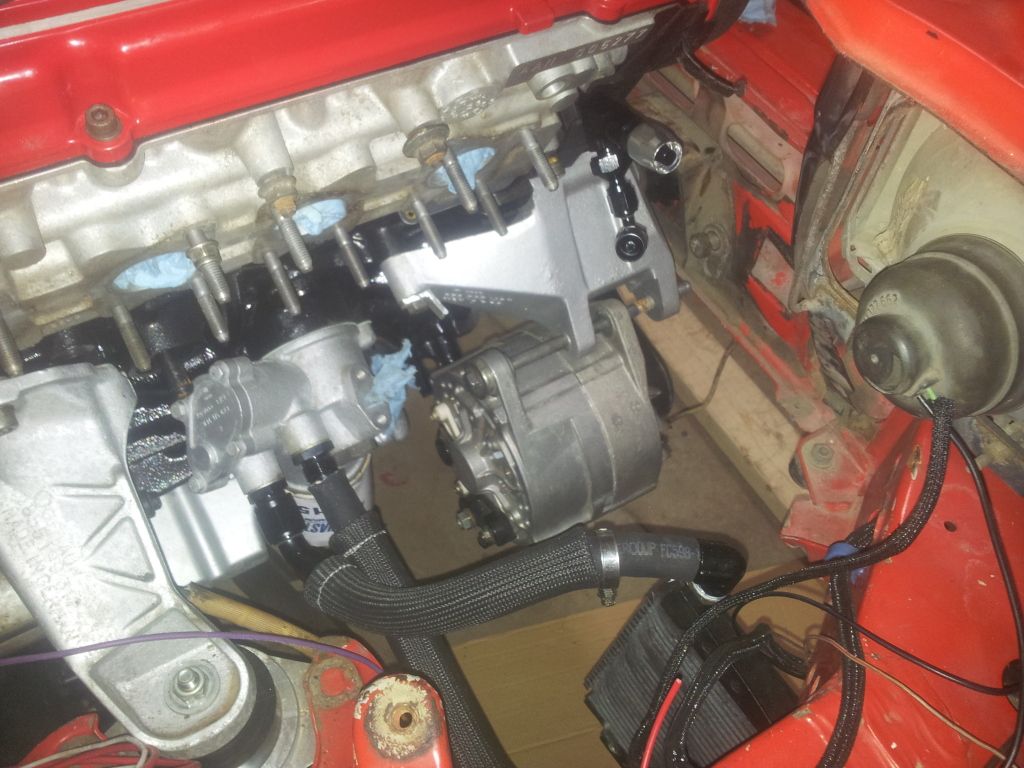

Finally got the alternator mounted up

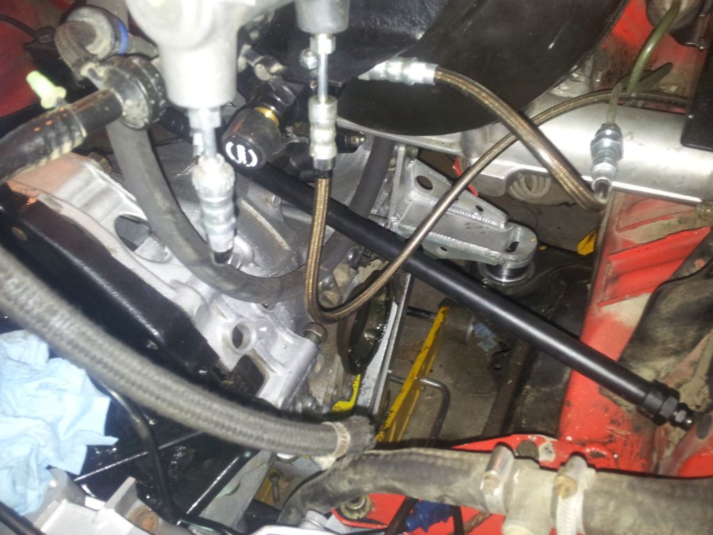

Also buttoned up the fuel lines
Catch can setup is figured out, only have to make a bracket to properly mount the can
Header/downpipe and turbo hot side should be at swain tech getting coated now, hoping to have everything back before Christmas. Eagerly waiting for that stuff so I can make the rest of the oil/water lines and have everything mounted.
Coils finally mounted
And I finally started mocking up the inter cooler, now to make some brackets and finalize its position

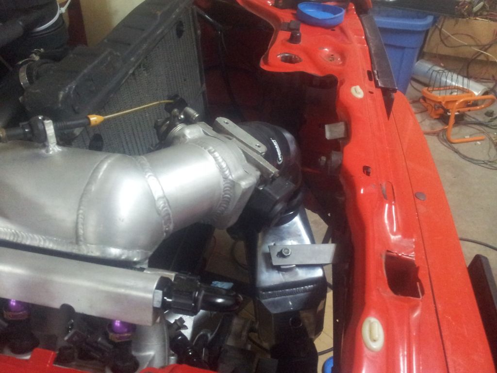

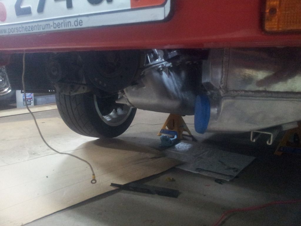

Little bit more progress today. Got the intercooler into place and some piping started.
Also finished up all the lines for the oil cooler. Now to get back to wiring. I finally finished up the centre console and put it in its place. Notice the 4kq window switch because I couldn't find one from a coupe.

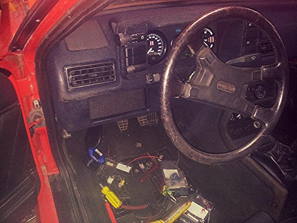

Little bit of an update, some progress was made.

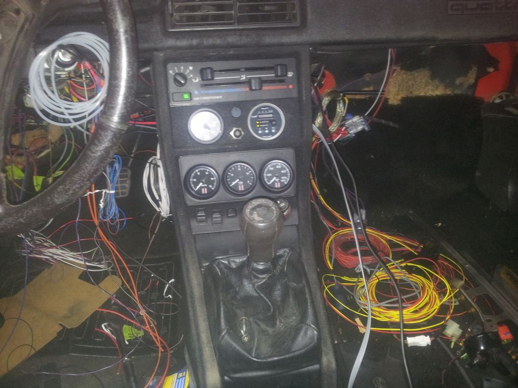

Had the car wired up but I didn't really like it so I tore everything out and re wired it again. I think its a lot cleaner and easier to use this way.
And if you don't want to look at it you don't have to

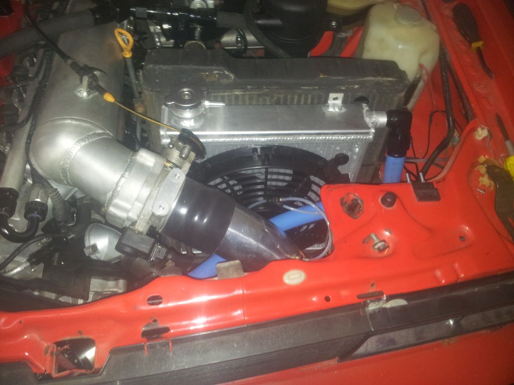

Heat exchanger for the intercooler is done as well

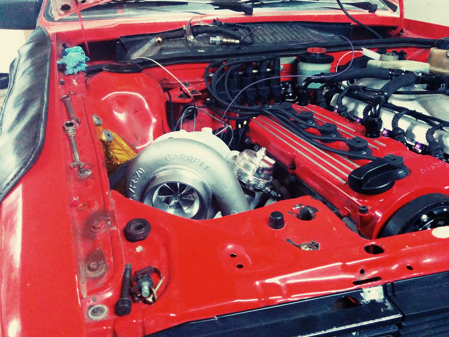

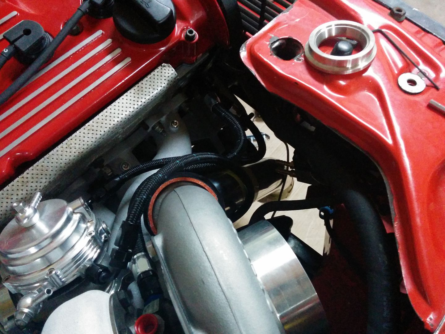

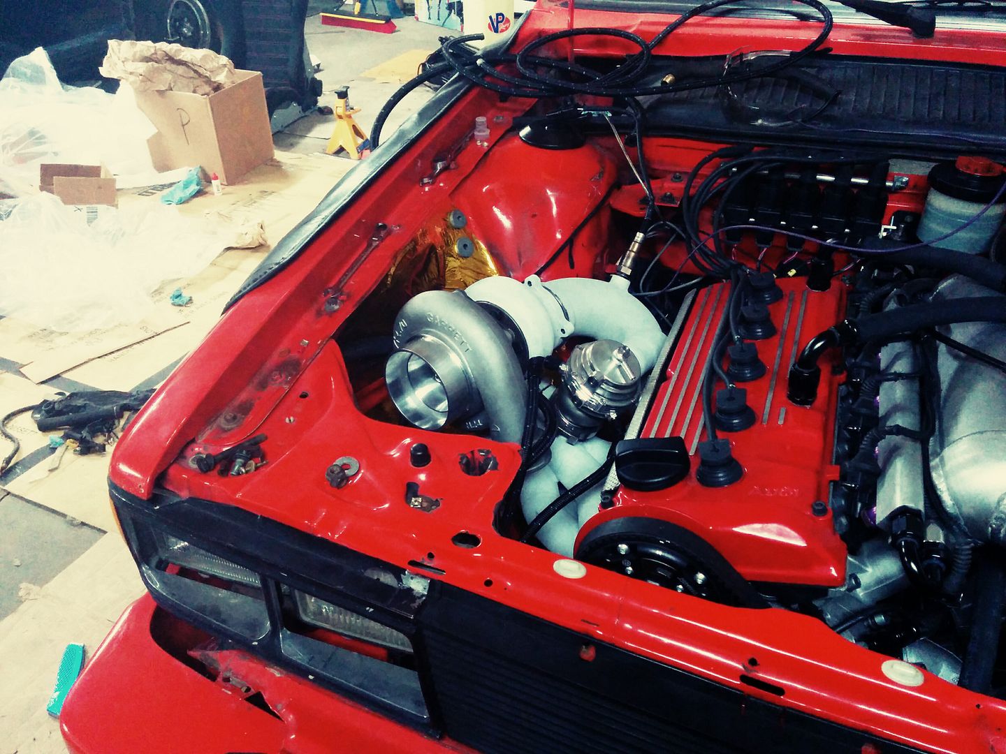

Exhaust parts finally came back from being coated. Its starting to look like an engine bay again.

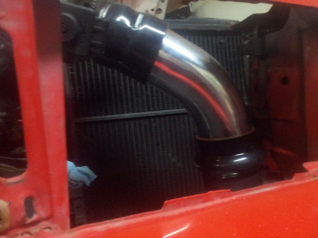

Started to mock up the boost piping

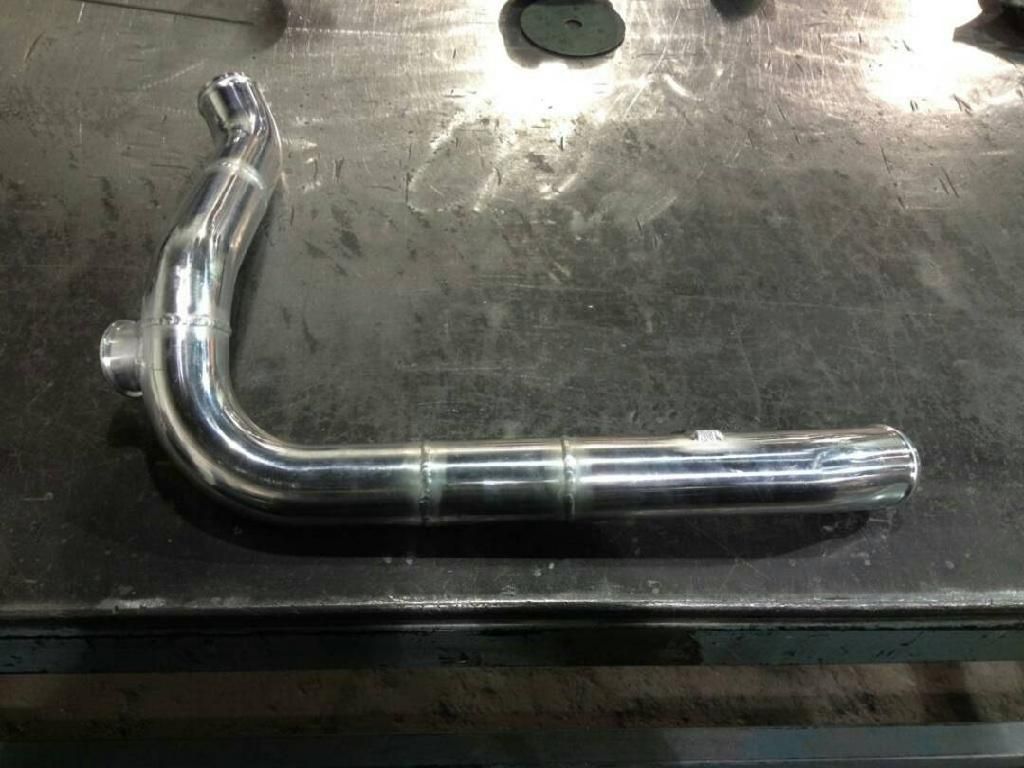

Here is the pipe from the turbo to the intercooler, waiting to be powder coated
All I'm waiting on now is a few sensors and misc. things in the engine bay and she will be ready to start. After that I just need seat brackets and axles and she should be ready for the road. Im sure I will run into a boatload of problems once it gets fired up and that will delay its road worthiness a bit but I'm not too worried.

Re: Ads urq project

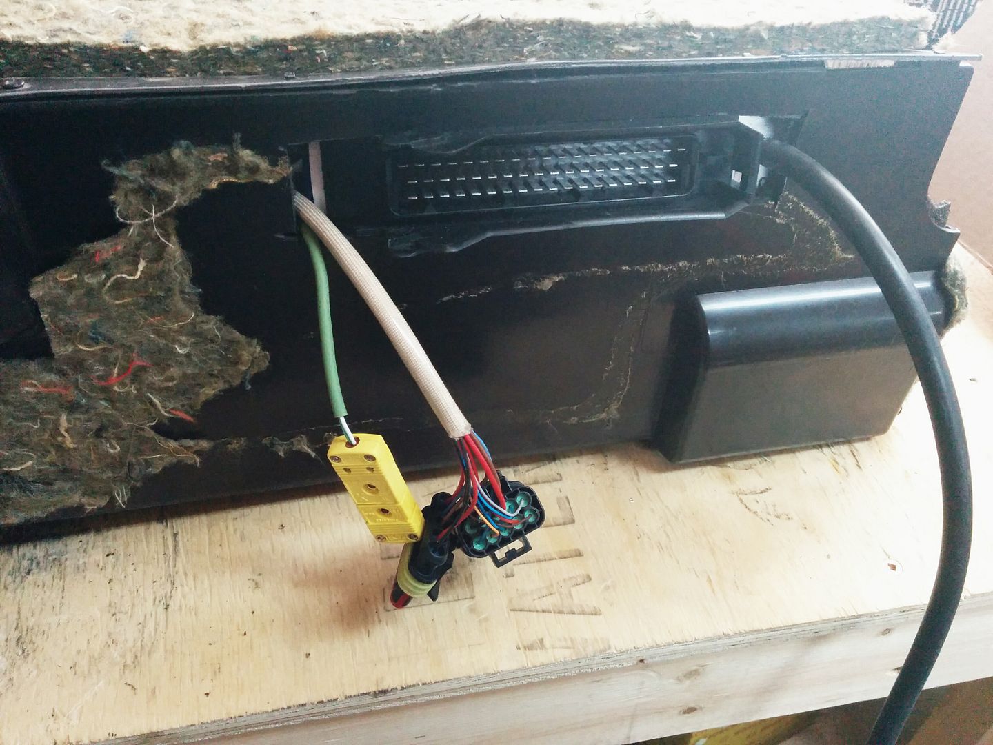

Nice progress! What did you use to mount vems to the top of the glove box? I'm thinking that's where mine has gotta go because there's nowhere to put it cleanly up/behind.
ads
Posts: 64
Location: Edmonton, AB, Canada
Re: Ads urq project
Post by ads »
I just cut a slot for the ecu plug and made it nice and snug, it holds itself up. then t
when you plug in the harness it holds it firmly against the back of the glove box.
83 Urq
