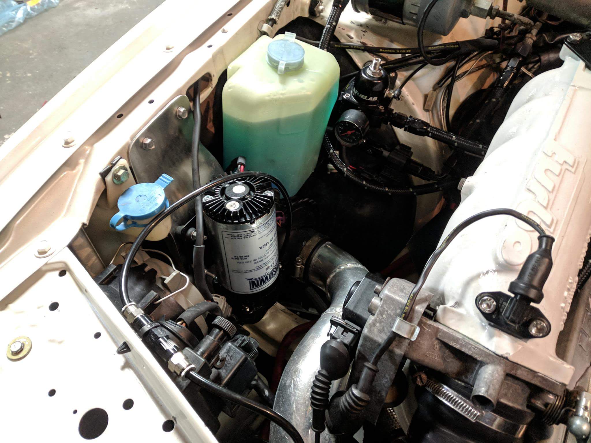

Devils Own water meth injection - controlled by VEMS

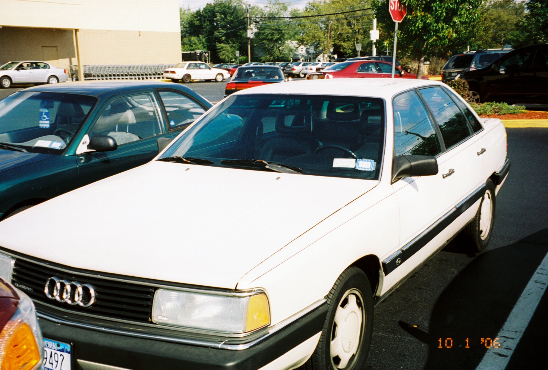

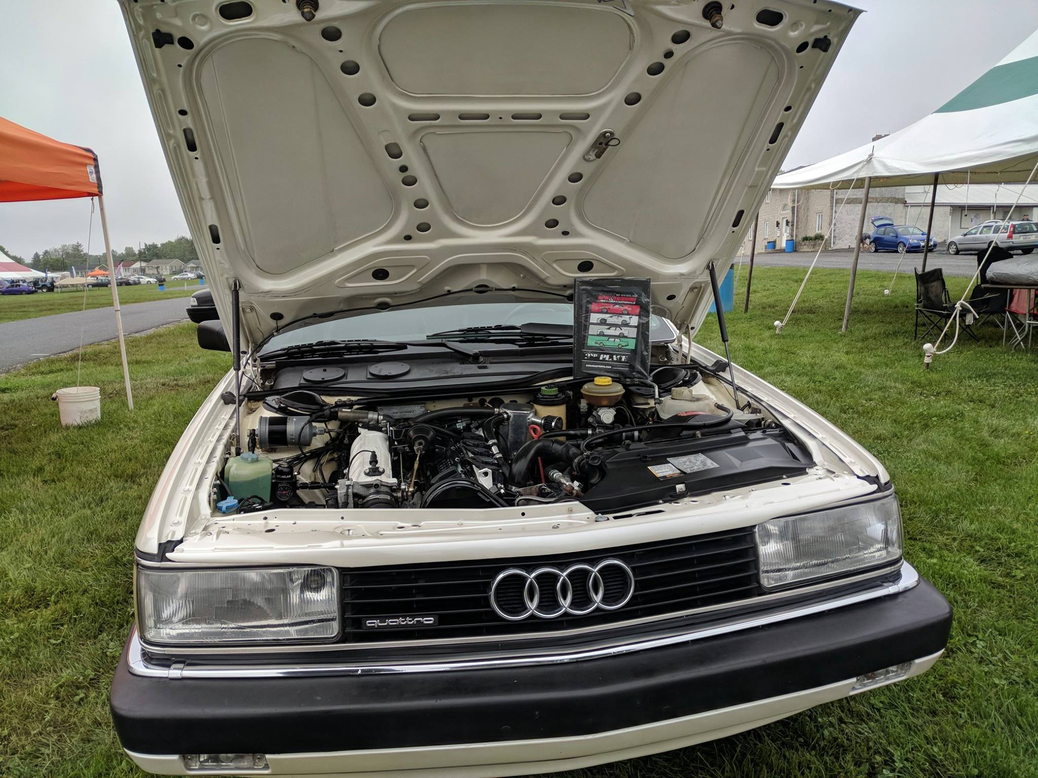

Roll the clock back to 2006... Someone made the mistake of passing the keys to me...
engine bay.jpg (503.96 KiB) Viewed 65377 times

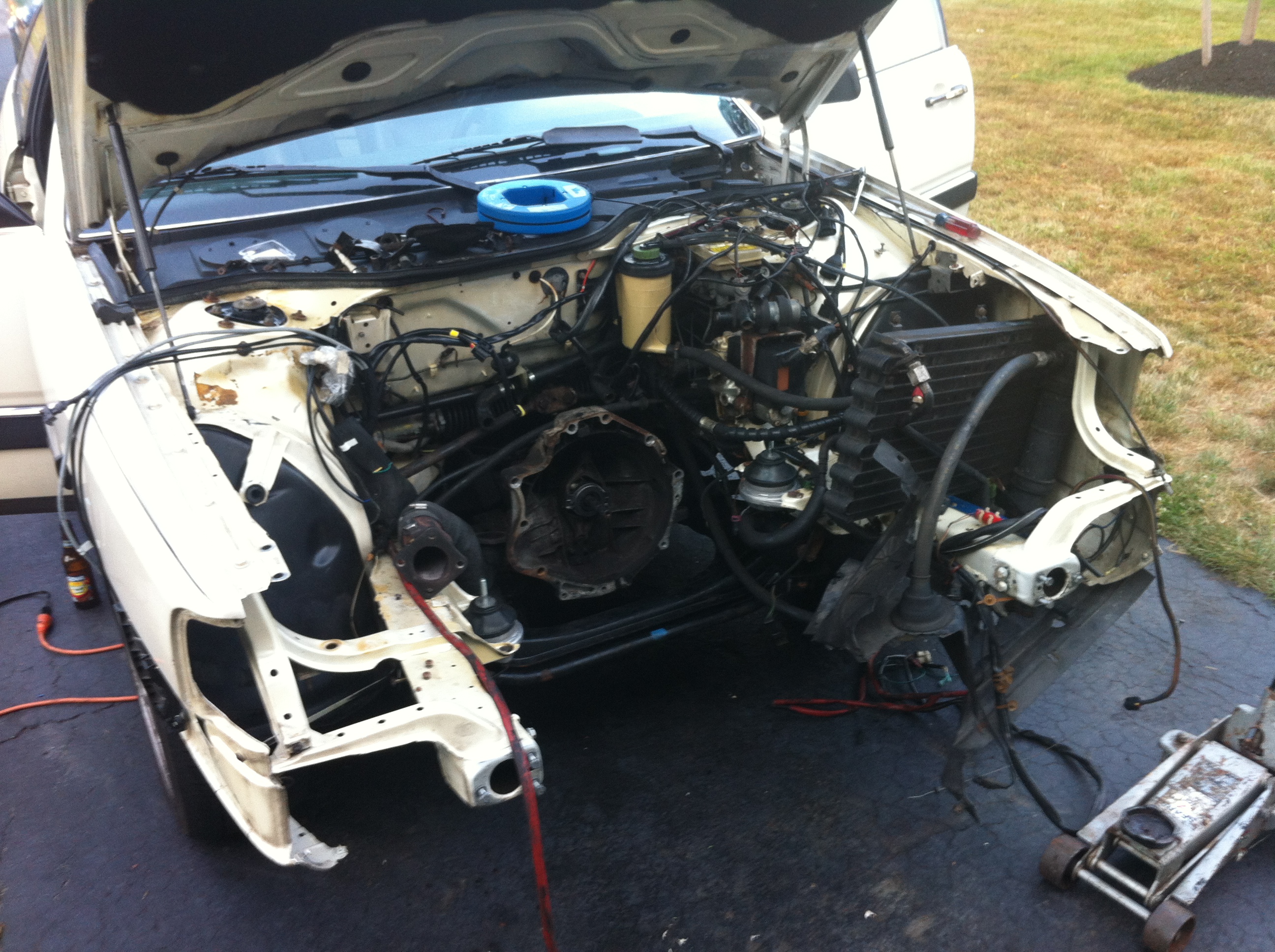

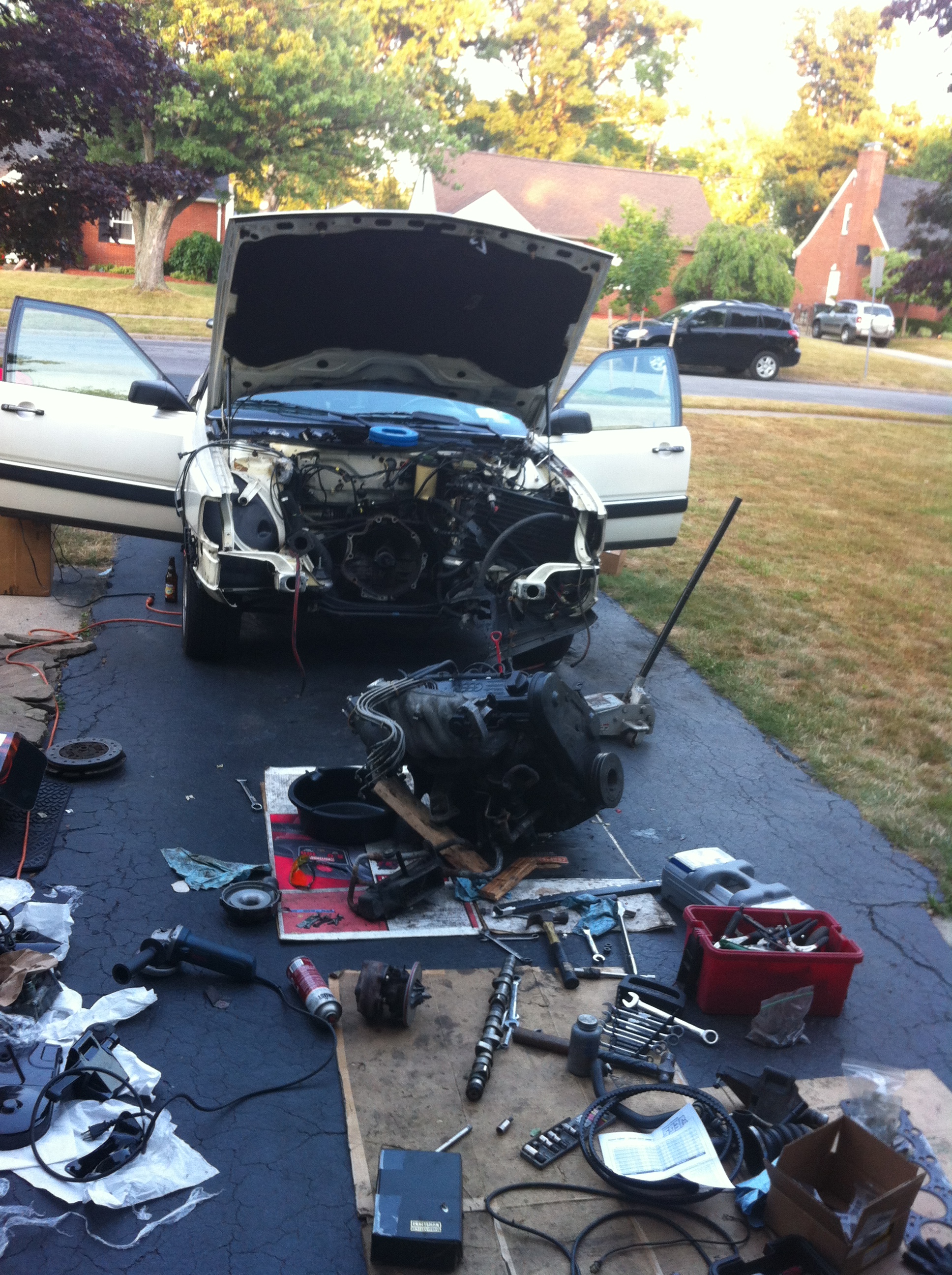

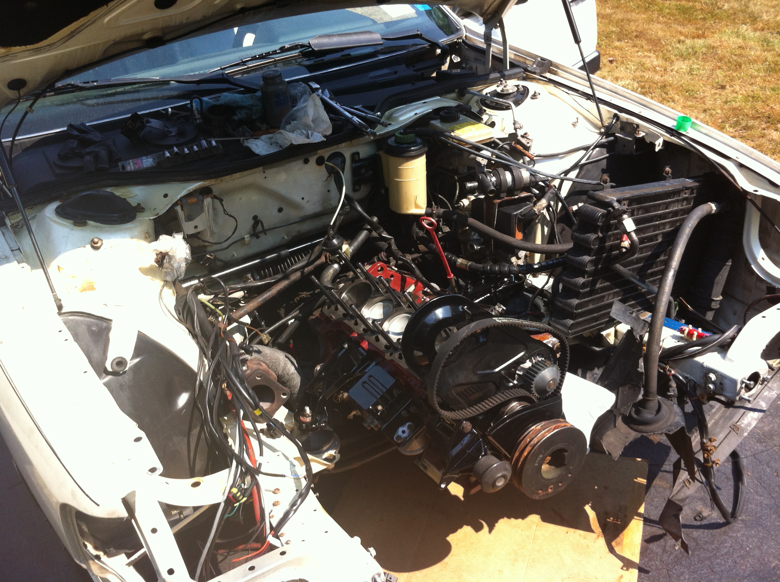

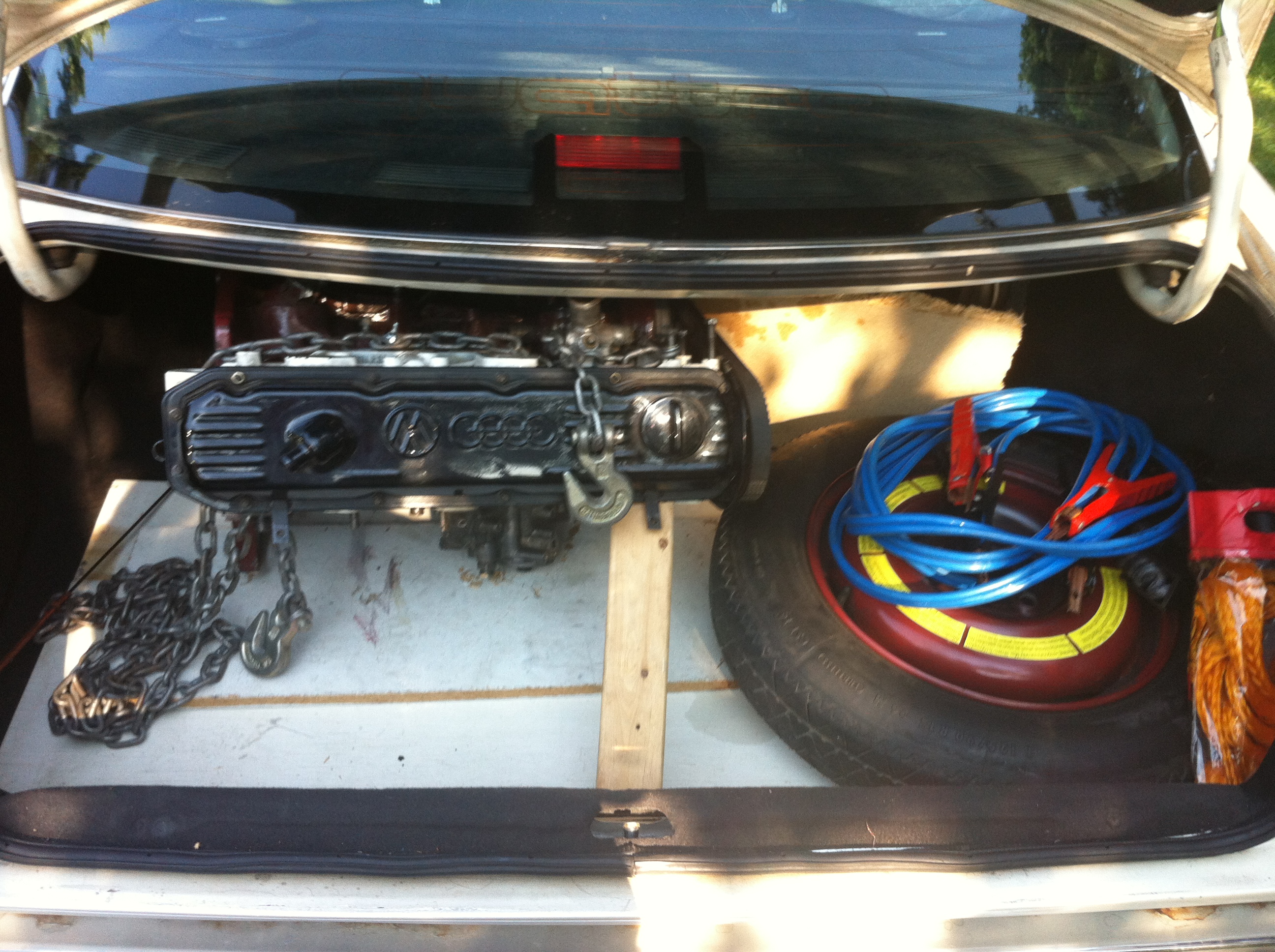

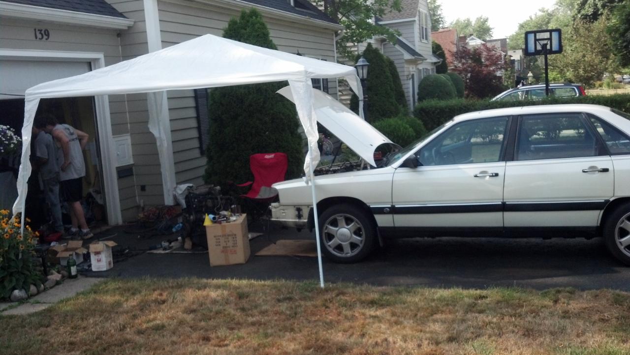

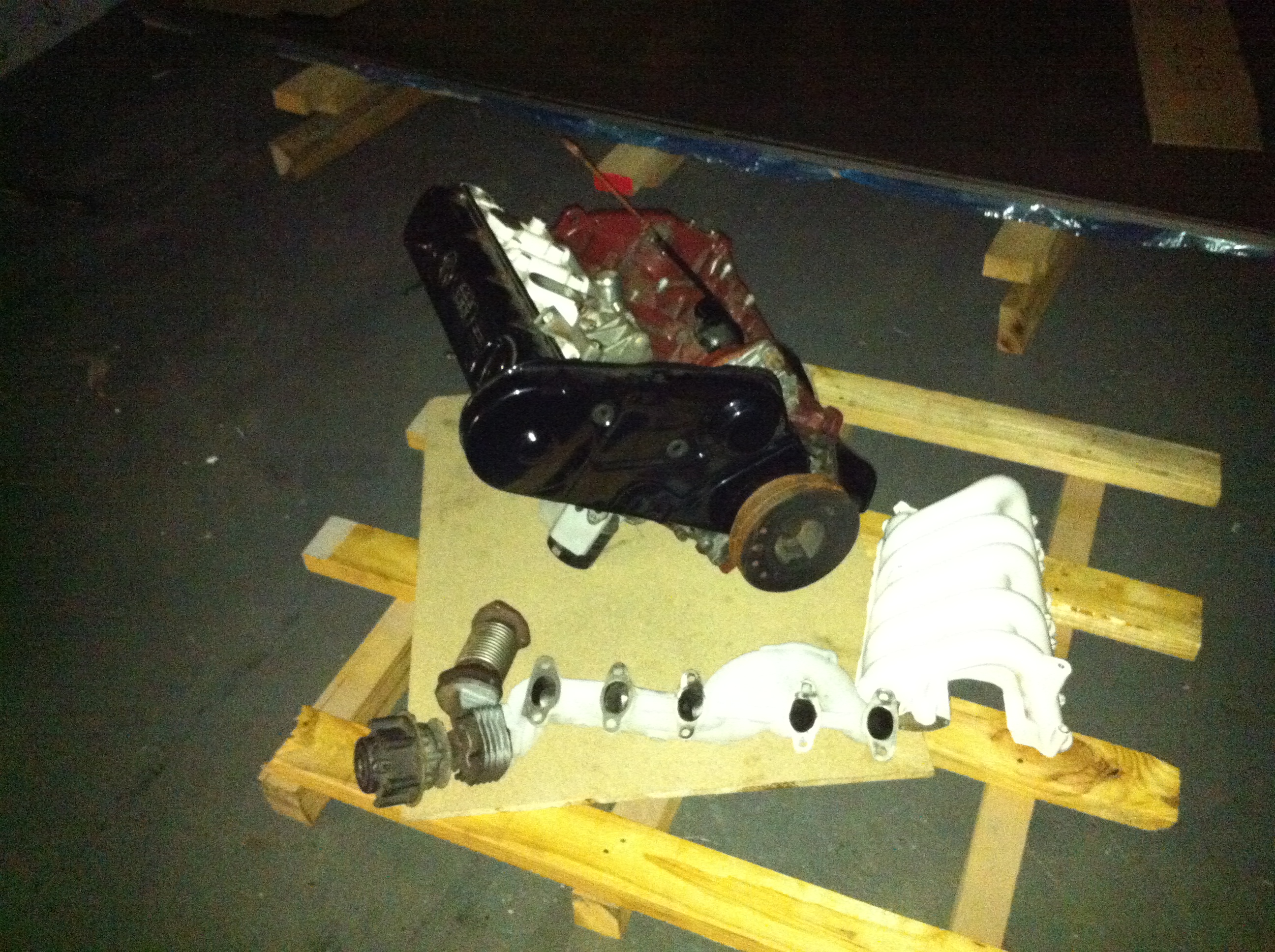

The beginning of the EFI conversion.. 2012
More details later...

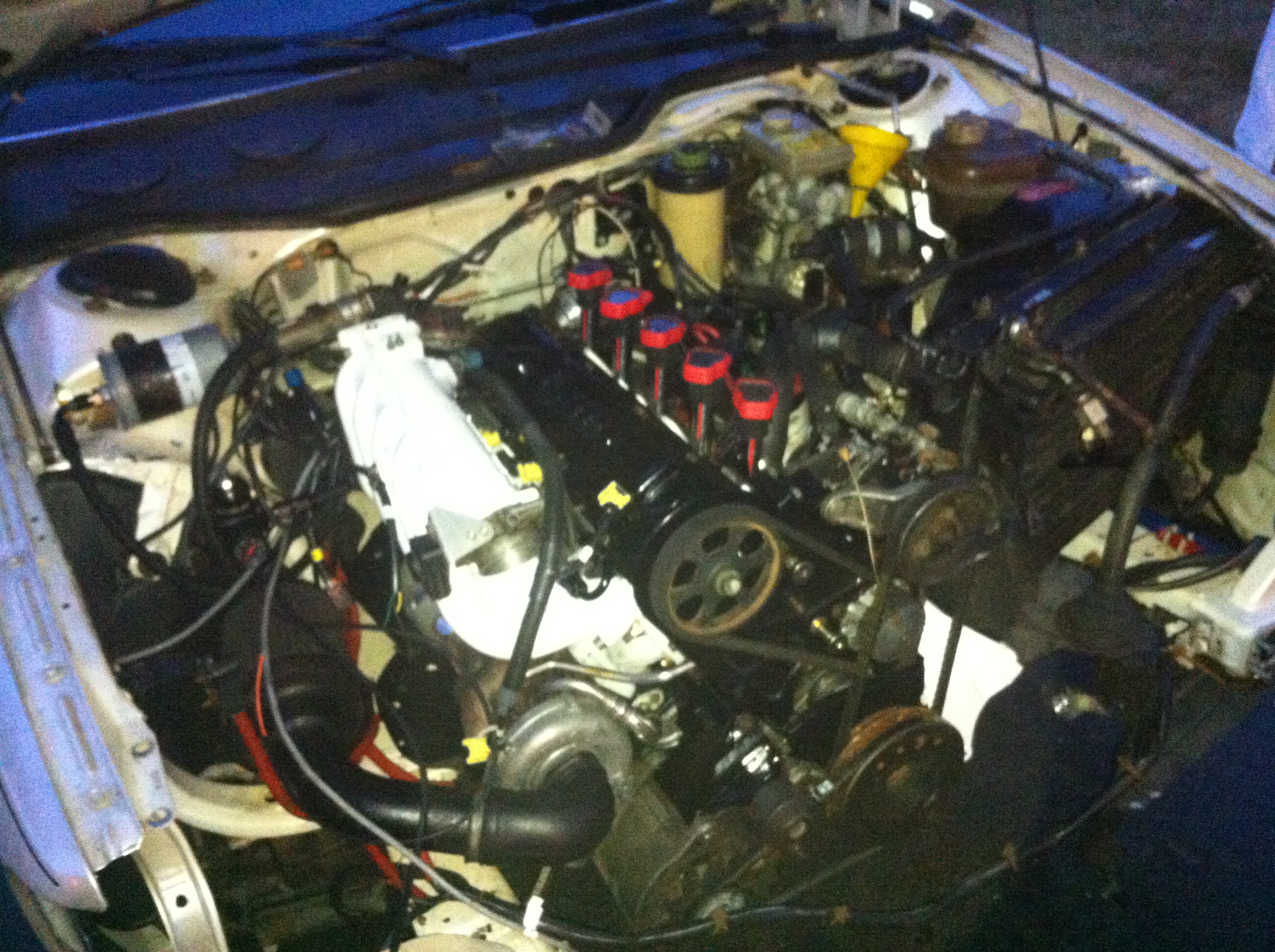

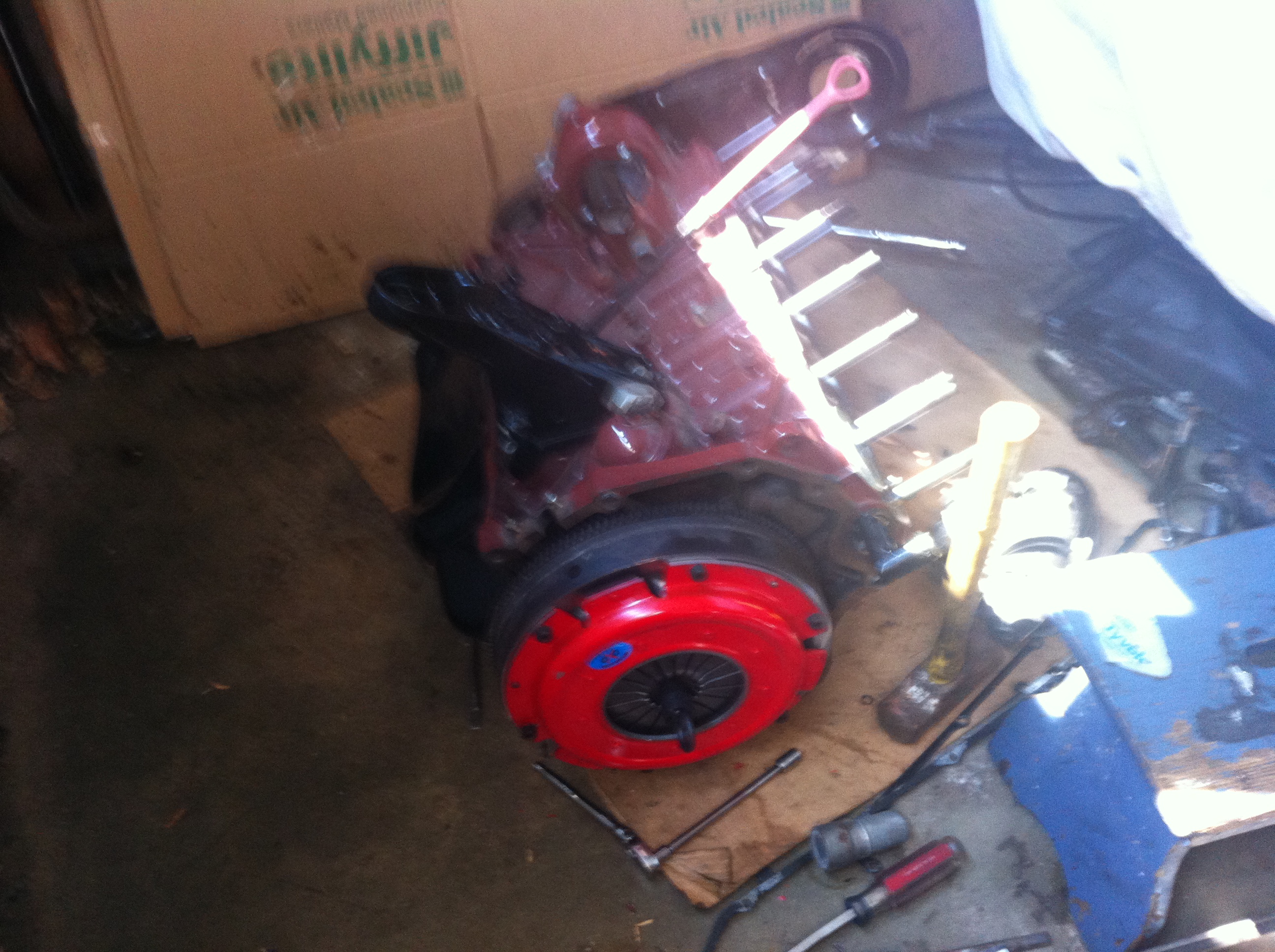

EFI conversion continued...
you know the drill... more details later...

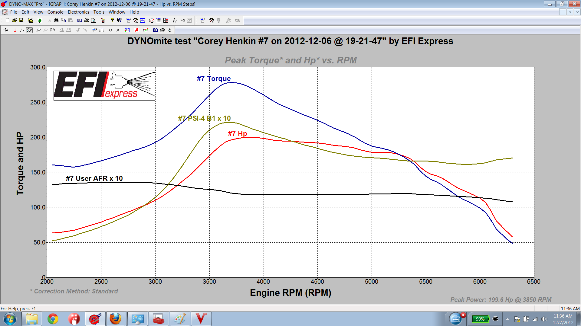

First time on the dyno... stock k26 and for some odd reason a 20v JT cam?
Blew up the turbo... it was time to upgrade.... Hank!!! Oh hello billet K26...

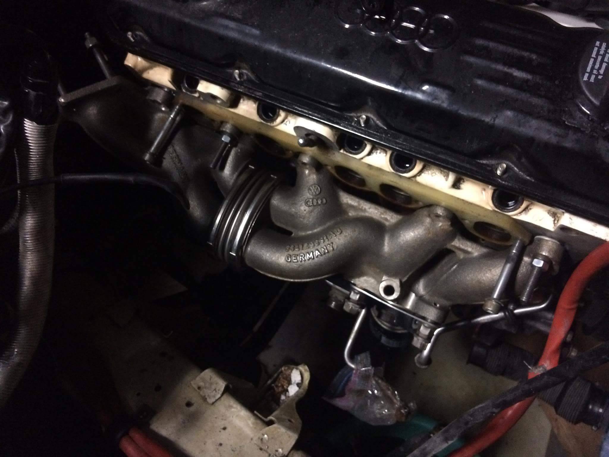

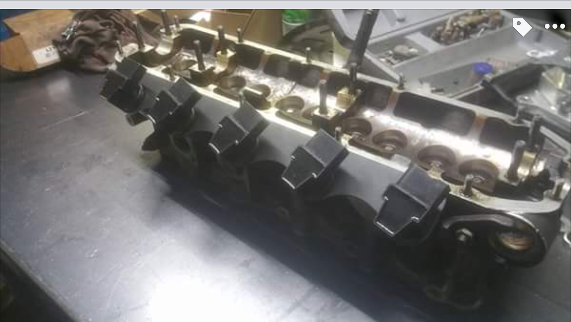

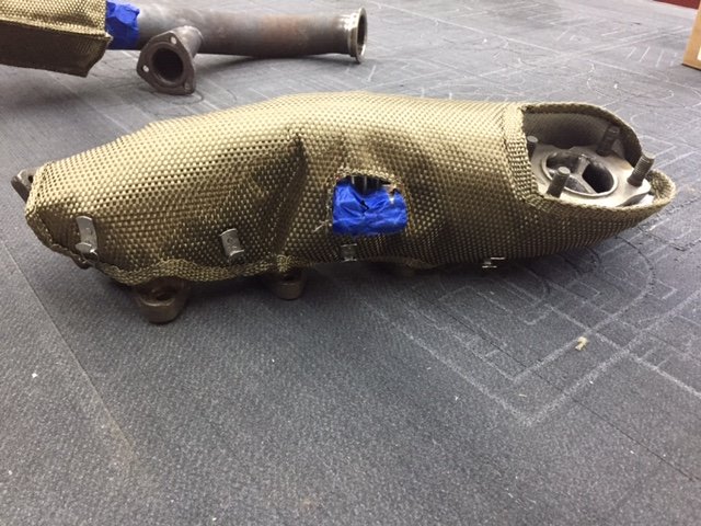

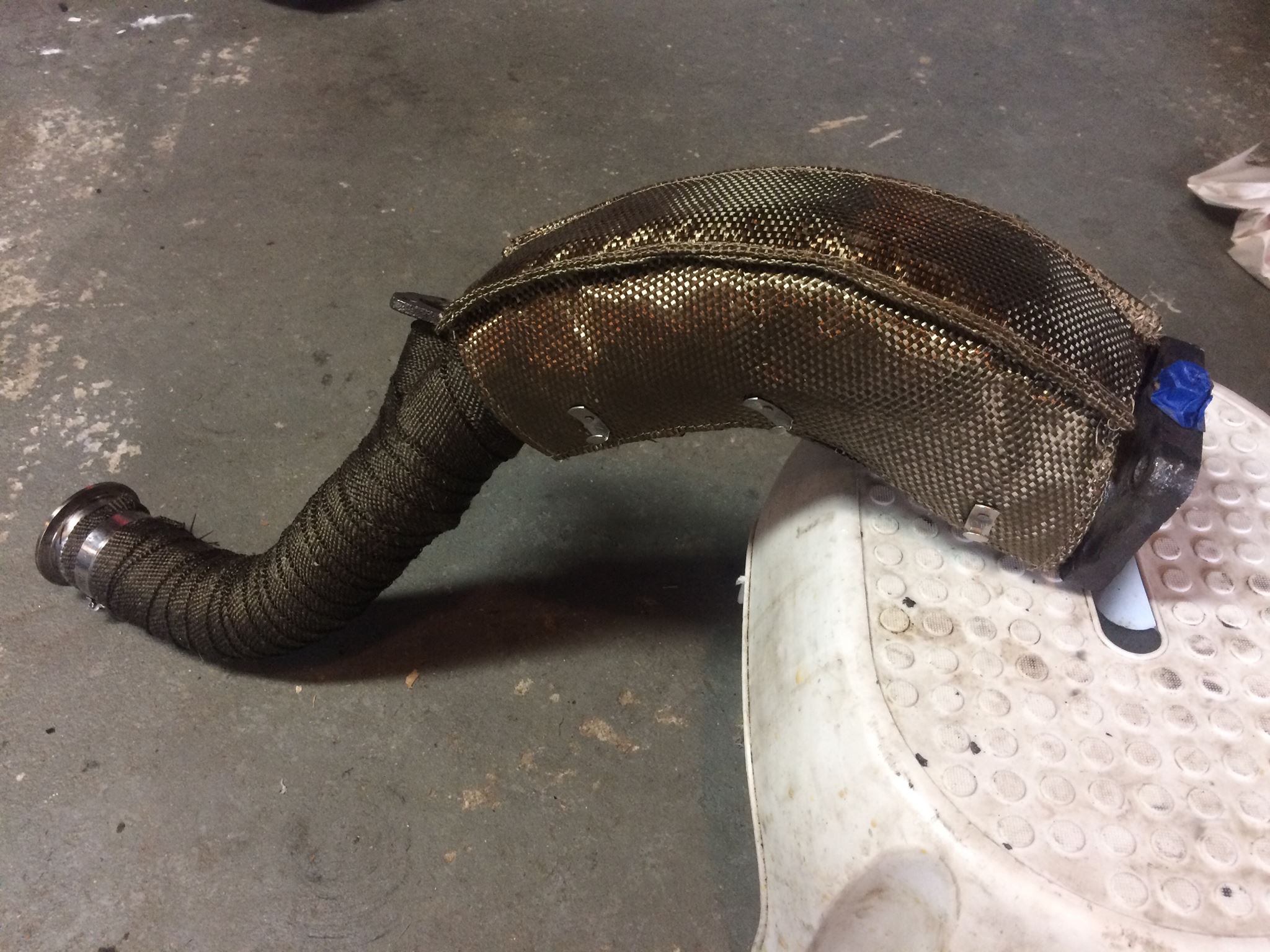

Among the long list of things to hate on the 20v for is heat control... or the lack there off...
My final attempt at this came together during the winter 2016...
NOS two piece EM
Retained the phenolic intake spacer
New custom lava manifold blanket
Custom lava stuff dp blanket

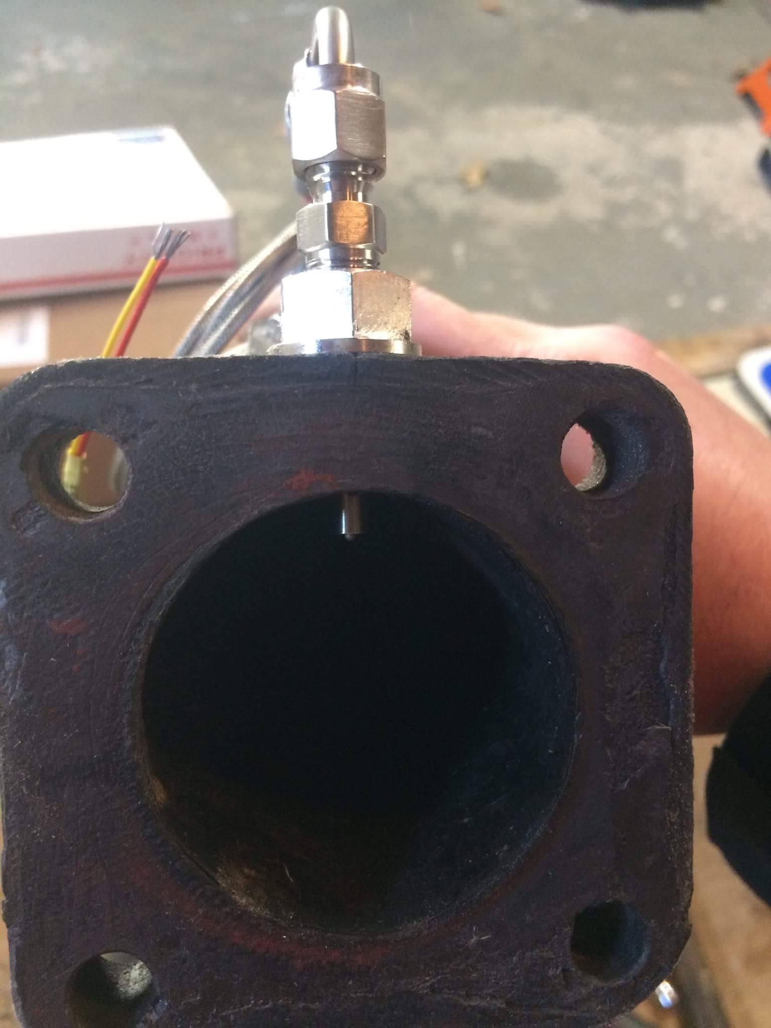

Relocated EGT probe post turbo for easier access... not too concerned about EGT accuracy... New probe is open tip style...

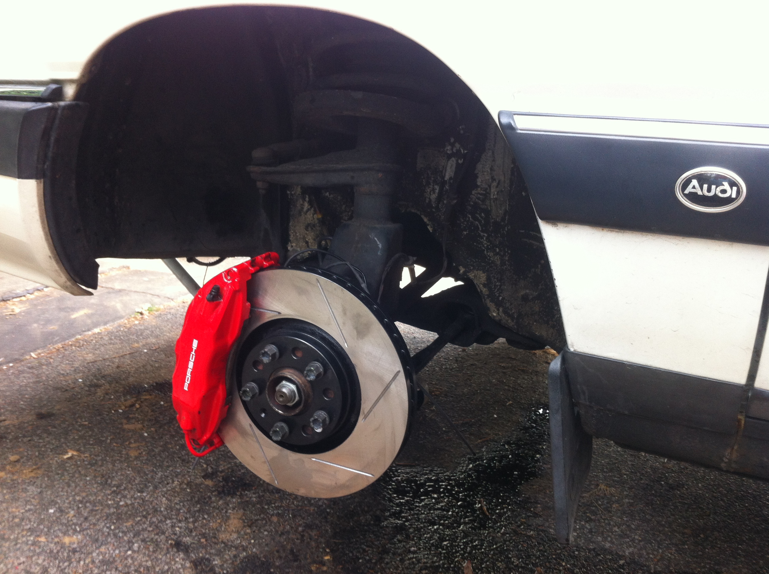

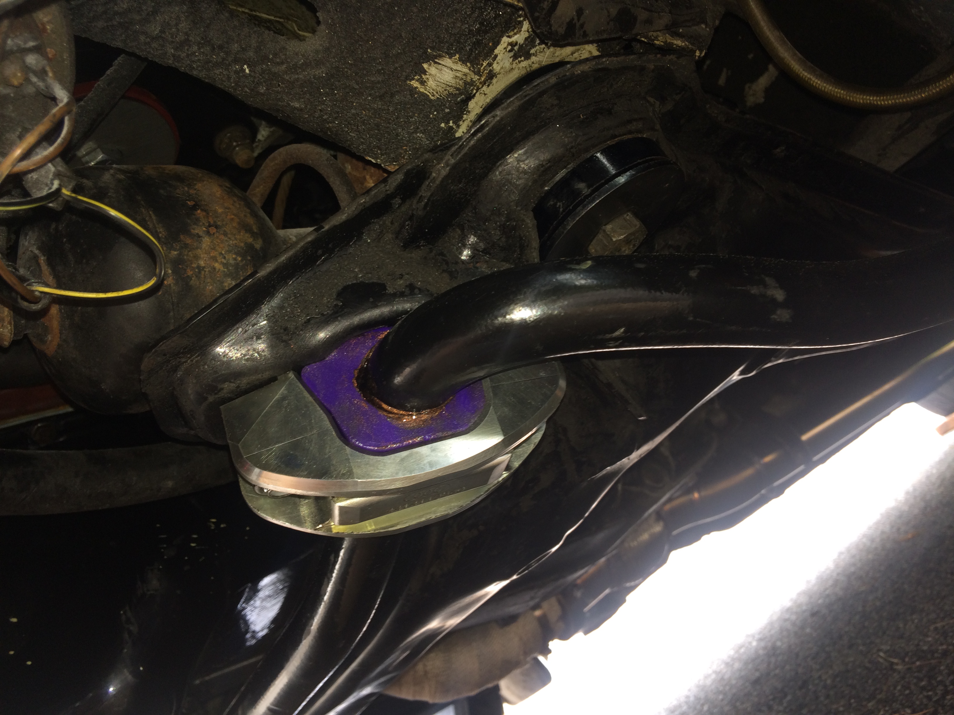

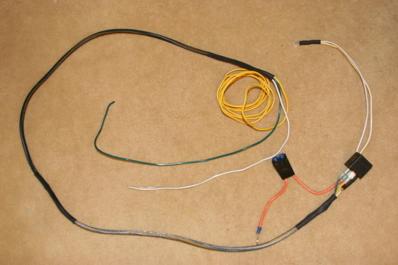

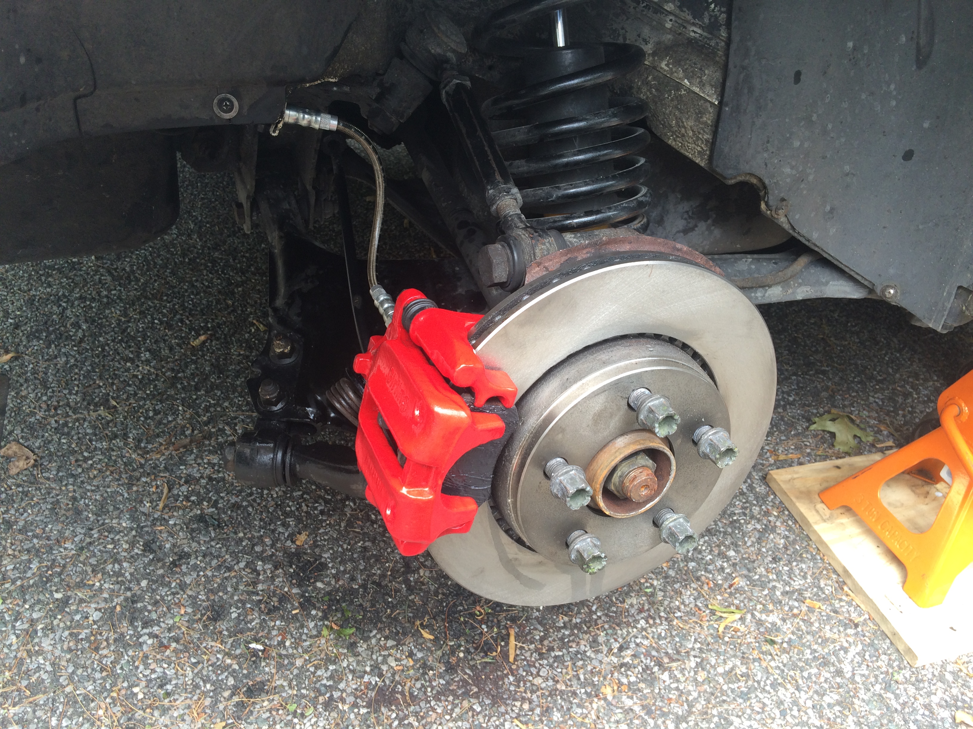

Front and rear brake upgrades...
Front: stock Girling G60 269mm > upgrade Brembo 993TT 321mm
Rear: stock 245x10mm solid > upgrade 220 20v 269x20mm vented...

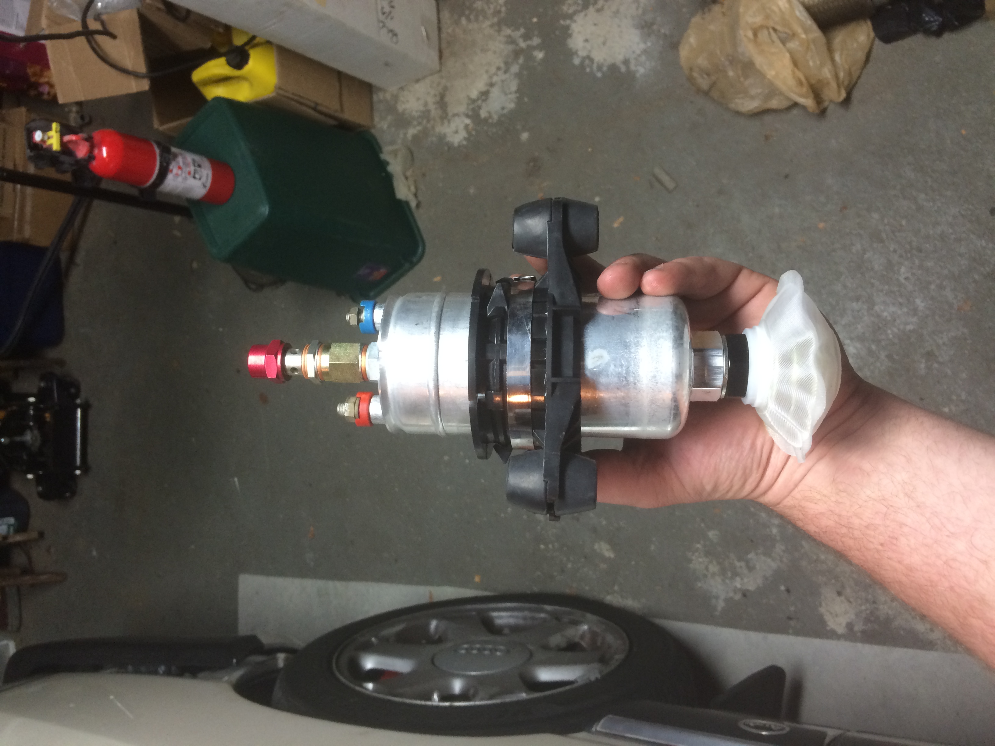

Fuel Pump upgrade: Bosch 044 pump, upgraded intake line, fuel pump relay upgrade...

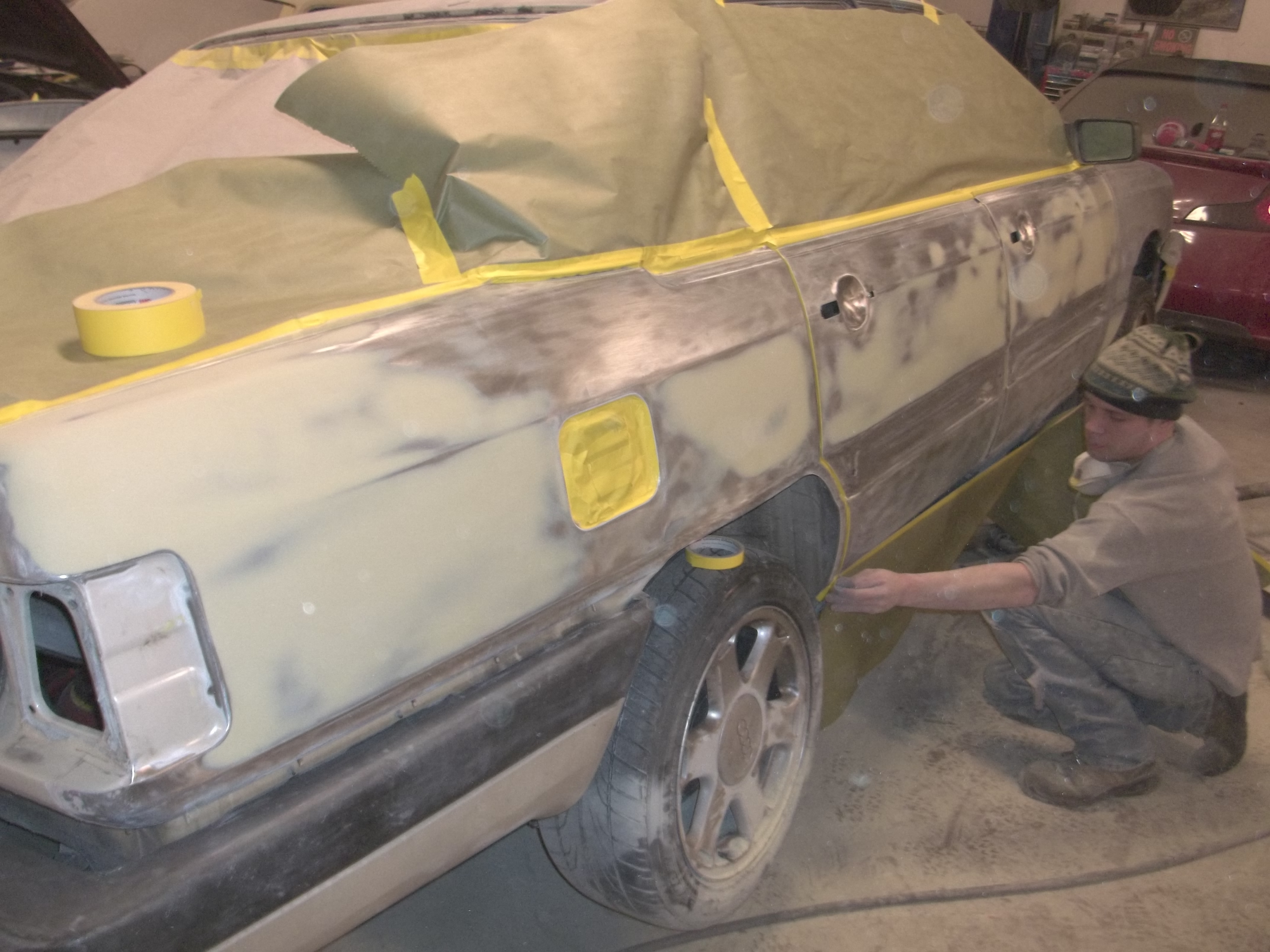

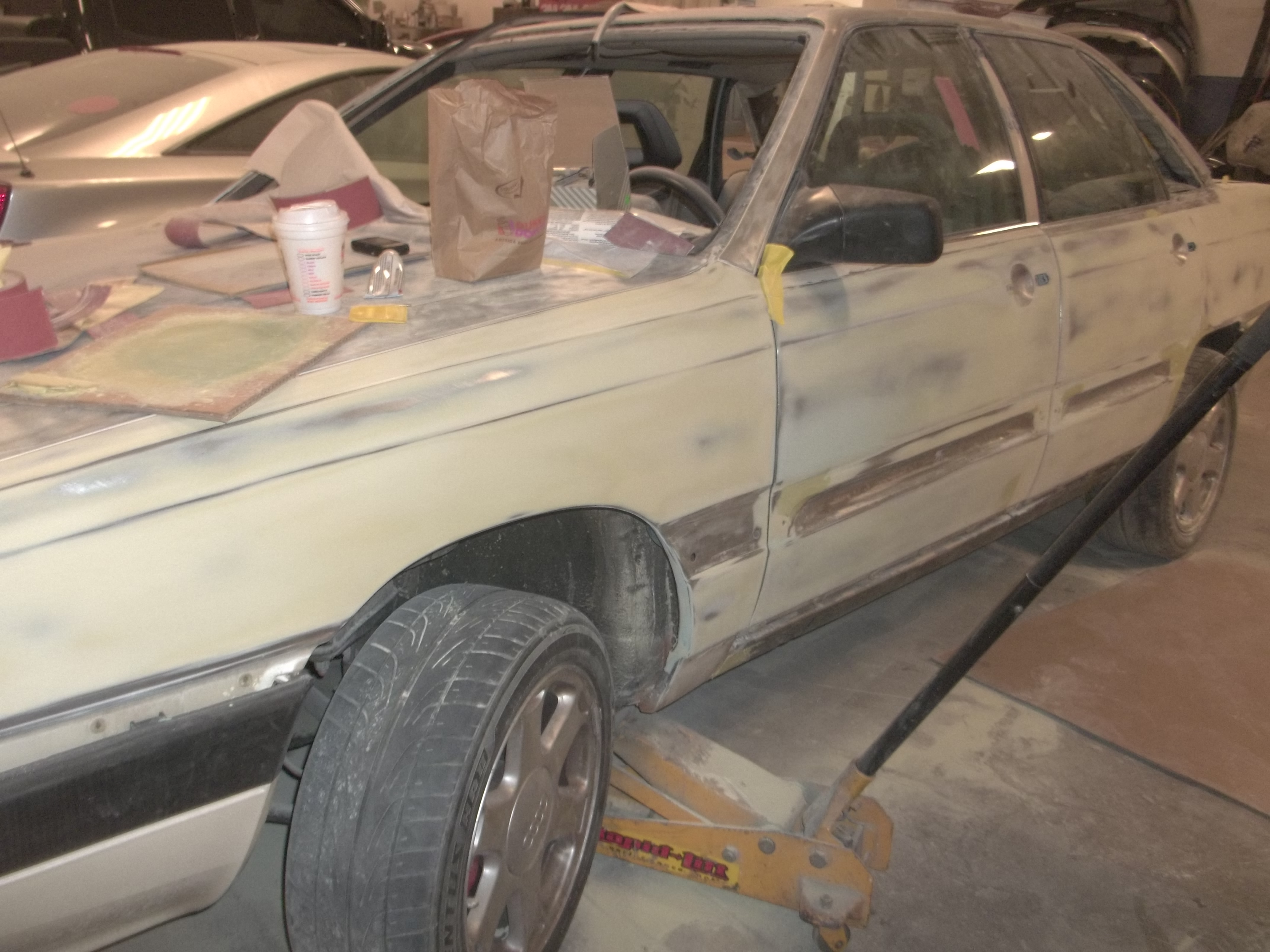

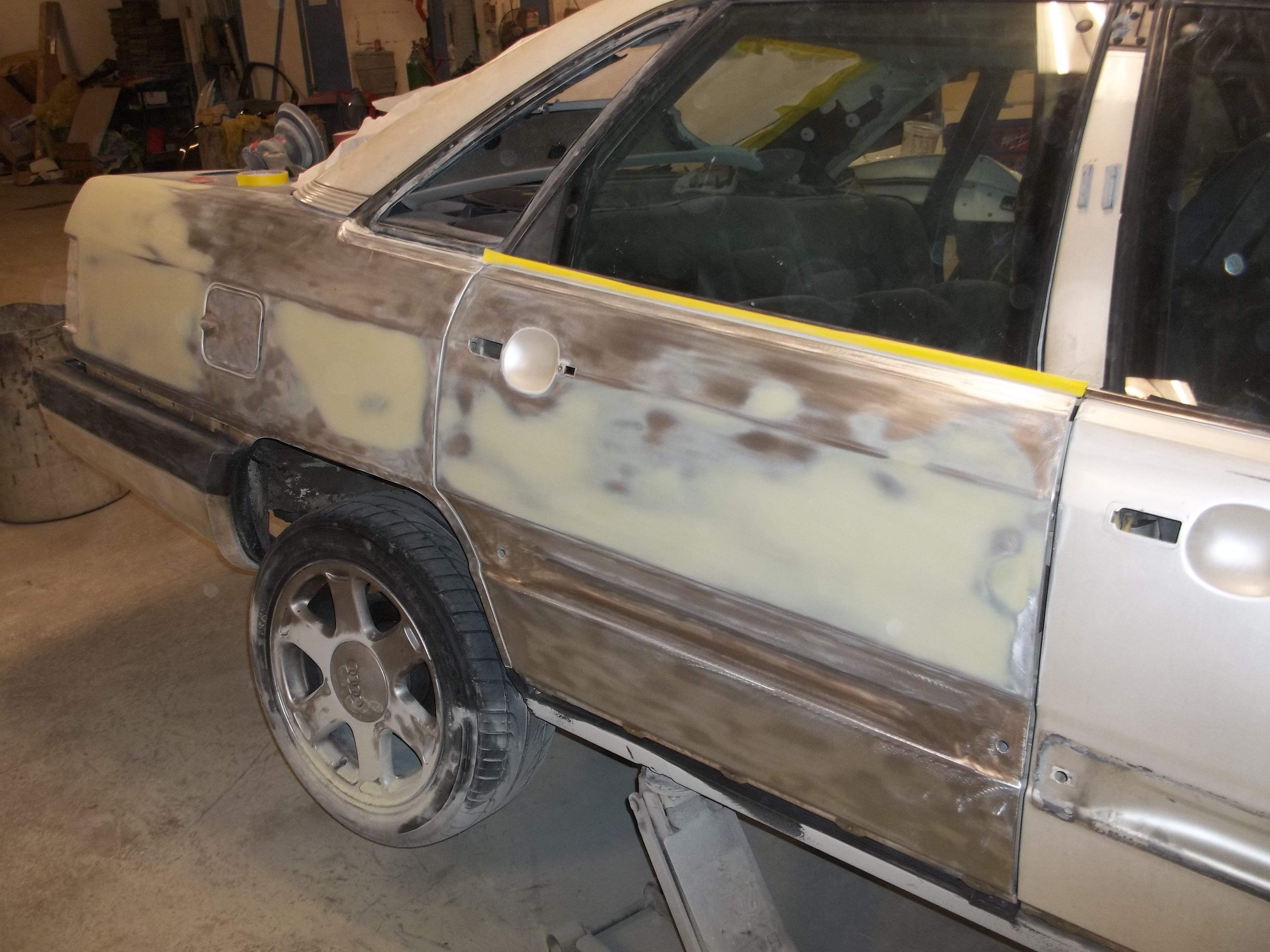

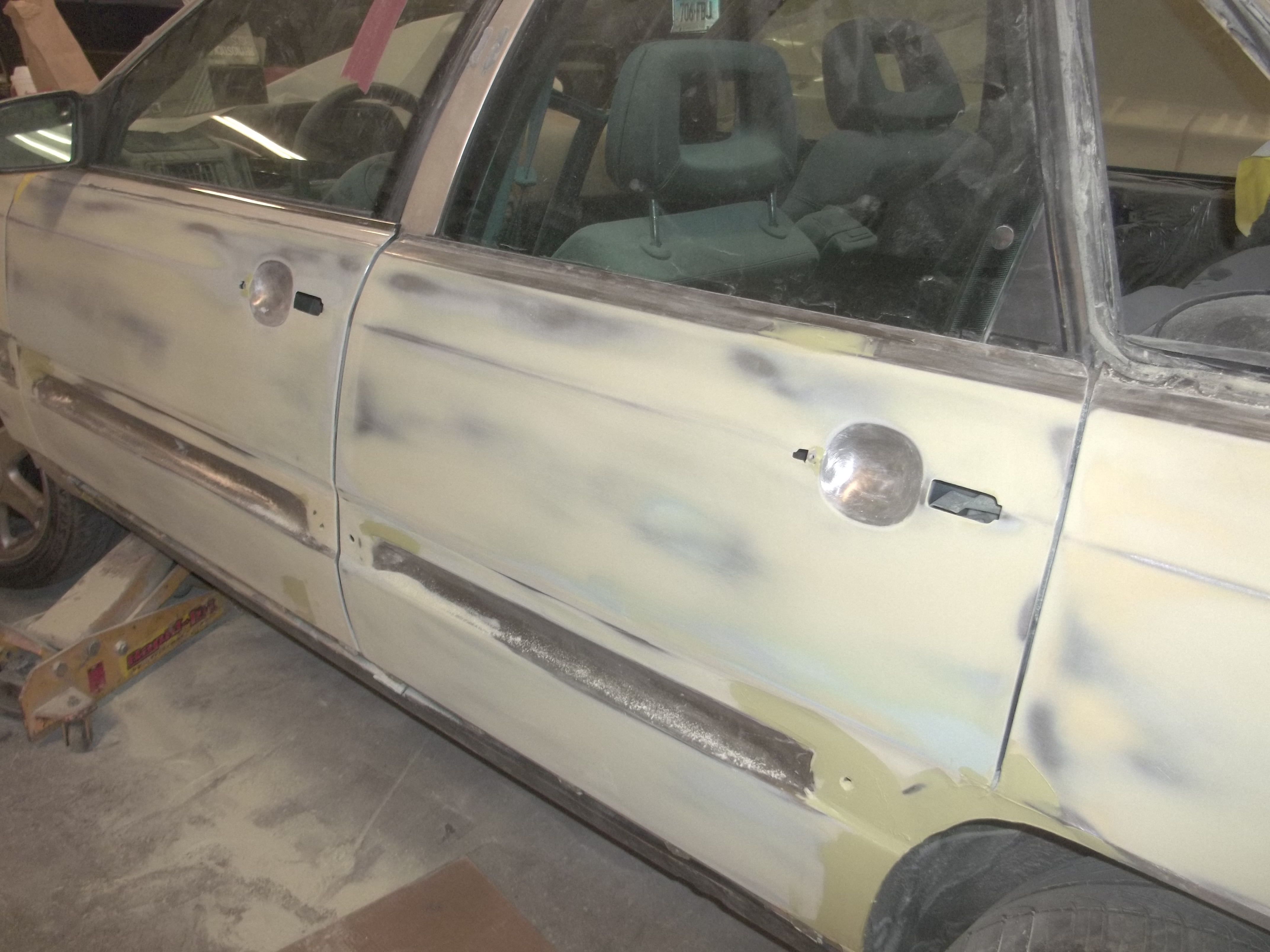

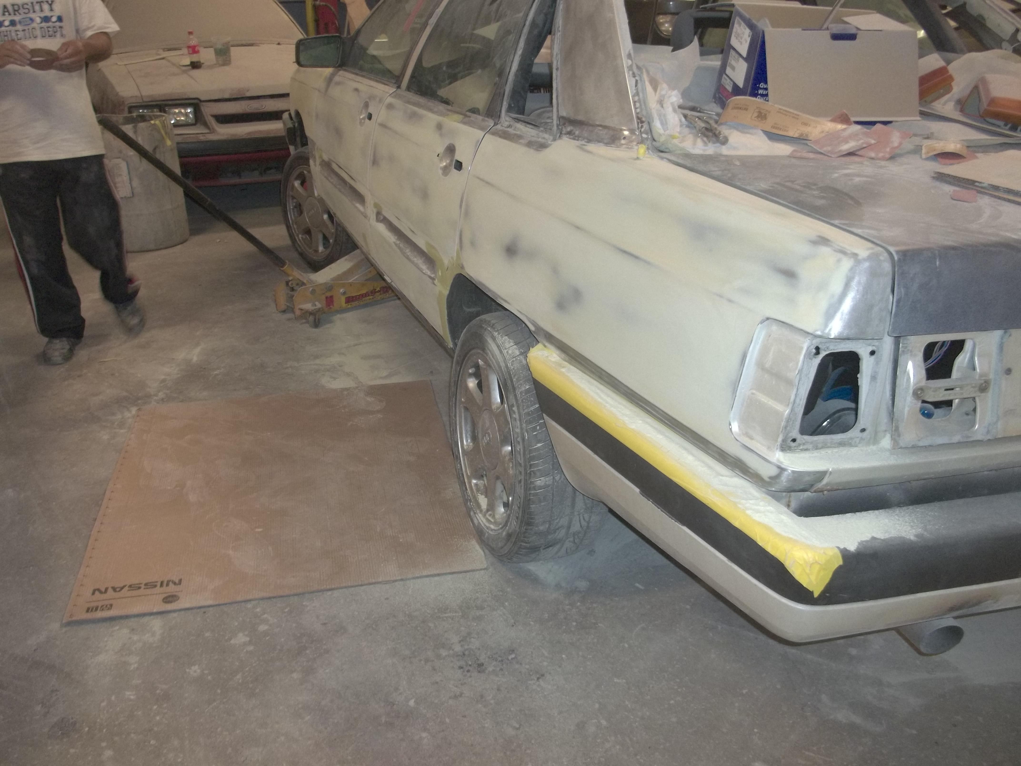

Time to prep the body for paint!

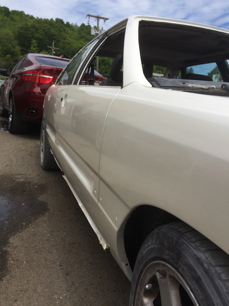

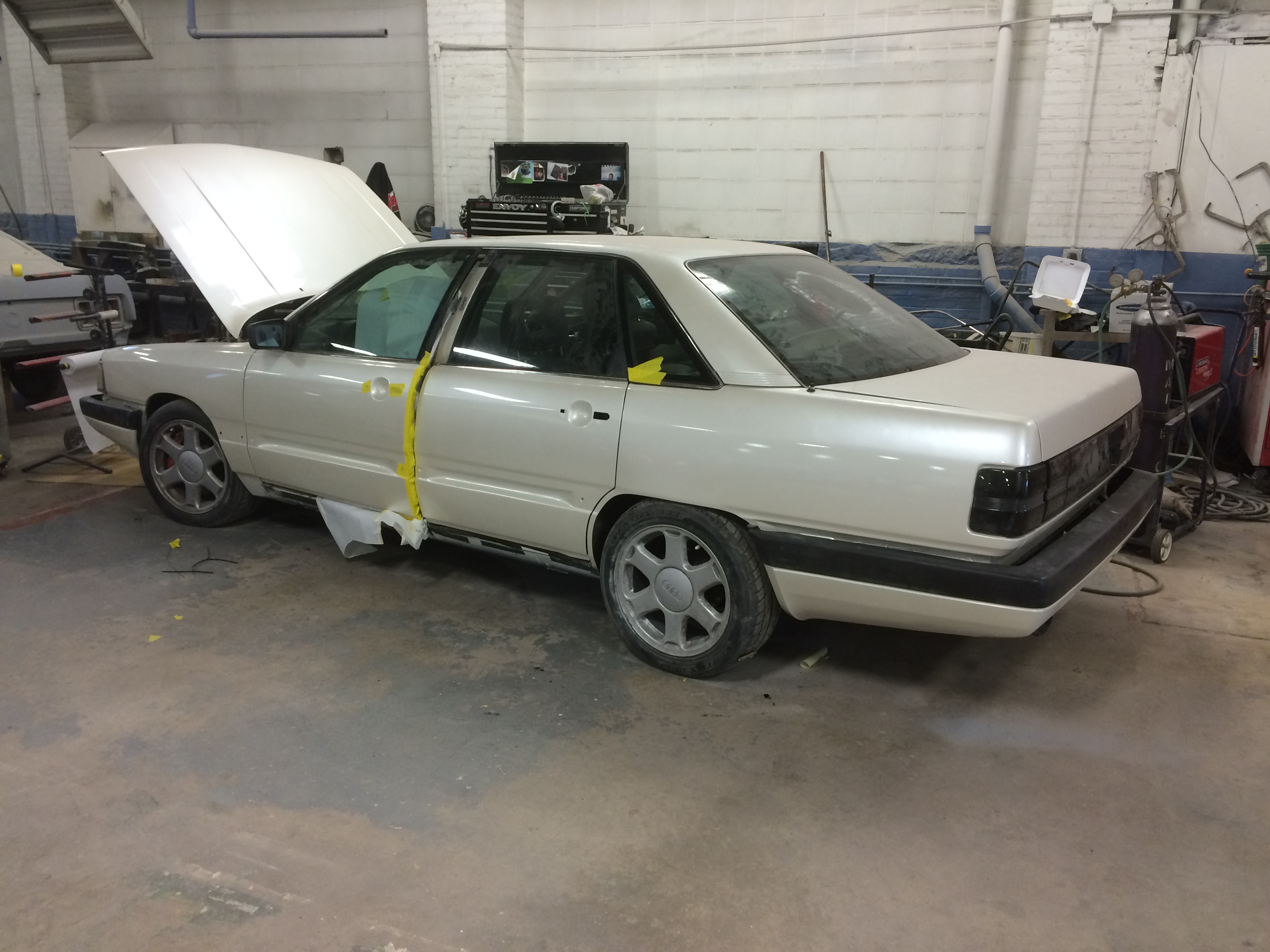

Wonderful a fresh coat of L0B9 - Pearl White!

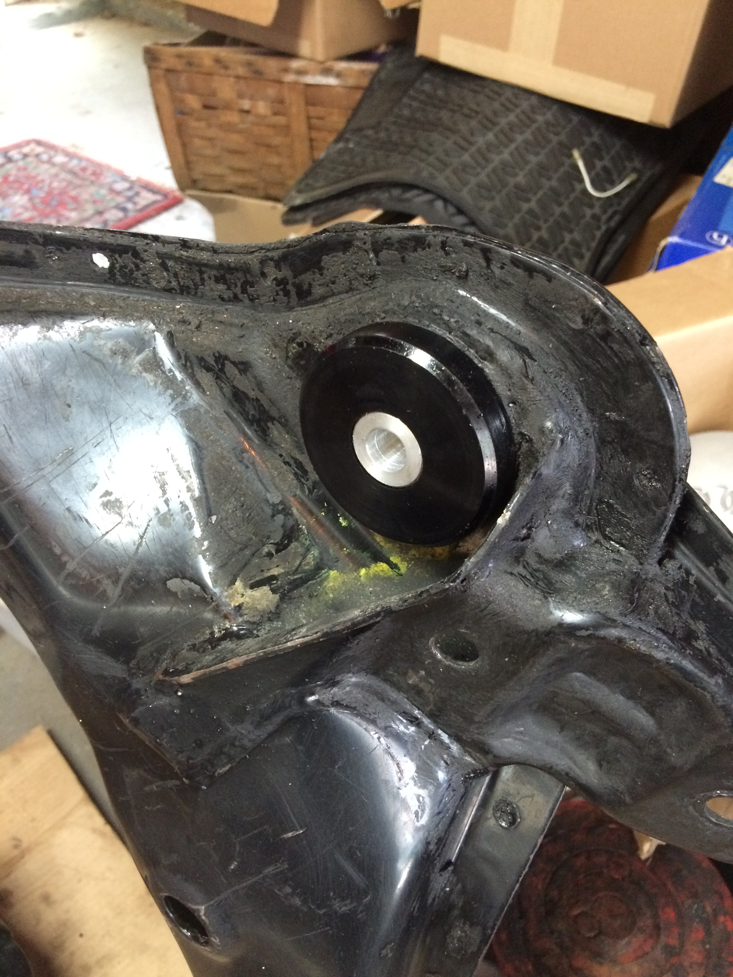

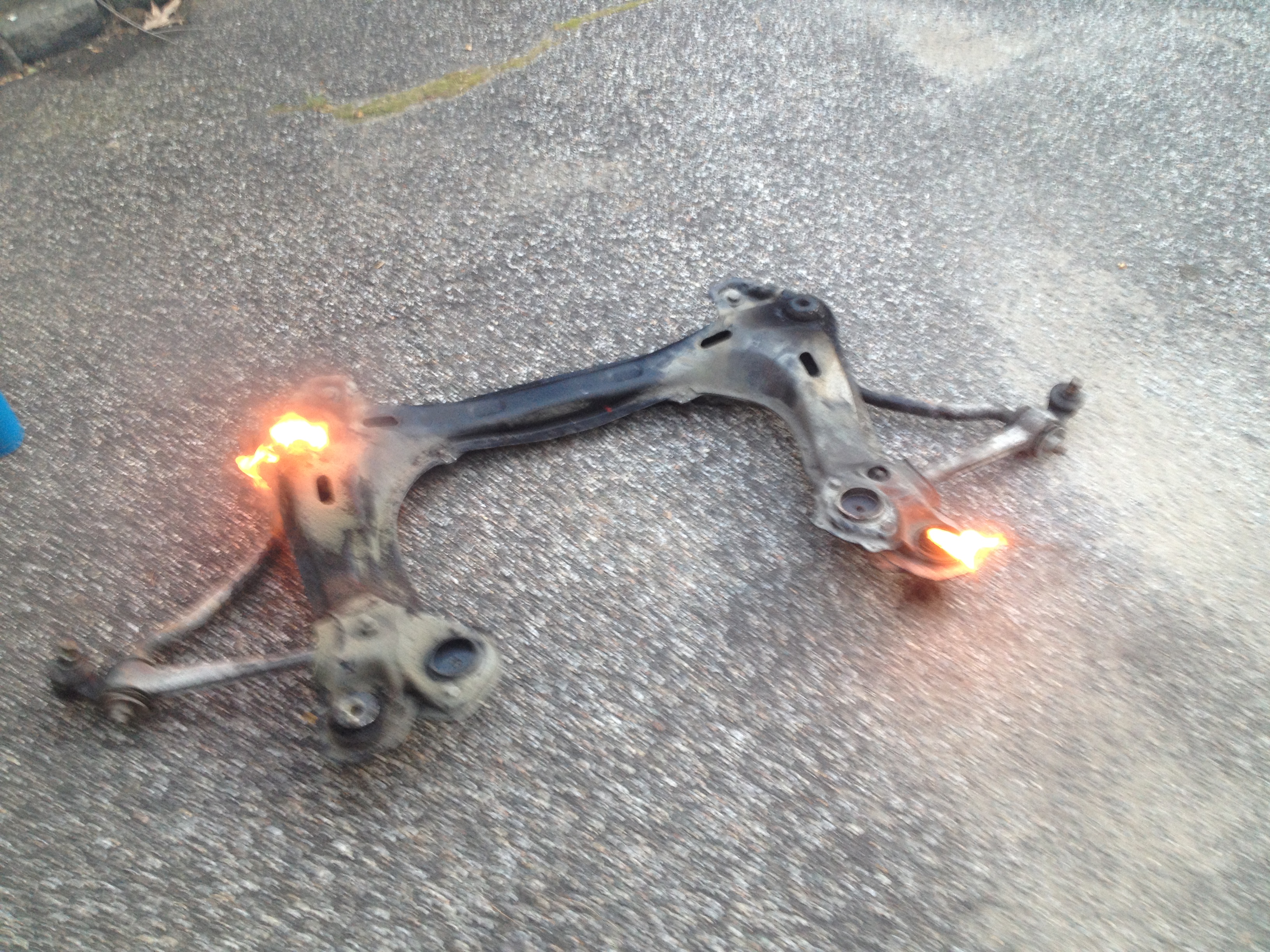

Front end rebuild...

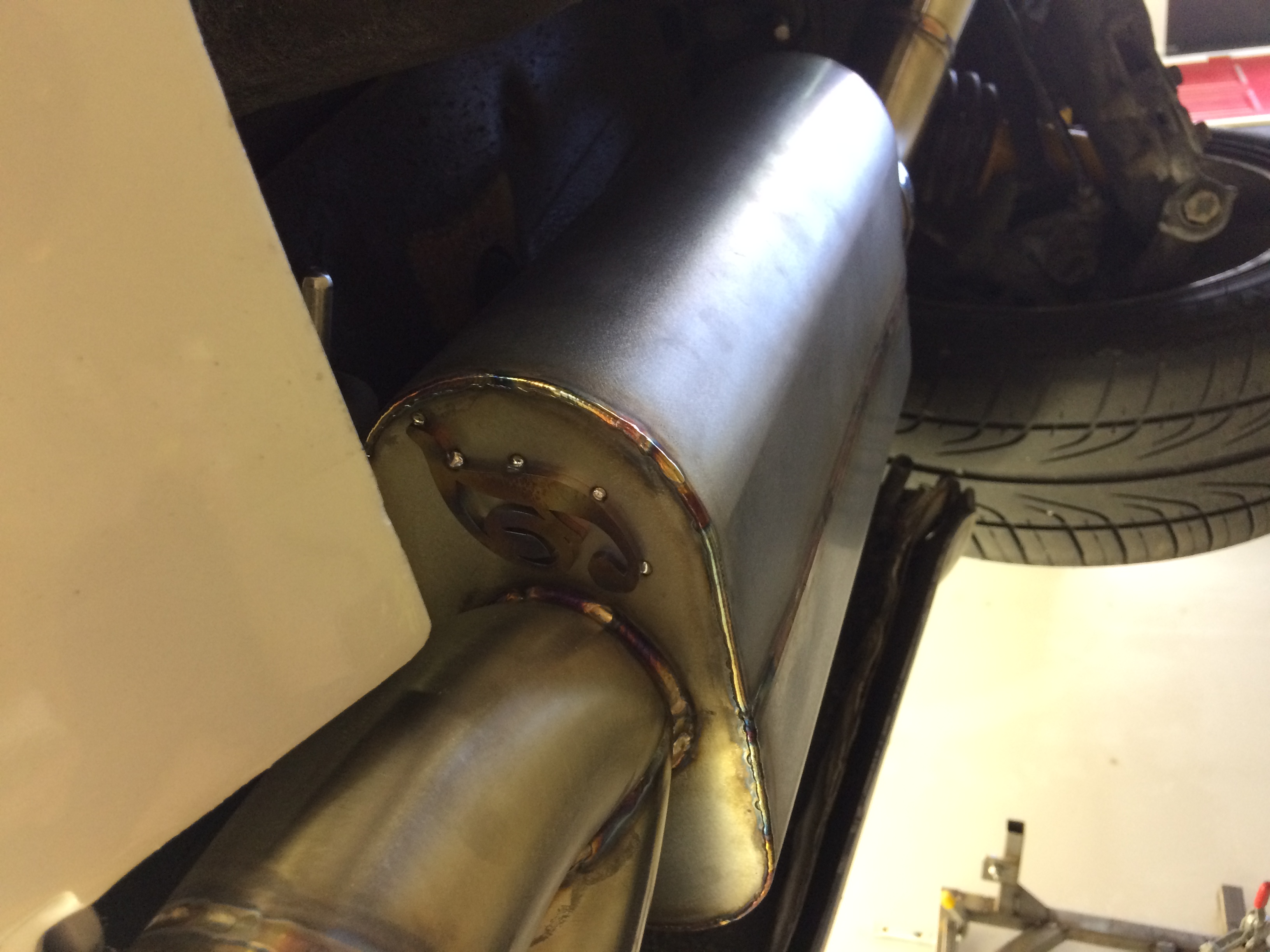

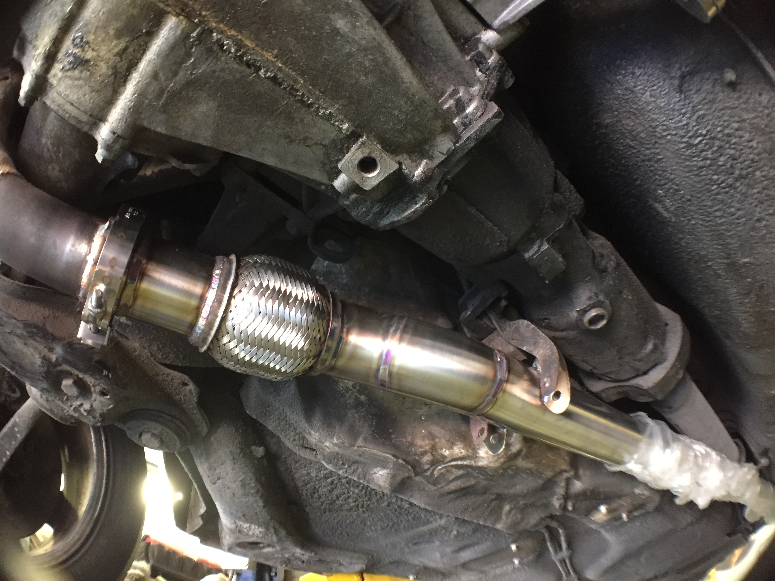

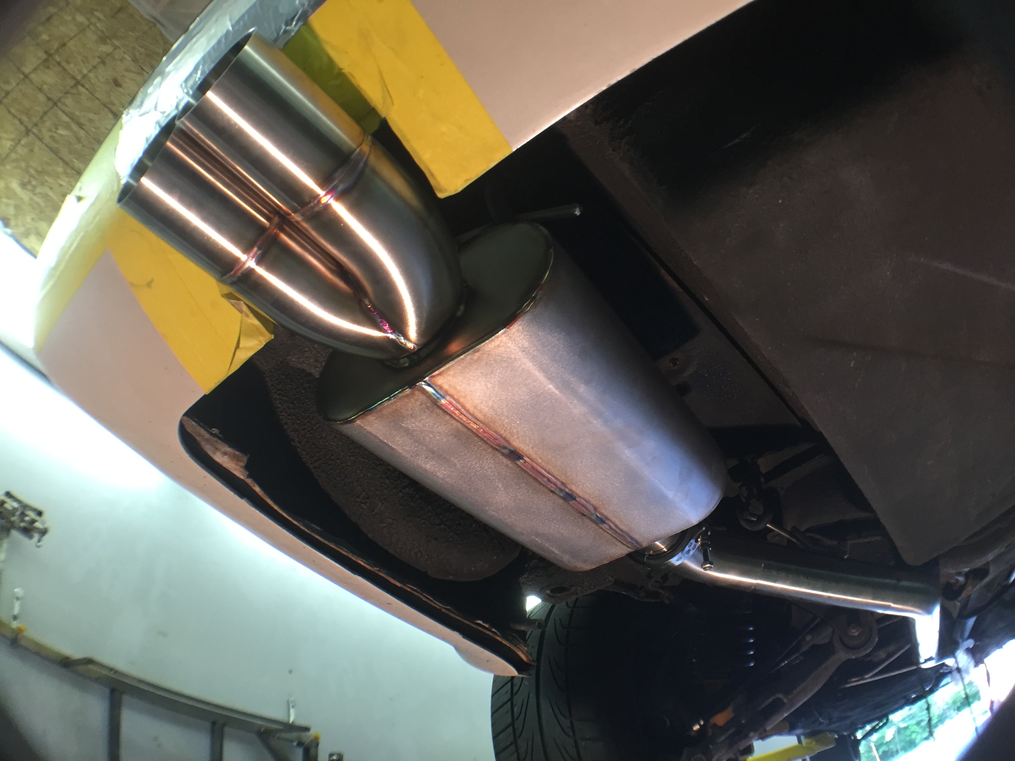

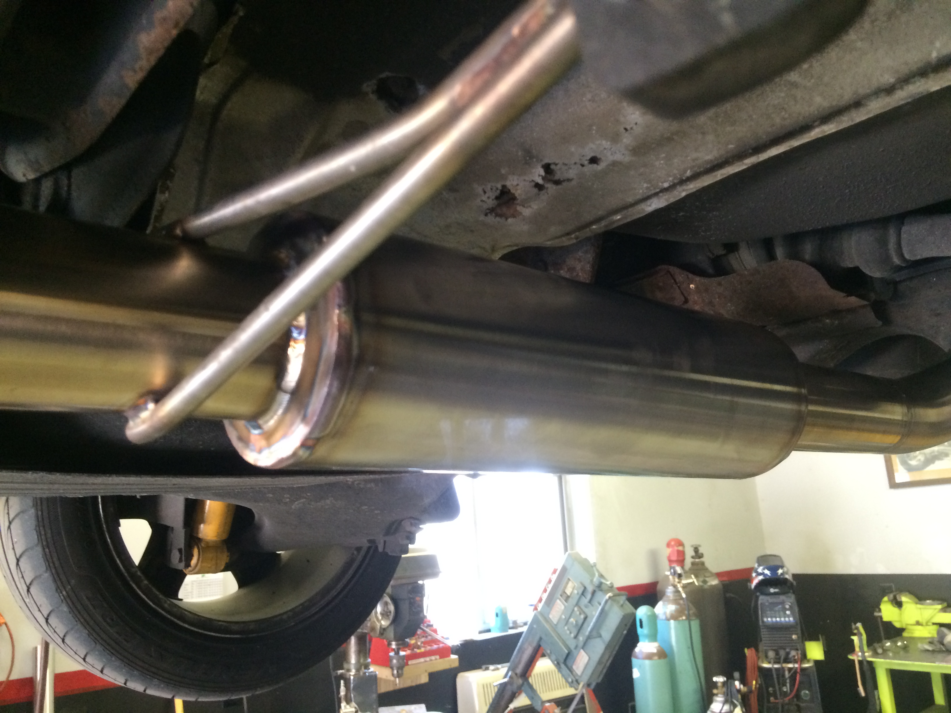

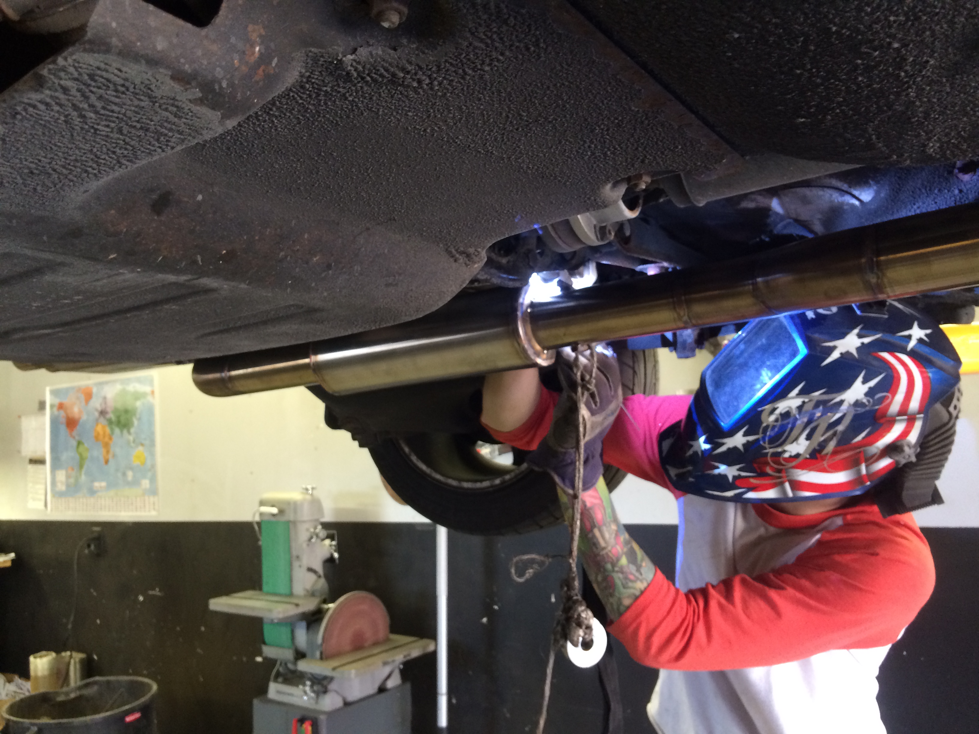

Exhaust: Thanks to my friend Jay of Filthy Habits Fabrication of "Buffalo"...
2.5"...v-band... stainless... flex joint after the dp... hand crafted resonator and muffler...
https://www.instagram.com/p/5ww1-WKwit/
Last edited by oldsklaudidub on Tue Jun 05, 2018 11:20 am, edited 3 times in total.

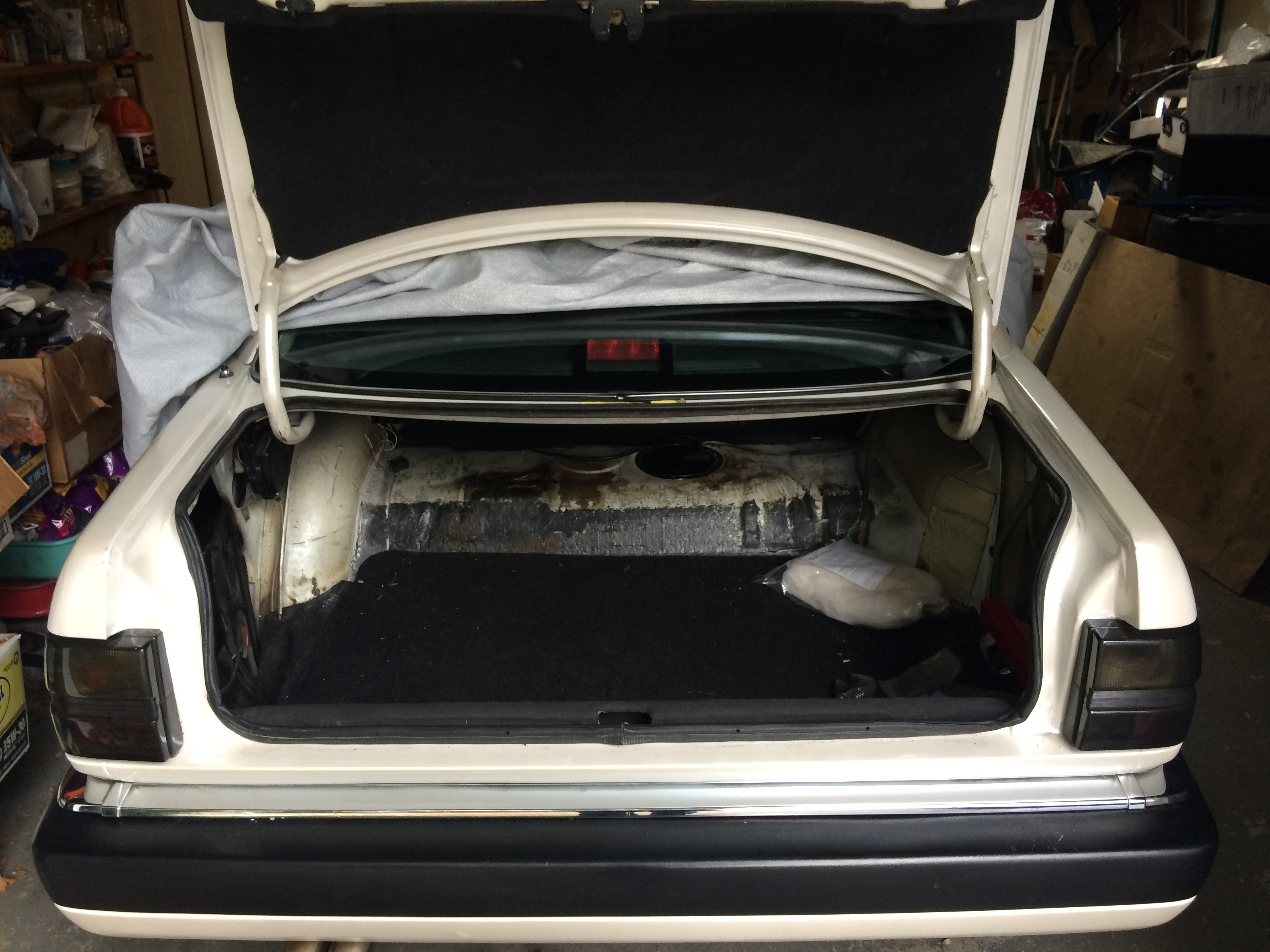

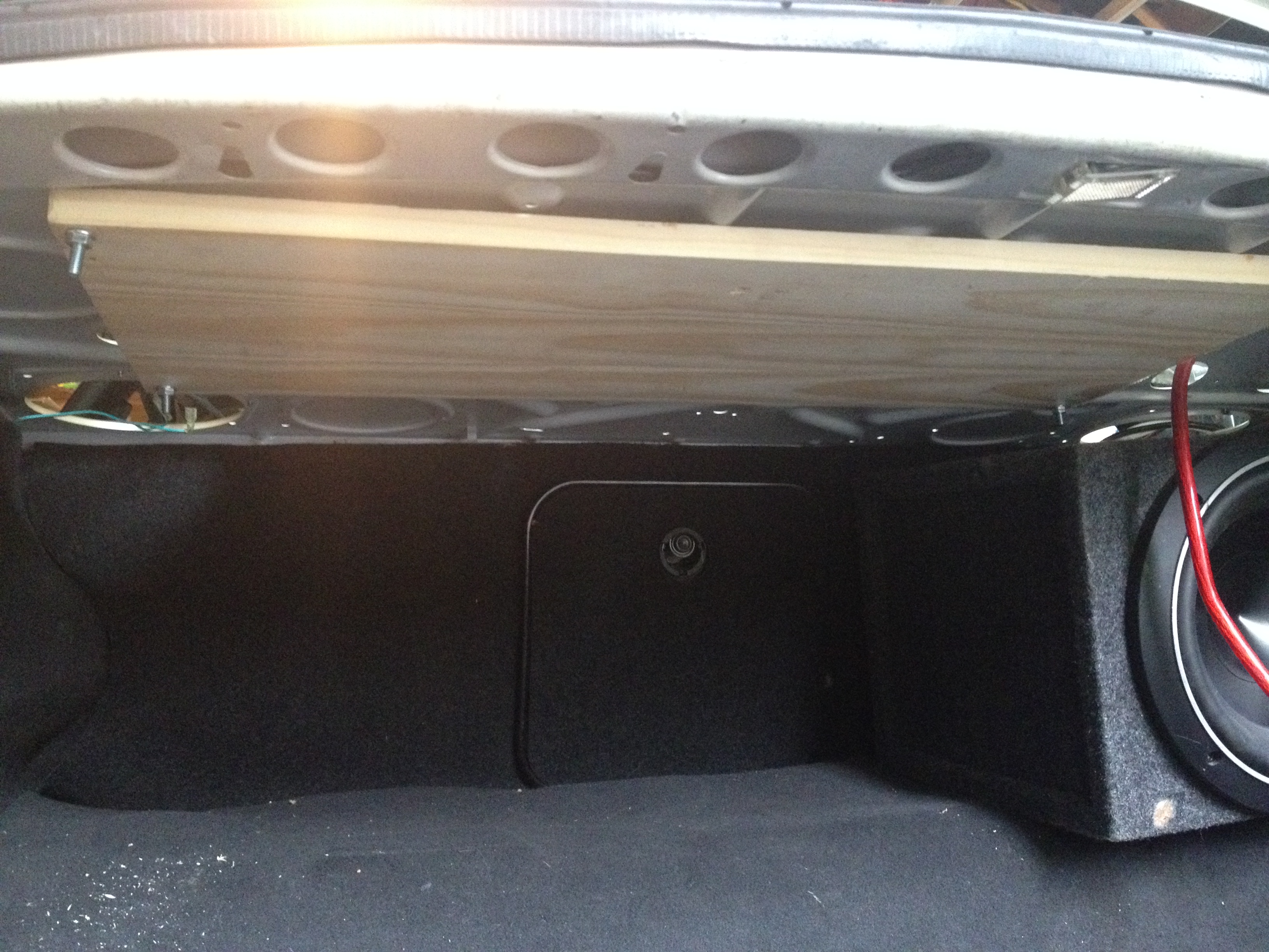

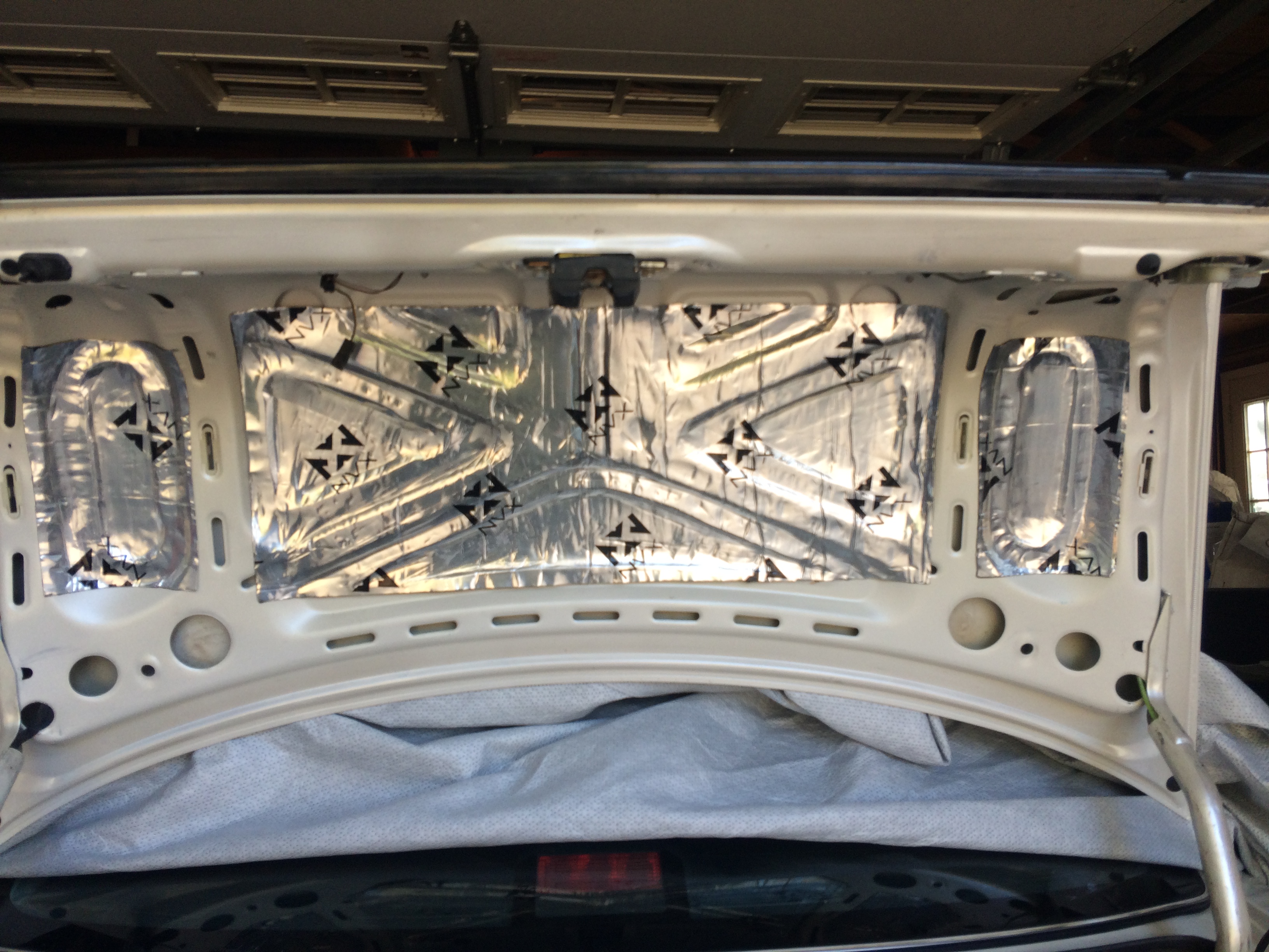

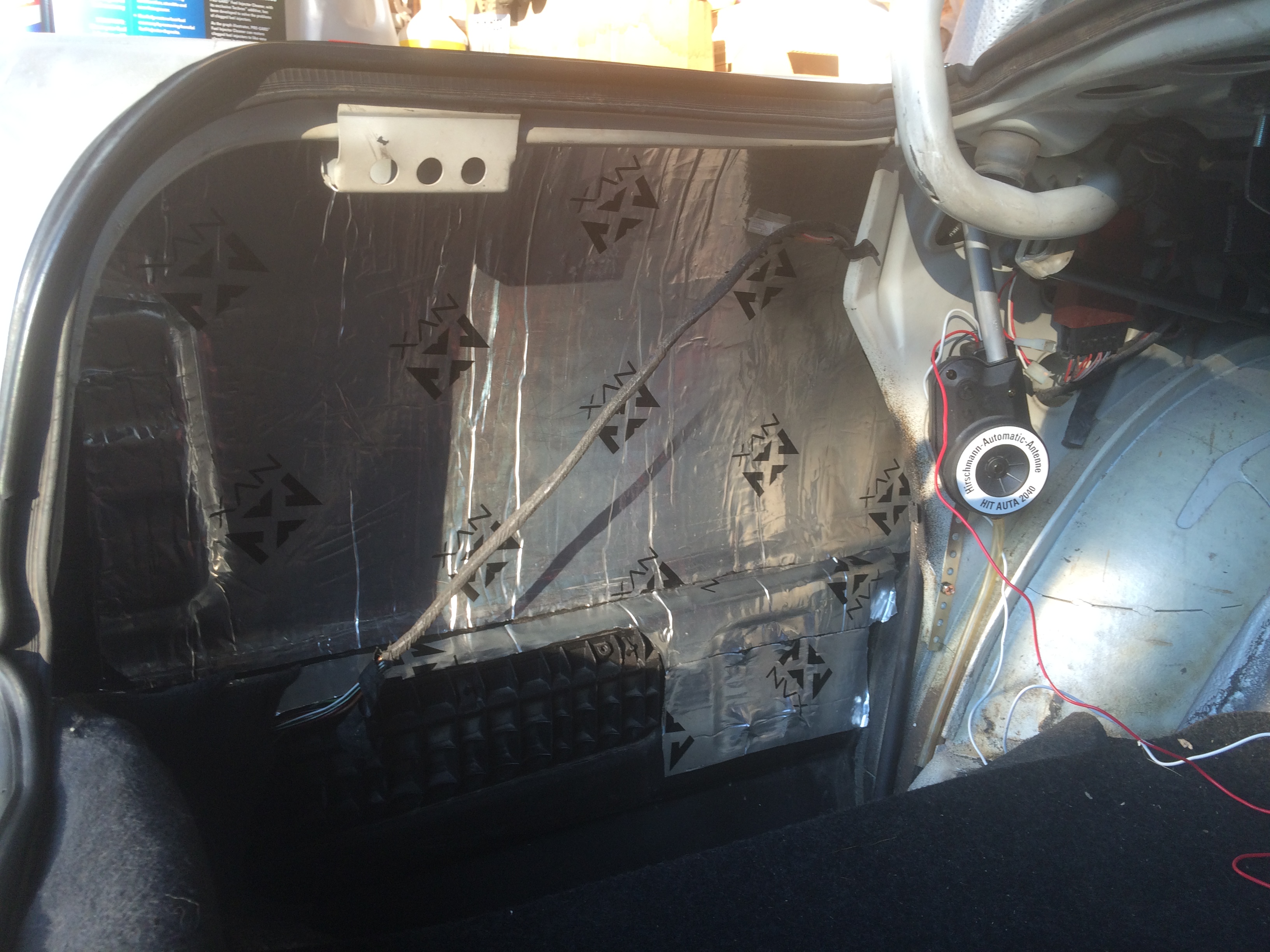

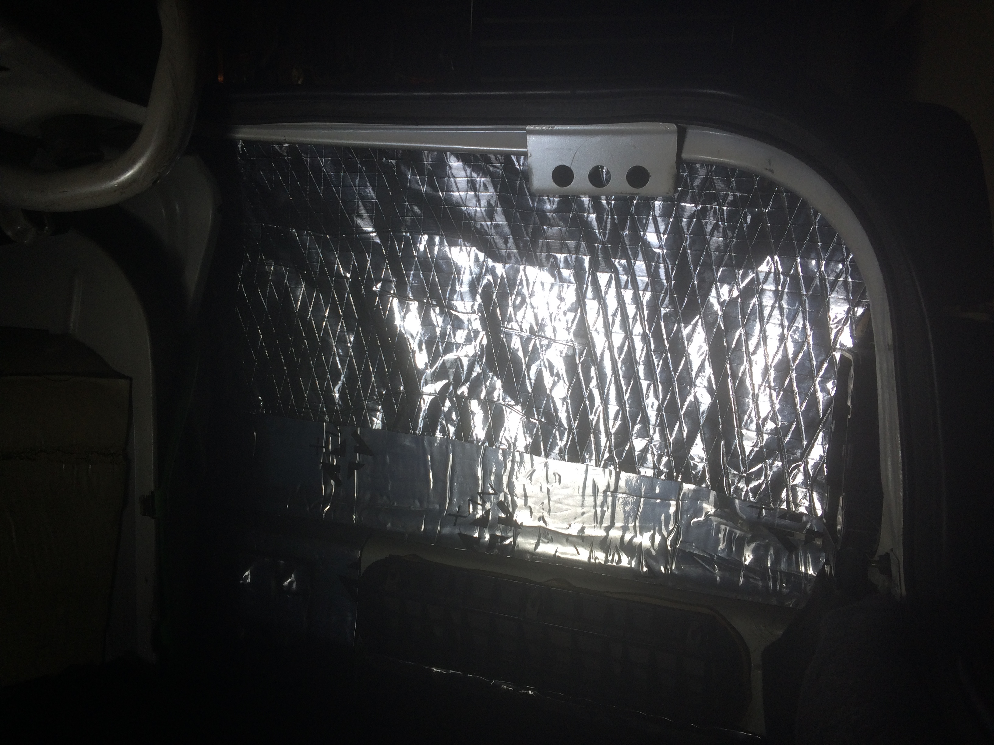

After the exhaust the cabin needed a little help... lets get the rattle can trunk squared away...
Last edited by oldsklaudidub on Sun Jun 03, 2018 10:00 pm, edited 1 time in total.

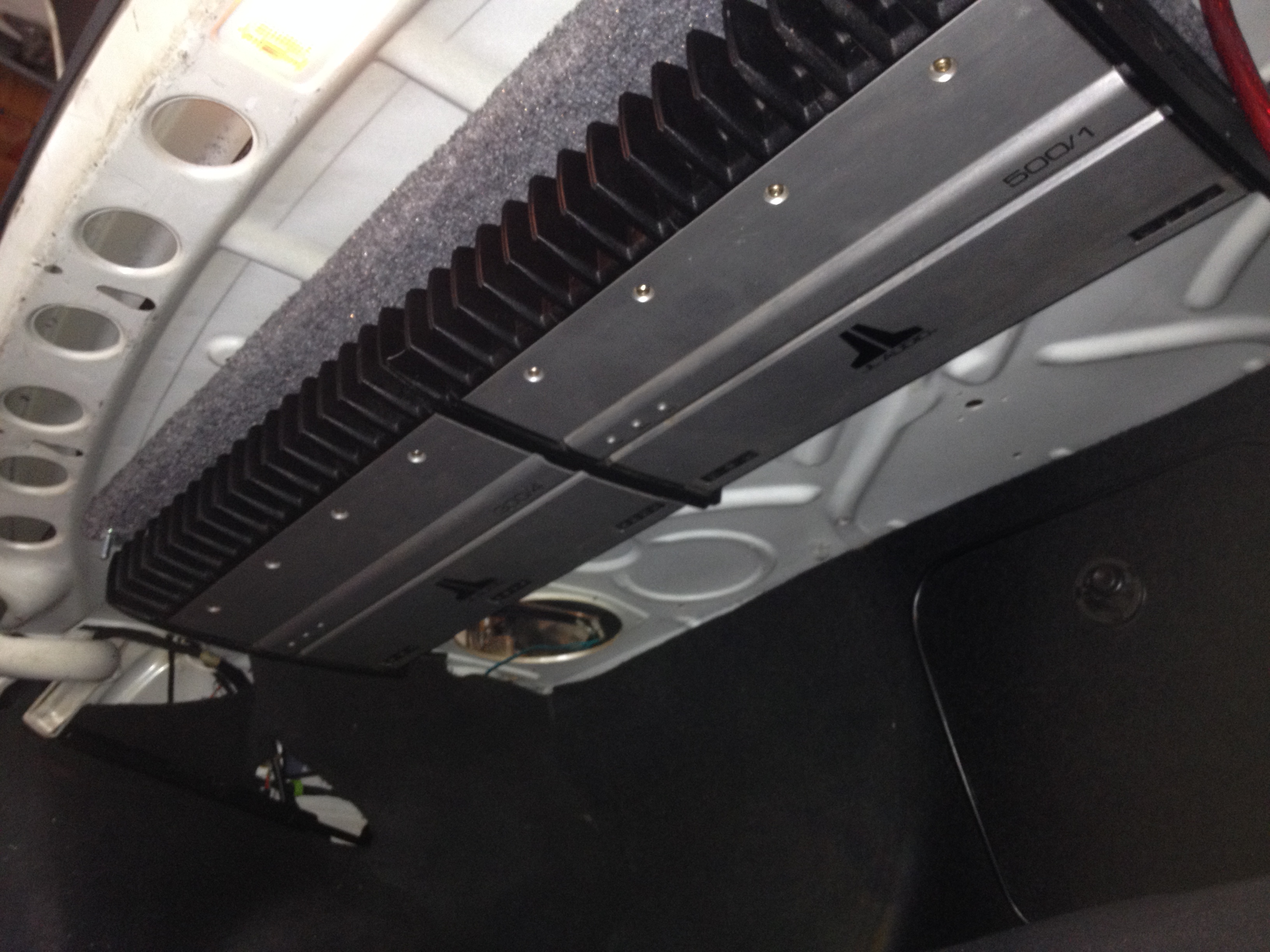

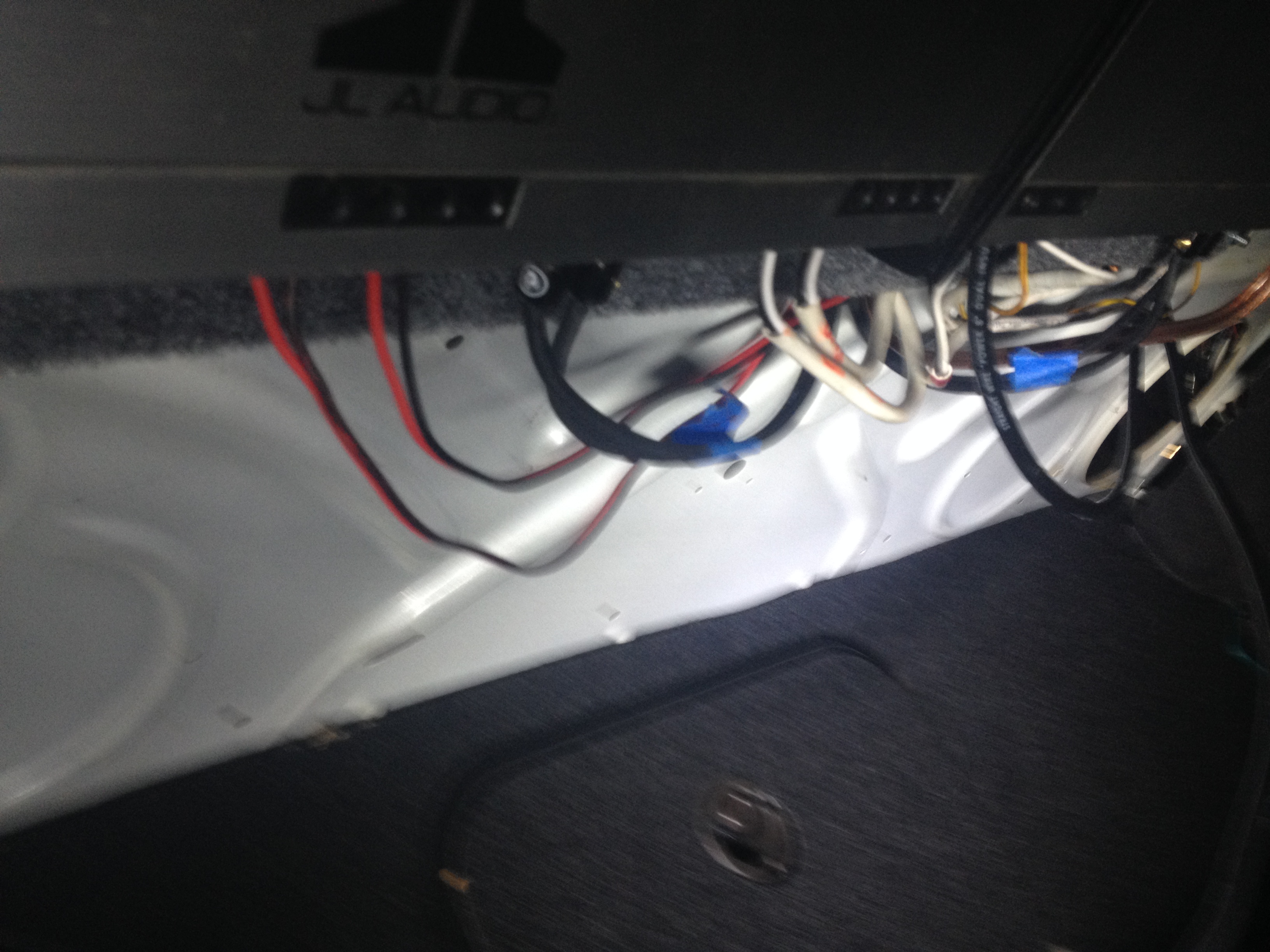

A couple of pictures of the latest rendition of the audio system, couple a JL Audio amps, a small sub, and let not forget my Blaupunkt!

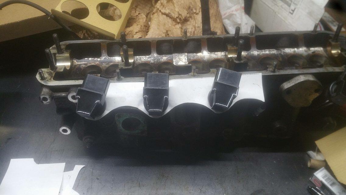

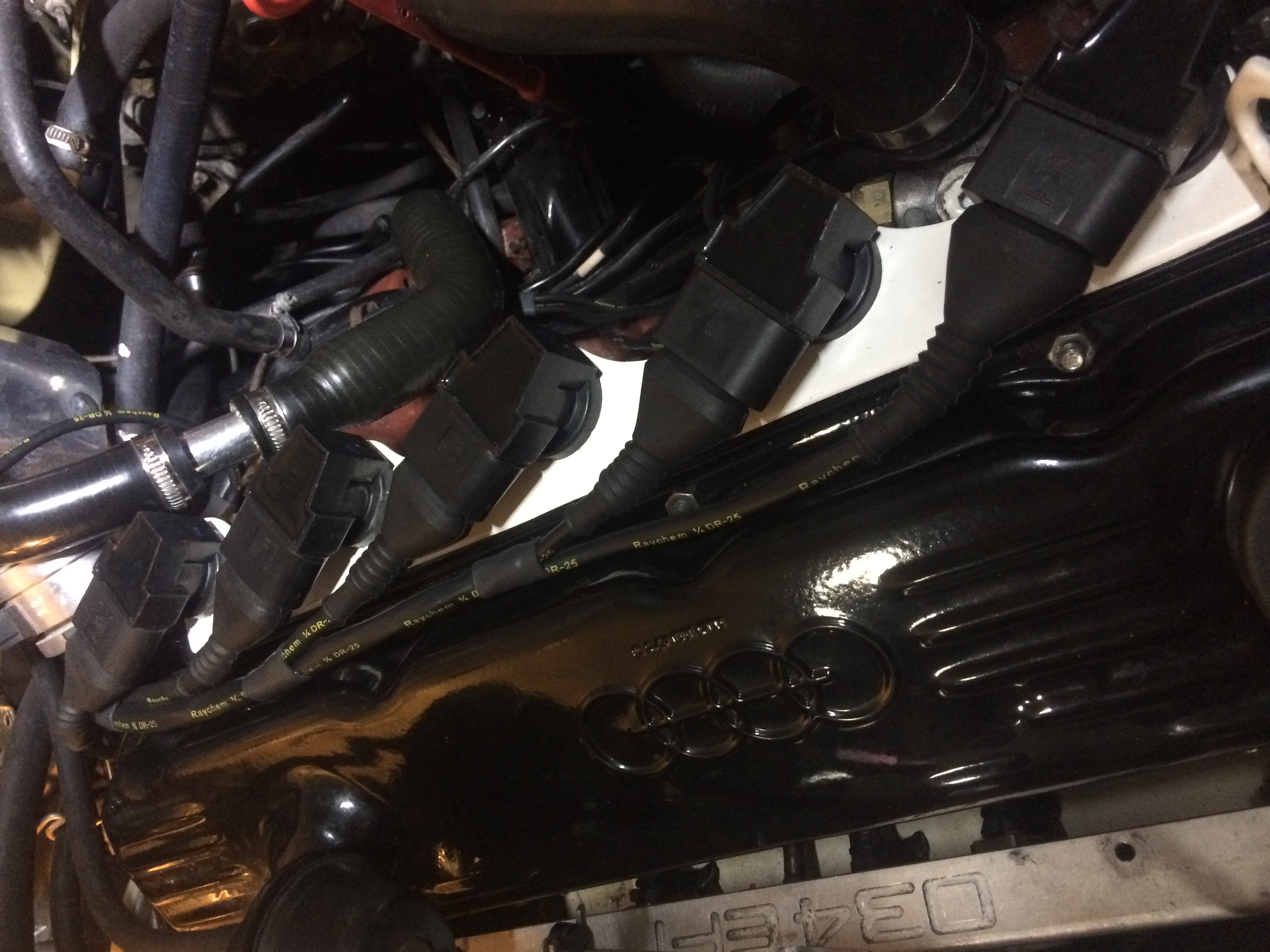

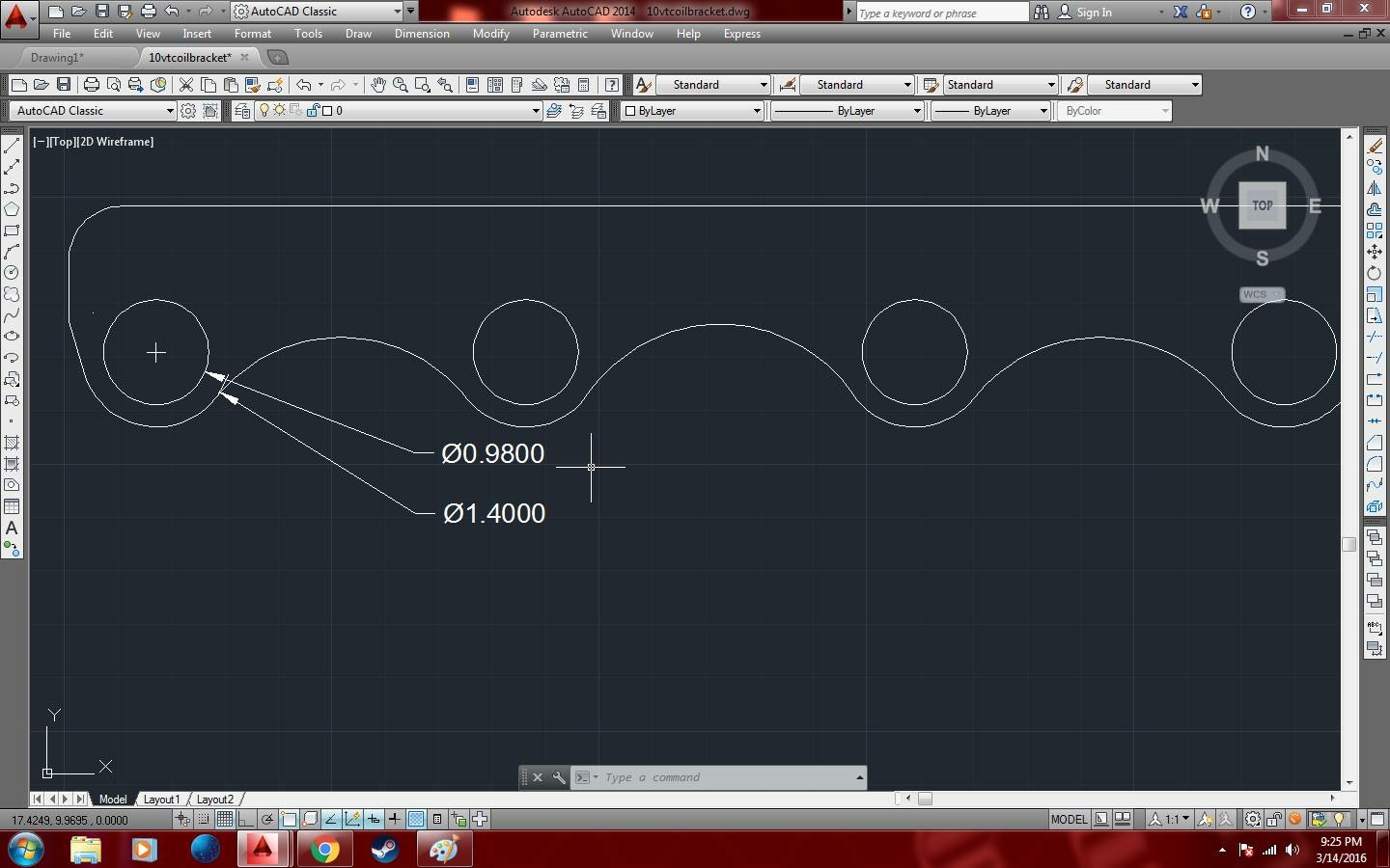

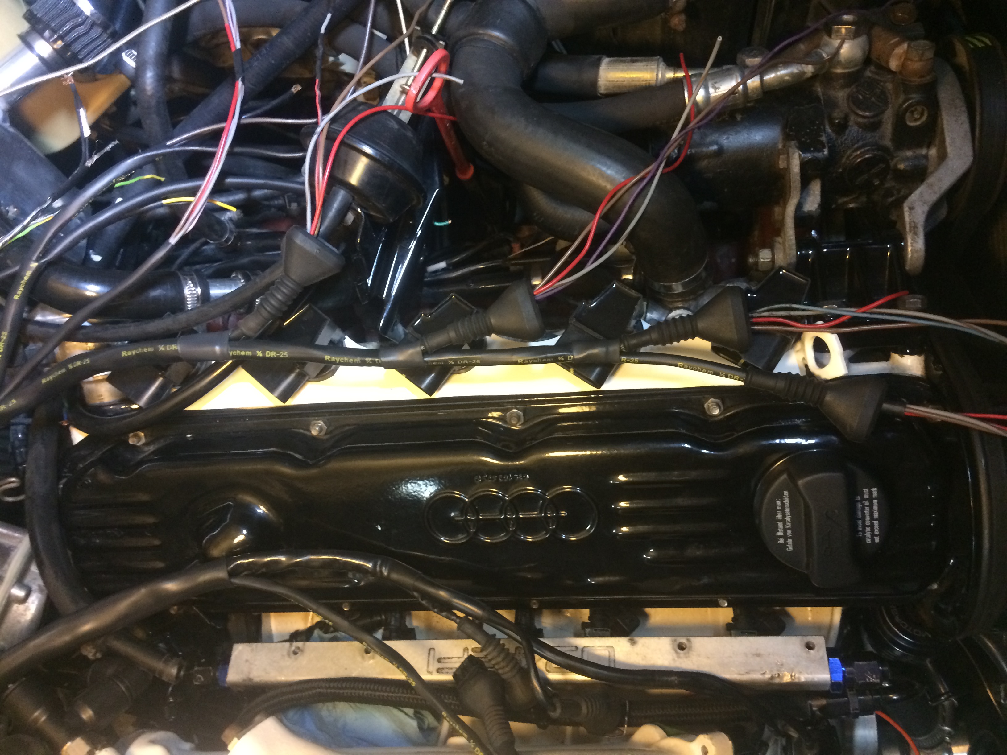

One off VW 1.4L coil mounting solution inspired by a European counterpart... This one was designed and fabricated by HPR...

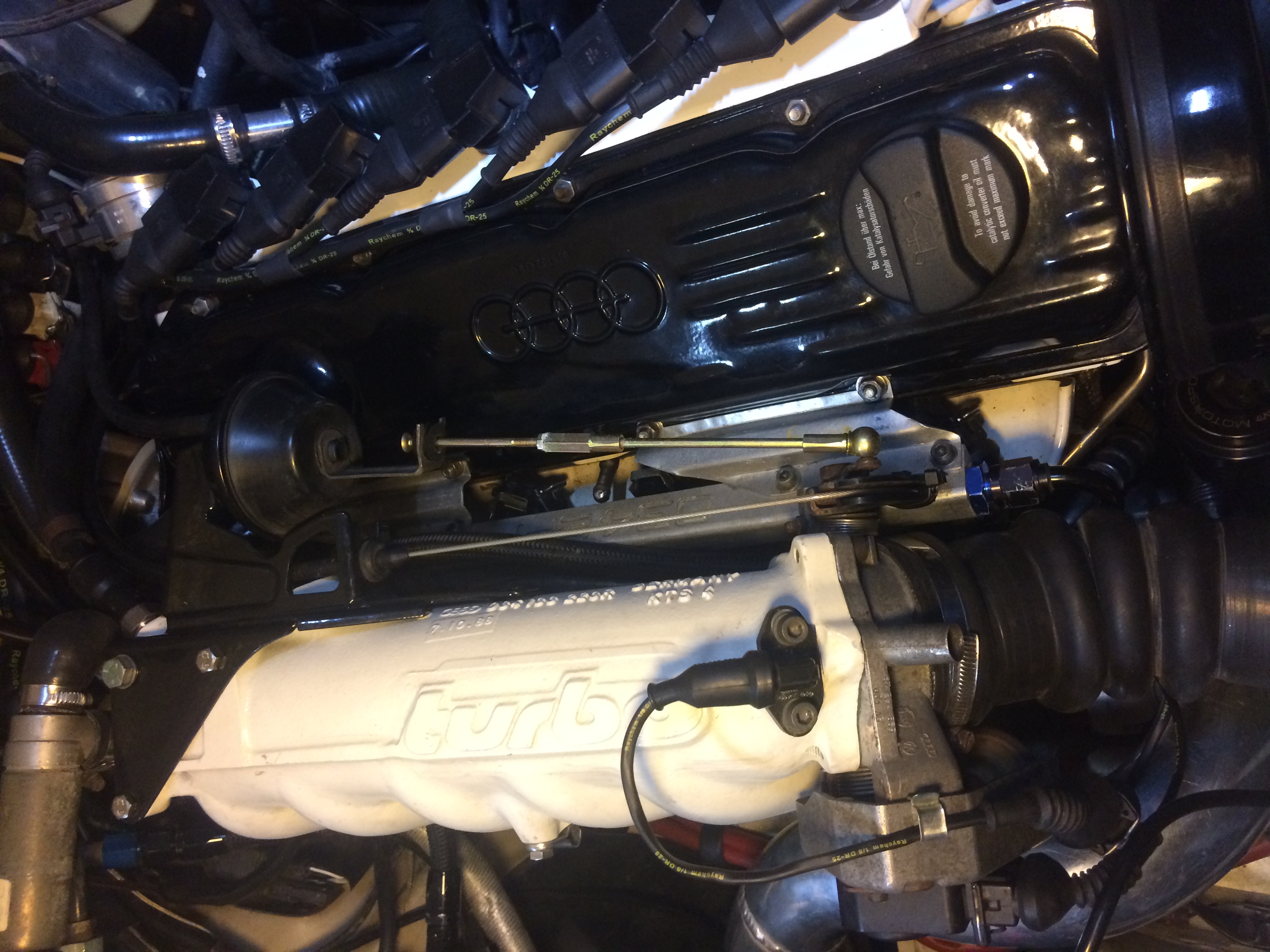

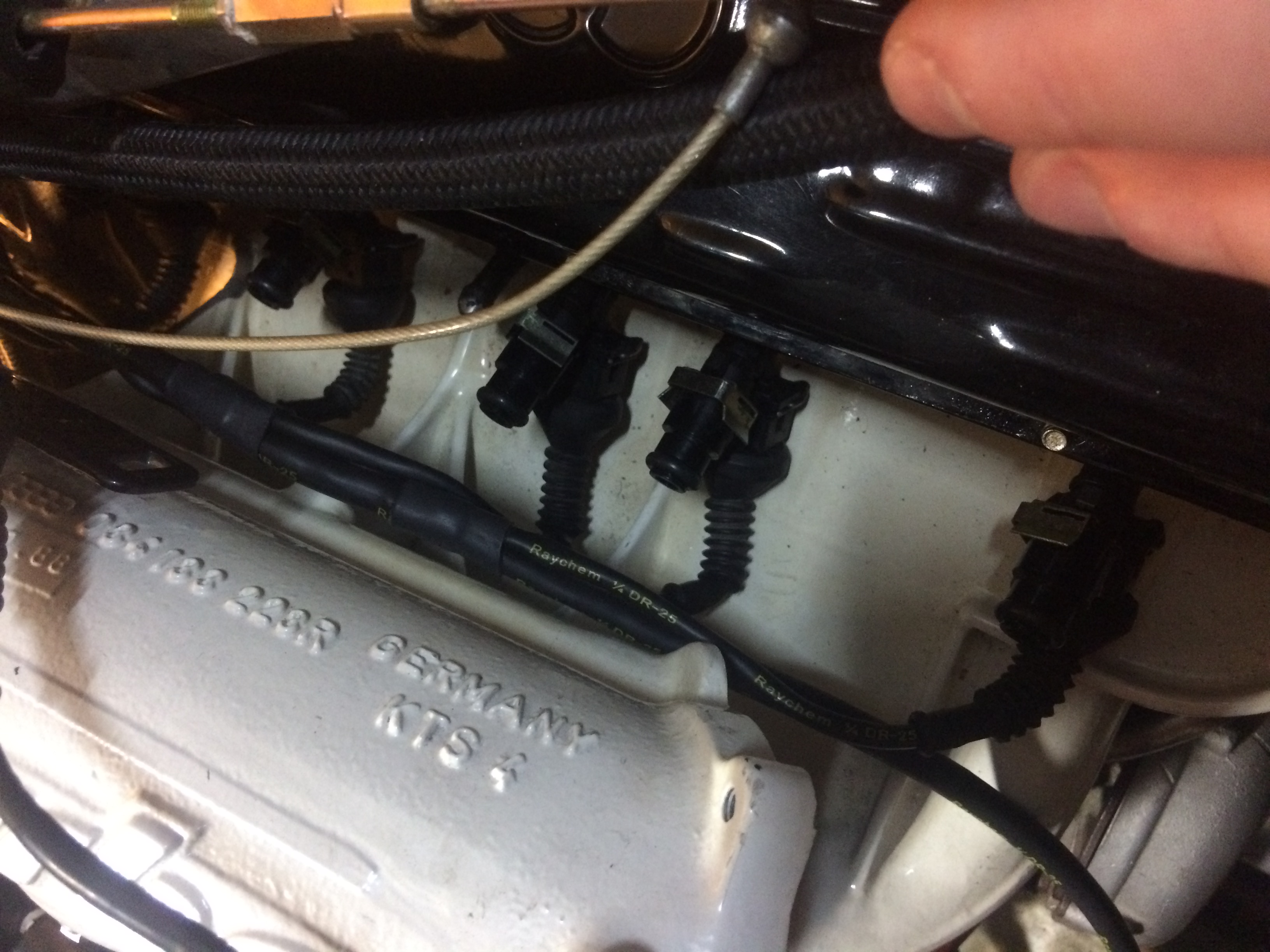

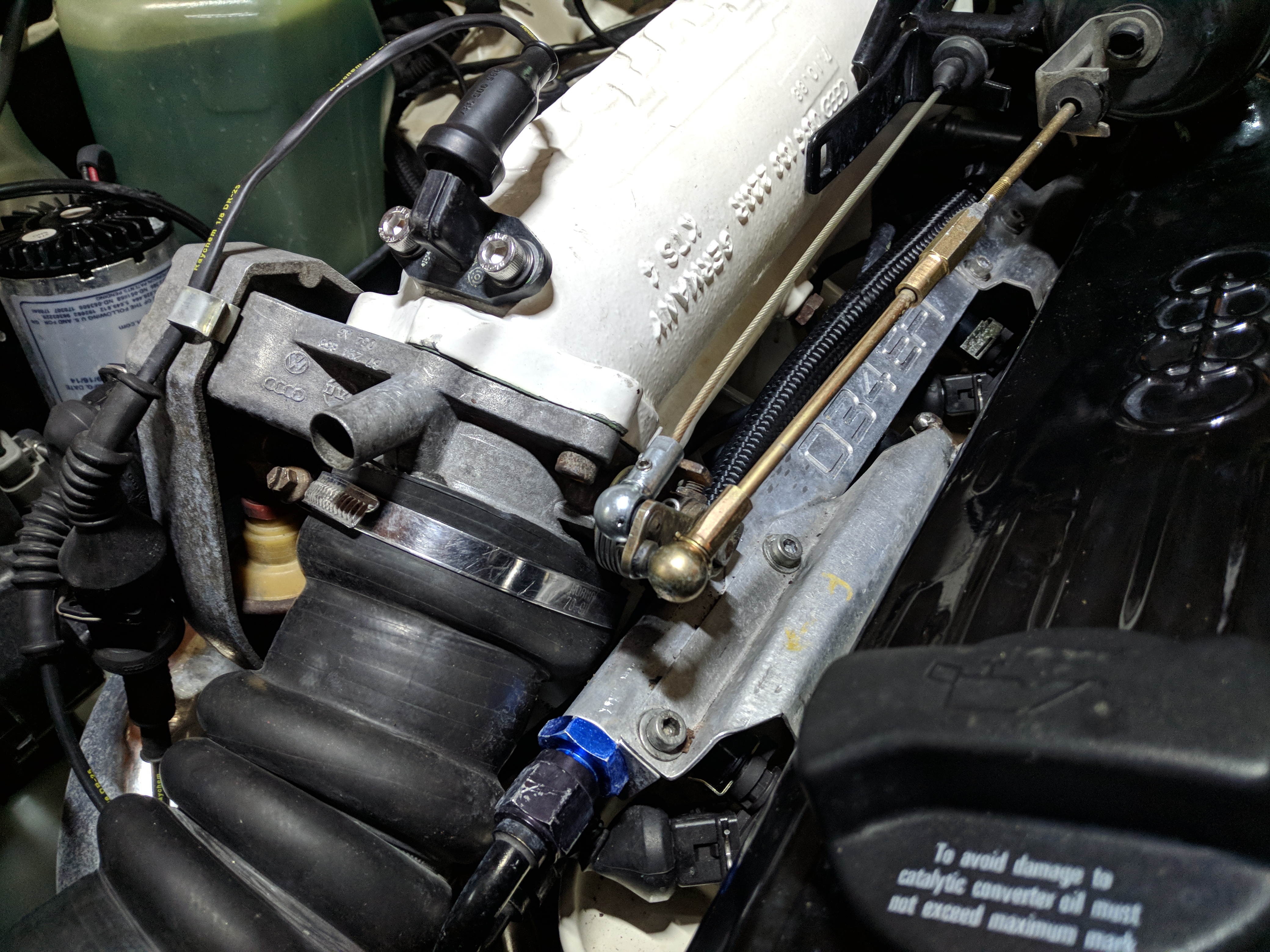

Reworked the wiring harness with DR-25 in the fall of 2017...
Late winter 2017 I fixed the throttle linkage interfere issue with the throttle cam lobe hitting the fuel rail... solution, 20vt fwd throttle cam and a cable end linkage from Australia

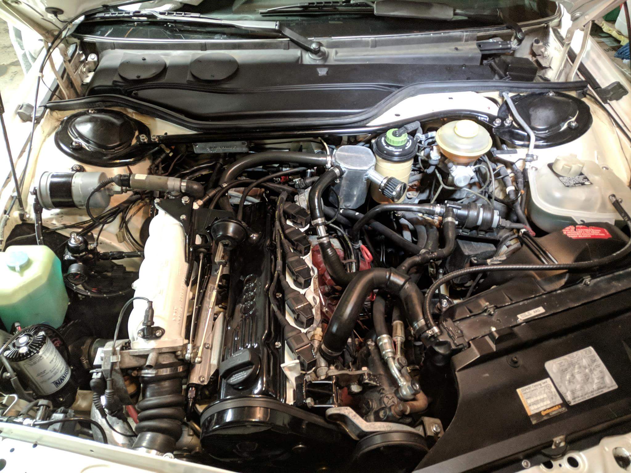

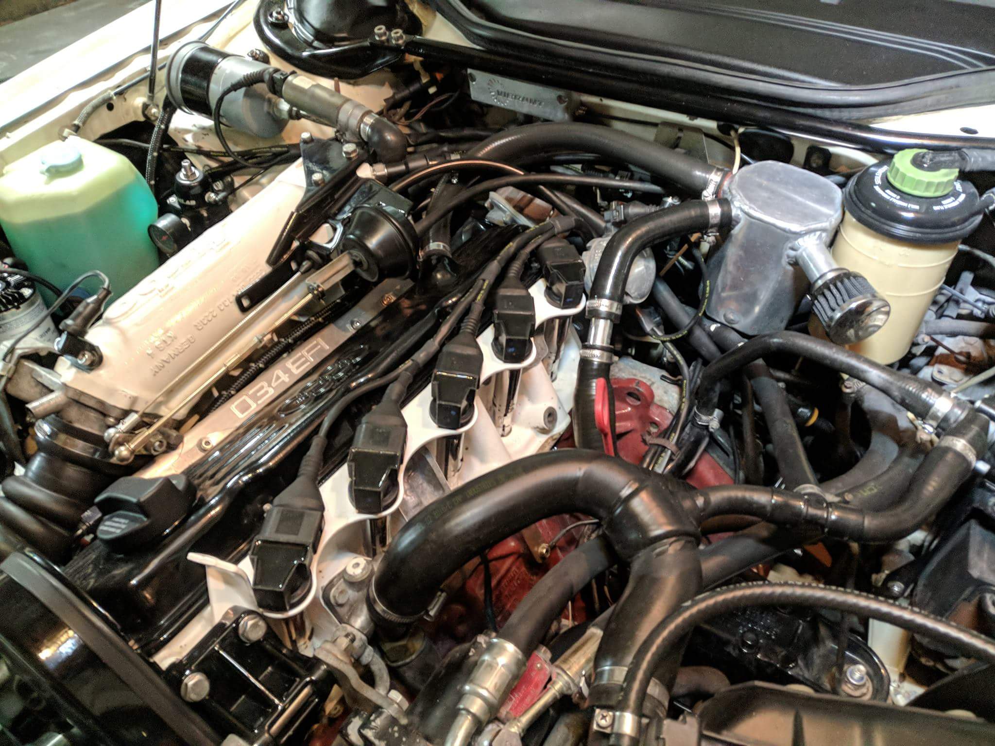

Engine compartment as of June 2018

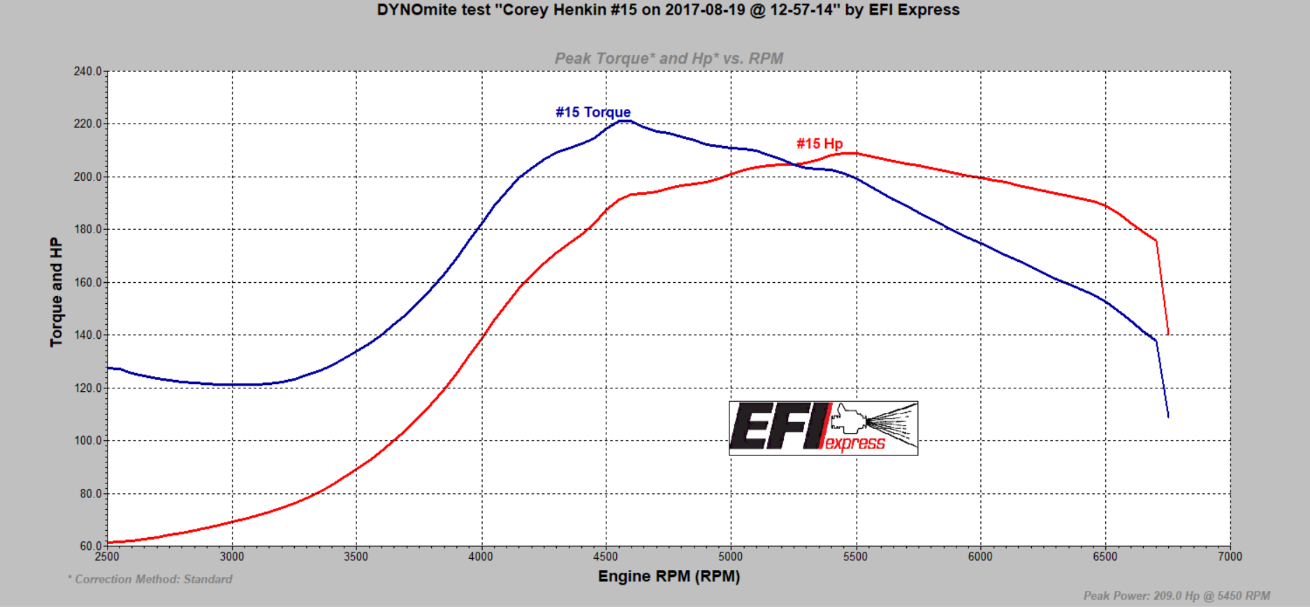

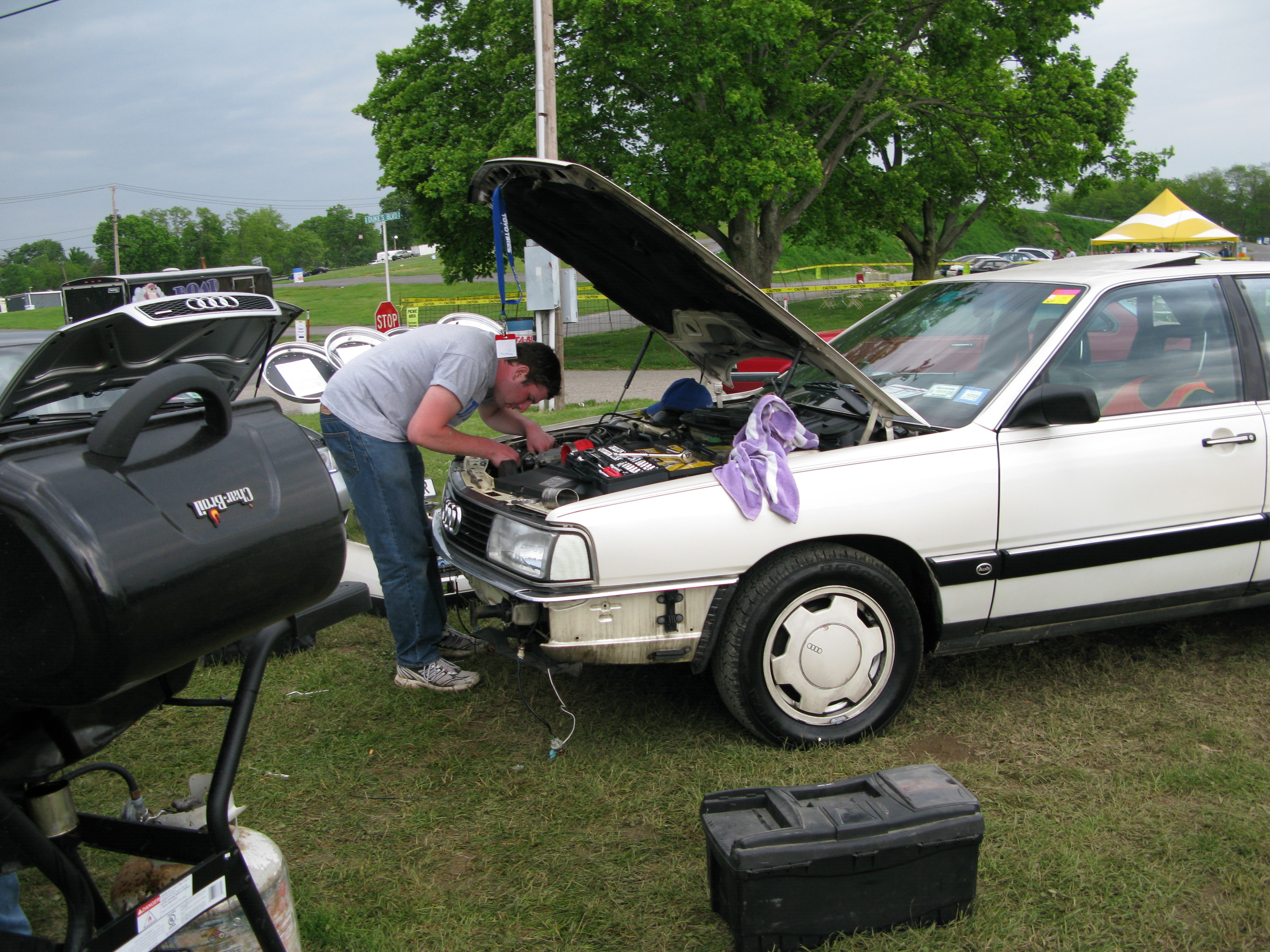

Dyno session 2017 - S-Fest East...
Tuner Marc Swanson - EFI Express...
