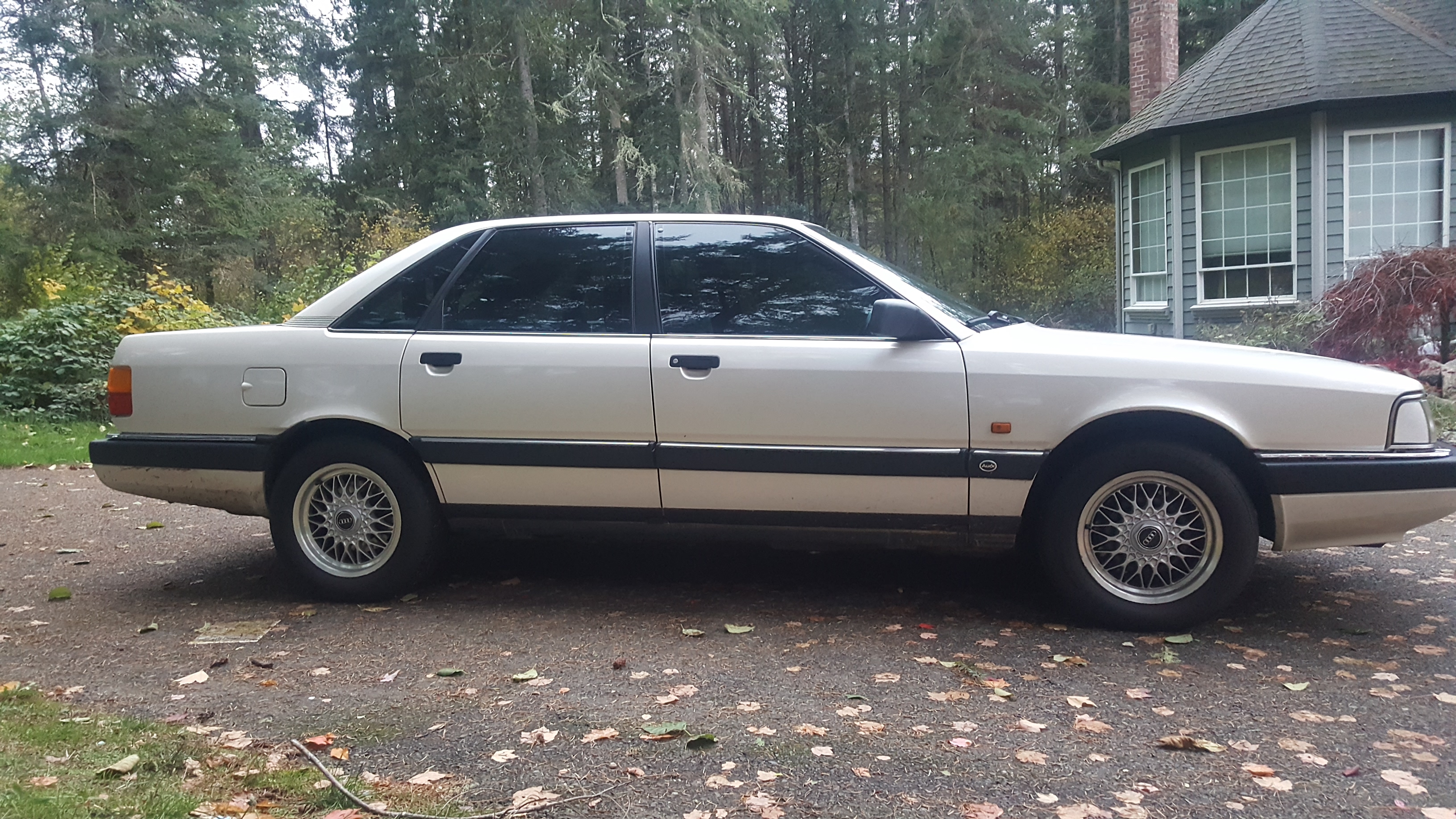

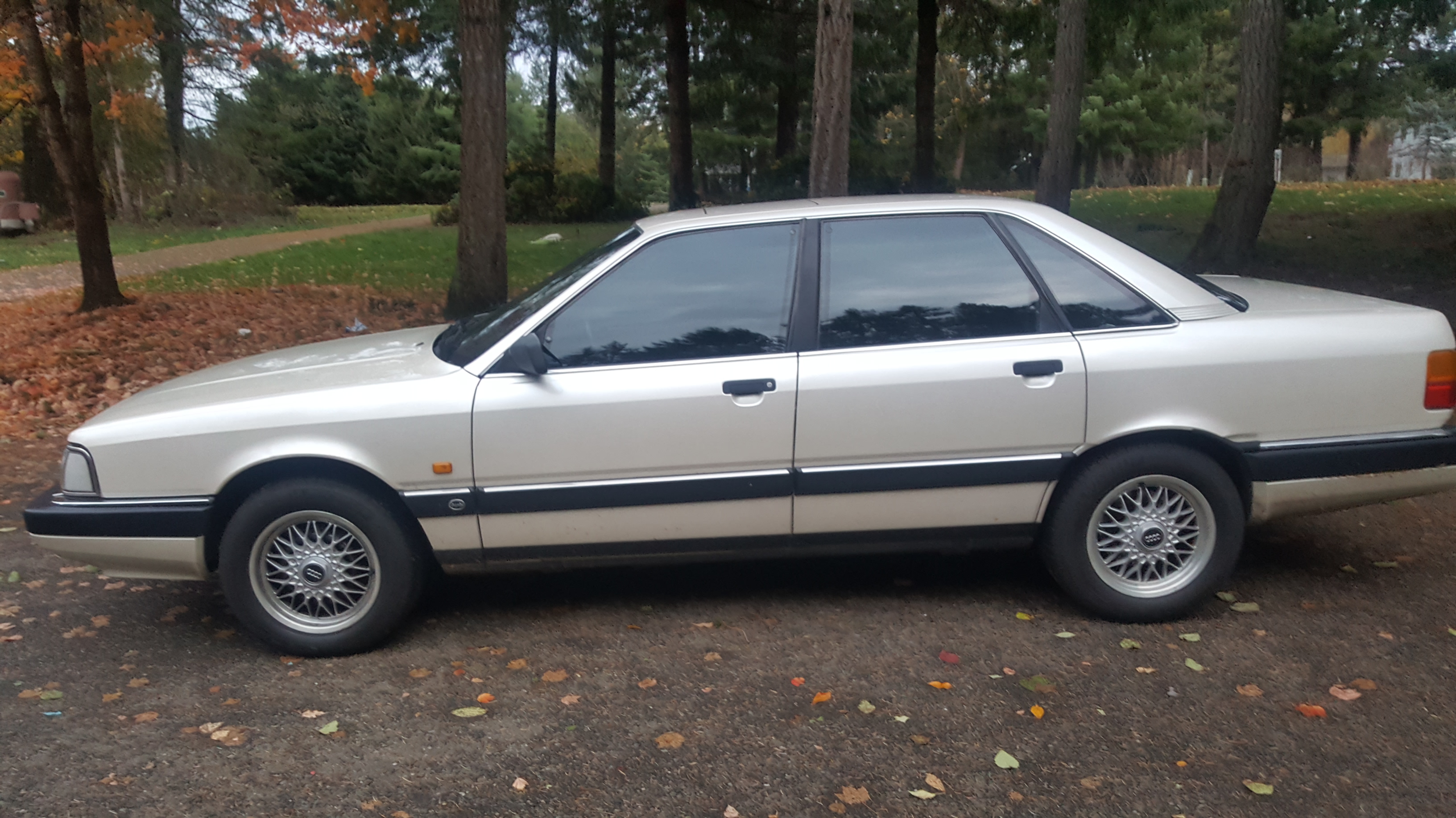

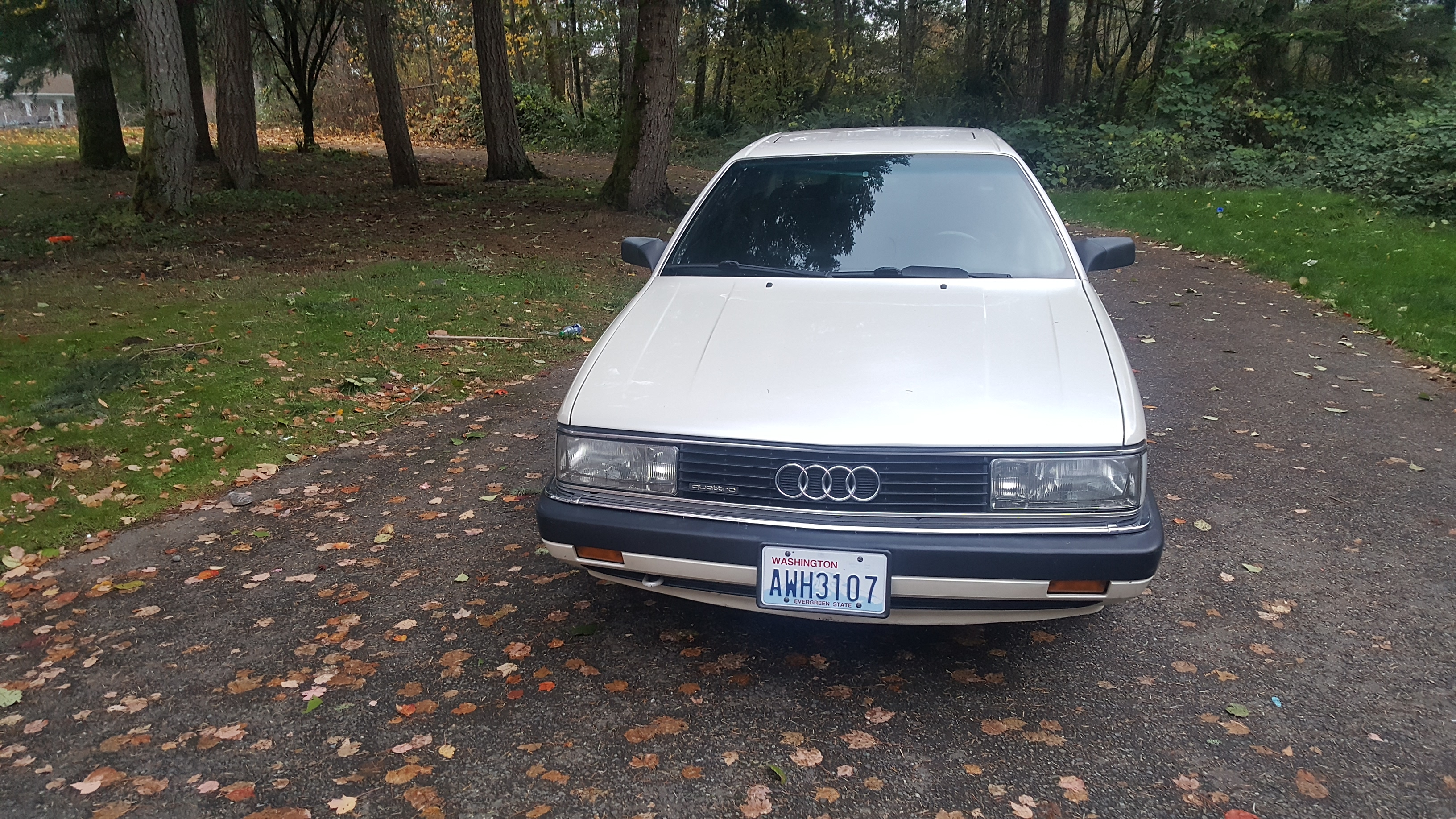

Hello all, I am new here and new to Audi ownership. I just purchased a lovely 200 20v. I have followed these cars for a while and when one popped up more nee me I jumped on it. I know a decent amount about the car but not all-knowing. The car is unmolested with 191xxx miles, Runs like a top, only things that were done are Bilstein shocks all around, and some fixing of know problems done by the previous owner. This being said I had a couple of questions.

Welcome! She's a beaut! Any plans for it?

Good looking car . Don’t even think I saw it go up for sale I usually watch the local Craigslist.
