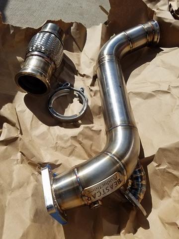

as for the quality:

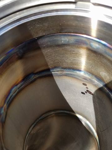

I'm not sticking up for him, but I don't know if I would call that shit work Chris. Maybe it's hard to tell from the pictures, The worst thing I can see is a couple of joints that are not perfectly aligned?

Are you kidding Jim? Or maybe you don't understand what's inherent in a good, strong weld. There is nowhere near enough penetration on those welds. That truly is shit work.
No excuses are necessary here and they should never be made for any product which doesn't state the shortcomings up front or fix the problem right away.

Dead serious. Looks like every aftermarket exhaust out there. It's not the space shuttle. Looks better than my shit with sugar hanging off the inside.

I've never really thought about looking inside other people's stuff soooooo I can't say much. Plus I don't know anything about welding. What do the insides of Hank's look like? I would presume different?

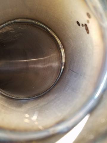

It would be cool if someone who is formally trained to weld would fill us in becAuse now I'm curious. Those welds look really good from the outside, much more consistent than mine, the fit up looks good, piping is clean before welding .
Curiosity got the better of me and I tried one myself , but I don't know what I'm doing .
This is with 1/16" rod and good fit up . No matter how little heat I try and put in I still have some of that heat coming through to the inside . But maybe that's just because it's not back purged?
Re: Anyone ever use DrBeastCar ?
Yeah that looks like sugar to me... back purge will help.
Are you using a 1/16" gap, or a tight fit up?

PRY4SNO wrote:Yeah that looks like sugar to me... back purge will help.
Small gap on that one, probably about 1/16

Flange is not dead centered, welds needs to be trimmed badly, etc
So yeah that was a cheap one, but it won't last 2 years ... or even worse, will leak immediatly / won't past pollution inspection :lol:

Come on now. There are plenty of suppliers who can deliver a product with proper welds. This is so important on manifolds or parts anywhere near the turbo. For a regular exhaust part, maybe not... but if you're paying someone to do something shouldn't you expect something which is done properly?

Afterthought wrote:It would be cool if someone who is formally trained to weld would fill us in becAuse now I'm curious. Those welds look really good from the outside, much more consistent than mine, the fit up looks good, piping is clean before welding .
No need to talk to someone formally trained in welding to tell if those welds are good or not. If the weld does not penetrate all the way through, its not as strong as it could or should be. That's the end of the story, simply from a common sense standpoint. This is why proper welders do V-notches in thicker material and make multiple passes... or... simply turn the power up if you've got enough. If you want to see proper SS tubing welds, just look at some sanitary weld pictures. The weld should be nearly flat on the outside, with full penetration to the inside (note, the second weld in the picture is not exemplary and wasn't meant to be).
