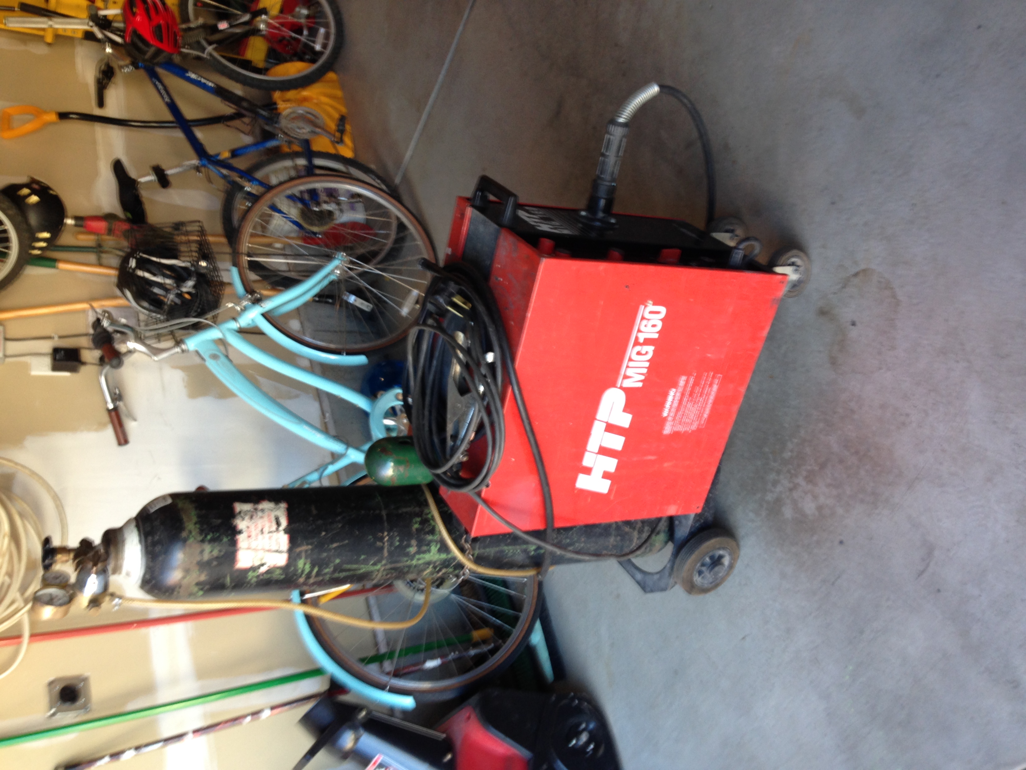

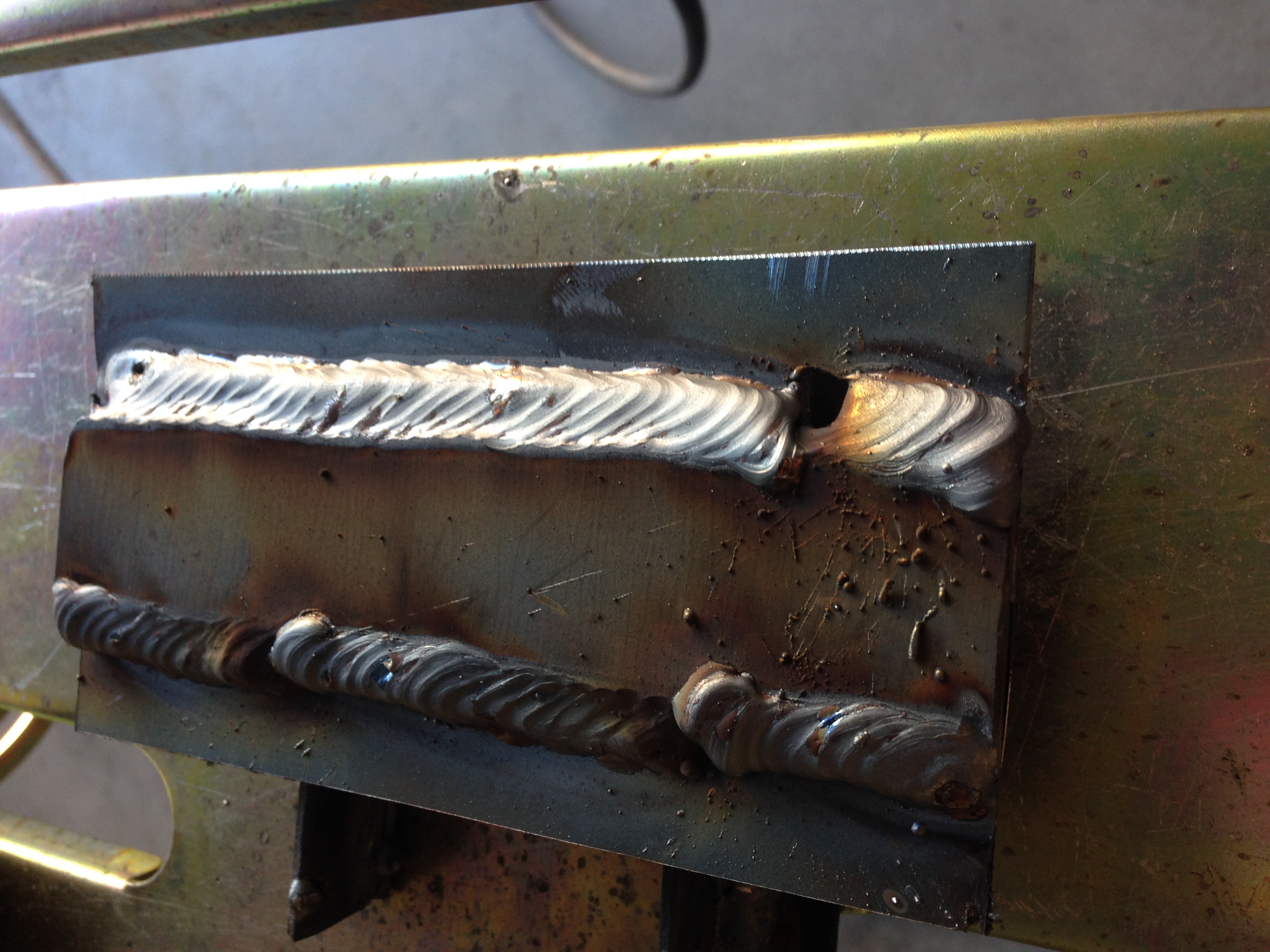

In the last month or 2 I purchased a used mig welder. Installed 220v outlet in the garage, been practicing my welding and accumulating tools for the rollcage build. I went to school for arc welding many moons ago. Looking forward to getting back into it!! Before tearing into it I'ld like to get out to the track one more time. I also got the accelerator pedal poly bushing so it should be good for the rest of its life.
Slow and steady wins the race.
More info and pics: http://theprojectpad.com/viewtopic.php? ... ead#unread
Pics:
Pics:

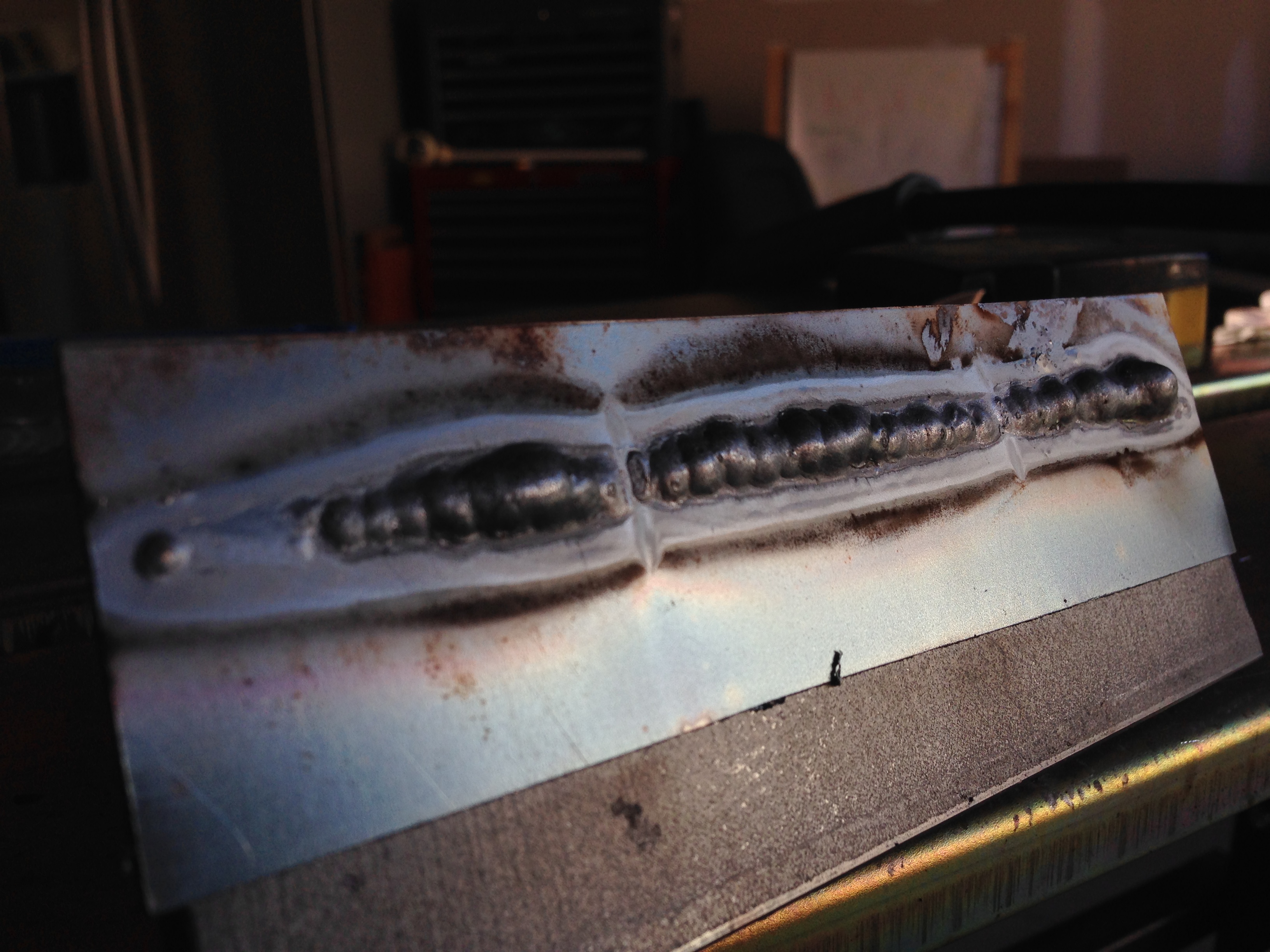

- Thick to thin
- IMG_4161.JPG (1.5 MiB) Viewed 125106 times
- Practicing thick to thin.
- IMG_4159.JPG (1.78 MiB) Viewed 125106 times
- Renting a cylinder of argon/co2
- IMG_4168.JPG (2.18 MiB) Viewed 125106 times
- Started with flux core
- IMG_4167.JPG (1.21 MiB) Viewed 125106 times
- IMG_4166.JPG (1.72 MiB) Viewed 125106 times

Burned through on some other pieces but getting it dialed in!
- Back side thick to thin
- IMG_4162.JPG (1.69 MiB) Viewed 125105 times

I read your thread on the other page!! Man that hurts my eyes (the page not your car), so please migrate this to the "Darkside" so I can save myself the anguish. I thought I was building a underdog for a car but yours has to frustrating to get parts for.
As far as welding goes looking at your ripple patterns, seems to me that you are whipping and not carrying the arc in a smooth manner. Since you stated that you stick welded many moons ago and you are teaching yourself a new process I can see you falling in that trap. Try just establishing the arc and than carry it in a smooth fashion Push Drag or go Parallel, depends on you preference and settings on your welding machine. Distance to work piece makes a huge diff. and should be held at the same distance for the length of the weld. Also when doing any type of innershield wire (flux core) reverse the polarity and that stuff lays down like its going to sleep. Your welds look good for someone who has not done this before. I have seen ALOT worse from people that are "certified".....

In my experience if you don't favor the thicker material you will burn through the thinner material. I'm practicing for the welding of roll cage base plates.
When I was flux core welding I didn't read up on the correct procedure and I had splatter all over the place!!! Switched ground and gun leads so my work piece was hot and the splatter calmed down a little.

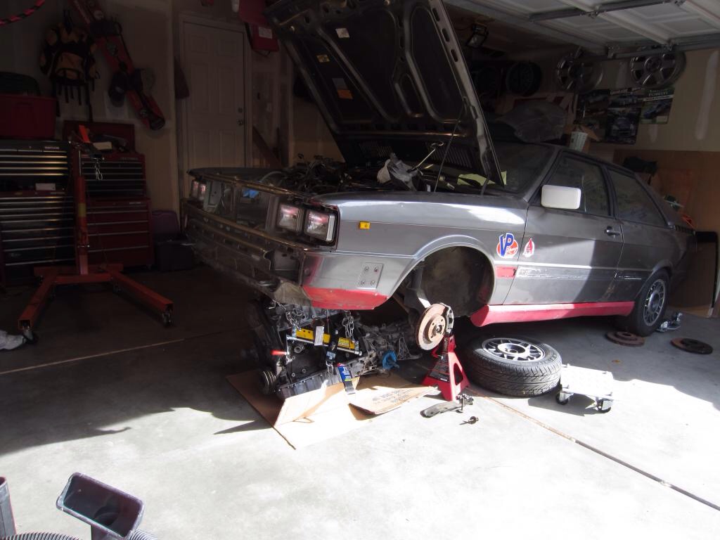

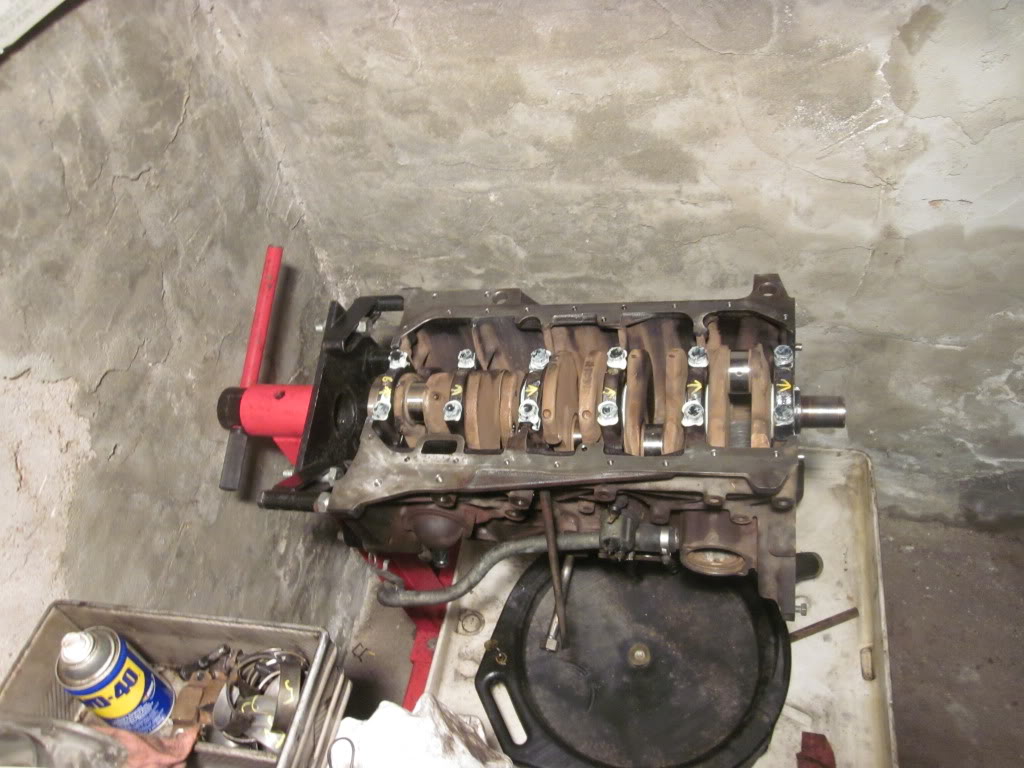

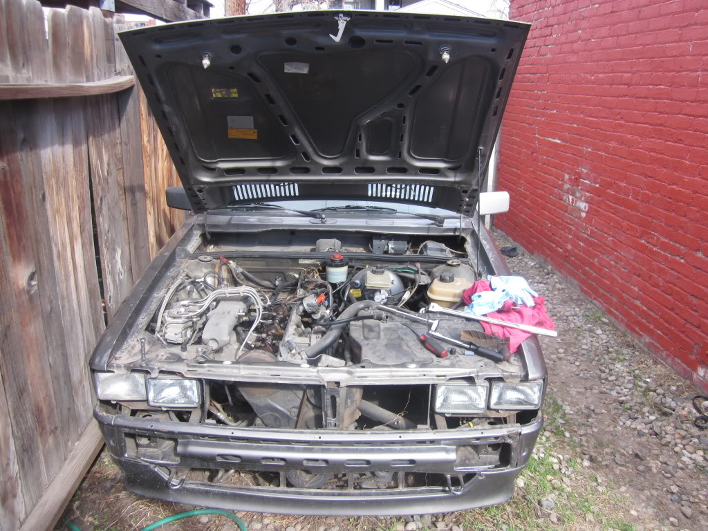

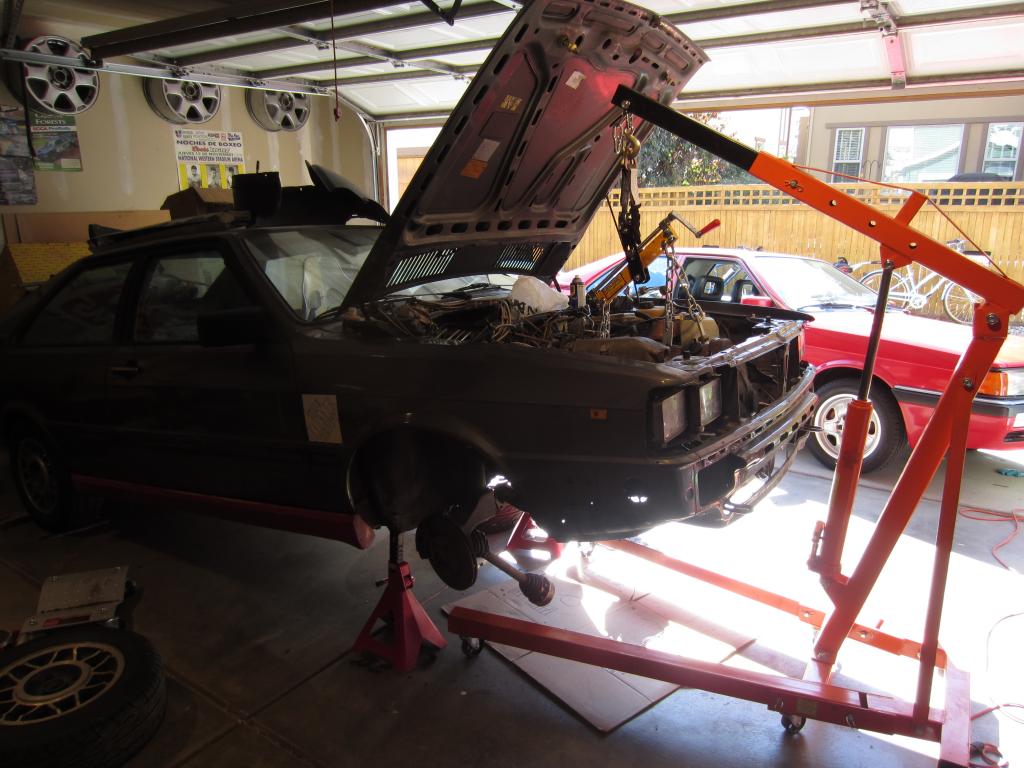

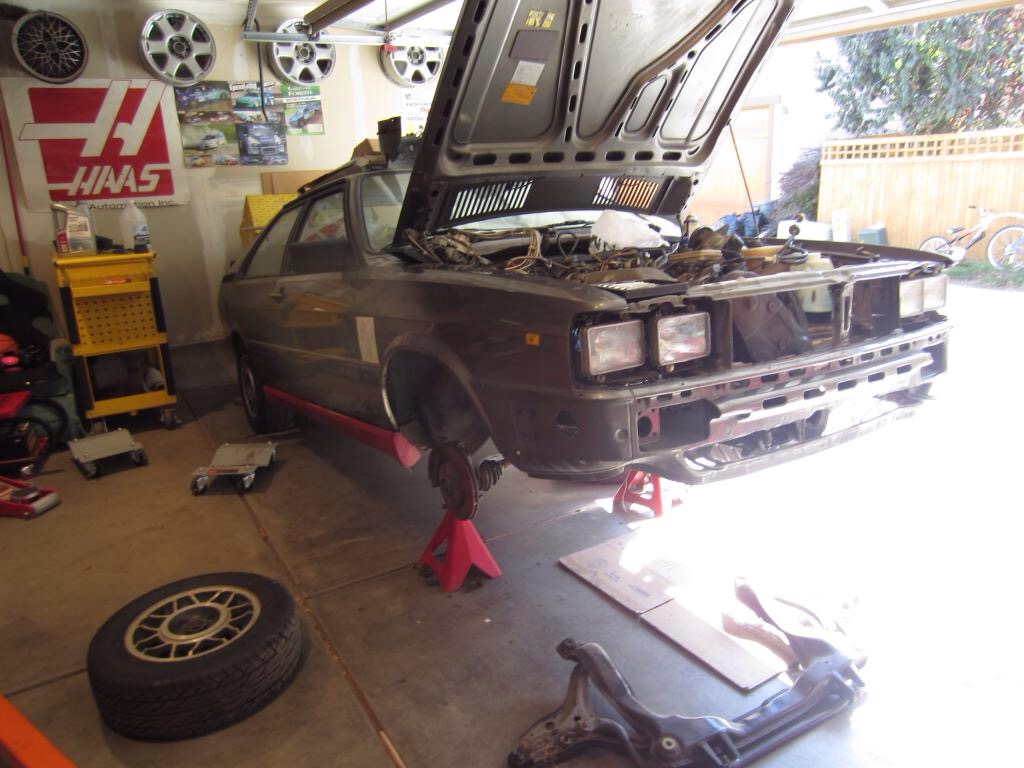

Re: '84 Audi Coupe Gt grp 2

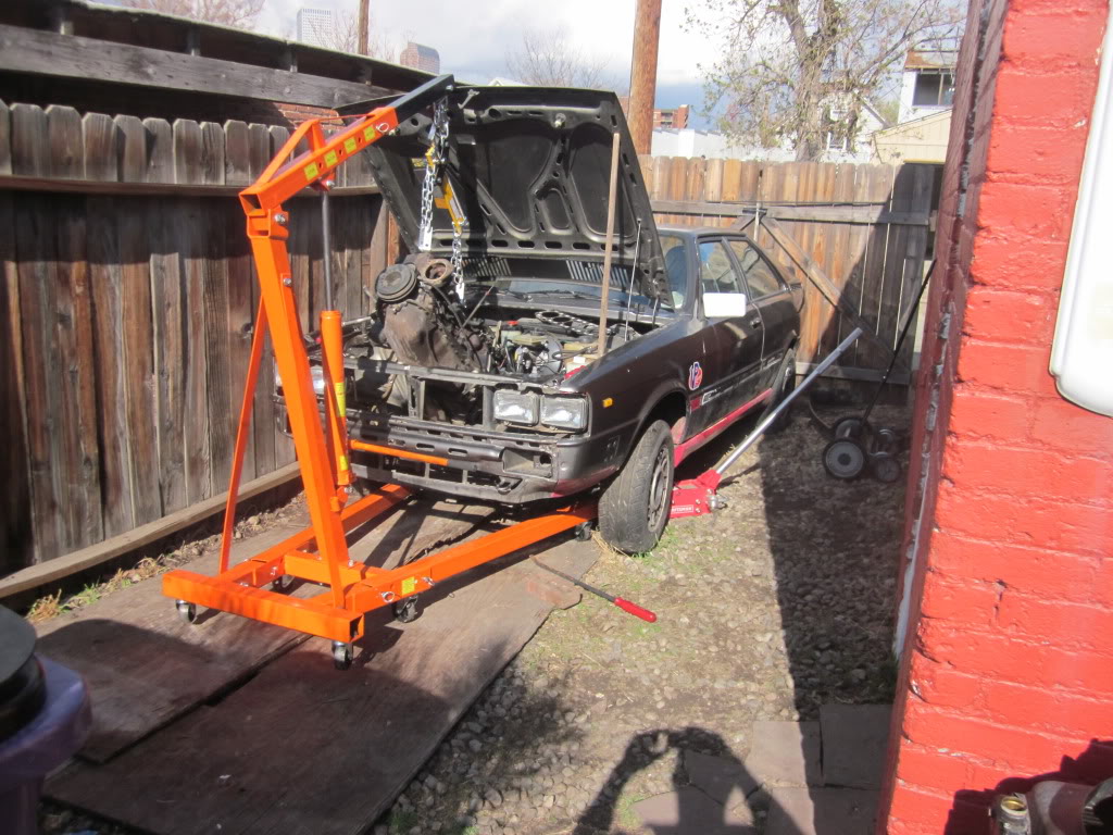

Tear down begins.
- IMG_4864.JPG (206.45 KiB) Viewed 123444 times
- IMG_4858.JPG (185.34 KiB) Viewed 123444 times
- IMG_4853.JPG (199.17 KiB) Viewed 123444 times
- IMG_4852.JPG (146.92 KiB) Viewed 123444 times

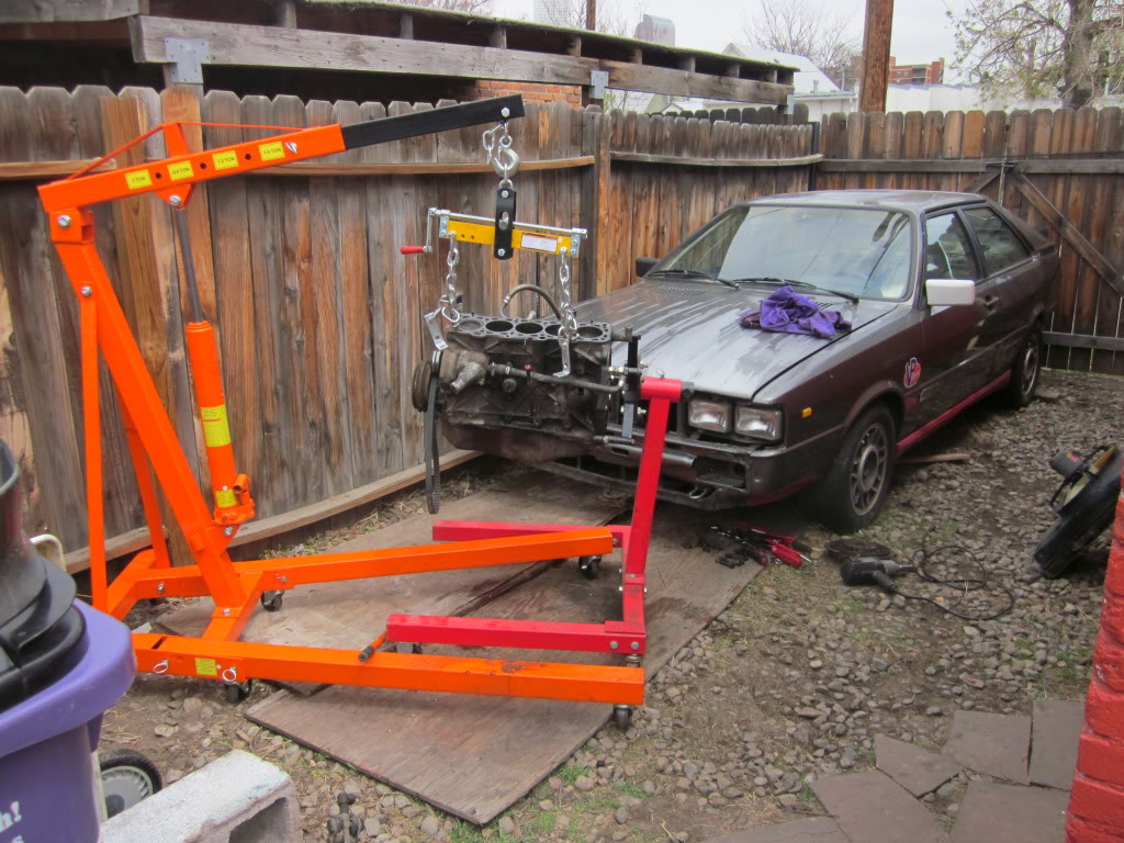

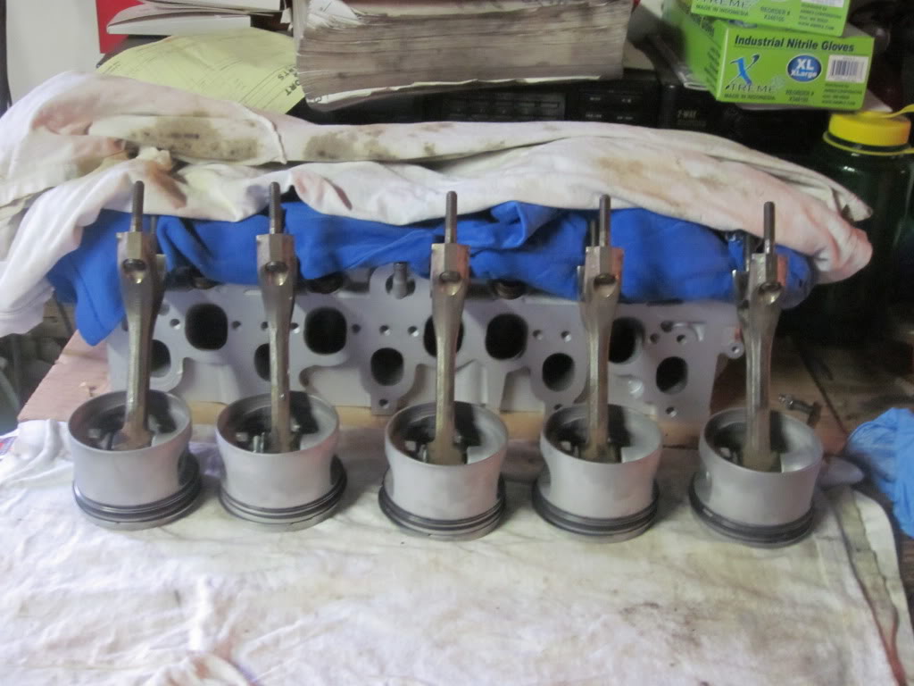

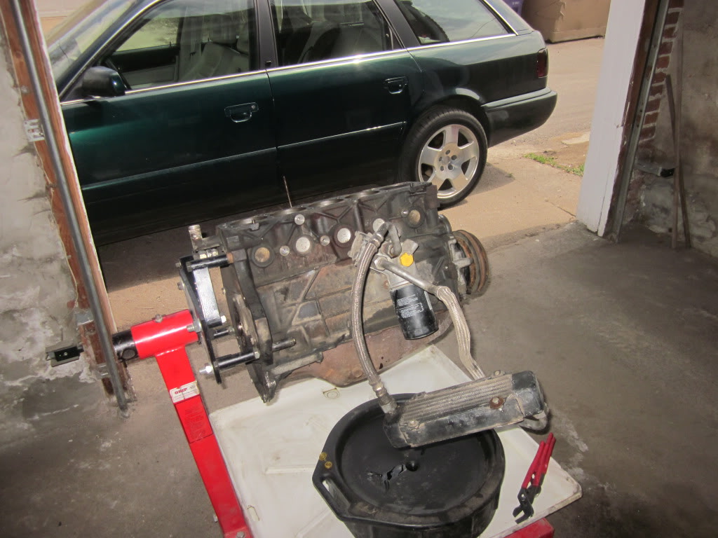

Engine assembly
- IMG_4850.JPG (132.36 KiB) Viewed 123441 times
- IMG_4851.JPG (107 KiB) Viewed 123441 times

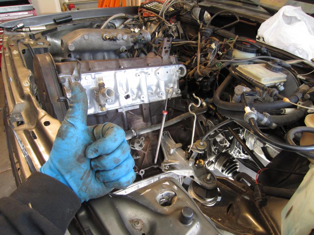

Head bolted on.
- IMG_4917.JPG (169.17 KiB) Viewed 123440 times

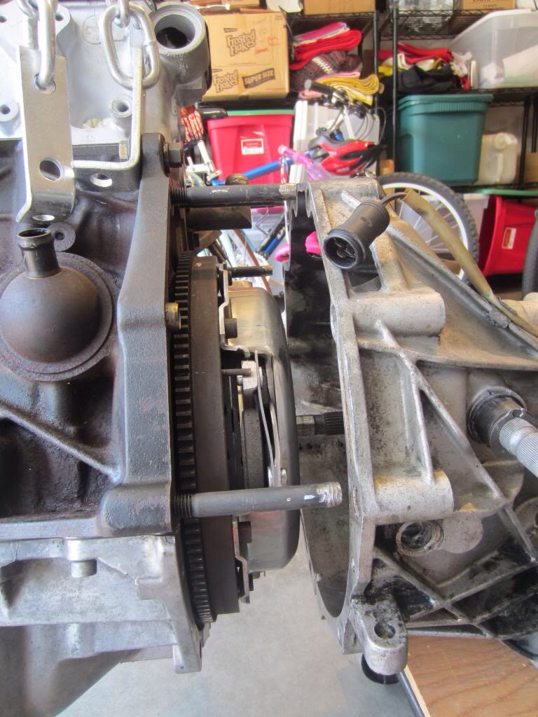

Tranny to block.
- IMG_4918.JPG (164.72 KiB) Viewed 123439 times
- IMG_4920.JPG (192.74 KiB) Viewed 123439 times
- IMG_4919.JPG (173.41 KiB) Viewed 123439 times

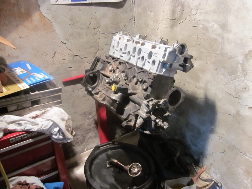

Engine going back in.
- IMG_4923.JPG (199.57 KiB) Viewed 123456 times
- IMG_4922.JPG (159.4 KiB) Viewed 123456 times
- IMG_4921.JPG (132.82 KiB) Viewed 123456 times
- IMG_4841.JPG (120.69 KiB) Viewed 123456 times

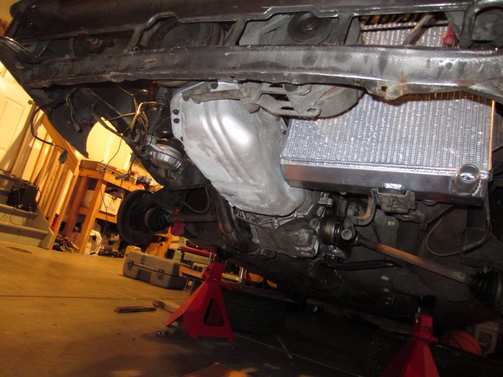

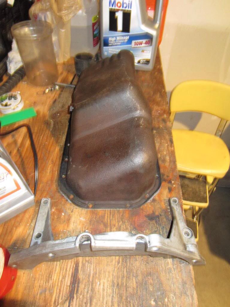

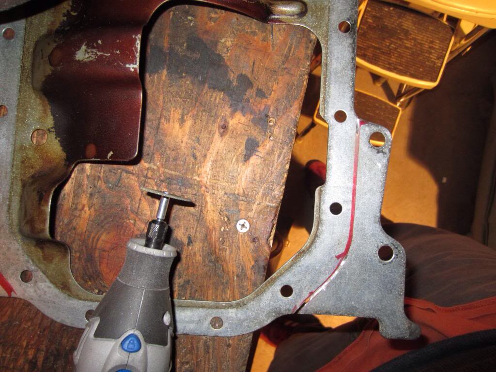

Oil pan sorted.
- IMG_4925.JPG (158.3 KiB) Viewed 123455 times
- IMG_4926.JPG (200.03 KiB) Viewed 123455 times
- IMG_4924.JPG (175.26 KiB) Viewed 123455 times

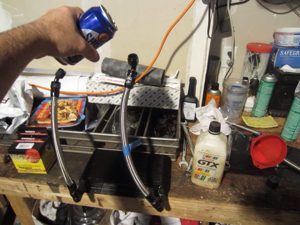

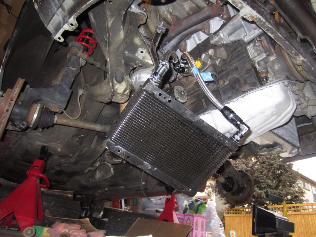

Oil cooler was hungry and thirsty!
- IMG_4928.JPG (176.3 KiB) Viewed 123454 times
- IMG_4929.JPG (176.39 KiB) Viewed 123454 times
- IMG_4930.JPG (204.19 KiB) Viewed 123454 times
- IMG_4931.JPG (189.46 KiB) Viewed 123454 times
- IMG_4932.JPG (149.02 KiB) Viewed 123454 times

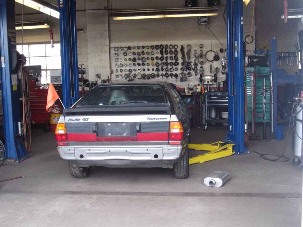

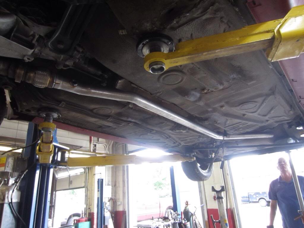

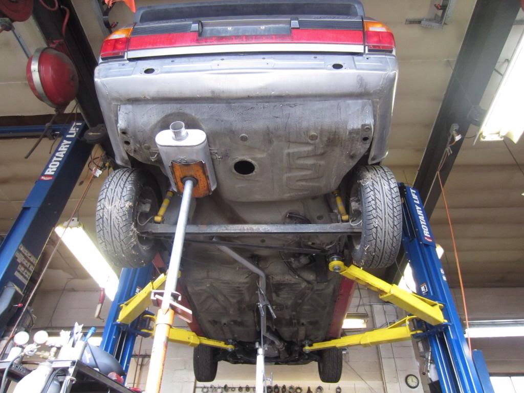

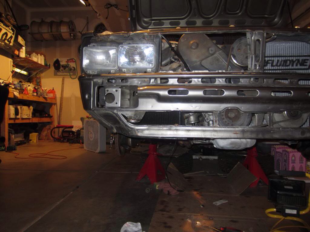

At the exhaust shop.
- IMG_4933.JPG (165.48 KiB) Viewed 123453 times
- IMG_4934.JPG (142.77 KiB) Viewed 123453 times
- IMG_4935.JPG (177.36 KiB) Viewed 123453 times
- IMG_4936.JPG (179.99 KiB) Viewed 123453 times
