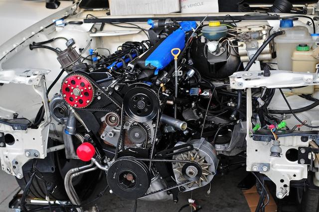

Once you weld in the engine mounts (or make custom mounts for I5 to B4) you have all the same restrictions as a B3 since the engine bay is basically the same. Only reason B4 had front mount rads were because they came with I4 or V6, all I5 B4's had the side mount like a B2/3.
Wiring would be pretty much the same as a B3 also, they use the same fusebox.
I'm really surprised nobody has made engine mounts for an I5 into a B4...I bet it's not hard, they aren't that far off from each other.

Actually...looking at it now are they even in a different location? Has anyone tried to bolt an I5 into a B4 and seen how far off the mounts are? Doesn't look like much. I should've checked when I had the engine out.

I may have heard speculation that 1 works but not the other. I have both but measuring x/y/z with the engines in the way is difficult.

I still think I want to do a 5 cylinder swap. Once I get past the mounts I'm basically doing the same swap I'd be doing in a coupe. just need to source a few things.
looking at those pics, the passenger's side looks like it's in the same place exactly. anybody have a B3 or B4 sitting empty to measure?
I made the ABH B3 mounts, no reason I couldn't make the B4 to I5 I'd think...

I don't see specifics but Tecknoquatt used the B4 mounts with fabricated consoles.
Tecknoquatt's photo
Tecknoquatt's photo
