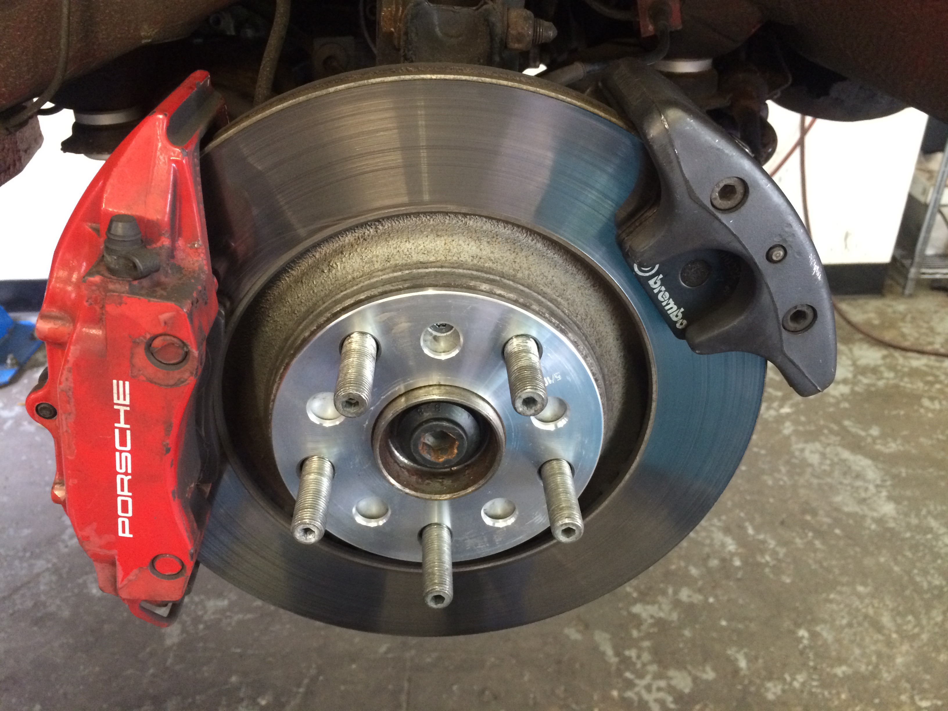

It is nice to have a working handbrake on my Coupe again. Brake upgrades are complete on my eS2 project. At least until I need new rotors ;)

Nice, Chris. I have the same setup I got from John B. I just have not gotten around to doing an install. I may be emailing you down the road for some advice about the e-brake cable install.
Did you take off your hubs to drill and tap the splash shield bolts to hold the adapter? Is that the B6 S4 rotor, 300X22?

Hubs will have to be removed to drill & tap the bracket mounting holes. Yes that is the old tried & true 300X22mm rotor. I used Apikol brackets to mount the Porsche calipers.

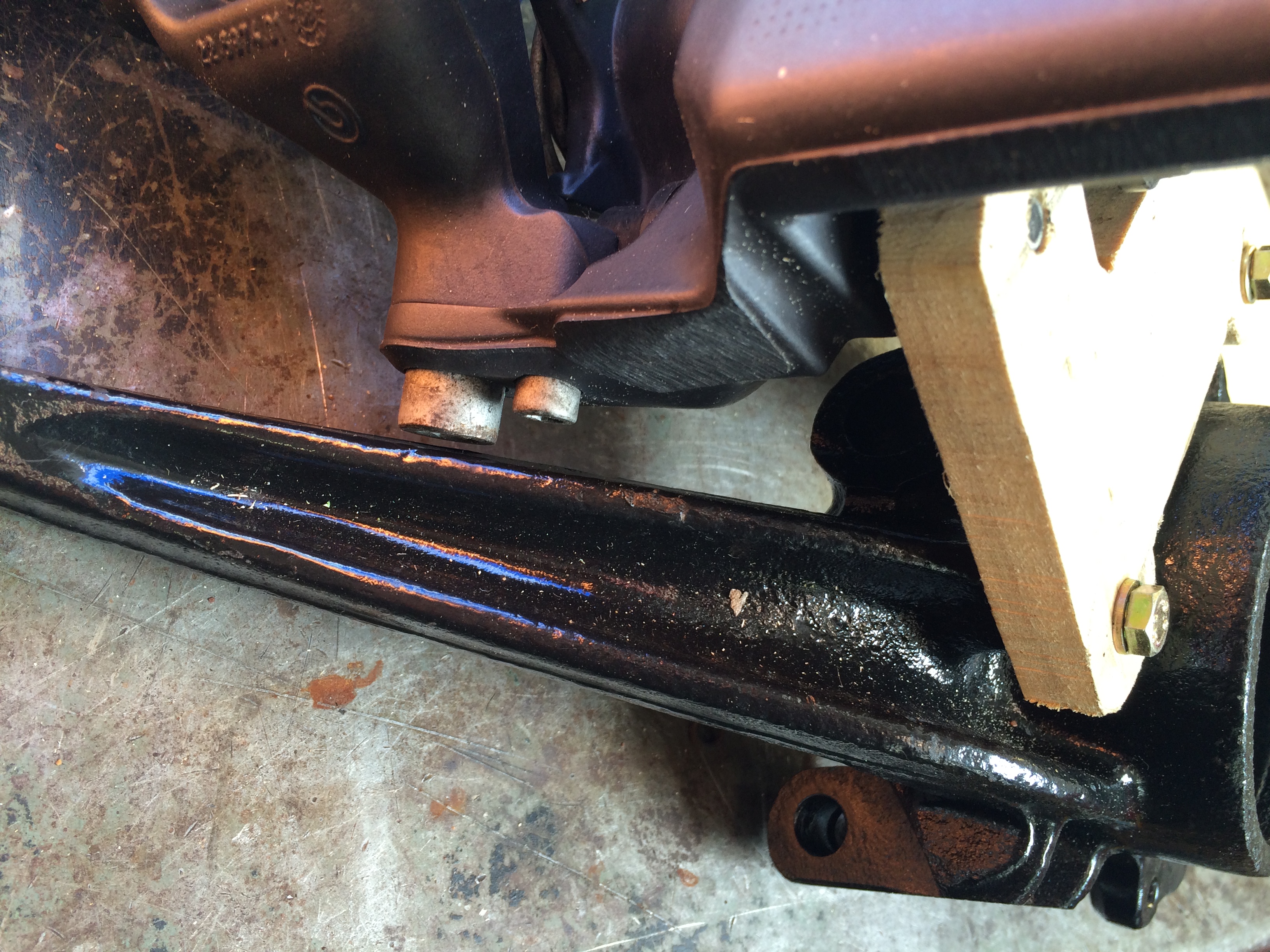

First off, credit where credit is due. I began this upgrade by thoroughly reading this thread on the
S2 Forum.
http://www.s2forum.com/forum/showthread.php?t=62766
This gives a how to & parts list that I replicated.
Secondly, I do not want to make another set of these brackets. It took me way too much time with the tools I had to work with.
I have S2 hubs front & rear installed when I did the 5-bolt hub swap. The A4 hubs commonly used on the rear "should" work without any issue.
Found the Viper handbrake calipers from a salvage yard listing on e-bay & sourced new e-brake cables thru Amazon that came from Shokan. Acceptable pricing for the Viper calipers, the cost of the calipers was still as much as I paid for the Boxster S brake calipers. Hardware, calipers, cables, steel plate for the brackets amounted to under $700. The heart wants what the heart wants.
I tried to source the brackets from Bambridge but I ended up making my own.

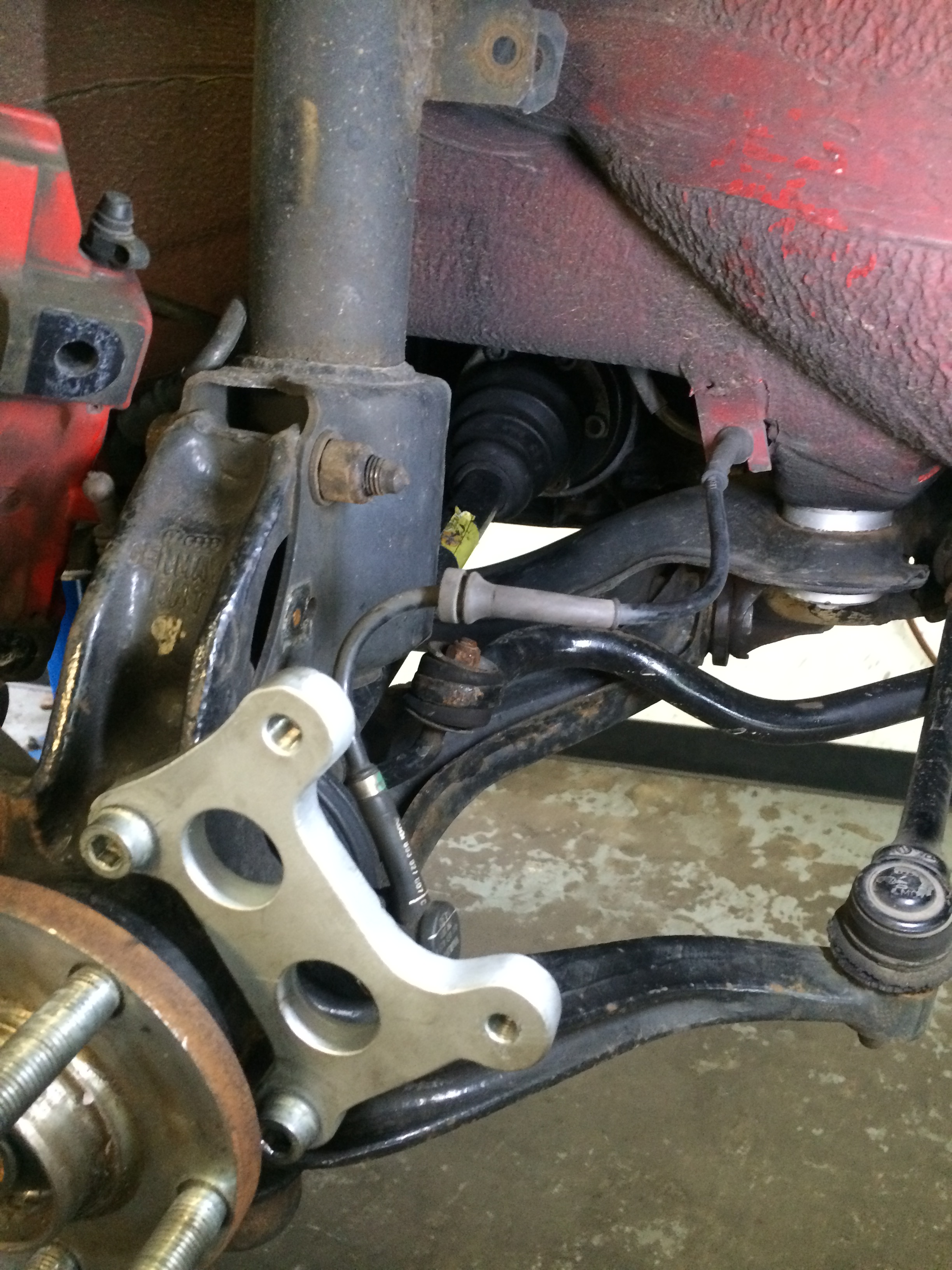

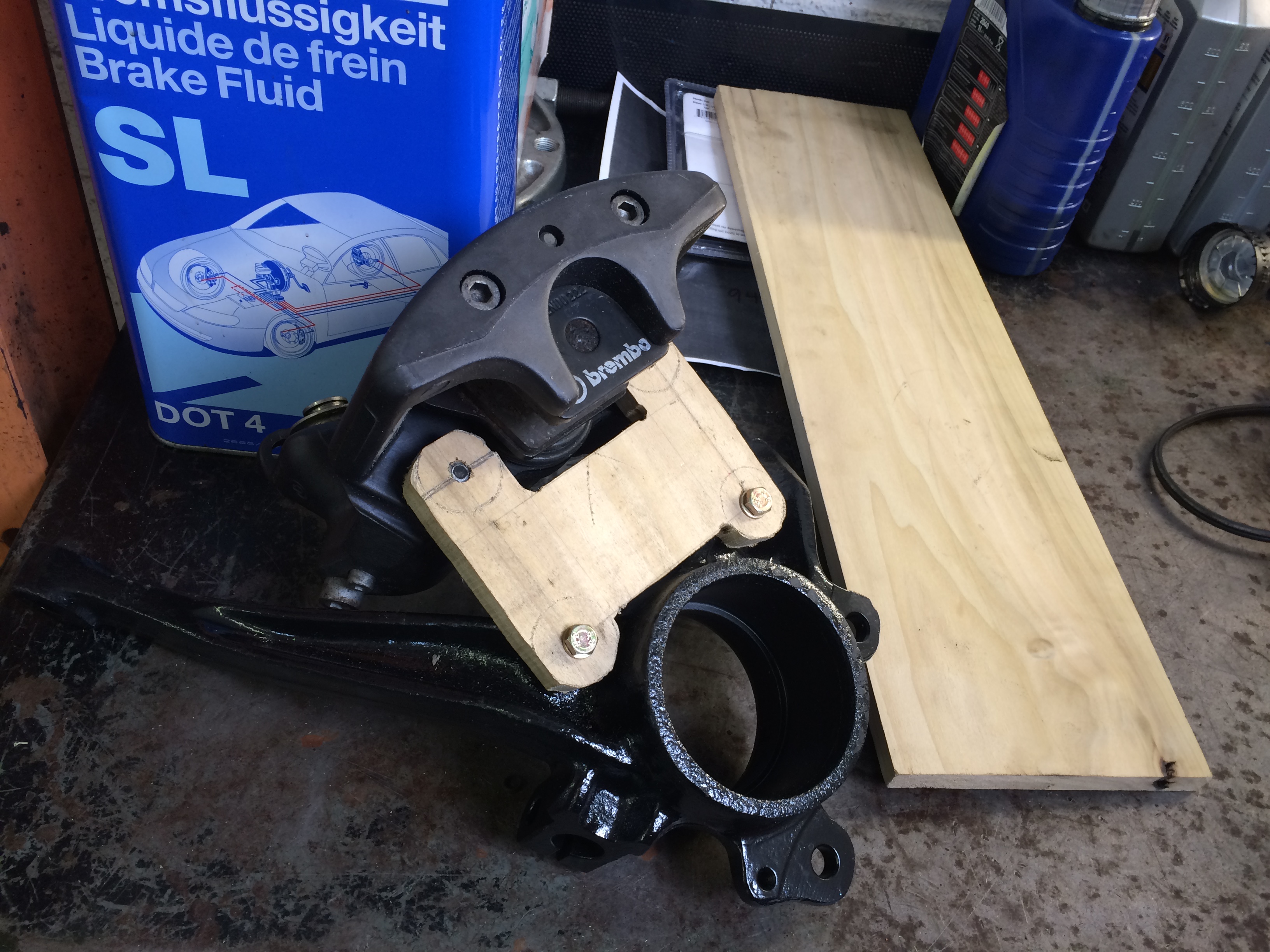

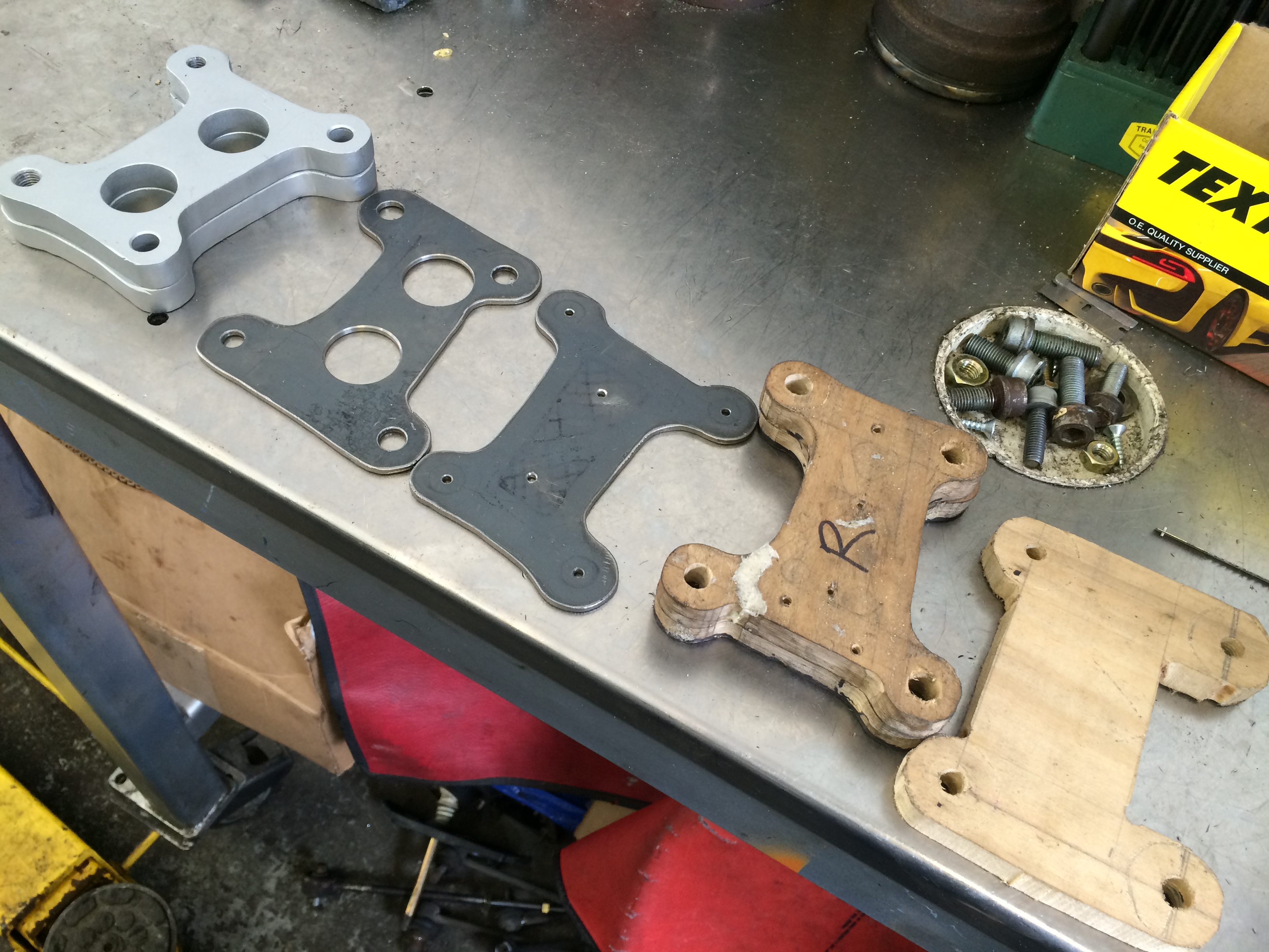

Started with a piece of Poplar wood to make my initial design. Easy to work with & cheap enough to try different designs. Moved to 1/8" steel plate for a pattern & then on to 1/2" plate for the final bracket. Maybe 3/8" would have been enough but I wanted to have at least 6 full threads on the 10X1.25mm bolts that held the calipers to the brackets & the thread depth should be at least the diameter of the fastener.
I torched the rough design out of 1/2" plate steel as I do not have a plasma cutter. I used a Harbor Freight bench top drill press for my "machining" work & an electric grinder for my finishing operations.
My first attempt placed the caliper too close to the hub carrier arm.
My first attempt.
My first attempt.
August 9 107.JPG (2.49 MiB) Viewed 47096 times
Evolution
Evolution
August 9 206.JPG (1.68 MiB) Viewed 47096 times

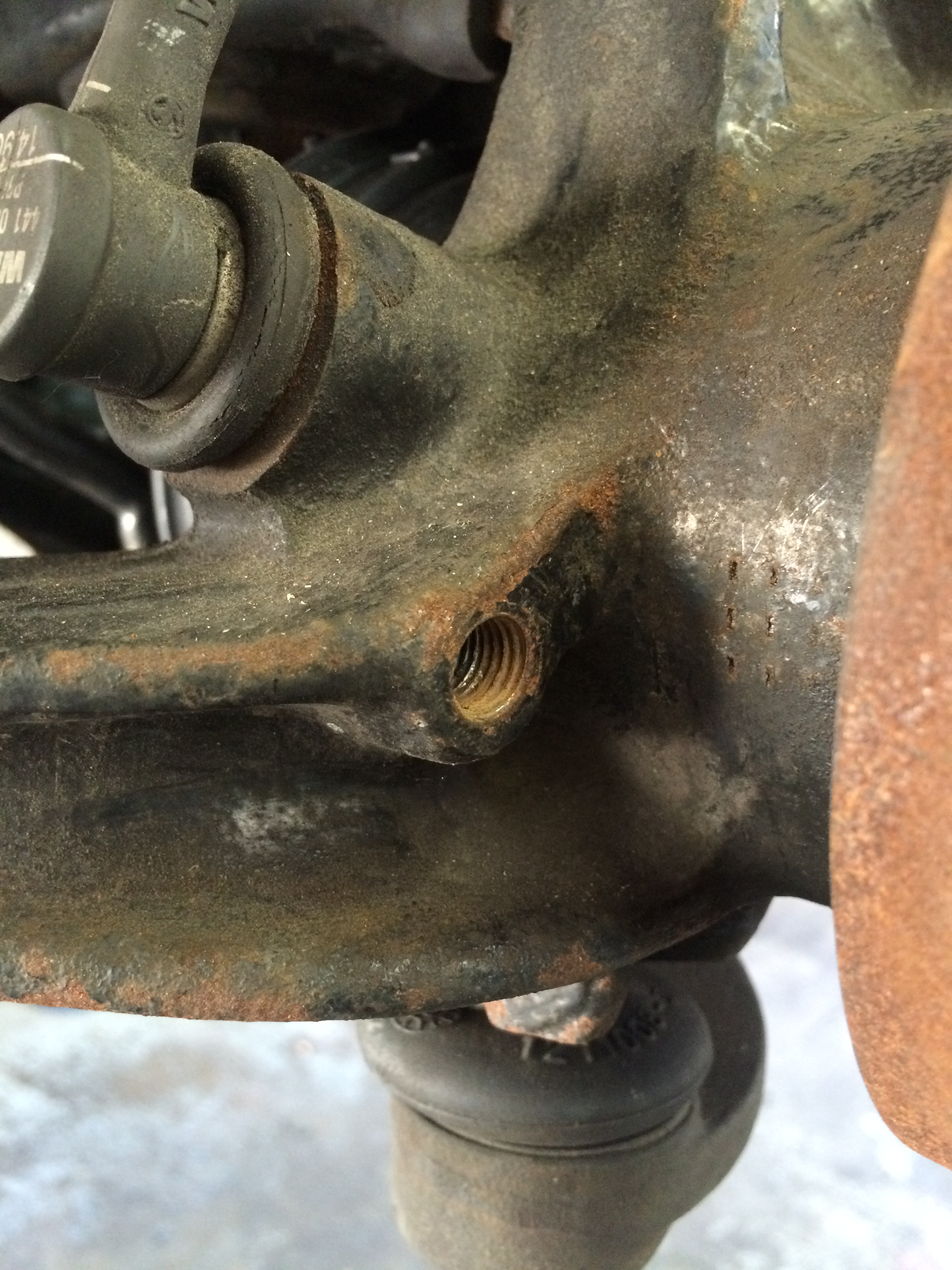

Mounting hole drilled & tapped
August 9 131.JPG (1.35 MiB) Viewed 47096 times
Lower mounting hole drilled & tapped.
August 9 132.JPG (1.34 MiB) Viewed 47096 times

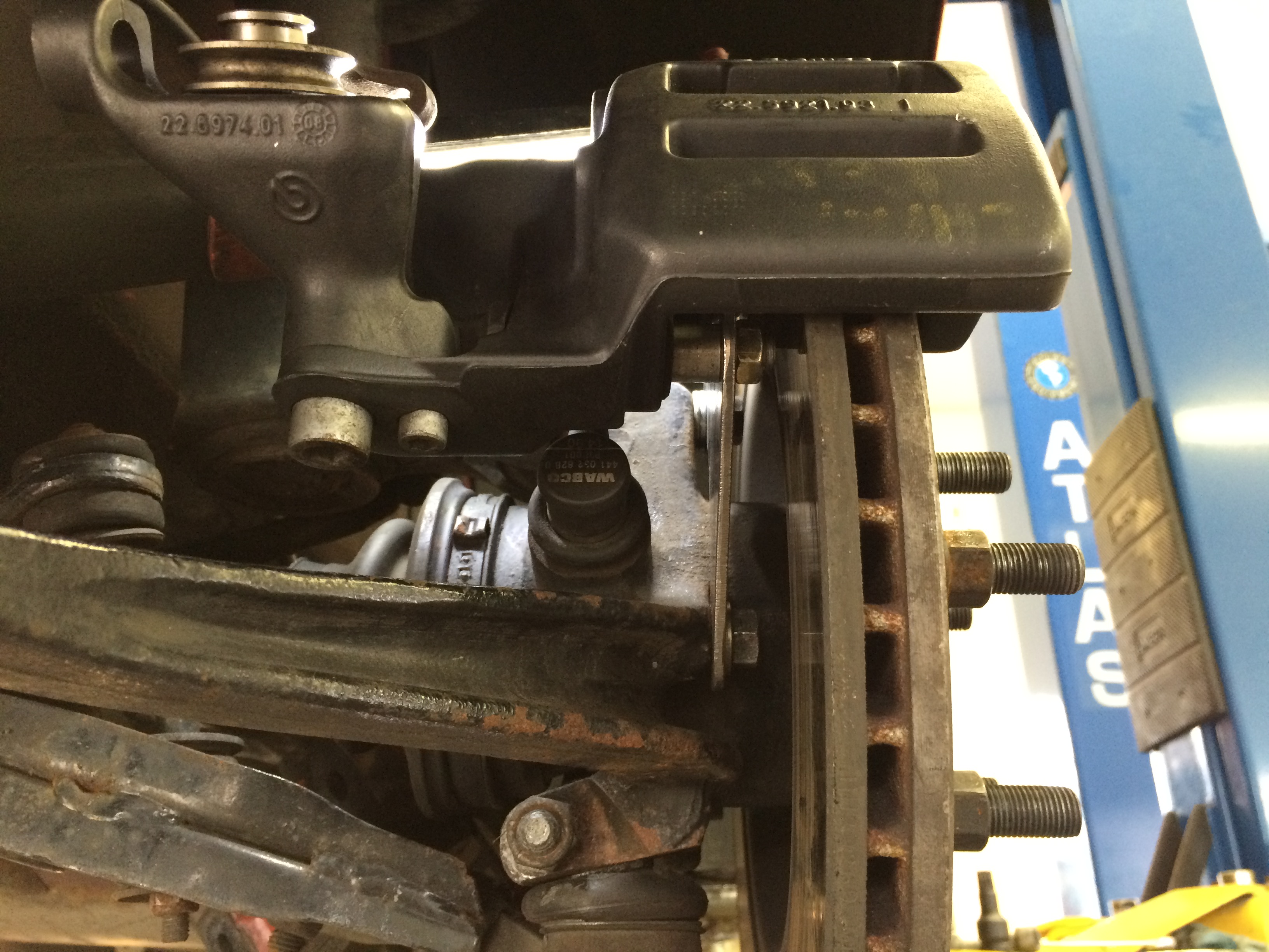

Metal mock up bracket
August 9 144.JPG (1.25 MiB) Viewed 47095 times
Showing pad contact rotor concentrically  & not overhanging rotor.
August 9 213.JPG (2.13 MiB) Viewed 47095 times
Mounted to hub carrier
August 9 212.JPG (1.29 MiB) Viewed 47095 times
Spacers installed to keep bracket in the same plane as the rotor. Only needed on upper mounting point.
August 9 216.JPG (1.45 MiB) Viewed 47095 times

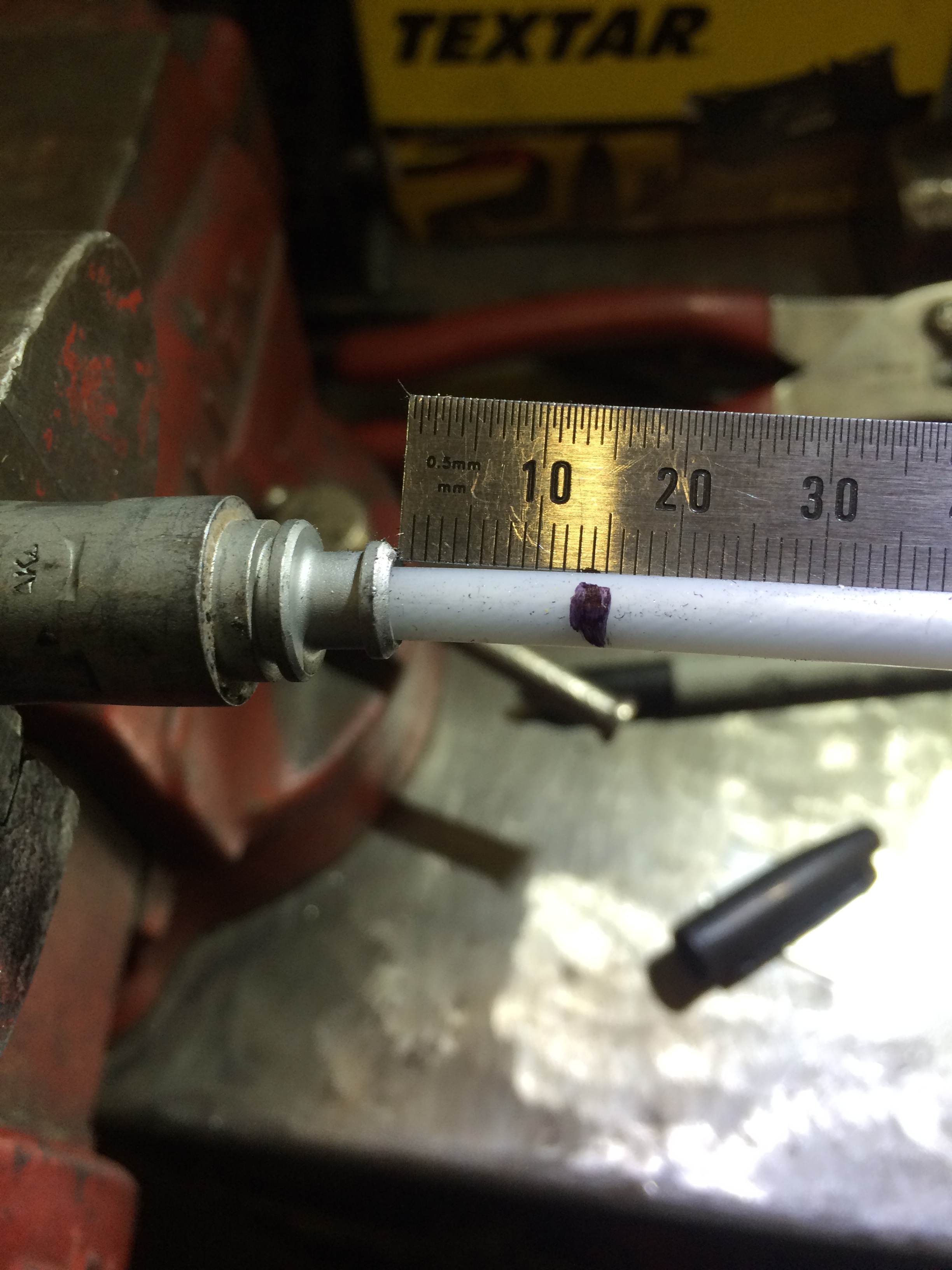

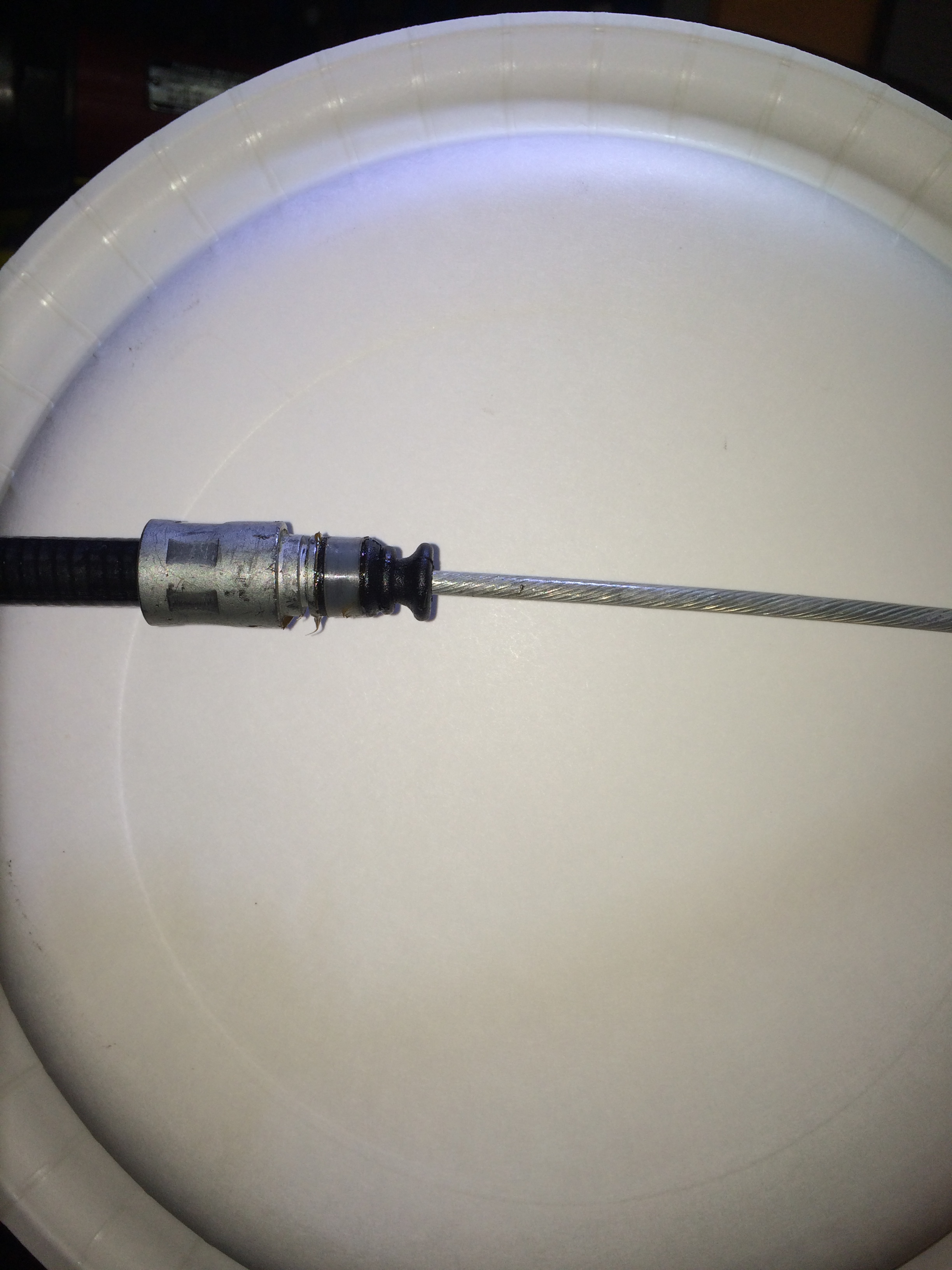

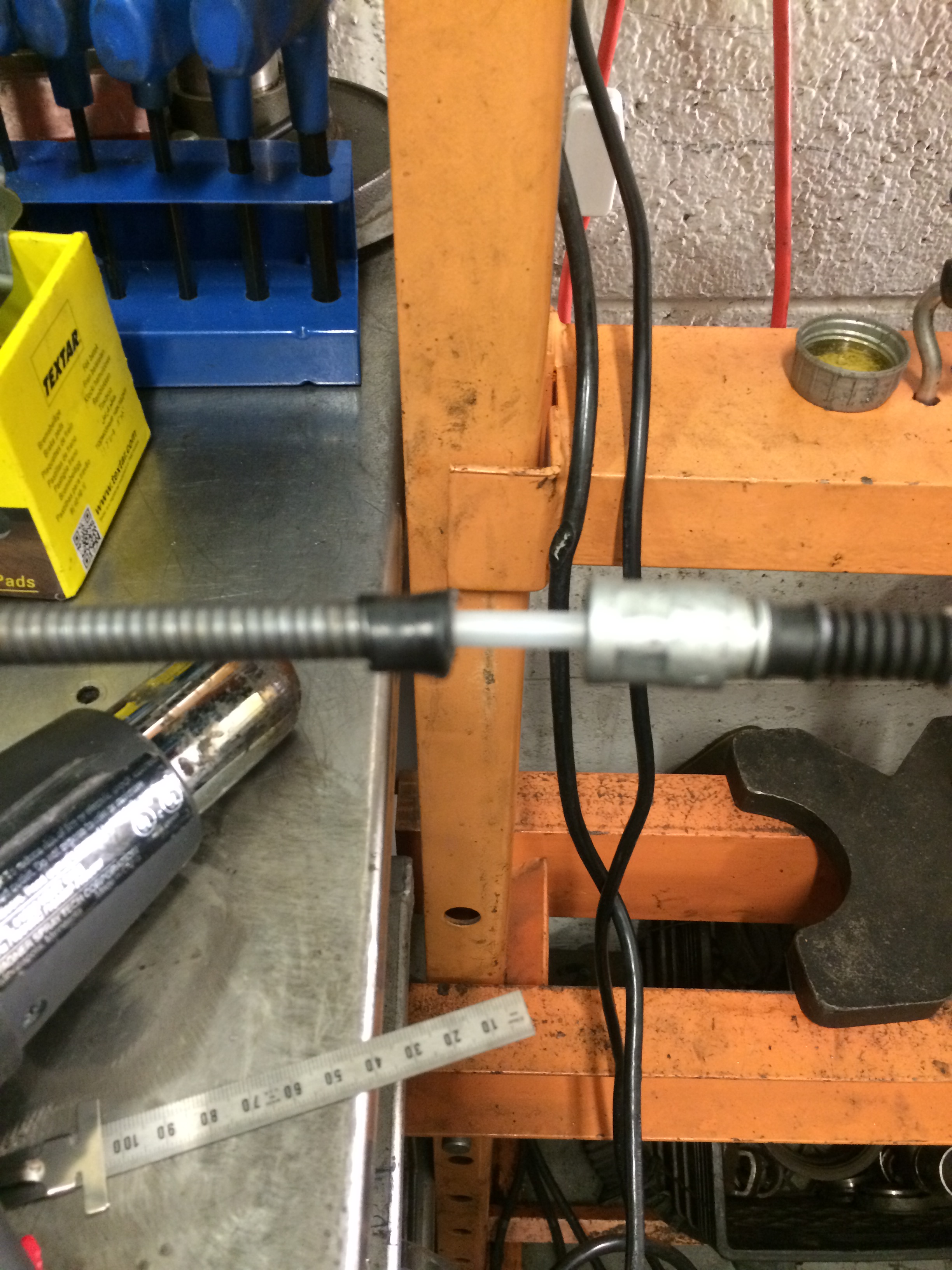

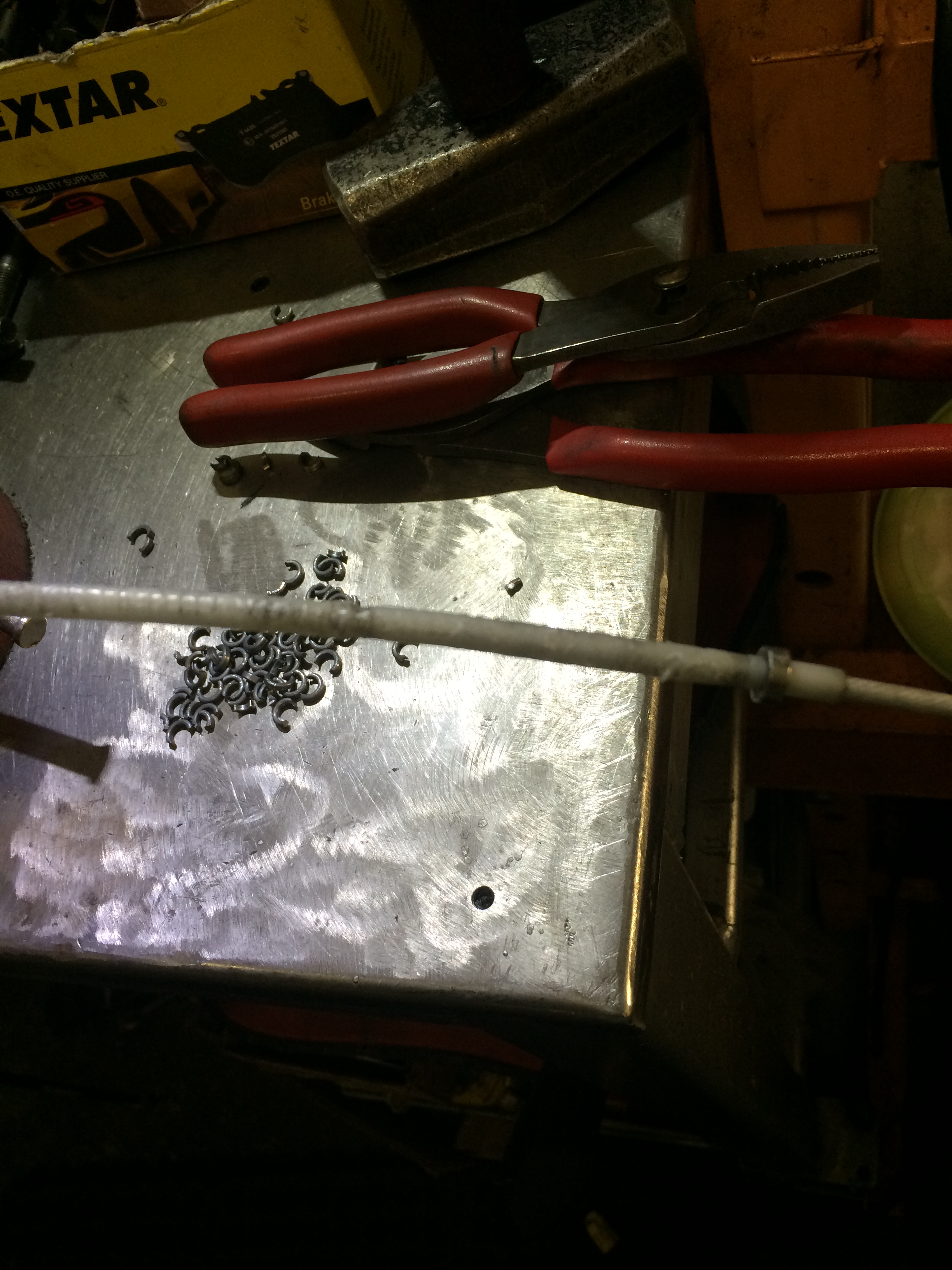

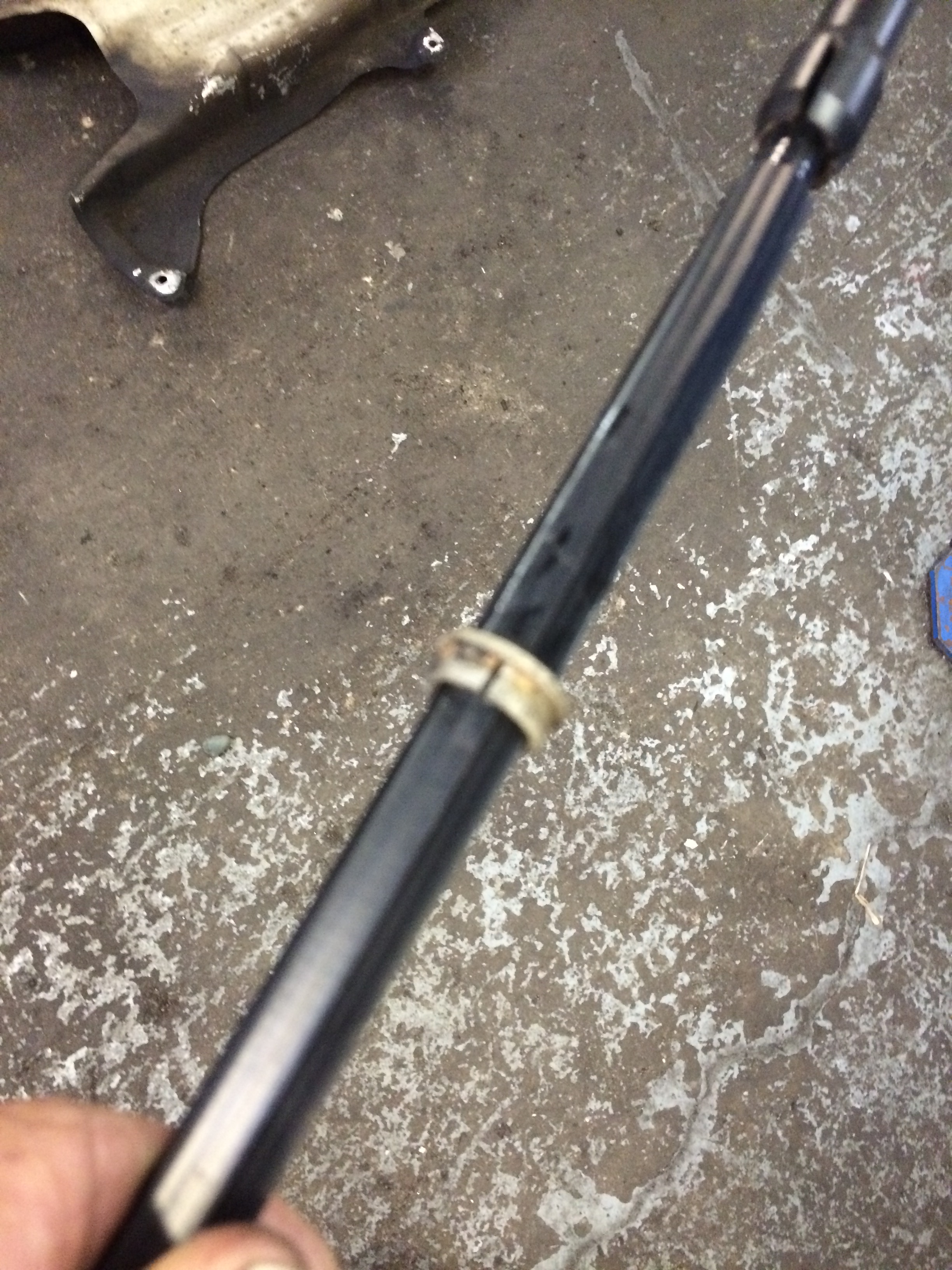

On to the cables.I want to clarify first that the brake cables ends will be referred to as the caliper end (CE) & the hand brake adjuster end (HB). Also, there are the parts of the hand brake cable that makes up the hand brake cable assembly. We will call them in order, firstly, the outer covering with the metal spiral wrap. The spiral wrap covers the inner sheath with Ferrule on the CE end of the hand brake cable. The inner sheath covers the plastic covered cable that imparts motion from the hand brake lever to the brake caliper arm. The write up by John B left me with questions about the brake cable modifications. (You did read it thoroughly, Right?) He mentions to remove the extra length from the caliper end of the cable. I believe that the hand brake adjuster end will be the better choice. There is a metal Ferrel on the CE that holds the inner sheath in place. As you remove the 100mm of outer cable sheathing from the CE you risk the chance of melting the inner sheath as well as needing to move the Ferrule. After removing 100mm of length from the outer cable sheath you are faced with how do you get it off. I used an air powered cut off wheel but had to be careful to not melt the plastic inner sheath that the inner cable rides in. If you do melt it then you will need to transfer the Ferrule on to the newly cut part of the inner sheath. No fun. If you work from the HB end then you can let the inner sheath protect the inner cable when you cut the 100mm section out. I used a heat gun to heat up the metal end of the CE off the cable body while twisting off metal end with a pair of pliers.
Mark cable 100mm from end of metal end of CE
August 9 219.JPG (1.26 MiB) Viewed 47084 times
CE metal end removed & showing extra bit of outer cable housing
August 9 220.JPG (1.15 MiB) Viewed 47084 times
Showing Ferrule on CE end of cable.
August 9 221.JPG (837.85 KiB) Viewed 47084 times
Need to cut this out without damaging inner sheath.
August 9 222.JPG (1.01 MiB) Viewed 47084 times

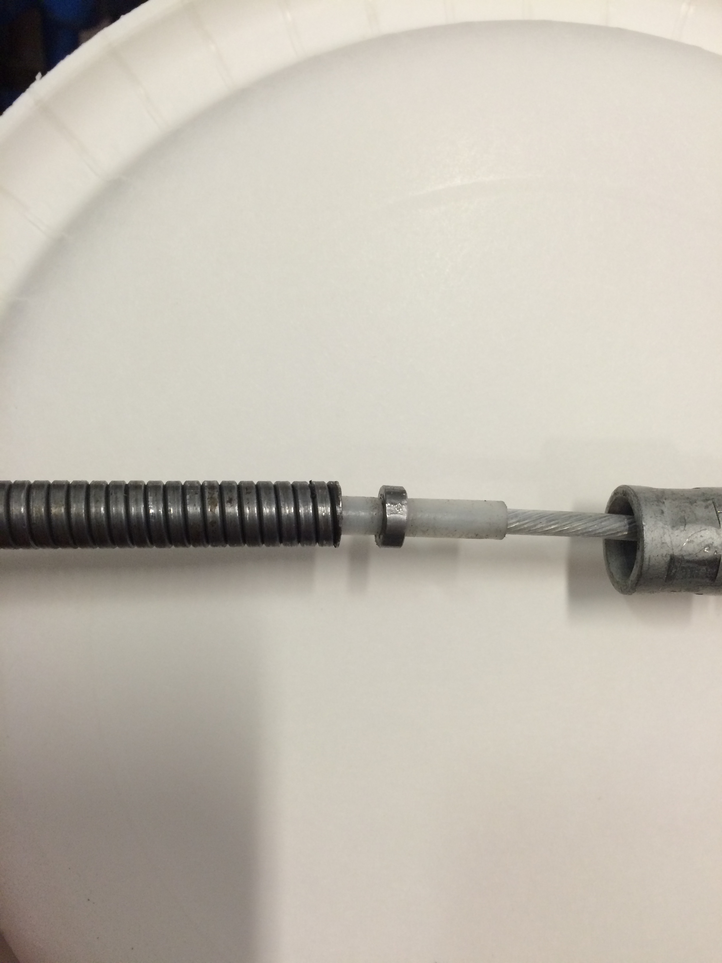

Metal spiral wrap removed.
August 9 224.JPG (1.71 MiB) Viewed 47084 times

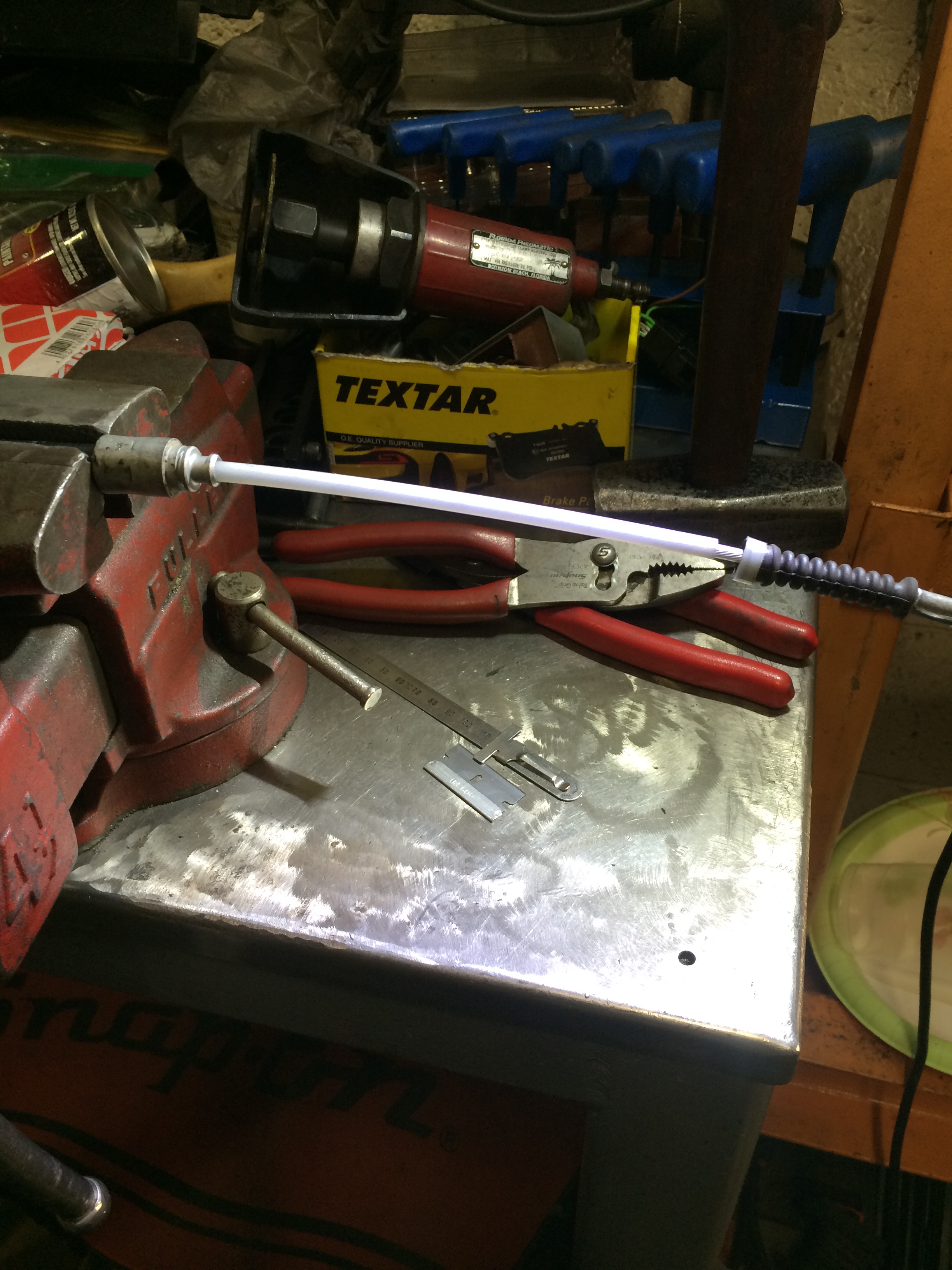

Working on the HB end of the cable.
Extra bit of inner sheathing to be trimmed off. I used a razor blade & carefully "fillet" it away.
August 9 226.JPG (1.72 MiB) Viewed 47084 times
Leave this much sticking out
August 9 227.JPG (1.41 MiB) Viewed 47084 times
HB end back together.
August 9 229.JPG (1.26 MiB) Viewed 47084 times

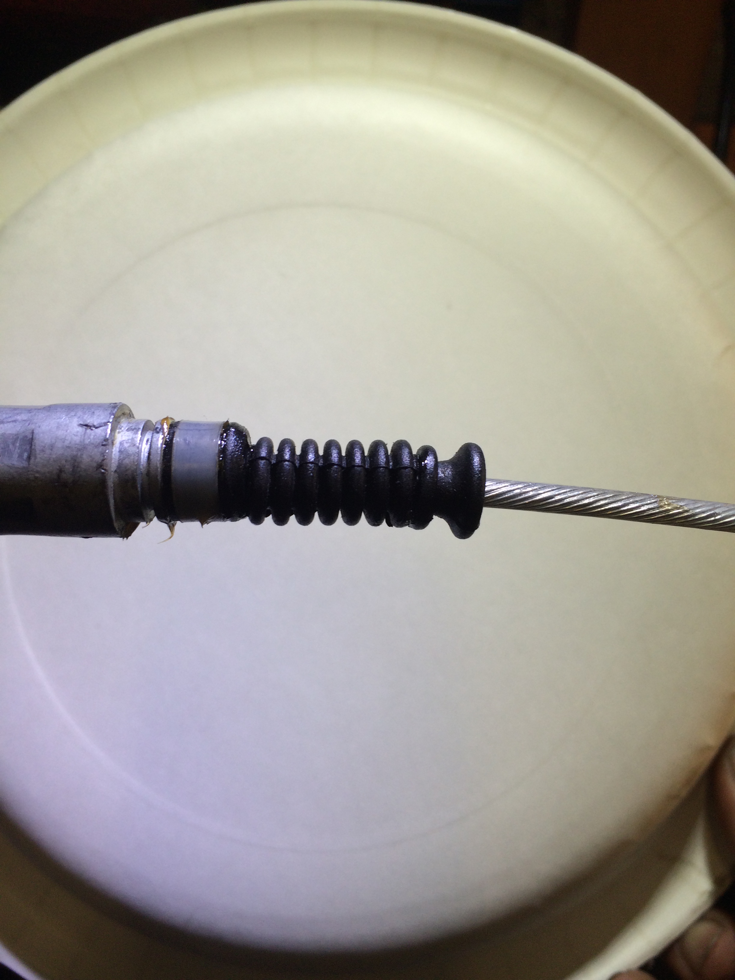

Back to the CE end of cable.
Boot trimmed on the CE end.
August 9 231.JPG (1.28 MiB) Viewed 47084 times
Boot trimmed to prevent interference with pulley. I left both ends of the rubber boot & trimmed away the inner section of the boot. A bit of grease to help seal the end & all is good. The pulley tends to keep the boot in place.
August 9 234.JPG (1.2 MiB) Viewed 47084 times

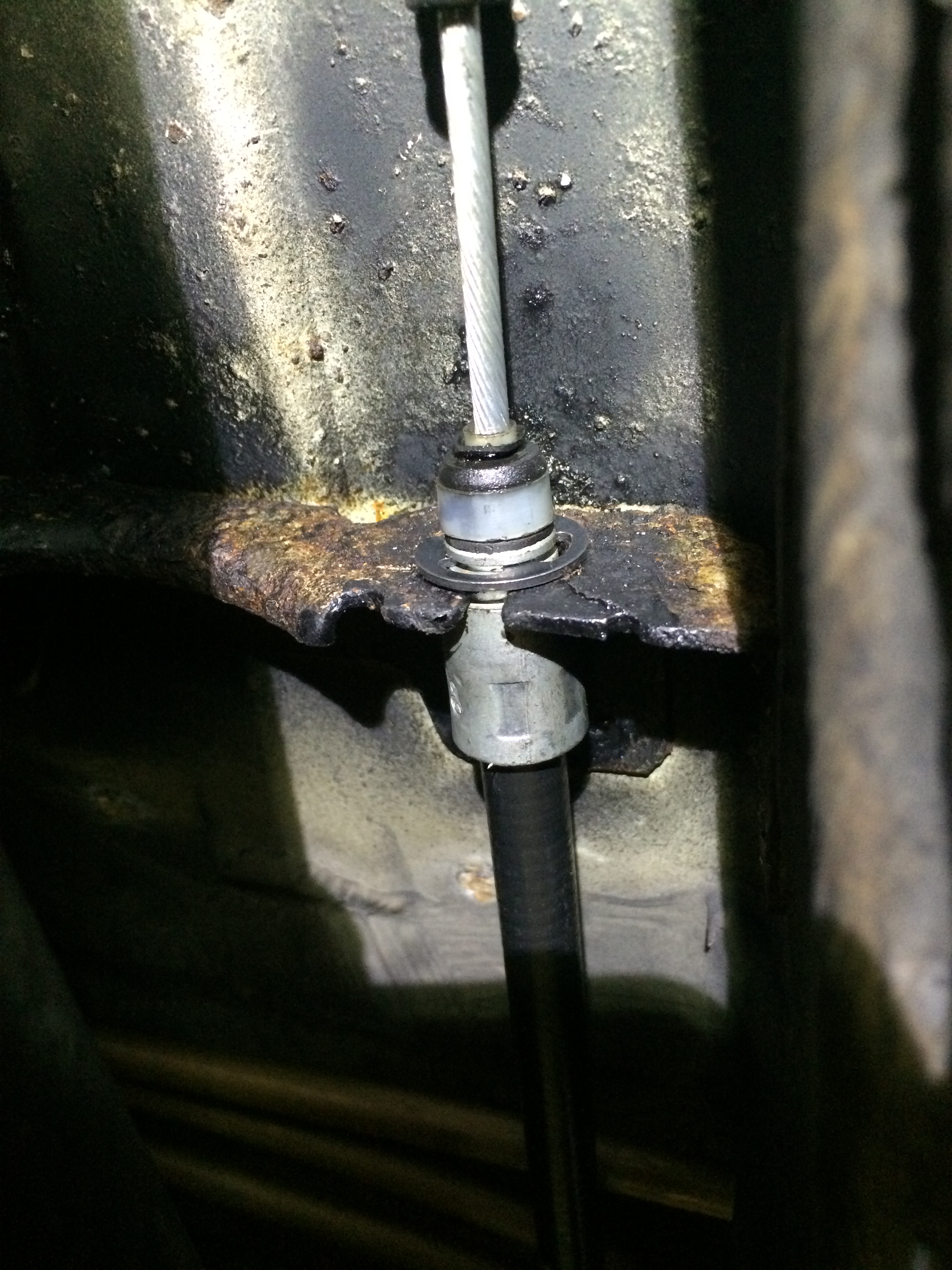

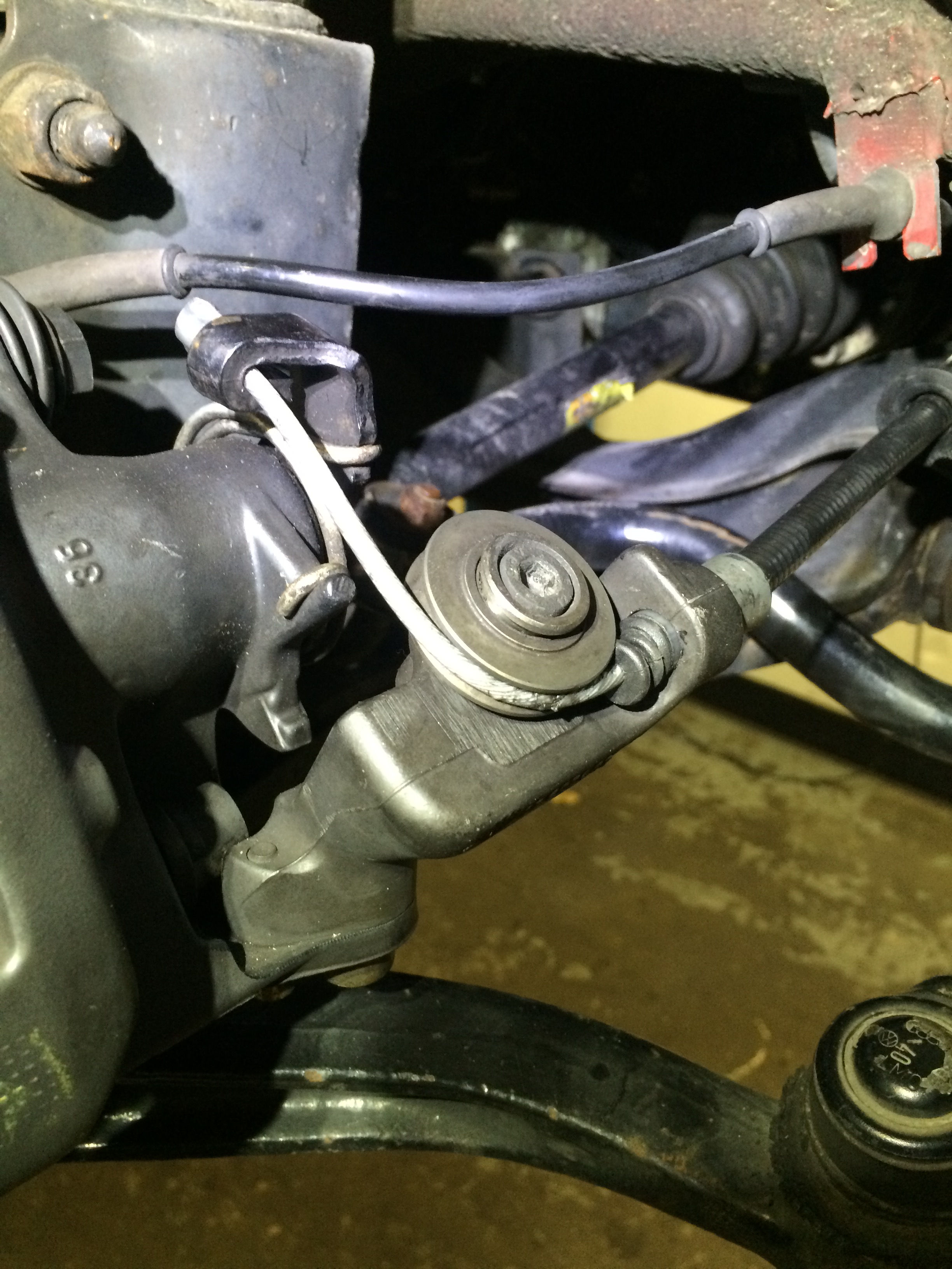

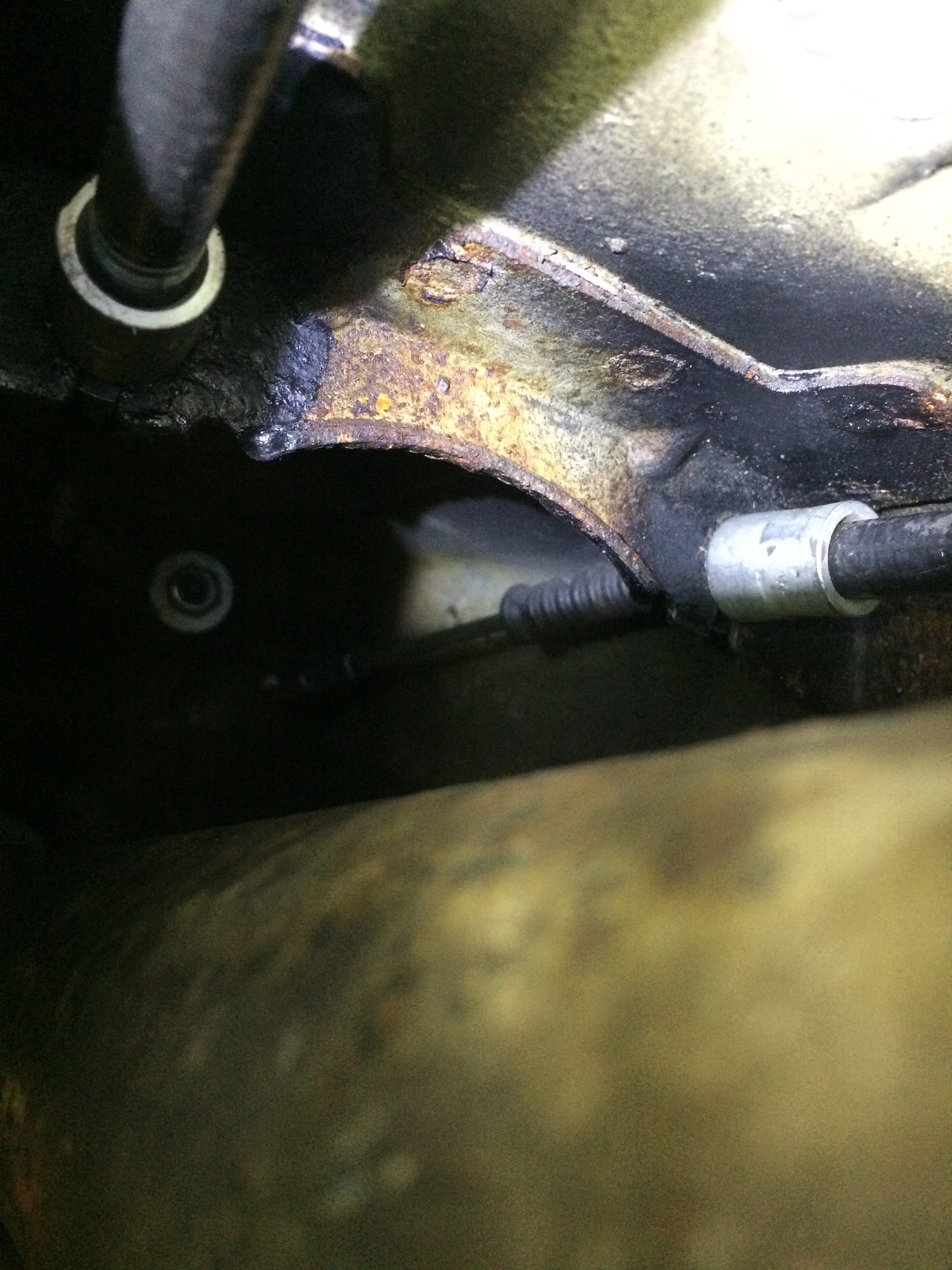

Right, continuing on. The bracket that secures the forward end of the hand brake cable will need to be enlarged for the B4 cable to fit the B3 chassis. The B4 cable end is slightly larger than the B3 cable bracket. You can reuse your old cable clips from the B3 cables if they are not rusted away as mine were.
Bracket needs to be slightly enlarged for the cable to mount properly.
August 9 233.JPG (1.31 MiB) Viewed 47075 times
Cable with new clip.
August 9 232.JPG (1.33 MiB) Viewed 47075 times

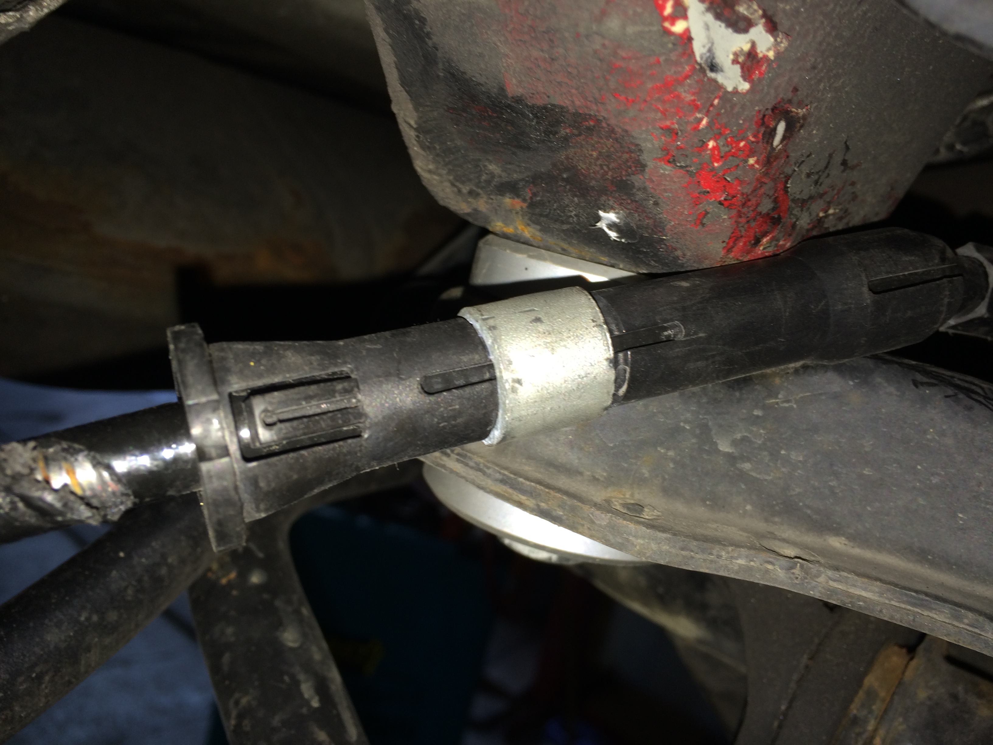

You will want to use these plastic sleeves from the B3 chassis. The cable passes thru these on their way rearward. Not bad for 26 year old plastic.
August 9 217.JPG (1.54 MiB) Viewed 47075 times
Plastic guide for fitment to the B4 chassis. Cut this off now as it will be in the way later.
Tweak the factory cable guide bracket so it supports new cable & does not cut in to outer cable covering.
IMG_1631 (2).JPG (1.23 MiB) Viewed 47075 times

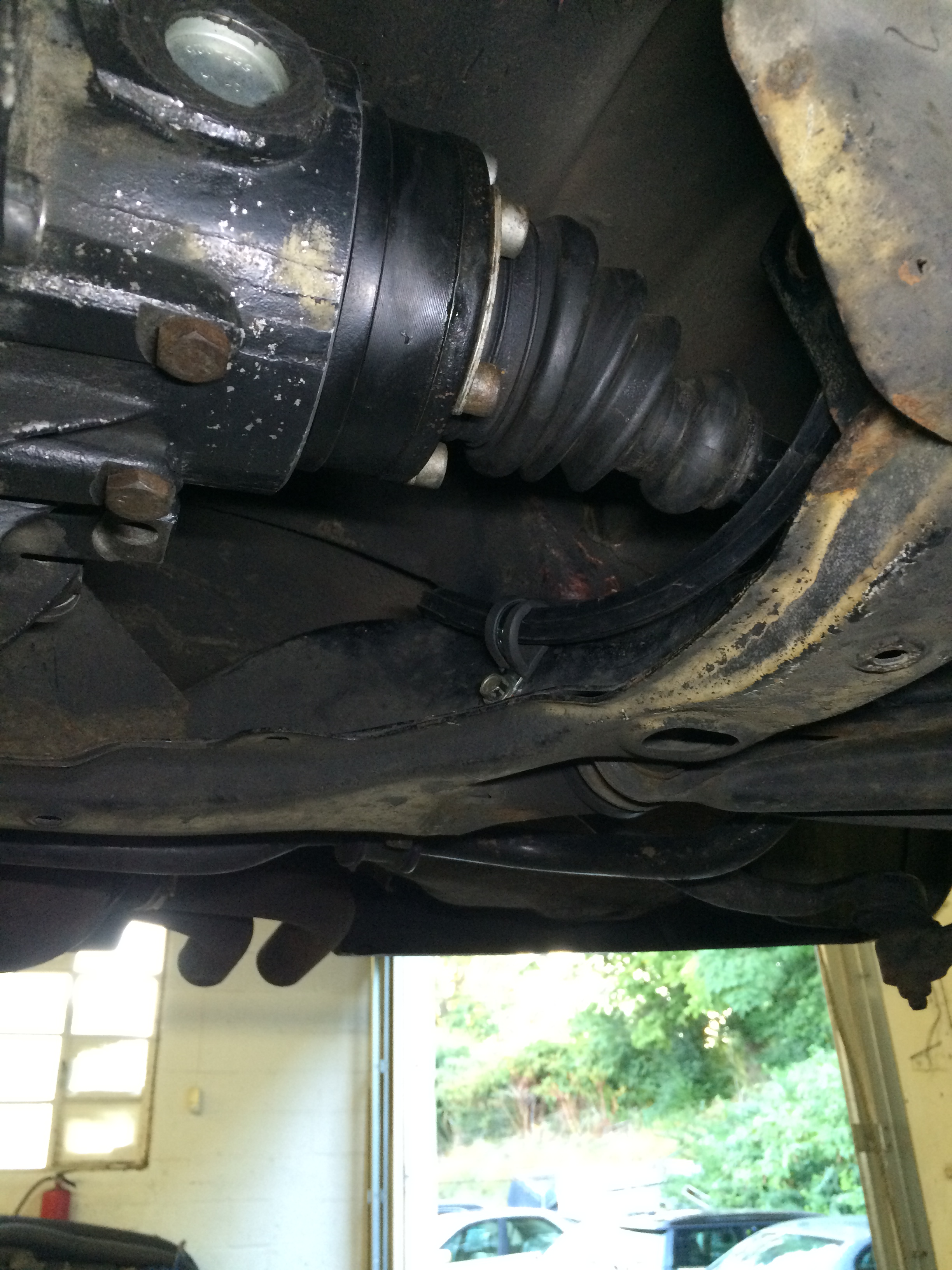

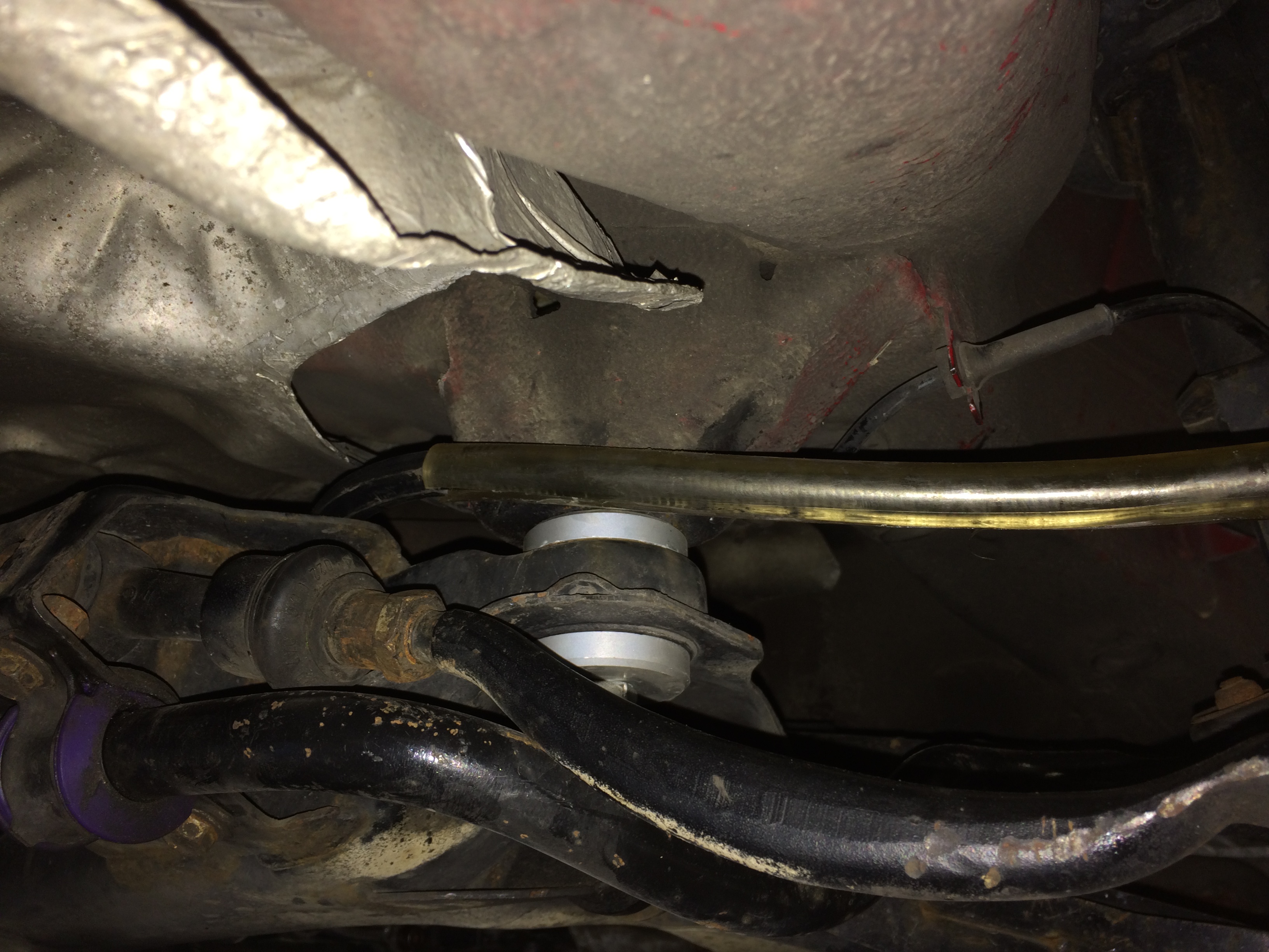

A1QSHIP
Posts: 109
Location: Palm Coast, FL
Re: Coupe with a working hand brake
Post by A1QSHIP »

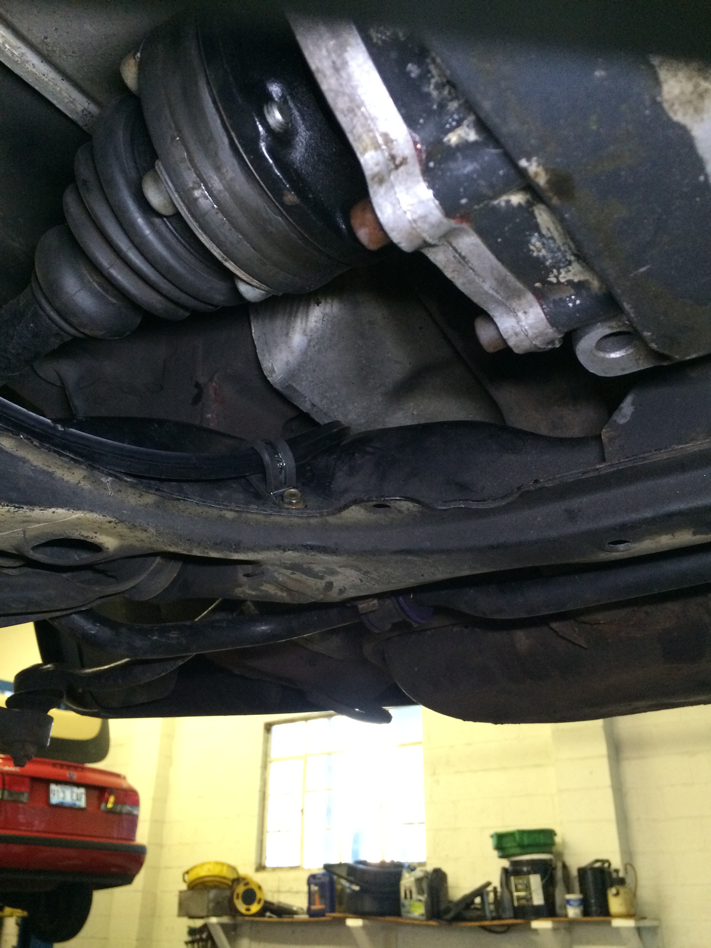

Almost done.
Cable routed Behind back end of subframe. Plastic tubing cut to fit over new parking brake cable for protection.
Another angle.
Another angle.
Adel clamp to hold cable to subframe on left side.
Adel clamp holding cable on right side.
And there you go. Questions? Comments? Criticisms?
