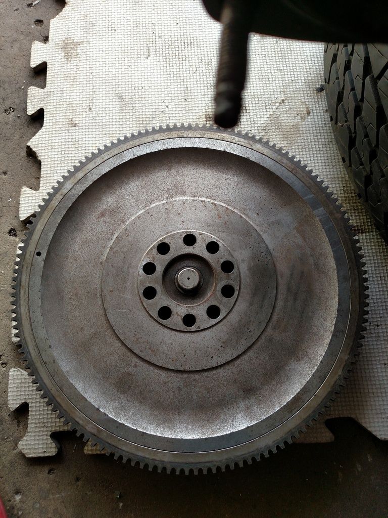

I couldn't get one from ttv because they were not in stock. Instead I took a chance and bought one on eBay. Now I can figure out what it is. 136 teeth, bolts to my ABZ but won't sit flush because of boss on crank.
Maybe oem abh? Can I just machine out the center so it sits flush?

It's definitely not ABZ since there is no 60-2 ring.
Looks like an OEM PT or ABH but it has the small pilot bearing.
Is there a part number?
Here's an OEM 32v V8 flywheel - note the larger pilot bearing:
My Fidanza flywheel had a large opening there...

Looks like an ABH after some more searching. The reason it won't fit is because I need to remove that nub thing on the back of the motor that the auto trans used..... I think it should work fine.
Now I need to figure out a clutch/pp I can use.
